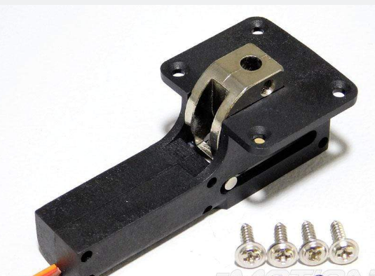

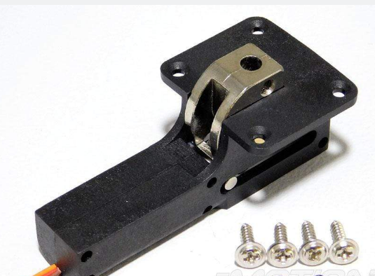

      Greetings all. I have just purchased an F7F from a club member and there is a minor issue (we knew about it before sale). The left main has a ton of slop, as in about 45 degrees of movement. Understand that I have very little mechanical abilities so thus the question. I have briefly looked over the gear and cannot find an adjustment screw or grub screw on the gear. Is there one that is hidden around where the actual retract mechanism is and I just can't see it? Thanks for any help provided!
        • 7340
        #2223
        Retract movement or pivoting toe in and toe out?
        There is a small set screw in the side of the silver arm of the Click image for larger version  Name:	retract.png Views:	0 Size:	239.5 KB ID:	374961
        retract. See it just below the hole for the gear to fit in. If I recall there should be one on both sides, there are set screws in them, try tightening them.
        (Line the gear up in the right direction first!) If its slop like it's half retracted, then check to see if the 'claw' is wrapped around the silver bar, there's a 'window' that runs the length of the retract head, the screw on the left in the picture is pointed right at it. If it's jumped that bar, disassemble the retract and put the claw back on the bar.
        Hope this helps.
        • morganjw1
          • Nov 2022
          • 20
          #2224
          Grossman56, thank you for the info. The issue is the gear swiveling causing an issue with tow in/out. The picture you posted is exactly what I was hoping to see. I really appreciate the help. Cant wait to get her in the air.
