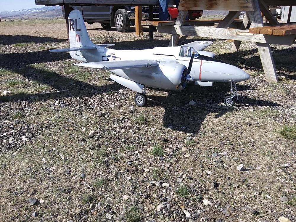

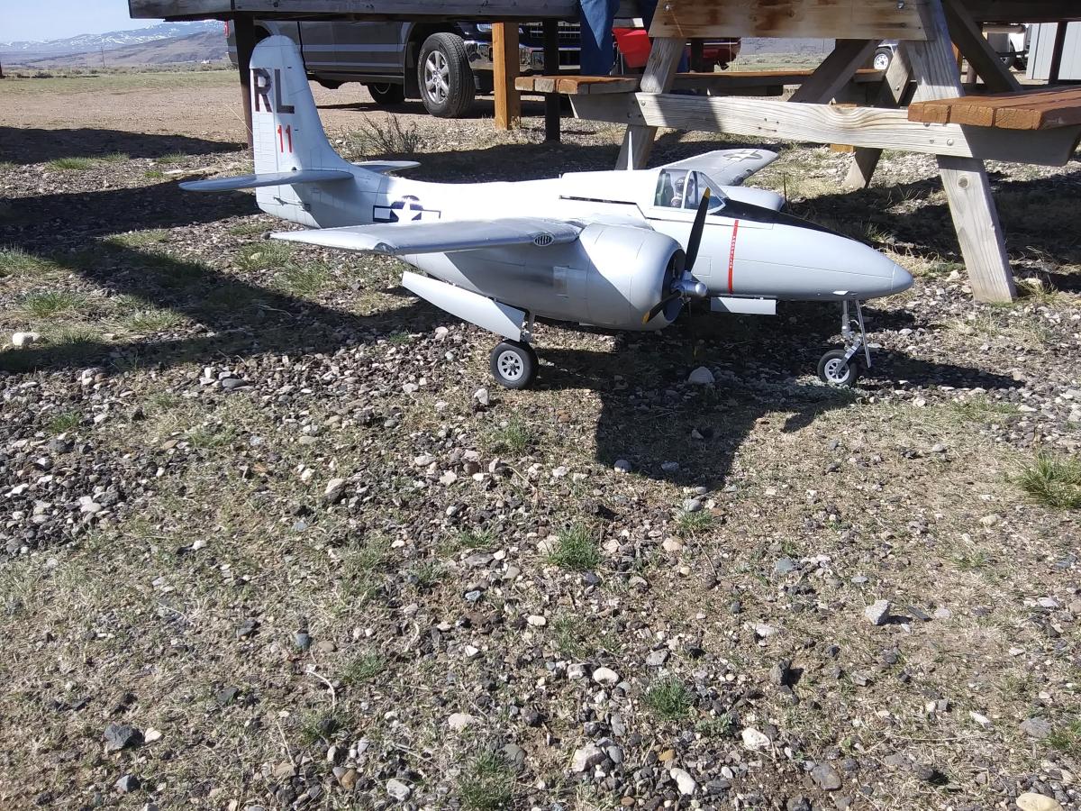

                      A guys gets a little nervous after going from this:
                      Click image for larger version  Name:	IMG_5577.jpg Views:	0 Size:	130.5 KB ID:	380541

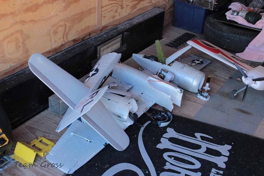

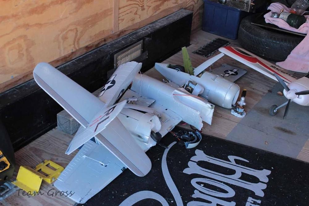

                      Back to this:
                      Click image for larger version  Name:	20230430_095520.jpg Views:	0 Size:	348.5 KB ID:	380542

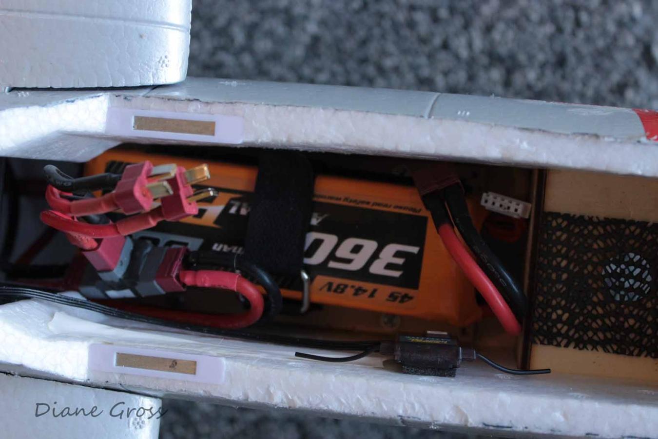

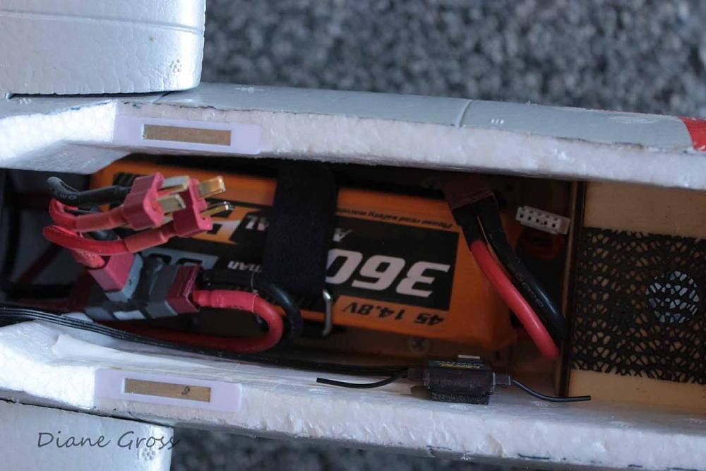

                              page 66 post # 1310 That's what I did, she still flies off the same plugs. No wires, just two plugs.
