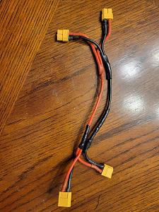

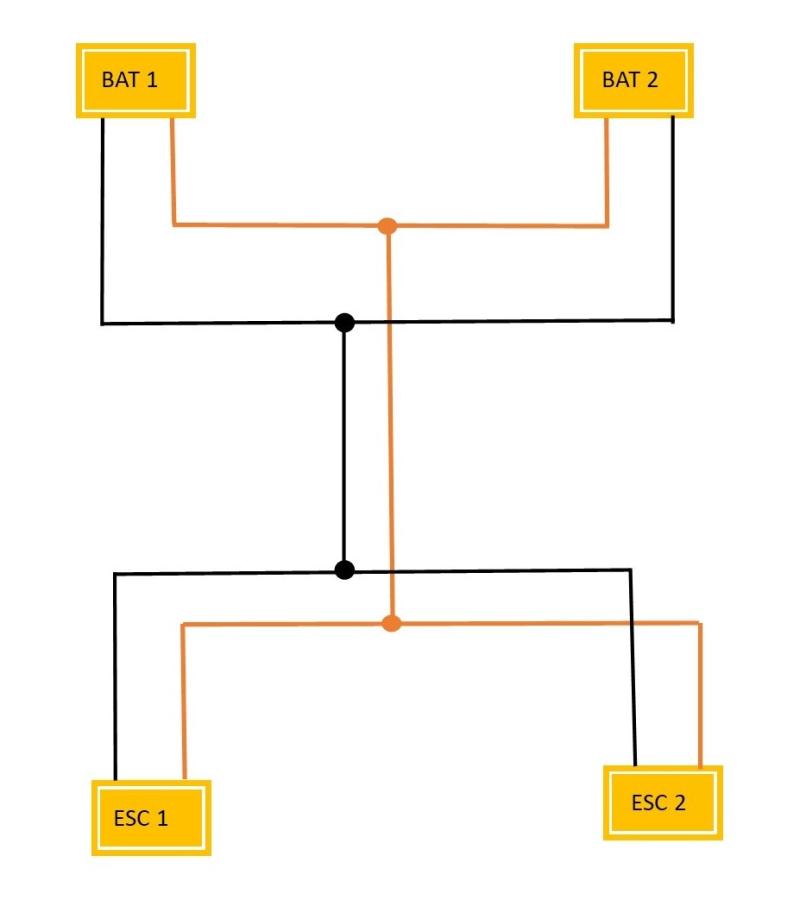

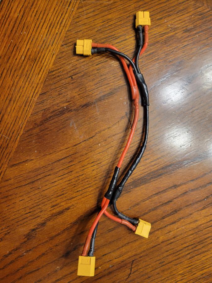

                                    How would you go about running the batteries in parallel? I am trying to picture what kind of harness would need.
                                    • Denniswpb
                                      Hobby Squawk Pilot
                                      • Dec 2017
                                      • 132
                                      • Rock Hill, SC
                                      #2298
                                      You would have 4 connectors ( 2 male and 2 female sets) The 2 male connectors plug into the 2 batteries. The black wires (-) get connected together and the red wires get connected together. The 2 female connectors plug into the 2 ESCs. Do the same thing, Black wires together, and red wires together. Now take the 2 black wires from the ESC connectors and solder them to the 2 black wires from the batteries. Do the same for the red wires.

                                        #2299
                                        Thanks. That looks cleaner and then what I was thinking of doing.

                                          #2300
                                          I attached a drawing also!
