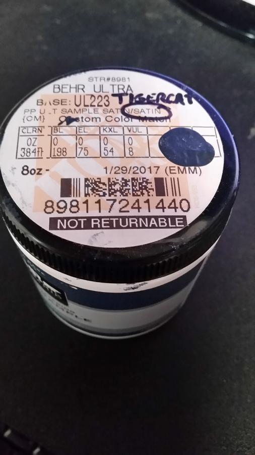

    • Bbolz - many of us have used the Behr paint 8oz "sample" jars available at Home Depot - they have a color match service, you bring in a piece of your plane and they have this gizmo that matches the paint.
      It's called 'Behr Premium Plus Ultra" and I picked a "satin" finish. Its just about completely flat and matches the sheen of the original perfectly.
      It's very easy to work with, you can use a brush and it cleans up (and is thinnable) with water.
      If you search this thread there's at least three others who have posted samples of their jars.
      The color match on mine is almost perfect, not absolutely perfect but extremely close. I use it for touchups. (This is the same color as the Bubble-top Corsair by the way)
      The picture shows the color codes, you can print this and just take it to the store.

                • For Mudduck and G56,I picked up touch up paint for the F7F from HD yesterday and it is a very close match. Thanks to MD for the screen shot of the code. Made it very easy to have it mixed up in an 8 oz sample jar. I took the canopy with me but the gal doing the mixing said using the bar code was the best way to duplicate it. I don't think she wanted to take the time. Thanks again to both of you. Now if I can just get the MCI sound card working right in the A10 I'll be ready. The MCI card in the Tigercat works great.

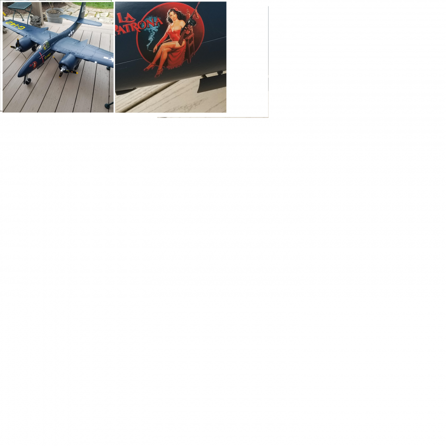

                    • Nice! I have been using the plain old MInwax Satin but spraying it on unthinned. Works great. I too have the La Patrona nose art but not on the silver paint. I know it breaks scale rules but I just like it. So what the heck hey.

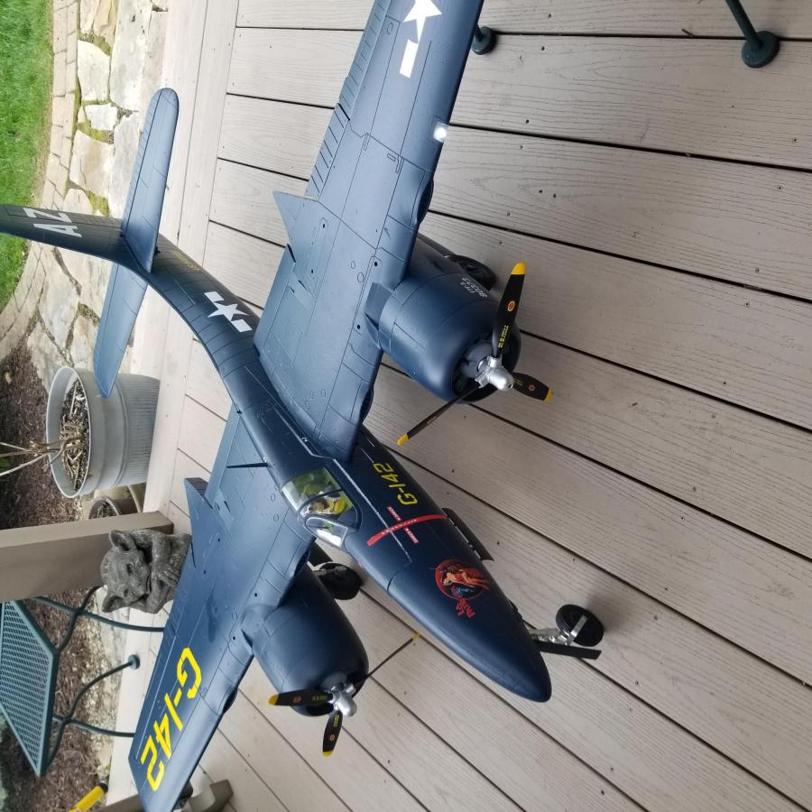

                            • Awesome plane. I installed an MCI sound card for the twin Wasp startup. Works great. I'll video that when I get a chance. Can you use a phone camera to video? Never have done that. Anyway, I love the blue color and the stickers. All I did was shoot Minwax clear to protect the stickers. I can't wait to maiden this baby if it ever stops raining in the Midwest. Click image for larger version

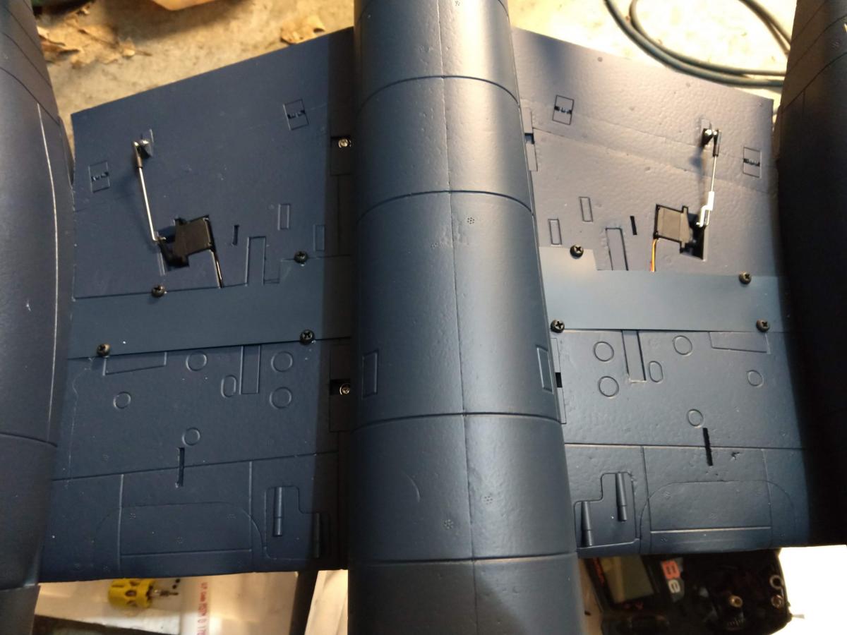

                                Click image for larger version  Name:	IMG_20190603_210044490.jpg Views:	0 Size:	138.9 KB ID:	198632
                                I did the undercarriage mod and screwed in that plate.

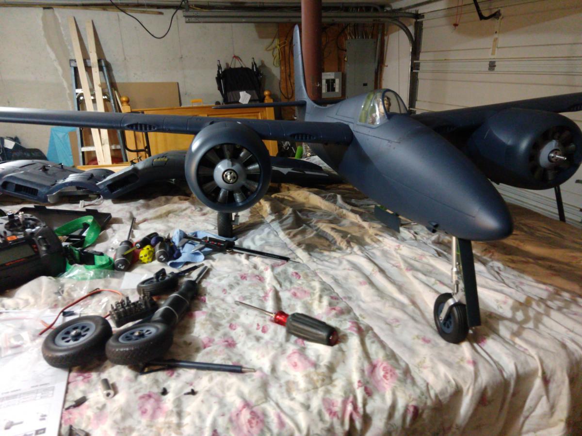

                                Click image for larger version  Name:	IMG_20190603_204546959.jpg Views:	0 Size:	87.8 KB ID:	198633
                                Finished the decals yesterday and just waiting on the battery straps tomorrow. Otherwise thumbs up!
