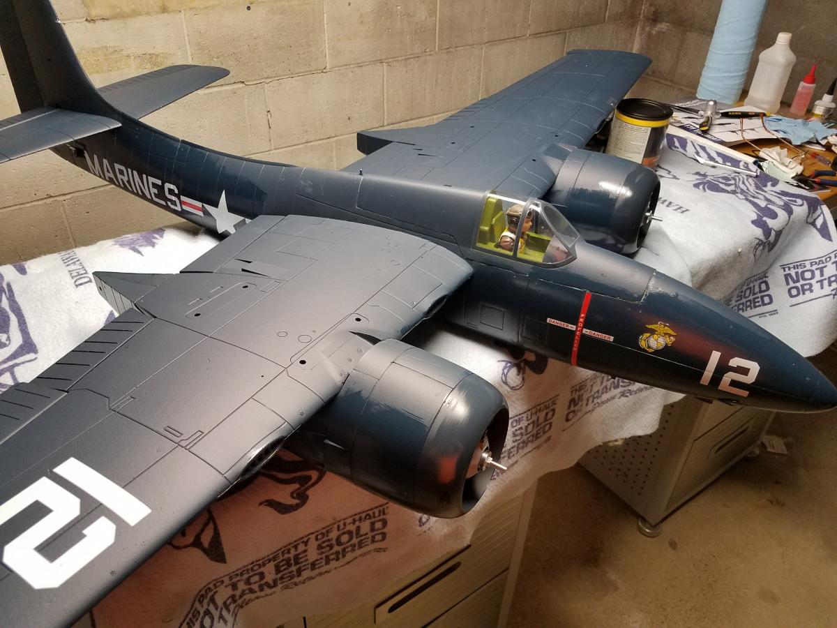

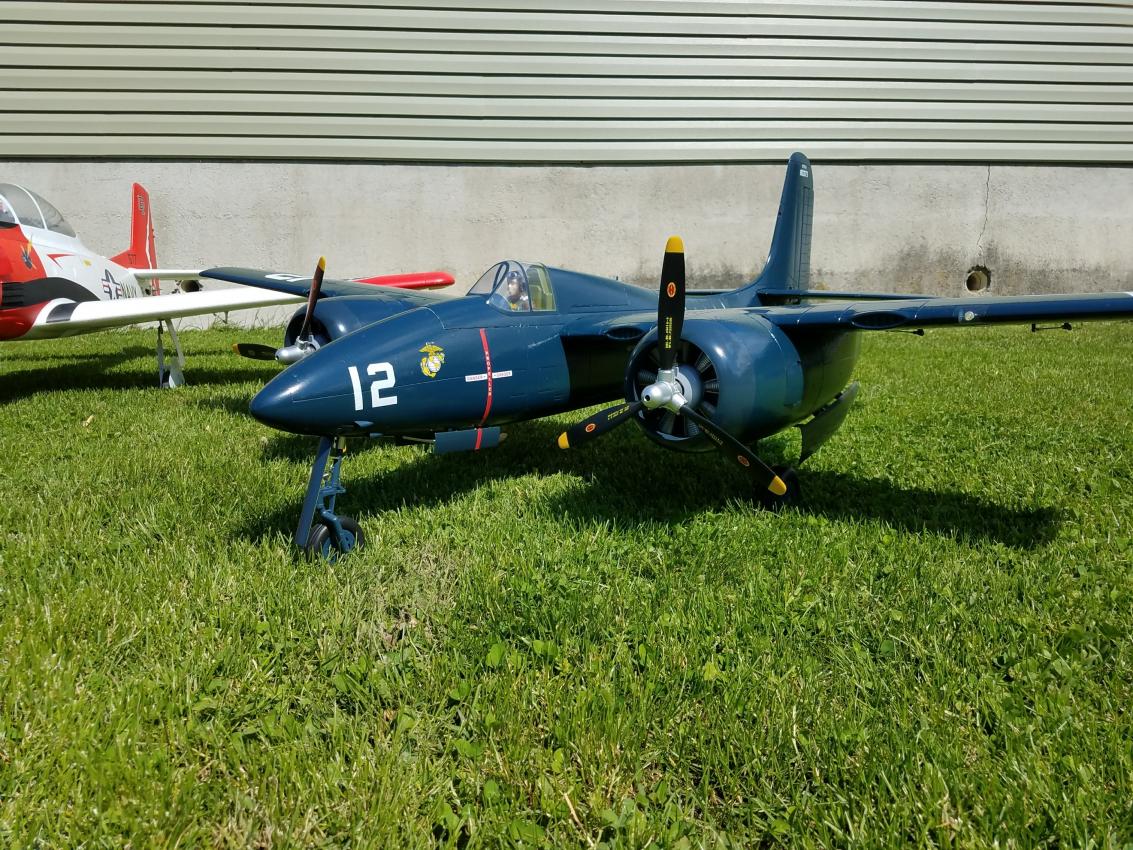

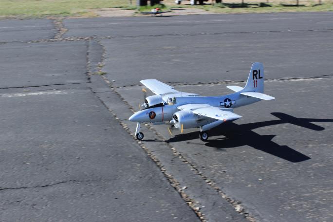

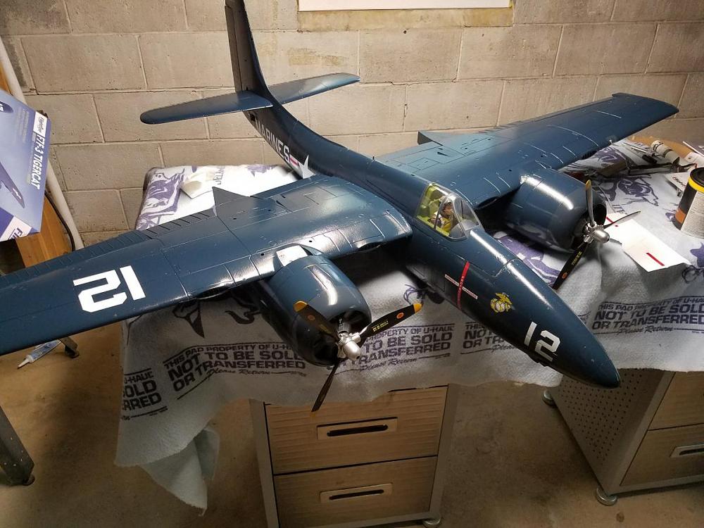

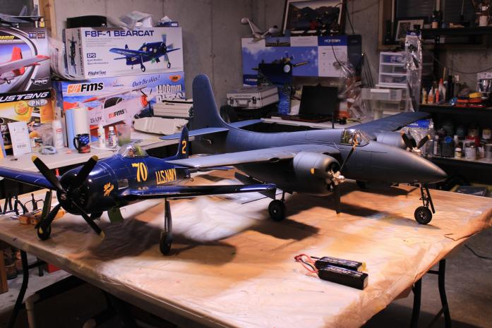

  • Looks like this Tom, the Bearcat and Tigercat are the same color stock, I have three coats of Spar Urethane on the Bearcat
ID:	74721Click image for larger version
ID:	74722Click image for larger version
    • Yes sir, that looks great!!!
      That's the way I want my F-7 to look. Hope I can do as good a job as you.
      Thanks a bunch for the info guys...
      Tom

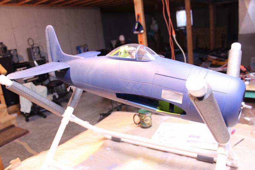

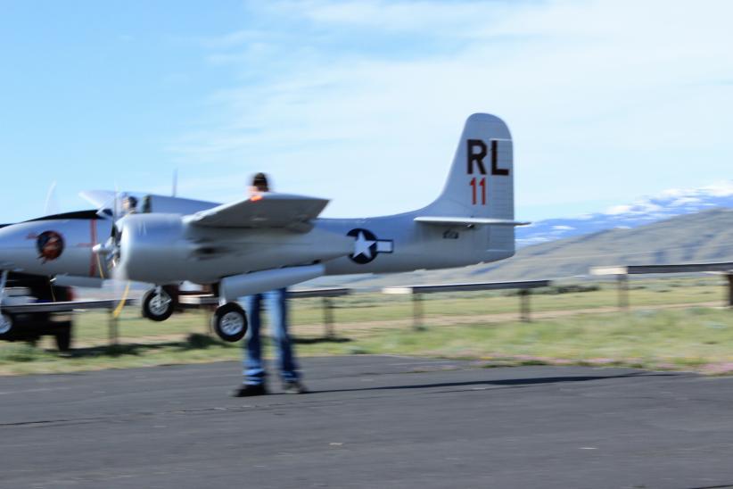

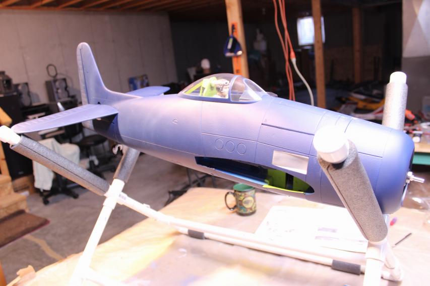

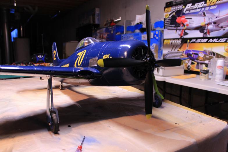

      • Use a soft brush or a foam brush. Go panel at a time, brush strokes width wise then in the direction of airflow. I use a hair dryer to get it set up quickly and watch out for runs I don't dilute it either). I usually leave it overnight before applying the final coat. The first one will look patchy, that's just the foam absorbing the paint. Second one will look pretty good, the third one will look even better. La Patrona has one coat of primer, two brushed one coats of silver grey, six sprayed on coats of Clear Pearlescent and two three brushed on coats of Spar Varathane, great results! Click image for larger version
        • I have used both and prefer the Minwax because it is easier to sand. I used 7000 grit paper to sand and polish the final finish with Minwax, which I find hard to do with Spar Varathane. I guess it is a matter of preference.
          • Yep, see I haven't sanded any of mine, never saw the need to, but if you do and you get a better result form Minwax, go for it. You're right it is a matter of preference. Sometimes it's a matter of whats sitting on my shelf as well:)

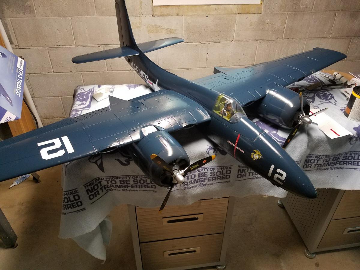

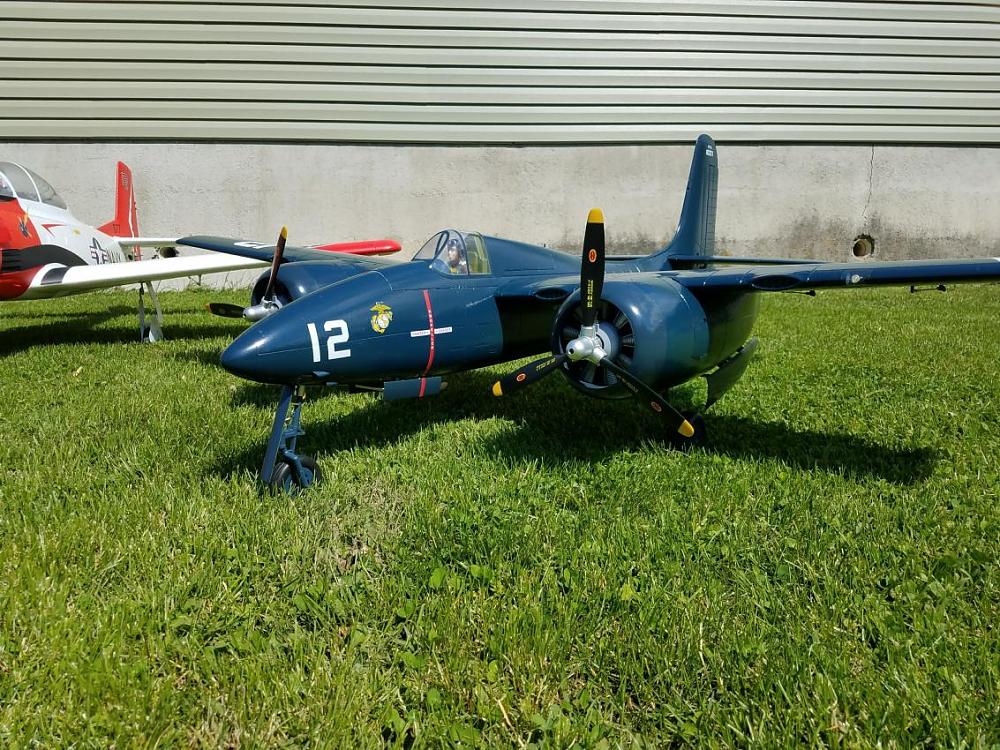

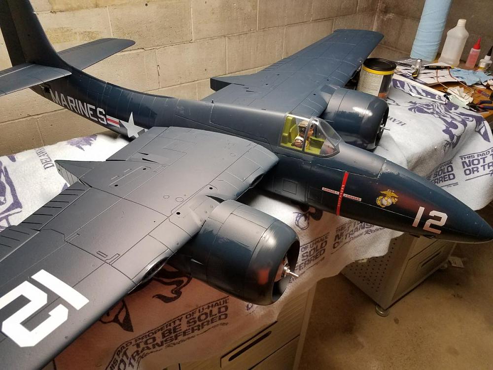

                  • Well, I couldn't find the products mentioned in the previous posts, but Lowes did have this... Water based, indoor/outdoor use, and UV protectant...
                    Here are some pics of the bottom side with 2 coats, going to put on 3 total using a foam brush as recommended by Grossman56...
                    Going to put 3 on prop also to preserve the decals...
                    Going on really easy and looks good to me so far, I like the shiny finish, some don't, to each his own... If we were all the same, it would be a pretty boring world...
                    Will post completed pics when done...
                    Thanks for the help with all the info you guys provide...
                    Happy flying...
                    Tom

                      • Heck, looks good to me!
                        • Looks good Tom, give her 24 hours to really harden up then get the final coat on her. You can also use a very soft bristle brush, like an oil painting brush, I have several so tried on of those on the Tiger cat, they work well too.

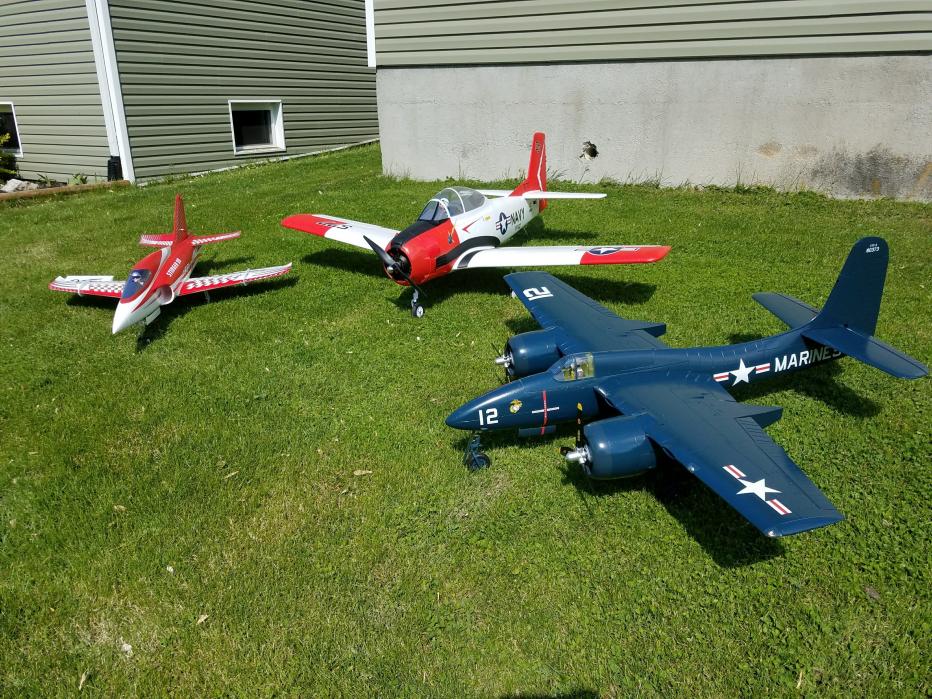

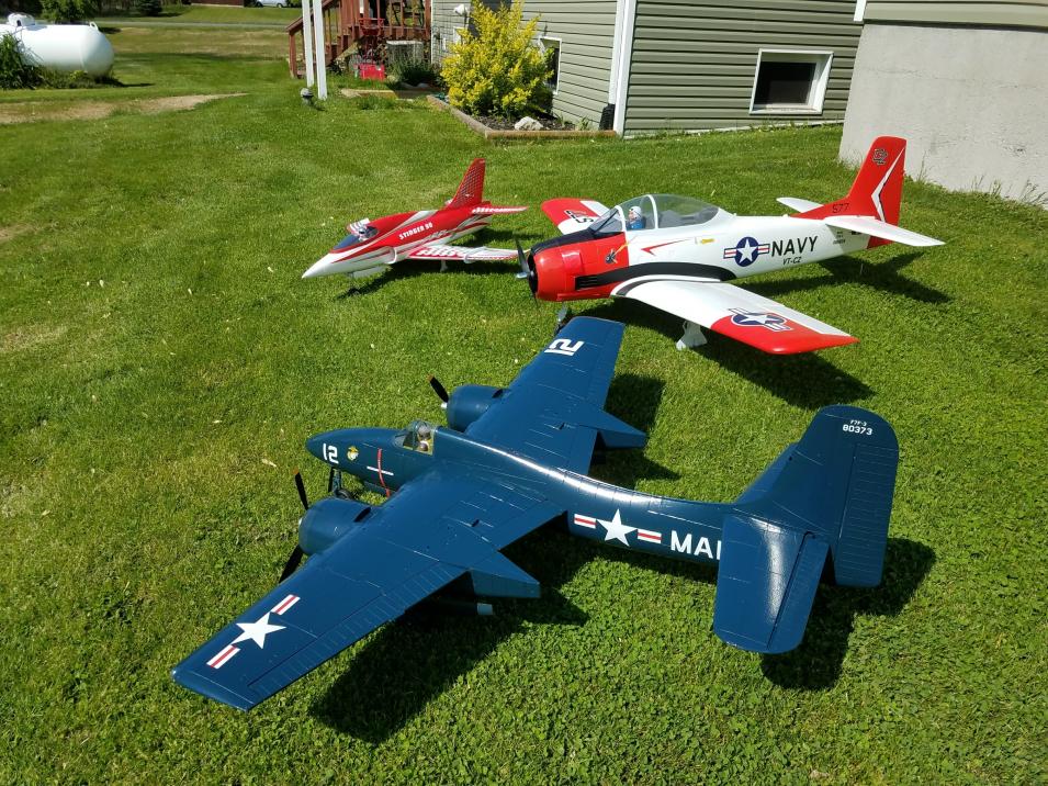

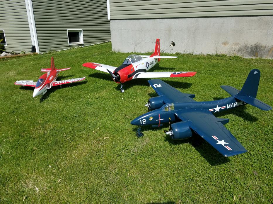

                            • Here is the finished F-7 using the new Minwax Pro Series Spar Urethane. Looks good to me, we will see how she holds up this summer... Click image for larger version

                              • Looks good Tom!
                                Aren't they a bird to be proud of ??
                                • Yes sir, they are... Military aircraft are my favorite, but the EDF Sport Jets with their speed and maneuverability are a blast to fly...

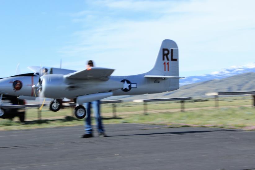

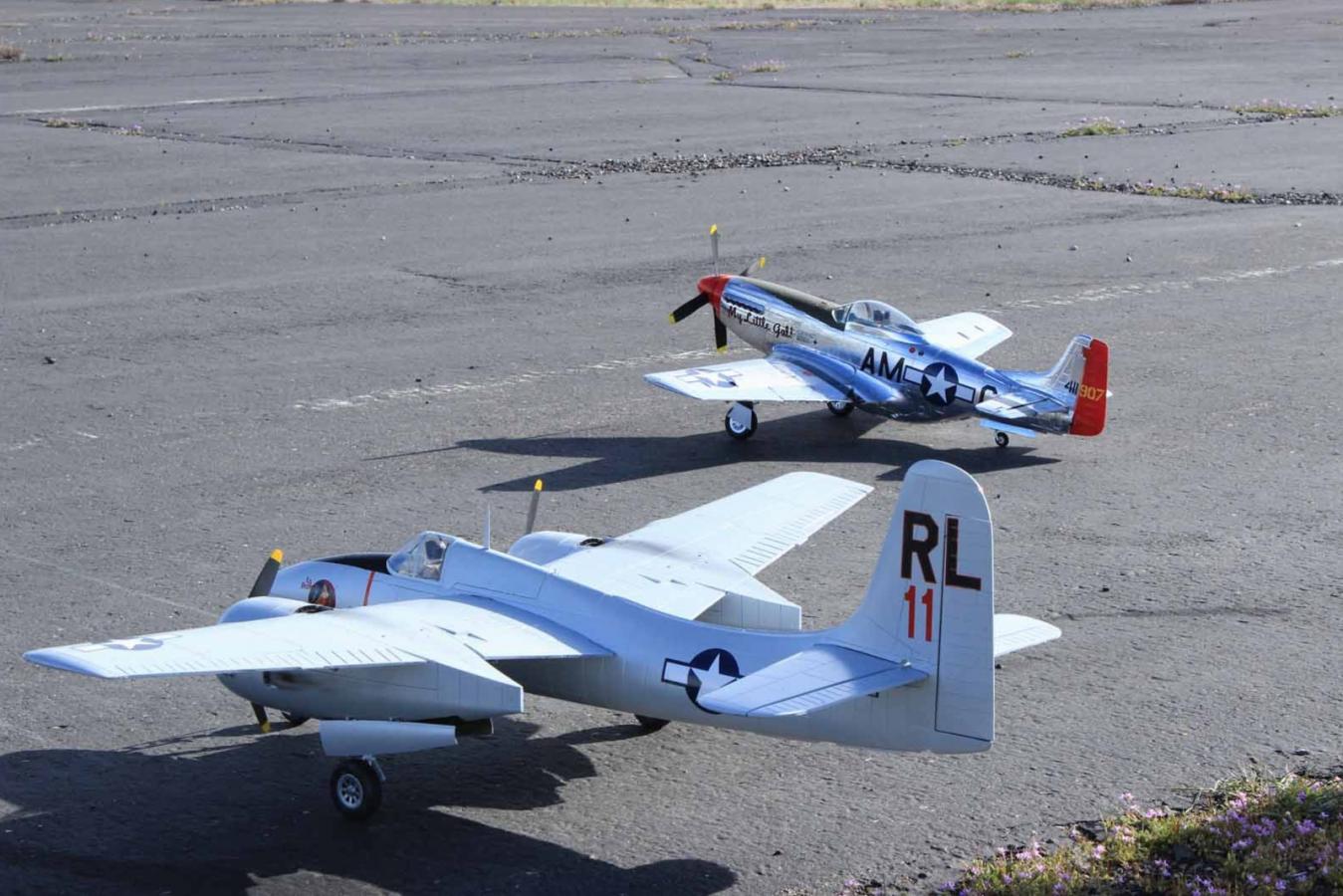

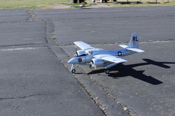

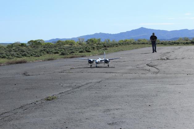

                                      Here's a slightly blurred, but nevertheless cool pic the wife got.
                                      Click image for larger version  Name:	IMG_9712.JPG Views:	1 Size:	37.8 KB ID:	75439

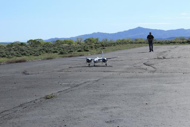

                                      And me walking her back after an early flight in which I landed with no flaps, this was while I was looking for the optimum flap elevator mix. She landed fine, but I was so focused on planting the nose that I accidentally hit the throttle forward instead of the elevator!!
                                      Immediately killed the throttle and pulled her over into the weeds to stop her rather than the sage brush at the end of the runway. A problem we're fixing at the field this morning during our annual field clean up Click image for larger version  Name:	IMG_9718.JPG Views:	1 Size:	34.8 KB ID:	75440Click image for larger version  Name:	IMG_9779.JPG Views:	1 Size:	41.4 KB ID:	75441

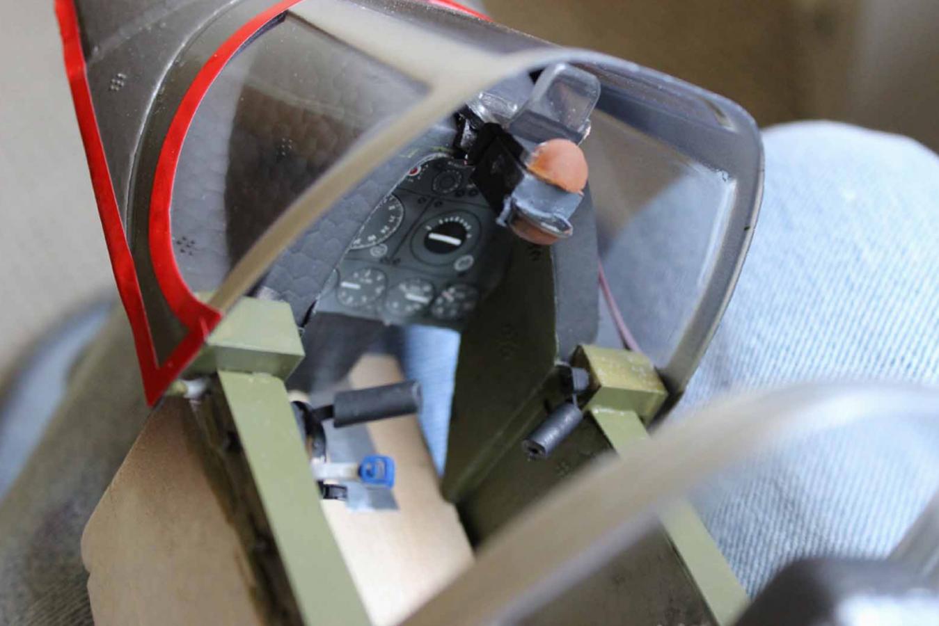

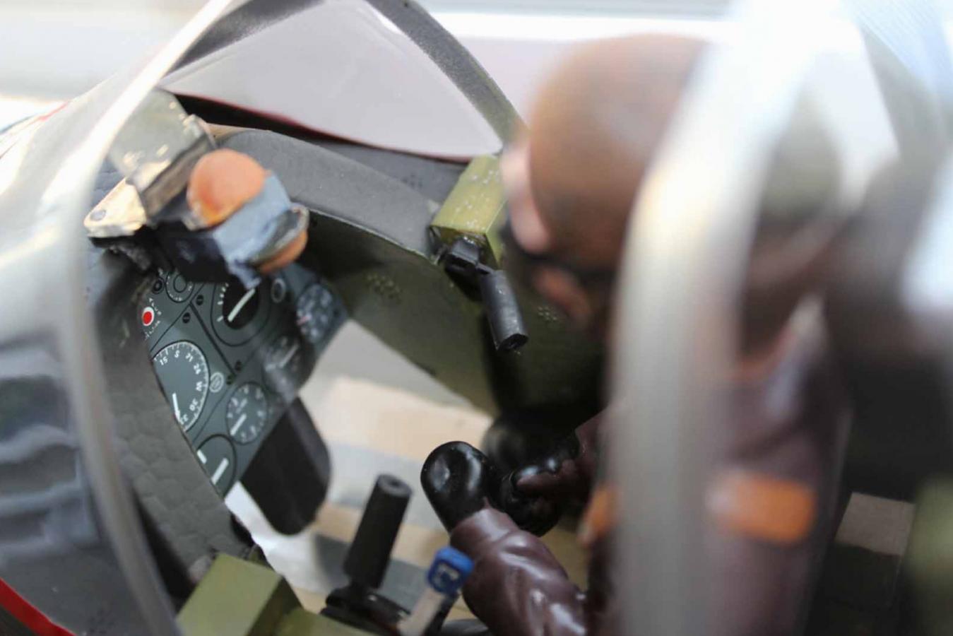

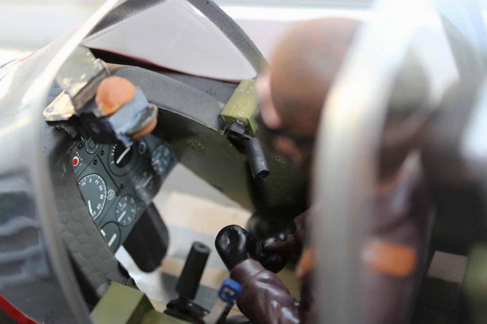

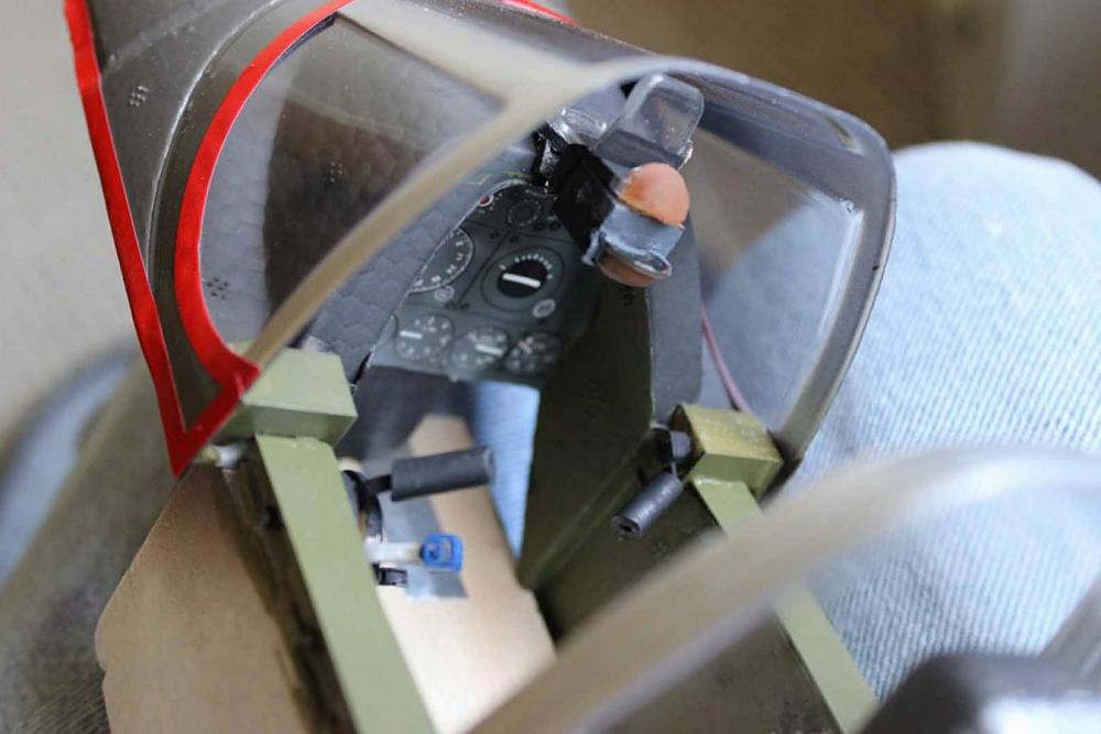

                                      So now that everything is working well and she's flying great, I'm keeping my eyes open for little things I can use for motor details. Came across some used manila tags that we were just going to throw out at work, the wires would be perfect for spark plug wires! So I scored some of them, things like that make for great detail and I get a kick out of finding things that 'look' right and adding them over prefabbing something, although I've done some of that as well, as in BBD's cockpit
                                      Click image for larger version  Name:	IMG_4411.JPG Views:	1 Size:	90.7 KB ID:	75442Click image for larger version  Name:	IMG_4409.JPG Views:	1 Size:	77.6 KB ID:	75443

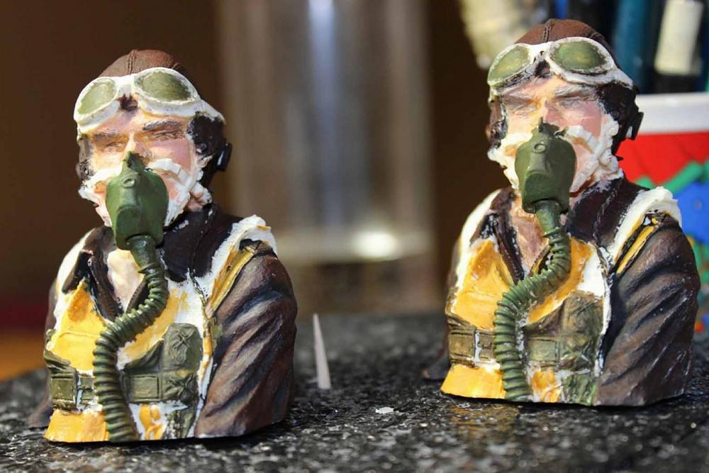

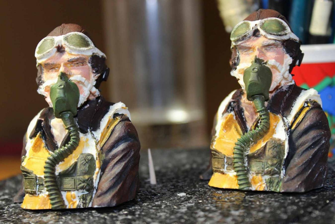

                                      the floor is made with tongue depressors and the throttle and flap controls are zip ties I bent into shape and painted the ends. Pilot got changed out as well. Click image for larger version  Name:	IMG_4422.JPG Views:	1 Size:	136.9 KB ID:	75444 chopped the original pilot and glued the new bust to the old lower torso, worked great!
