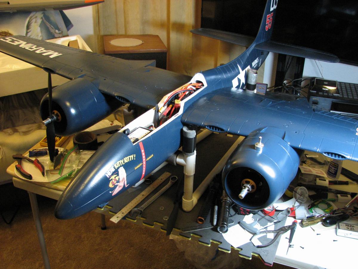

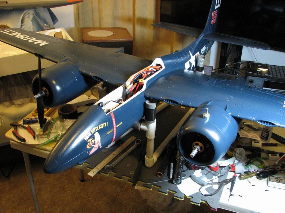

                                    • I finally maidened mine this morning, it flew well. I was surprised a little, not that it pitched up a little when I retracted the gear, but that I haven't seen that mentioned on the various sites. The dilema I think is going to be the delay built somehow into the retracts when I mix elevator to gear (assuming I can on Futaba 7C). Also the flight time was barely 5 minutes. I have only used the hi power motors. Admiral 4000's. Probably 60% mid throttle 40% full at most. Had 15.4 in both at landing. Balanced at 73mm. Flew like it was balanced well with the gear down, which is how I balanced it. Click image for larger version

                                      • Hi Rekit500, The High Performance setup (both the intended motor and intended 2B prop) consumes more, so 5 minutes sounds about right to 3.85. My HP setup in one of my Tigercats averages 6 minutes to 3.74 unloaded with my kind of mixed throttle.
                                        Regarding pitching up when the gear is retracted, others can weigh in here with their own experience, but my Tigercats don't do that. It seems peculiar that it noses up when the gear is going up (which is to say that they're moving forward... which if anything would shift the weight toward the nose and cause the model to nose down, not up as you've observed).
                                        Would you mind posting a photo of where you're measuring your 73mm? Just to double-check and compare with what others have been flying here.
                                        Happy Fourth!
                                        • I haven't noticed any nose up pitching on gear retraction of the three different FLRC Tigercats I've flown. All are stock setup.
