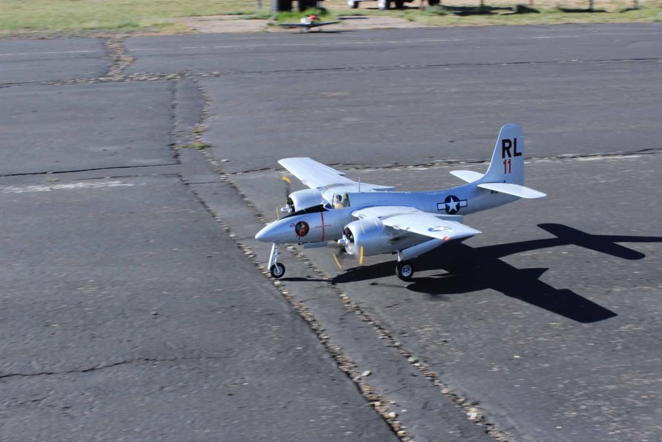

                  • XT-60 connectors replaced by T connectors, control throws set per instructions with the exception of down elevator mix ( went with crxmanpat's recommendations). Balanced with Admiral 3000's. the only thing left is to balance the props.
                    Hopefully we get a decent day here soon to take it out for the maiden. I was surprised how fast and easy this plane was to build! Motion RC and Flightline did an outstanding job! Thank you to all the people on this thread for all the information with set up and advice with flying the TC. You've helped me tremendously with this and the P-38!
                    • Gman..............those first 2 pics are SWEET
                      • I'm with CB on your pics Gman, excellent!!
                        Lon
                        Freewing A-10 80mm, F-86 80mm, F-15 90mm, Avanti. FMS DHC-2 Beaver, Fliteline P-38L ,HSD HME-262, HSD F86.
                          Hey CB, that was before we refinished the runway as well. That was pre Nefi when I had her up for the first couple of times. I believe that was the first landing with the full flap/elevator mix properly installed.
                          She's awaiting some upgrades this winter;)

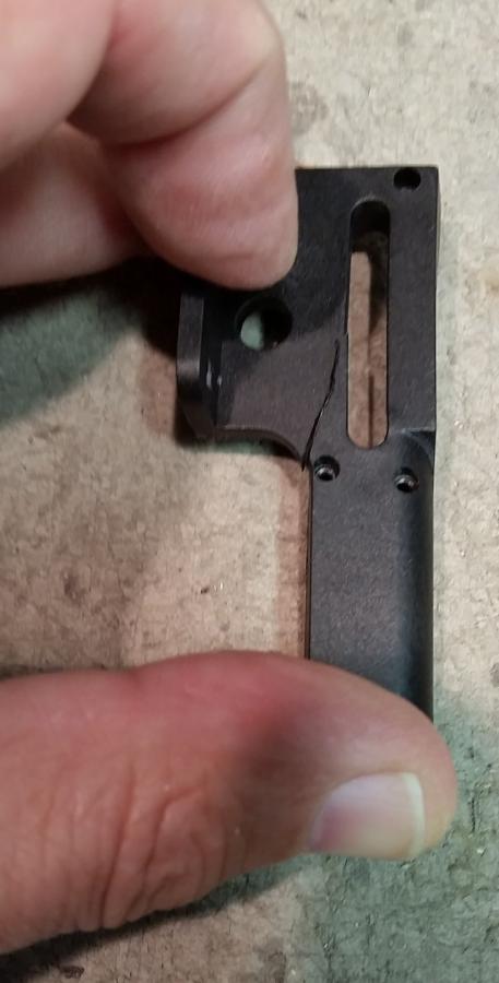

                            • I ran into a problem with the retracts... just normal wear and tear really. But I thought I'd share in case anyone else will see a similar issue.
                              About a month ago I had noticed that when retracting, the main gear would "stutter" as it came up. But they did come up OK. So anyway, last weekend I made a normal landing (full flaps, nice and easy) and the left main gear folded up upon touchdown in the grass. It looked pretty cool actually, except the prop blades didn't bend back like the real one would! One of the gear doors came off, but there was no other damage. Didn't even break a prop.
                              So upon inspection I found that I could move the main gear into the retracted position by hand, back and forth, it wouldn't lock and of course it's not normal to be able to move it by hand like that. Very strange.
                              I didn't discover what was going on until after I got it home and disassembled the retract. I found that the retract unit's plastic case had cracked open. All the mechanics inside were completely OK. The broken case allowed the metal trunnion to "move around" past the screw. The crack in the case was not visible during my first inspection because it's black and it didn't open up unless it was under pressure.
                              Understanding that these units have to absorb a lot of stress and shock during normal landings, I don't consider that this is a big problem. The replacement retract is only $15. (Yaaaay MRC) If it cost $40 then I would expect it to last longer, so I'm very happy with the service that the unit provided (I had a lot of flights this summer). I just thought others might like to be aware, if you notice something goofy going on you may have a hairline stress crack in the retract's plastic casing.
                              I haven't checked the other one yet but I'm going to replace both of them.

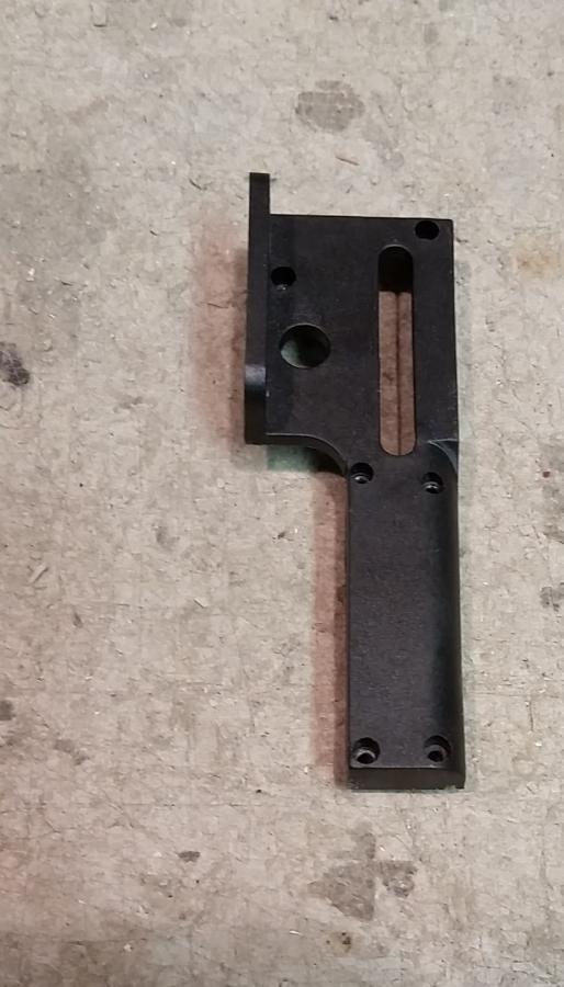

                                      • OK check it out. Here is the plastic case of the retract unit, its cracked but its really hard to see. Second picture is me flexing the case so the crack is much more obvious!
ID:	106461Click image for larger version
                                        • Good catch. Not where I expected. Hope it's just a one off and not endemic.
