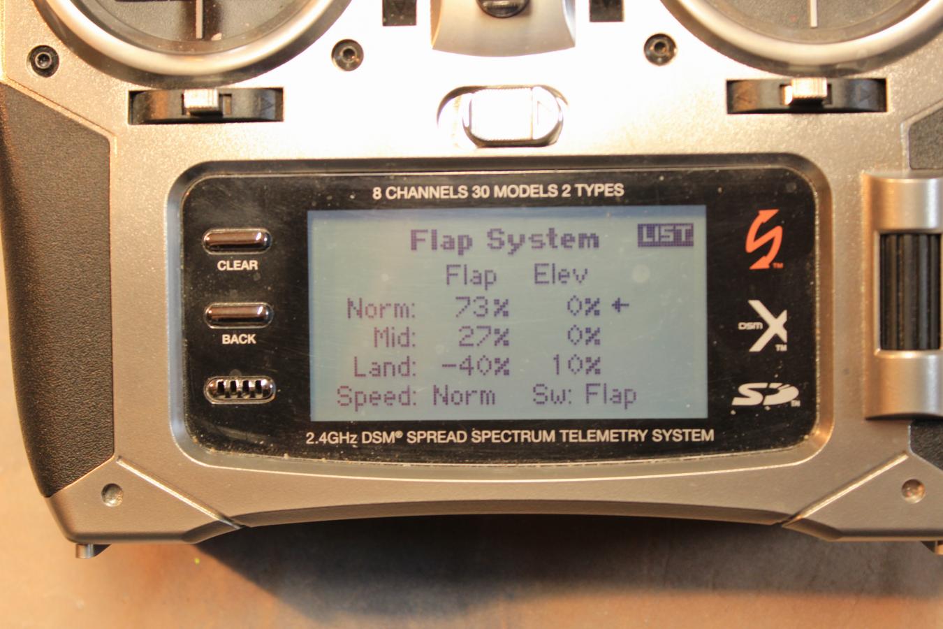

                Question for spektrum guys. I mixed up the flaps and elevator.The problem is the elevator snaps down and the flaps are set at a slower servo speed. I dont want the flaps snapping down and up because that just does not look cool and not scale. So, what happens is my elevator snaps down..my flaps are slowed down some..so I am yanking back to keep the nose up until my flaps finally lock down. Wondering if anyone knows how to slow down the elevator on the spektrum DX9 mixing?
                  That's strange. When I do the mix on my DX8G2 (and G1), the elevator moves at the same slow speed as the flaps. Something is amiss.
                  The other thing worth mentioning, if you have the flap deployment speed slow enough (3 seconds or more), you shouldn't need any elevator compensation. As you come in for landing and begin to deploy flaps, your speed should already be starting to decrease. From that point, a slow flap deployment shouldn't cause "ballooning" to any significant amount and what there is, happens slowly enough you can manually compensate till the speed drops even more. I've eliminated elevator compensation on almost all my planes by increasing the flap deployment time.

                      How are you mixing? I messed with the system settings and got to the flap menu but that just caused more grief than it was worth. I am pretty sure our software is pretty close to the same.

                        Hey Ben, here's how I have mine set, I just made sure that the wing type is correct, then set it like this....
                            In "wing type", do you have "1 AIL, 1 FLAP"? This is the first step. Otherwise, the flap switch (AUX1) just goes to default. Once you do the wing type selection, then you can go to the "flap system" and program from there. See Grossman's picture.

                                Dude I dont ever recall seeing that in my menu options. I will def have to look and mess with it more. Thanks Grossman, a picture is worth a thousand words. Man I am so stoked up about Rend Lake Warbird fly-in this coming weekend!

                                  Let me check. I did mess with the wing type and it caused me to lose gear, flaps went to half etc. Maybe I had it on the wrong setting. I will look at it this evening. I am going to start the decal work and airbrushing on it tonight. I got the come here kitty from Callie package
                                  If you lost gear, it's likely you did something in the port/switch assignment menu by accident. Flaps going to 1/2 just means something defaulted. Like I mentioned before, the flap switch always works and is defaulted to AUX1 but that doesn't mean they are "set up". See below for an explanation.
                                  Whenever you set up a plane for flaps, after selecting wing type, you must always re-zero the flaps so they are level with the wing when on the first position. Notice how on Grossman's picture, the percentages don't make sense? You must go into servo menu, flaps sub-trim and dial it as close as possible to level with all flap % at zero (so you don't over-drive the servos accidentally). Then start with position zero to get it more level if necessary. Then go to position 1 and dial in as much 1/2 (or take off) flaps as you want, then to position 2 and dial in full (landing) flaps.
                                  If you have never seen the menu page as in the picture, then you have not selected the correct settings to begin setting up the flaps. I'm not sure how you managed to get a delayed deployment without that menu page. It's likely you went directly to the Mix section, which is not the correct way to go when dialing in flap settings and elevator compensation. Doing it that way, you won't get a direct correlation between flaps and elevator compensation.
                                    You mix the Flaps and Elev via the Flap function menu and not the Mixing function menu in order to get the time(speed) control on both surfaces.
                                    On the Mixing function, speed only controls the primary(first designated control).

                                      Thanks everyone for the advice. Xviper good call on wing type. That was my first mistake. Grossman, your picture was the icing on the cake. It did look a little different in my menu, but was the same thing. Everything mixed, will fly it Friday to see how it does. Honestly though I have no need of flaps with this plane. It is one of the best flying planes yet, its still underpowered imo on the stock three blade set up, but now that I am up to the fifth flight on the new batteries there has been some performance improvement.

                                        Be, make sure you have the 'wing type' set for 'Wing: 1 ail 1 flap tail: normal"
                                        When you switch channels on a 1 Gen DX8
                                        Scroll down through the system setup menu to wing type, then scroll down to what I posted up above and select it.
                                        Go back up and go into main screen and it will take you to the , main screen, :Silly:
                                        Hit the scrill bar and go down to 'Flap System, select that and you'll get the screen I posted.
                                        Boy, did I go red faced when CB showed me that last year.:Sweating:
