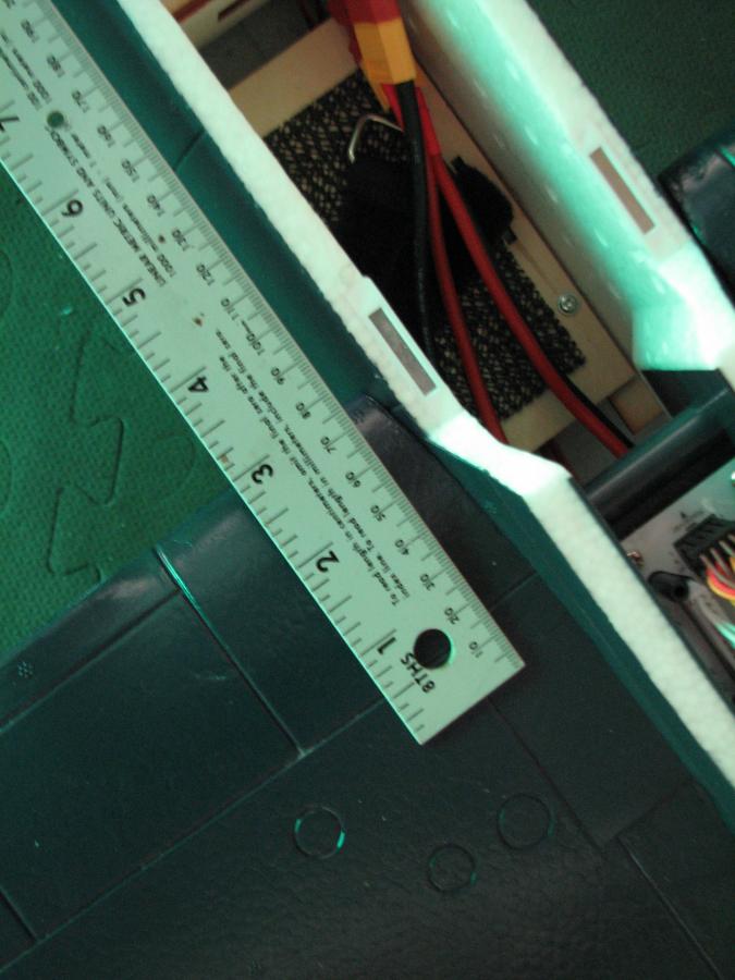

    Thanks all. I measure from the front of the wing at the root, next to fuselage, on the bottom of the wing. I must have a "special" 'cat cuz all my wheels go to the rear when they dissappear! That's why I wasn't surprised at the pitch up. Click image for larger version

      Rekit500, its true that the balance point will move back slightly when the gear comes up (as you said, the gear retracts rearwards) but its not a big deal. It can be a good thing. Setting the recommended balance point with the wheels down make the model slightly nose-heavy. That is a desirable thing during landing and takeoff, since the plane is somewhat more stable that way. It also helps when the flaps are down. With the gear up and the balance point shifted back a little, the plane is more maneuverable - which is exactly what you want for a fighter.
      The last thing Marine aviators needed when coming in for a landing was to deal with a tail-heavy airplane. We don't need that either!
      I'm just guessing, because you didn't mention whether you used flaps, but the flaps do cause the model to pitch up rather strongly. You'll need to trim the elevator down when deploying the flaps. My maiden flight (with takeoff flaps set, and elevator trimmed with too much "up") resulted in a wild takeoff that almost went vertical. When adjusted correctly for the flaps, it takes off normally and I haven't noticed any pitch-up when the gear retracts during any of my subsequent flights. Of course, I should note that when the gear is coming up, I am climbing out.....

            I've got it set pretty close now, just needed 5% up elevator when gear is down. That way I am running neutral elev with gear up. Does anyone know why or how the gear has the delay and how to get rid of it? I also don't see any need for flaps as it takes off in 30" feet w/o them and floats in. In the interest of longer flight times I'm going to unplug the 4 flap servos and the landing light, just to see. I know it won't be much different...but dang, I just get grooving and the timer starts harassing me. Next is to mix the rudder to ail and speed up the roll rate. I think this will mess up inverted flight a little, I may have to put that on a switch.
