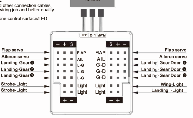

                Fairly new to this hobby but planing ahead I acquired a flightline spitfire mk4 now putting it together I'm pulling my hair out at the wiring. Have the little blue box and plugged in where it says it goes but the only 2 things that operate correctly is the elevator and prop. I'm using a spektrum AR8020T and a soektrum nx8+ but no matter what i do cant get flaps, alarons, landing gear to work and the rudder works but on wrong leaver lights are fine. I've gone into the reciver list on the transmitter and plugged everything in where it says yet I have this problem. I have tried swapping plugs round and all servos work fine just not where there supposed to. Maybe I'm just a fool and missing something obvious but im big enough to take been made fun off lol any help would be appreciated cheers

                  inchi41
                  Welcome to Hobby Squawk.
                  Glad to have you onboard, Sir.
                  Have you tried bypassing the "blue box" to see if it all works w/o it?
                  If so, then it would seem it is the BB and I'd contact Motion RC about the issue.
                  Honestly, I use the blue box for lights, MG door sequencing, etc, and plug Elevator, Ailerons, Rudder, Throttle, and Retracts into my RX.
                  Best, LB

                    Yes all the servos work I've shuffled all the plugs around and everything that supposed to move does just not all at the same time lol

                        First is it the 1.2 or 1.6? Different blue boxes.
                        I'd wager a user issue not a faulty box.

                          Ah, the good old blue box, here's the pic of the online manual that I rewrote for MRC a few years ago.
                          Click image for larger version  Name:	Blue box.png Views:	0 Size:	63.0 KB ID:	421231 The brown wires are the negatives. Basically, the blue box is a sub for 'Y' cords, so you only use it for ailerons flaps and landing gear (lights as well of course) plug the wires from your flap servo into the top two slots, as shown, brown wires out. Next ones are for the ailerons. Landing gear is cool in that you can plug them in the same as the flaps and ailerons and it will give you a scale retract, one coming up, then the other or you can plug both L/G wires into the left side (Landing Gear 1 and Landing Gear 2) and they will retract at the same time. (L/G3 being for a tail wheel retract but yours doesn't have that, the blue box is made for many different airplanes). Run your rudder and elevator directly to the receiver. I've seen some blue boxes that have slots for those as well, I believe in the Avanti?? You never know, they might have given you that version of the blue box. Also, make sure that the wires coming out of the blue box are in the right slots and the negative (brown or black) wire is oriented correctly. Ch1 - power Ch2 - 4 A, E, R. Ch5 - flaps, Ch6 - L/G.
                          Hopefully, that helps, if not I can pull the wing off one and double check for you.
                          Click image for larger version  Name:	20240512_185528.jpg Views:	0 Size:	153.5 KB ID:	421232 Click image for larger version  Name:	20220915_132635.jpg Views:	0 Size:	139.5 KB ID:	421233
                          (Dangerous Dan)

                            Cheers guys just ordered some y conectors so will try it again when they arrive and tripple check all connectors are in right then will keep my fingers crossed lol.
