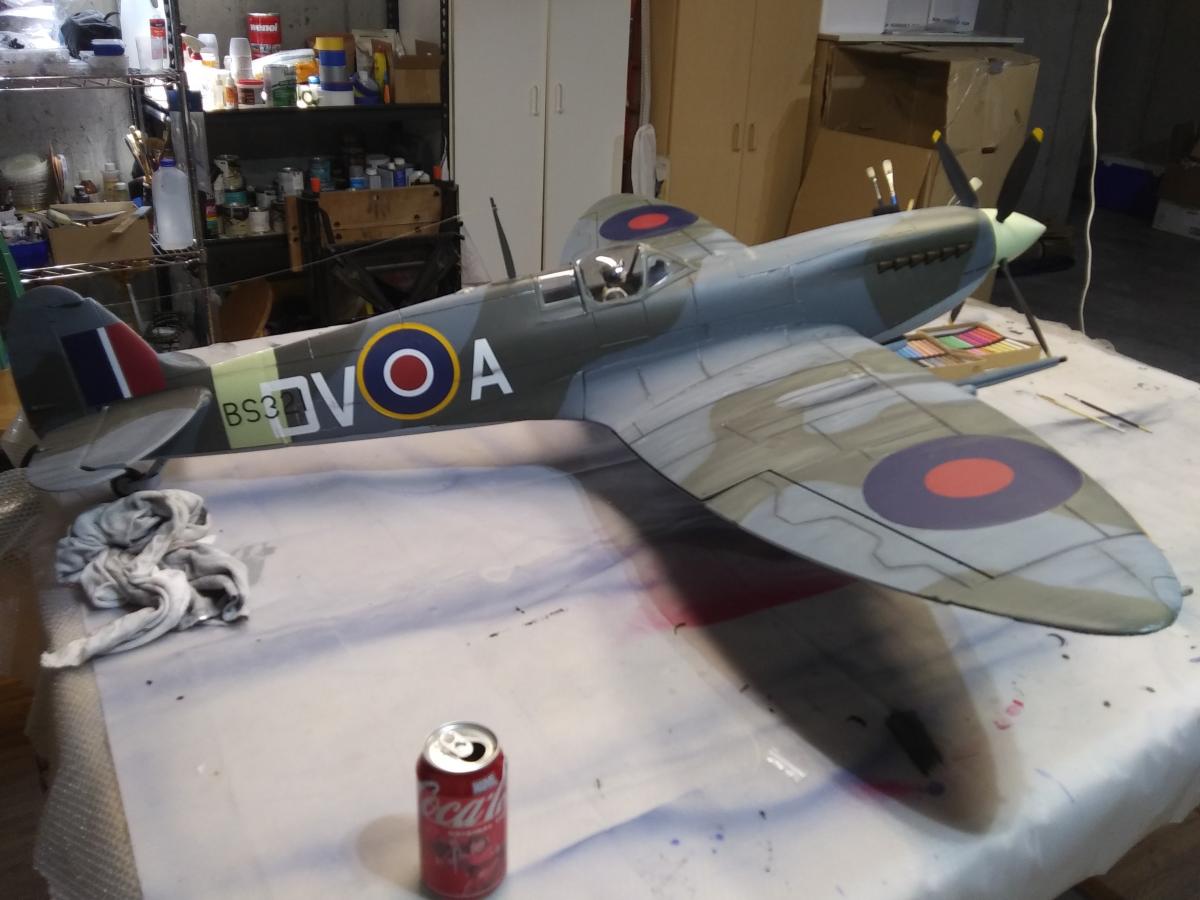

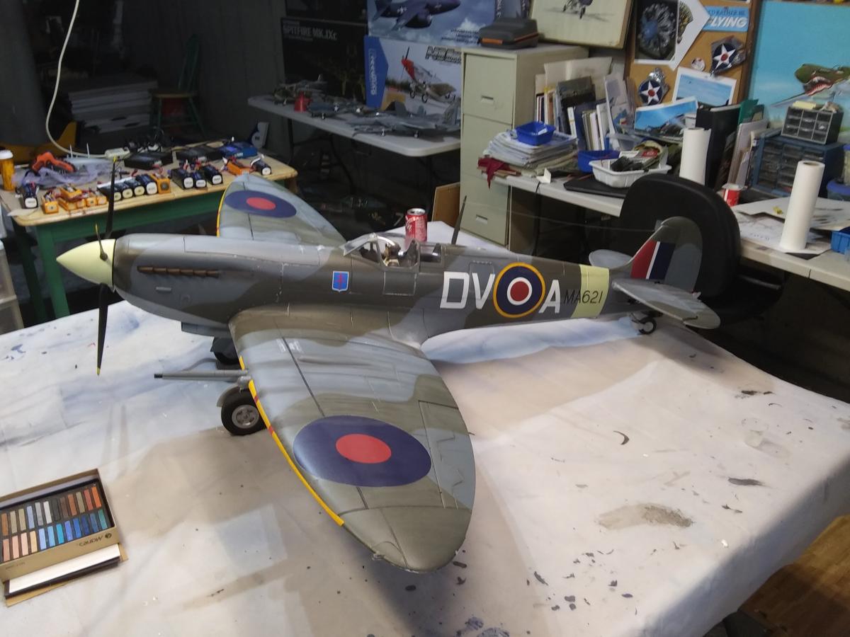

                  Got a set of chalk pastels for Dad's Day and so I got to work. They're pretty cool and surprisingly easy to work with. First couple of hours gave pretty good results...
                  Click image for larger version  Name:	20240616_154416.jpg Views:	0 Size:	110.1 KB ID:	405088 Click image for larger version  Name:	20240616_154425.jpg Views:	0 Size:	98.6 KB ID:	405089 Click image for larger version  Name:	20240616_154436.jpg Views:	0 Size:	95.1 KB ID:	405090
                  As an added bonus, they give a nice flat finish which is exactly what we all are looking for in a warbird.

                    :star::star::star::star::star: Beautiful work, Grossman56, Bravo Zulu, SIr. Best, LB

                      Using chalks is one of my favorite techniques for weathering warbirds. Yours looks great!!

                          Looks fantastic. The more you use the chalk the better you will like it

                            Of course the only problem is when you pick the airplane up, it comes off on your hands, so I happened to have a can of workable fixative that I use on my pencil drawings to stop just that from happening. Applied it and it works quite well, a great tool for layering too.

                                Hey Dave. The fixative didn't remove anything and leaves a nice flat finish, dries in seconds and does no harm to the foam

                                      Local art store, Hobby Lobby, Opus (in Canada) Most of these places have it or something similar. I also have the Krylon version available on Amazon. Try it on an old wing or spare part if unsure, but she worked great on the Spitfire. Keeps the weathering and minimizes the loss when handling. It's designed for artists working in graphite, chalk or charcoal. What it does is allows the artist to preserve the work done up to that point so it's not being smudged while adding a top layer. You can erase through it (hence the 'workable' part of the name) but it takes more than erasing an untreated surface would. It's a godsend for charcoal, if you've ever worked in it, it's the definition of messy.
                                      I used to use cheap hairspray between layers, but this is better (of course, what wouldn't be?)
                                      I think that one is as good as the other as far as brand names go. I can't remember whether I've used the Krylon on an airplane, but I don't have any problem trying it, again, try an old piece first.

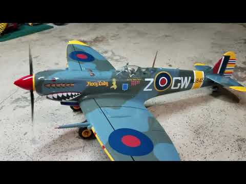

                                        #3679
                                        This aircraft is so good , I’ve just ordered another one from MRC as a spare in case Flightline stop producing them and I end up without one or unable to get spares.
                                        Of all my RC aircraft, this one gets more favourable comments from watchers than any of them.
                                          • 7359
                                          #3680
                                          I agree, there are a couple of head turners in my fleet, one is my first Spitfire, painted as 'AI-A' which was Skippers airplane in the movie The Battle of Britain. It was actually a Mk IX painted to resemble a Mk IIa
