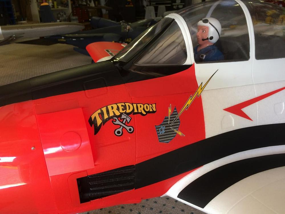

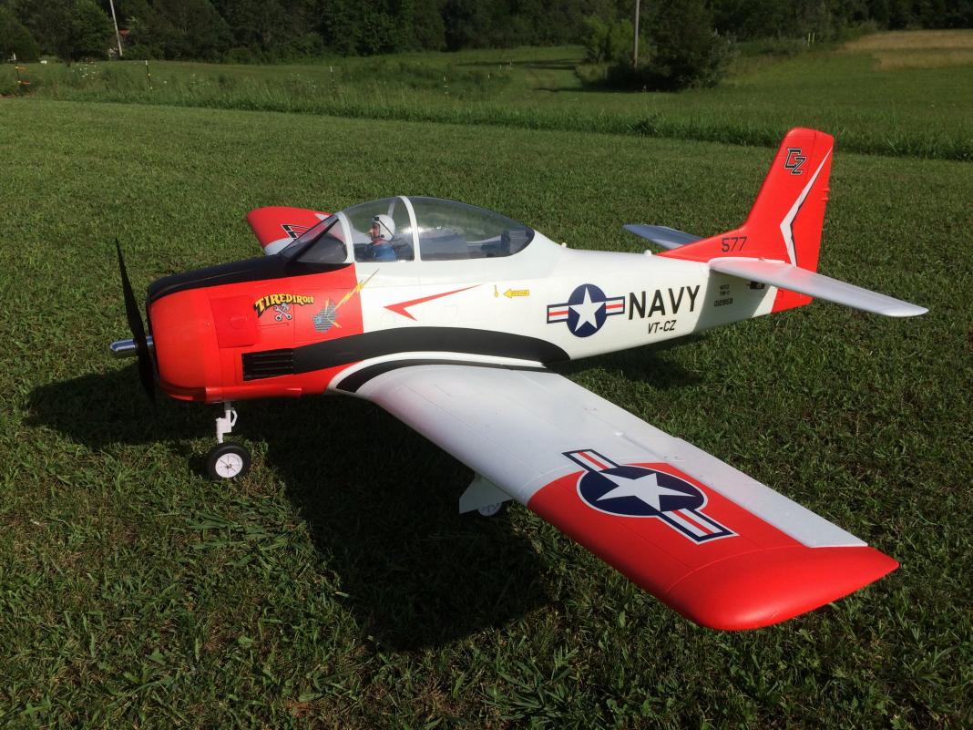

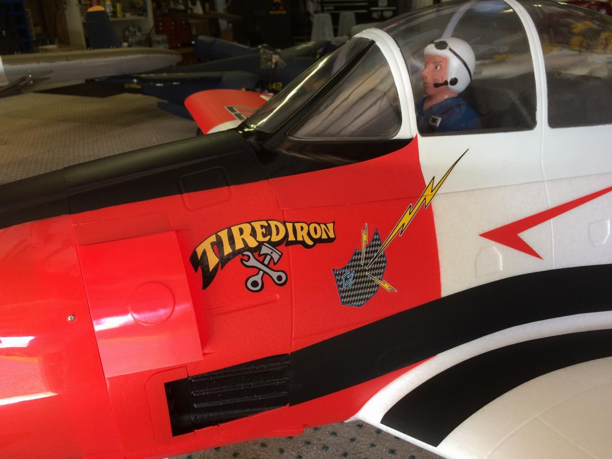

    I've been wanting one of these for a while and finally popped on one and all I can say is WOW! I love this plane, I've put 10 flights on it today including the maiden and every flight has been great, smooth straight takeoffs and fluffy, martini on the dash landings. With full flaps you can park it in the sky and come back and get it later, half flaps are perfect for landing.
    Did I mention I love this plane :)
