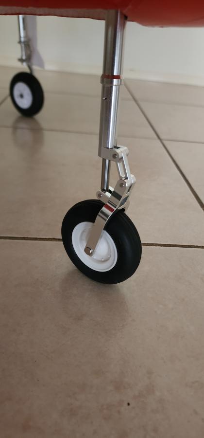

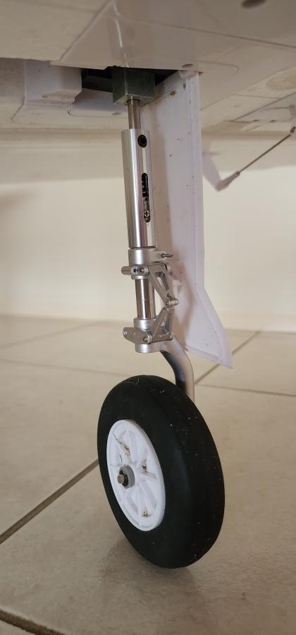

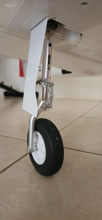

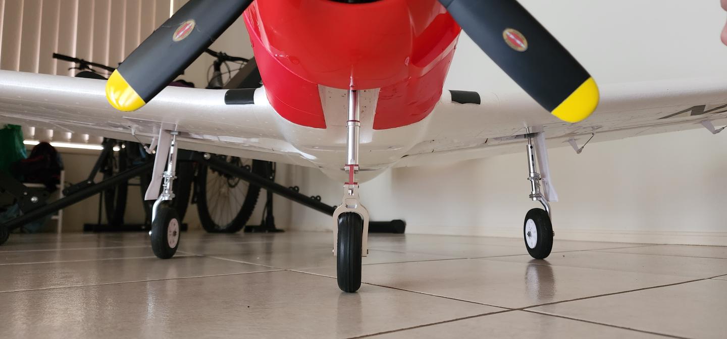

                                    Any chance you could provide further detail into the work you did and provide more photos? You say you used Freewing Spitfire struts but I found them to be too short and would require a very long connecting pin. What was your method with that? And could you show the fitment of the nose gear strut and the setup of the gear doors and servos. I see you also have added lights to the plane, did you use a lighting module of some sort and how does this work for the nose gear light?
                                    AT the moment I am using FMS 1.7m P-51D main struts with longer pins and a Freewing A-10 80mm nose strut (trailing arm option part). This setup does seem to work quite well but I am not able to refit the original doors to the mains legs and I have not yet come up with a nose gear door solution. I was considering using a spring for the front doors instead of servos. Like some planes have for the tail wheel doors. Would be nice to seal up that gaping nose wheel bay for flight.
                                    Here is a photo of my retracts upgraded.
                                    Click image for larger version  Name:	20221105_122650.jpg Views:	0 Size:	83.3 KB ID:	361115Click image for larger version  Name:	20221103_134930.jpg Views:	0 Size:	28.7 KB ID:	361116Click image for larger version  Name:	20221103_134918.jpg Views:	0 Size:	27.6 KB ID:	361117Click image for larger version  Name:	20221105_115401.jpg Views:	0 Size:	26.9 KB ID:	361118

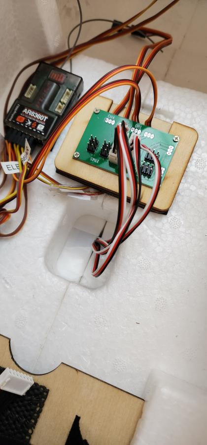

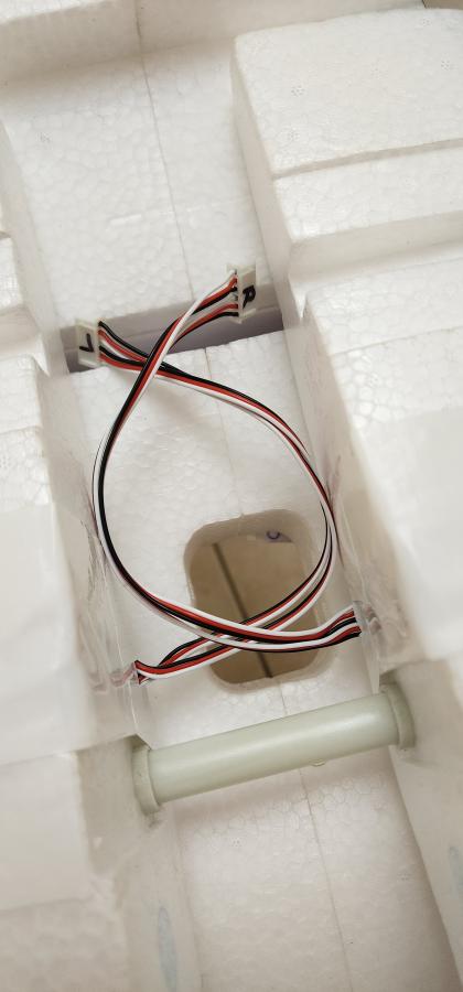

                                      Tidied up the wing wiring by fitting a Multi connector board. So much better setup now instead of the horrible wiring mess it was previously..
                                      Such a cheap and easy mod to do I highly recommend it.

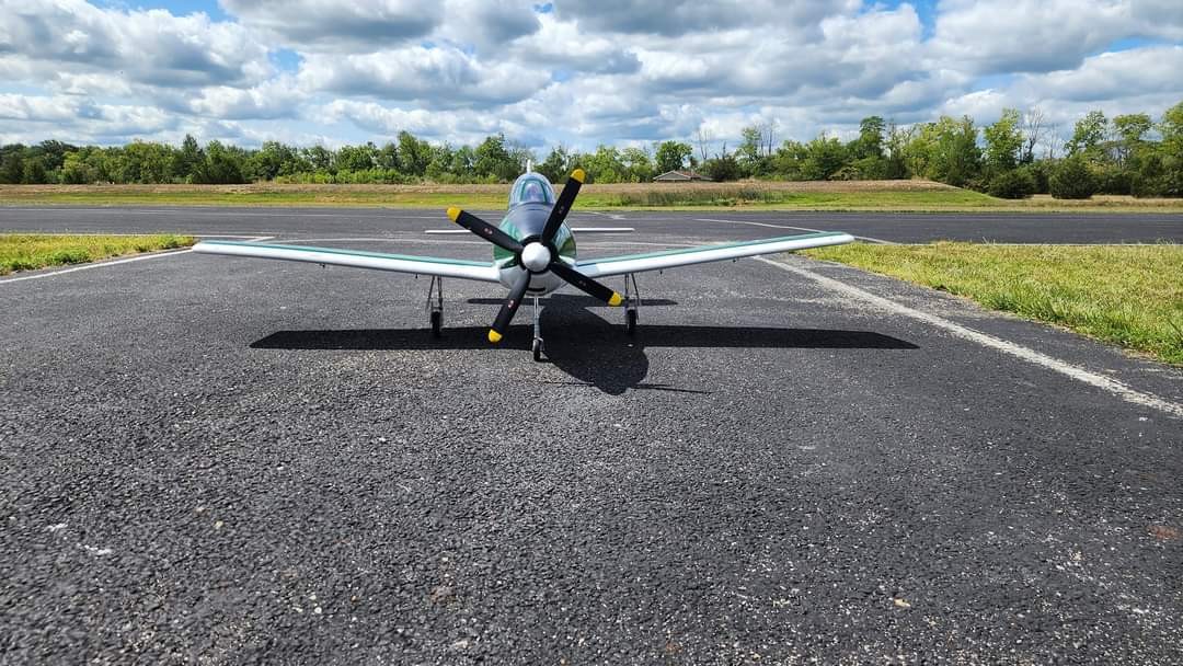

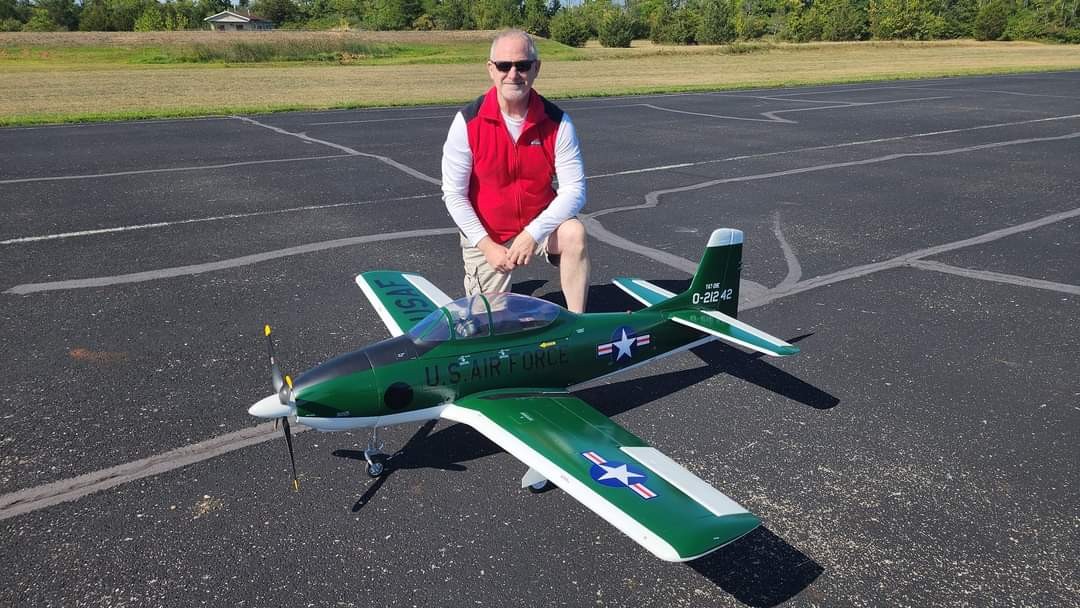

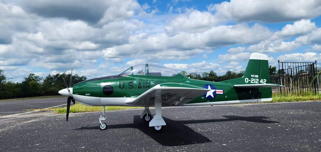

                                        Click image for larger version  Name:	FB_IMG_1723507411936.jpg Views:	4 Size:	112.0 KB ID:	408896 Click image for larger version  Name:	FB_IMG_1723507427548.jpg Views:	0 Size:	225.4 KB ID:	408897 Click image for larger version  Name:	FB_IMG_1723507384610.jpg Views:	0 Size:	187.9 KB ID:	408900 ​​​​​
                                        I decided to head back to 1963 for my motivation.. Built and test flown in good old Columbus Ohio at the North American aviation facility, this bird is just Cool. Looking. The following are the mods performed on my carbon ZT28:
                                        Upgrade the mains to FMS P47 struts, FMS f7F nose gear strut, 3D printed cowl and spinner, FMS predator 360 KV motor, 100 amp ESC, with FMS Corsair four-bladed prop,. Since this was version 1, I upgraded the retracts with the JP controller after pulling out the stock circuit boards.
                                        Sunday came along for its maiden flight and flew just like it was supposed to! Nothing different with the longer nose and four bladed prop.
                                        Very happy!
