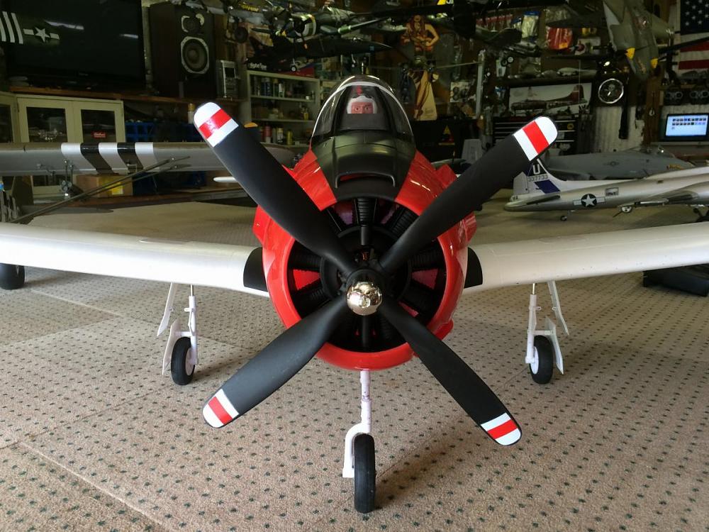

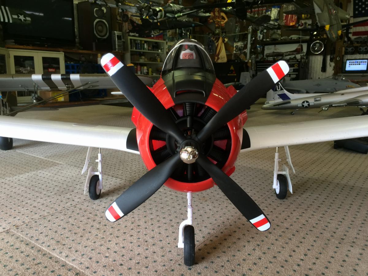

                Almost done with the garage incinerator rebuild (see update at post #68) so it is now time to start getting busy with my modeling again.
                So I picked up one of these CZ T-28's used from a member of TJ's club a couple weeks ago in preparation of having a large bird for his clubs Festival of Giants.
                Got it for about 1/3 of it's original retail price which meant it needed some TLC to my expectations. :smirk:
                Gave it a SEA Camo facelift and did my power plant upgrade magic on it.
                It now has an 85A Opto ESC with a 10A ZTW UBEC set for 5.5V with a Scorpion Backup Guard.
                The motor is an FMS 5060-360kV motor (from my Seagull A-1 Skyraider lost in the NEFI Triangle 3 years ago) turning the Flight Line 1600 Corsair 18 inch prop.
                OHHHHH mama............. 78Ap and 1597Wp at full tilt boogie throttle. Can't wait till next week to put it thru it's paces at the Festival.

                        Just a follow up to my power mod of this bird noted in post #89.
                        It got it's maiden last Thurs at the Festival of Giants event hosted by TwoWingTJ's club.
                        It is my second time for this event and it is a 3 day event that is spectacular. A great event that could show off some of the Black Horse line of birds.
                        We did a swarm of 5 CZ T-28's (my SAE Camo, an AF Academy and 3 stk VT-CZ) several times over the 3 day event which the spectators enjoyed.
                        The power mod really impressed the other 4 pilots that had the stock power plant.
                        I was running about 75% on the throttle to their full bore and that 3 blade had no issues with ground clearance
                        I'm back in the modeling saddle again.:star_struck:

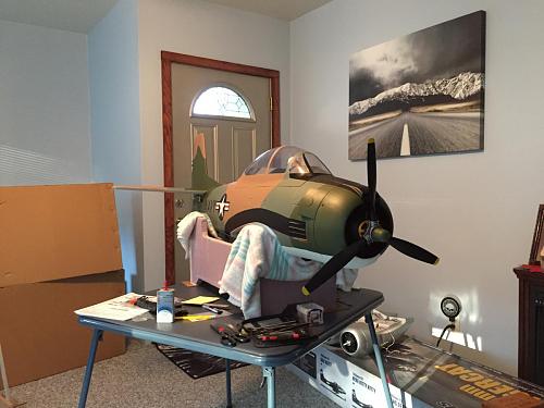

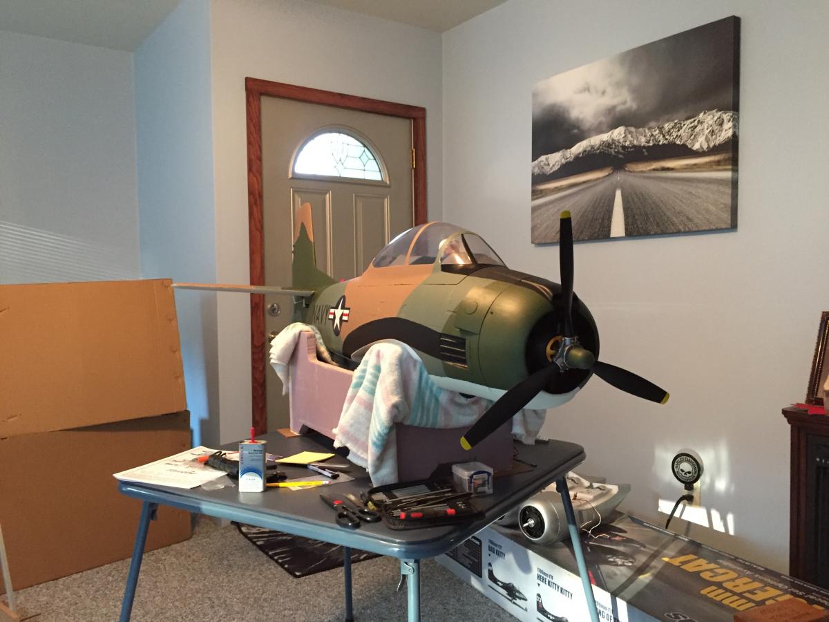

                                Met a guy at Paradise Valley on the weekend that has the FMS version. Now I didn't get to see him fly, but he said it was giving him problems control-wise. He had an A3L in his for some reason, so I don't know whether he had it set up correctly or what. The FL version definitely does NOT need a gyro and I would venture to say that the FMS version doesn't as well. Chime in on you're opinion.
                                BTW, got the nacelle swapped out on mine after the replacement nacelle's firewall kept breaking loose. So, ironically, she now has her original nacelle back on as I think I managed to fix that one and the Avanti now has her original fuse and nose back on, after I smucked her up... A testament to my growing repair skills??
                                Anyway, still looking for some advice on how to remove the ring cowling on the nacelle so I can repair the spare.
