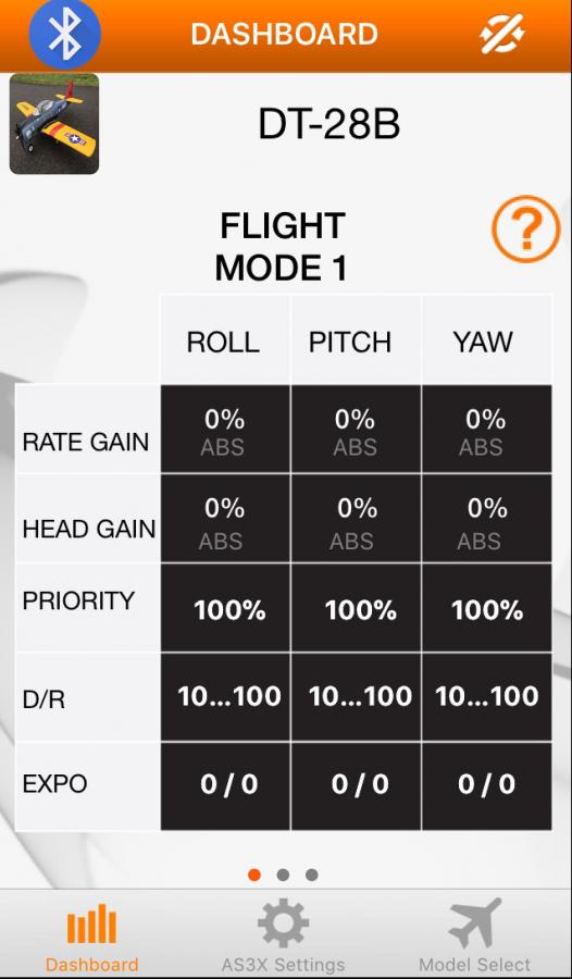

      I do have a question on the as3x settings, for anyone who had the opportunity to look at the parameters. I know the systems are not the same, but I would like an idea on where I should start with my frsky s8r receiver. I would like to be close to the as3x program as I can be.

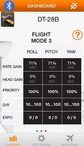

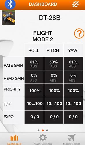

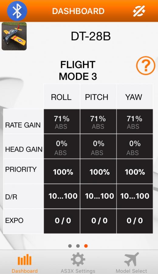

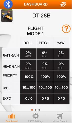

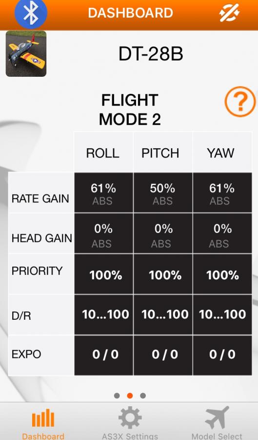

        #43
        All AR636A, key here being the “A” at the end, receivers are preprogrammed and having ruined one already by trying to alter its parameters, I won’t even try to install one in the AS3X program anymore.
        Spektrum is also silent on the parameters they use. To try and build knowledge on how to program AS3X, I have installed AR636’s in some of my airplanes. One of them is my old PZ T-28.
        I have three flight mode’s set, 1 is off, 2 is middle of the road gain, and three would be the high end. I was not finished experimenting with this when winter set in. That said, anytime you see oscillation in flight, back off on the gain.
        It turns out that most of these planes actually come with an extremely capable $80 Spektrum AR636A Sport receiver, and it can be reprogrammed using just a smartphone and a special programming cable…

          #44
          It seems to me that most AS3X receivers have too much yaw gain from the factory.
            #45
            Yeah I've seen that too from time to time as well. And thank you for the gain info, I will use it for a start point
              #46
              I got those settings in
