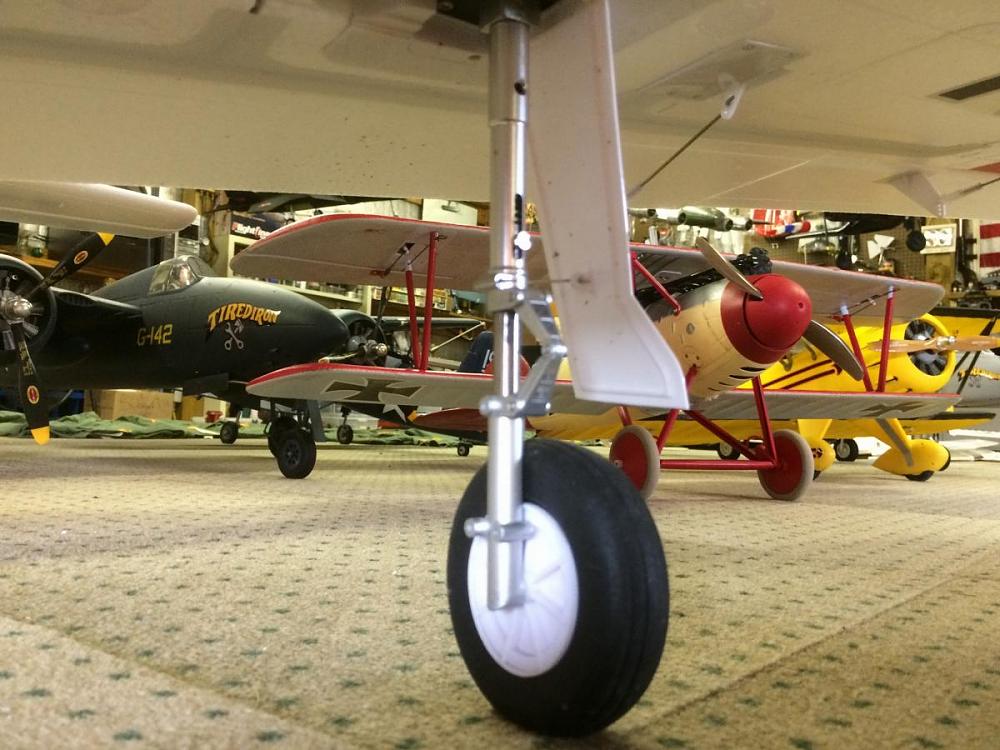

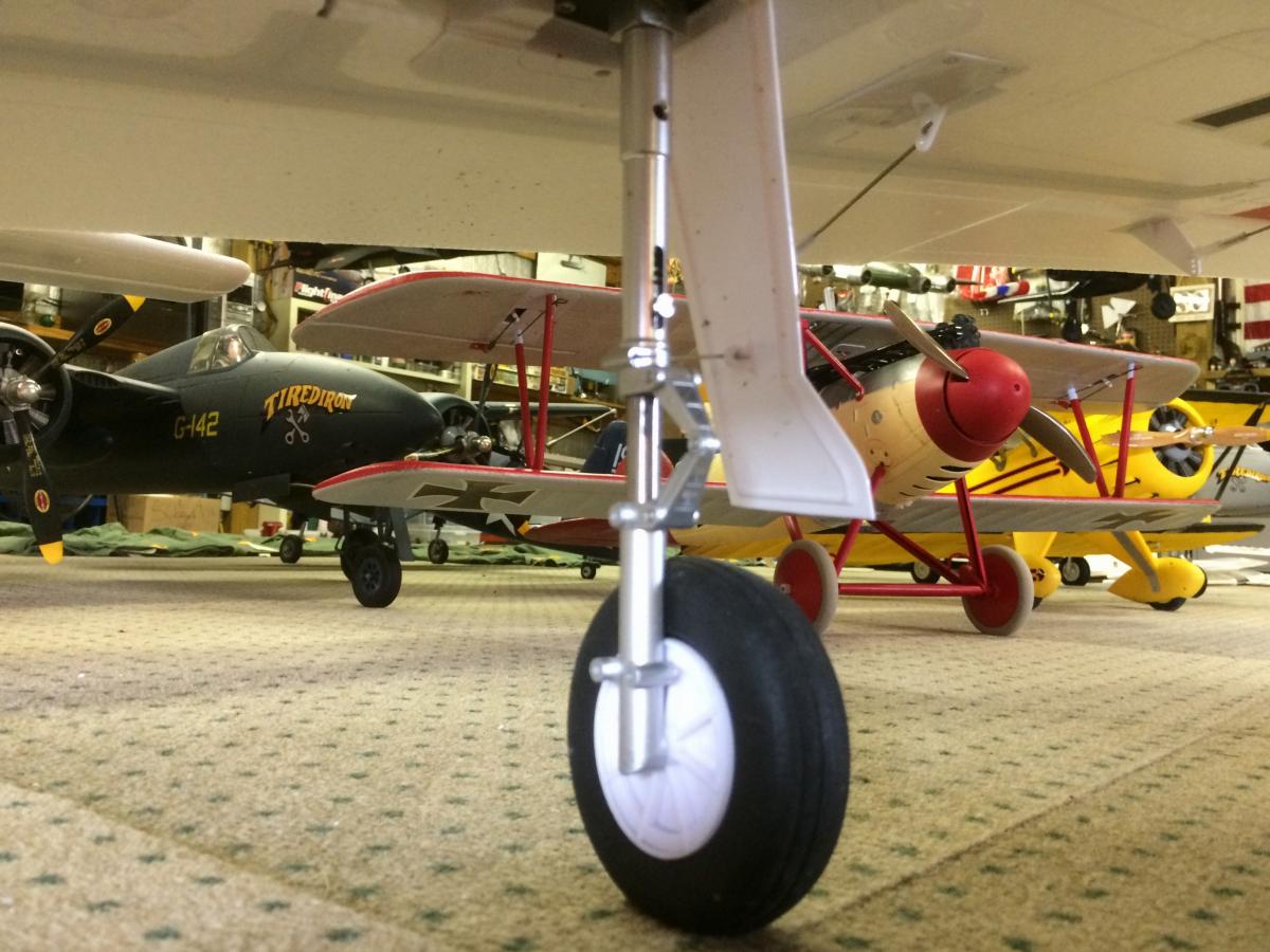

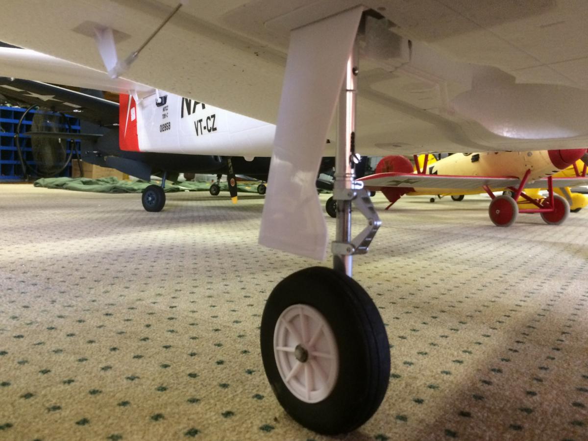

      I used struts for a FMS 1500mm P-47 and used the stock T-28 wheels but had to take the tires off and sand the sides of the wheels down so they would fit on the axle, I used a sheet of 280 wet/dry laying on a smooth flat surface and just sanded down the hub till it was flush with the wheel.
      I didn't use the lower gear door cover (they grab grass anyway) but I used the top one and just made new wires to connect it to the strut. The pins that go in the retract need the flats re-cut to center the strut/wheel assembly. I have a Freewing 80mm A-10 nose gear I plan to use as well.

          Hi TiredlronGRB,
          did you use the full P47 main gear system(including Servo) or just the struts?
          • #25
            They look fantastic, would work well on the grass field I fly off as it is a bit rough.

                  Just the struts.
