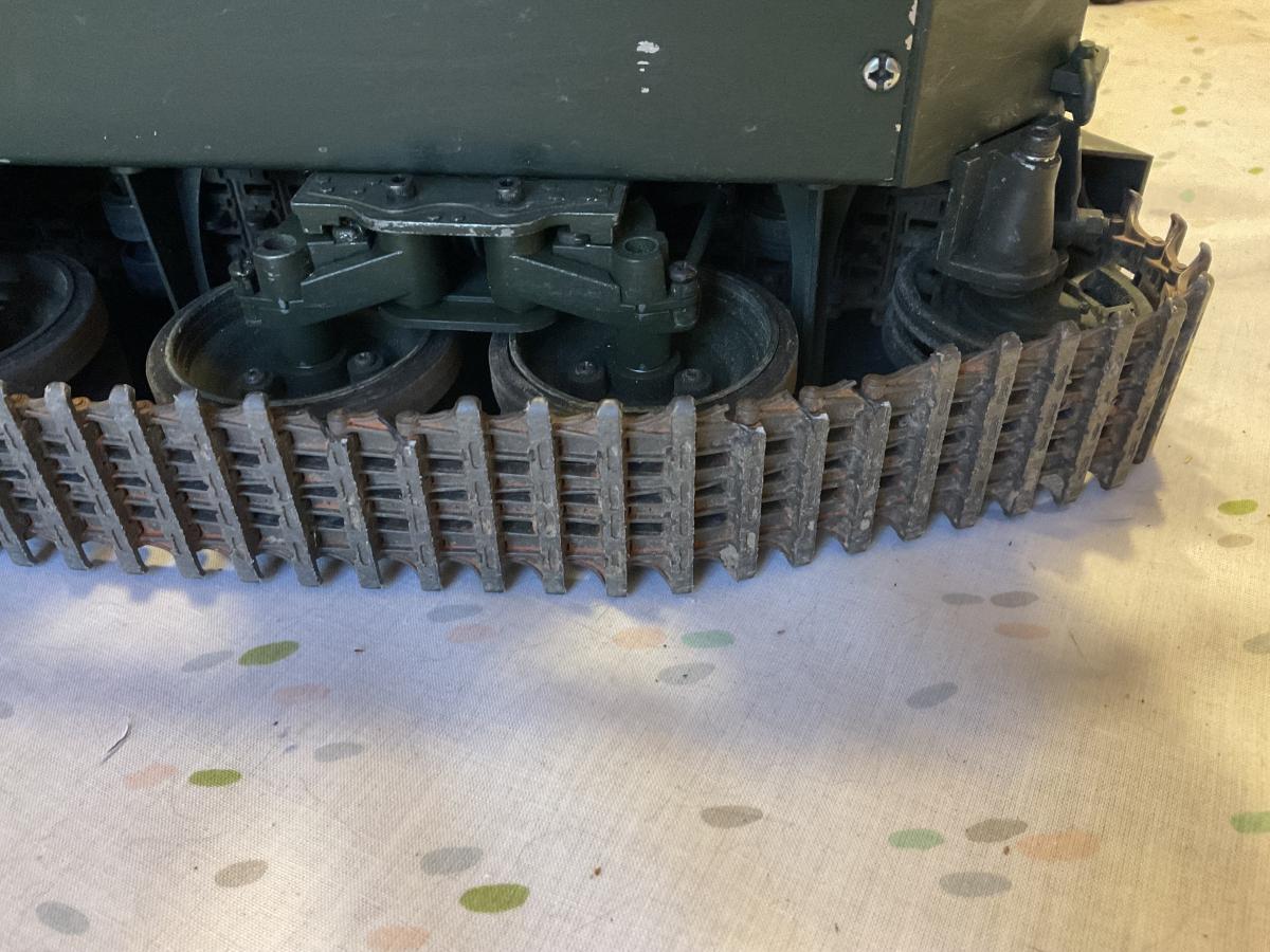

                      Those are the original tamiya plastic track. I considered getting metal but have refrained for a few reasons. 1. The damage doesn't interfere with the track working. 2. If the track extensions didnt break, where would the force go and what might break instead? Better a broken track extension than a stripped gear. 3. The real track sometimes fails like this as well, though not as often. Consider it weathering!
                        This is way I went back to Tamiya track vs the DKLM metal track. Not only worried about the gears but the idler attachment arms. The little locking "wing" on the arm just gives me pause to how much force it can take before stripping out.
                        On another note Just out of curiosity have you tried swapping the Haya tracks onto the Tamiya or vice ver-as? It is suspected that the DKLM metal tracks are actually Haya tracks off one of the pre production runs for the Haya tank. Might be interested to prove or disprove this should the track be or not be interchangeable.
                        For those that don't know what the Tamiya idler arm locking "wing" looks like. Yes that little tiny line on the arm is all that holds it.

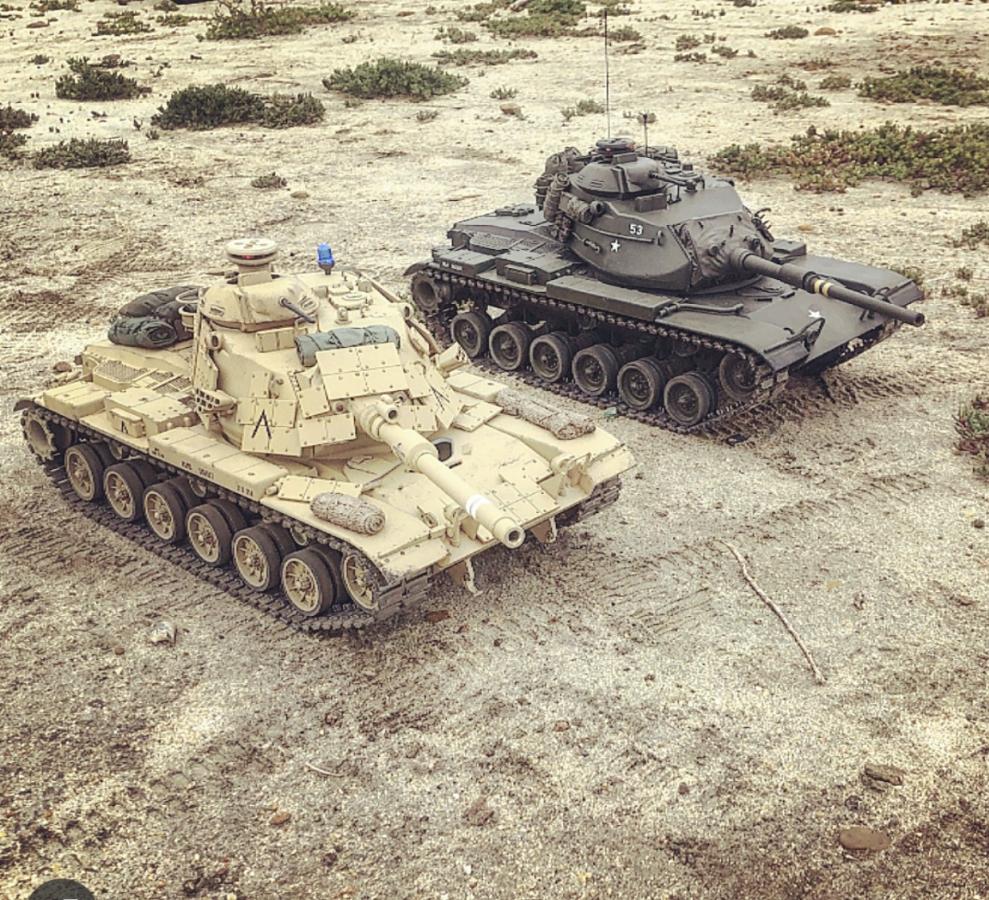

                                      M60 troop fun run at the San Diego tank clubs April 2023 meet. It's not all battles sometimes it's just about a game of follow the leader. Video is up on my Instagram @ fsttanks
                                      Click image for larger version  Name:	535F5AED-CAC3-43A2-88FB-1001E4D1C004.jpg Views:	0 Size:	204.6 KB ID:	376539Click image for larger version  Name:	C71582E8-FDFD-48B7-AC18-29042105A407.jpg Views:	0 Size:	223.7 KB ID:	376534Click image for larger version  Name:	A223489A-543D-44B9-9637-D8B2DCD64A14.jpg Views:	0 Size:	253.2 KB ID:	376535Click image for larger version  Name:	87A8907A-A603-4241-8DAD-C49ADA1EE552.jpg Views:	0 Size:	421.0 KB ID:	376538Click image for larger version  Name:	34940003-FB25-4D4B-AB7F-FDE492832134.jpg Views:	0 Size:	418.3 KB ID:	376537Click image for larger version  Name:	9A684D5D-2FF0-46FA-9678-E0326858964A.jpg Views:	0 Size:	483.8 KB ID:	376536
