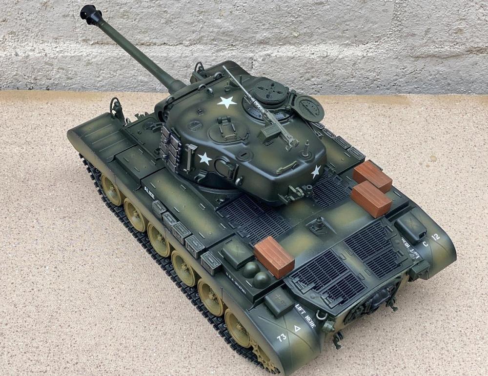

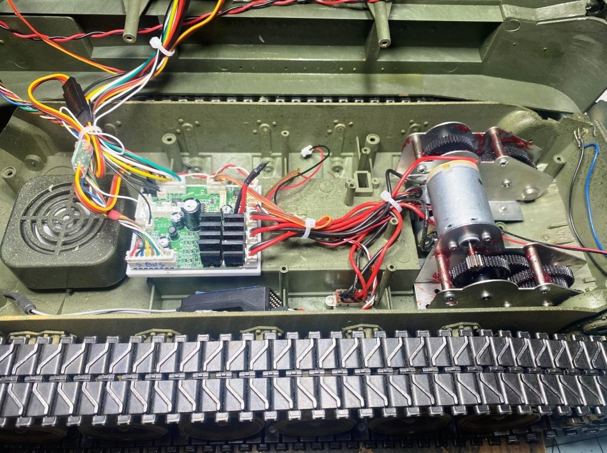

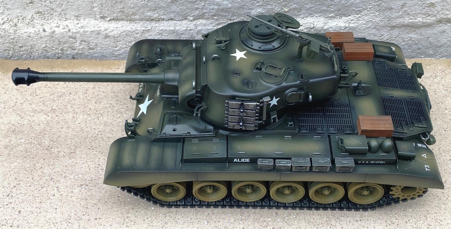

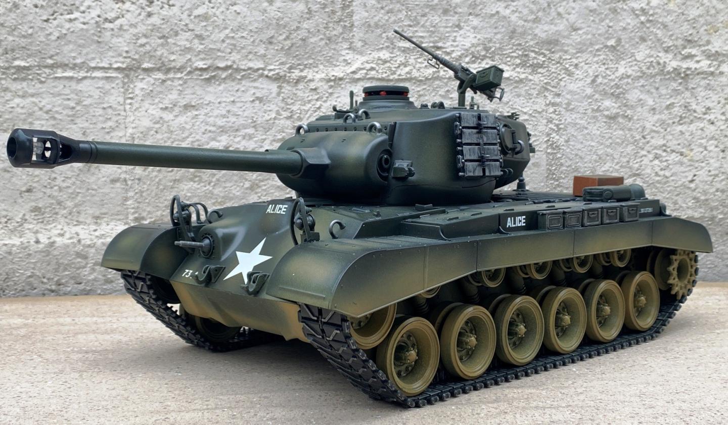

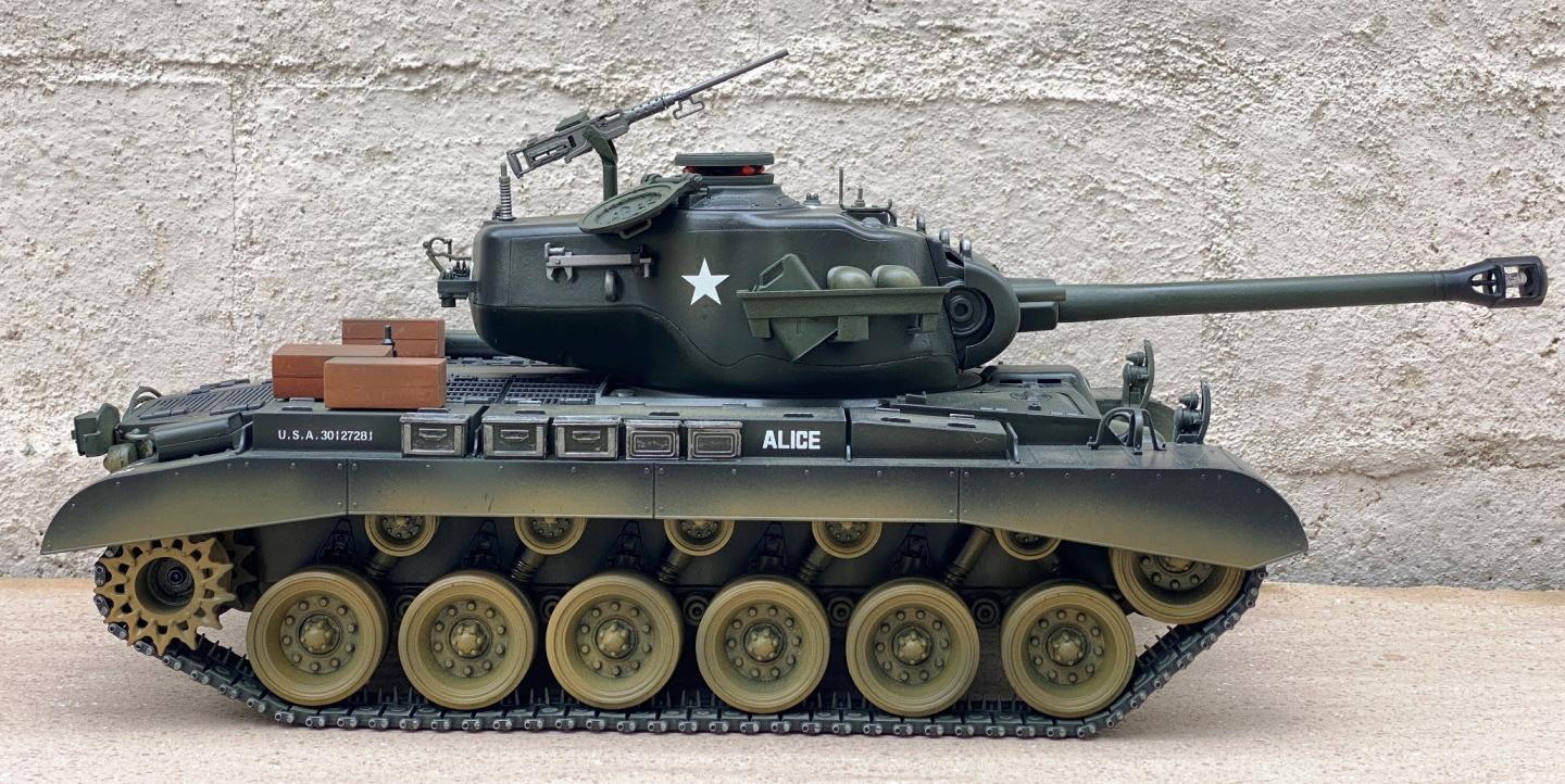

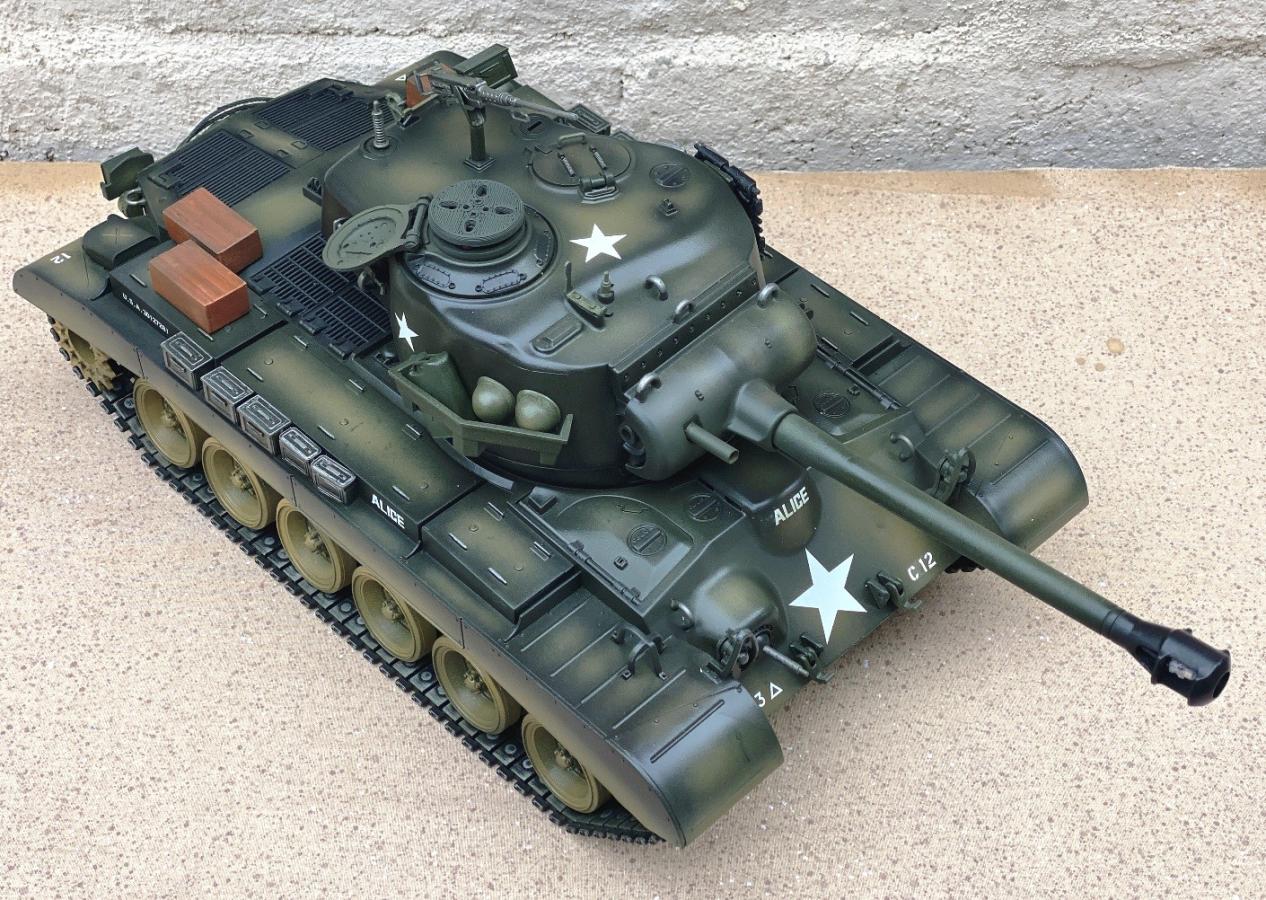

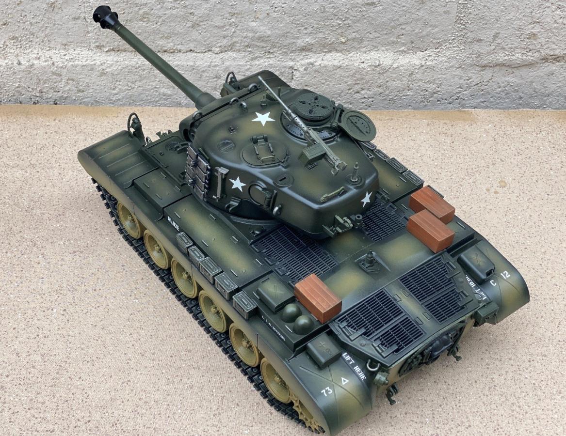

          I found a rare Taigen M26. I took me a whole day to rip out its "guts" and replaced with the Clark's board, recoil barrel unit, barrel elevation motor, barrel muzzle flash, metal gearboxes, DAK IR receiver and the powerful IR emitter. I kept the barrel short so I can battle with it easier. I had extra decals from my Tamiya M26 so I used them on this beast.​
ID:	432735 Click image for larger version
ID:	432736 Click image for larger version
ID:	432737 Click image for larger version
ID:	432738 Click image for larger version

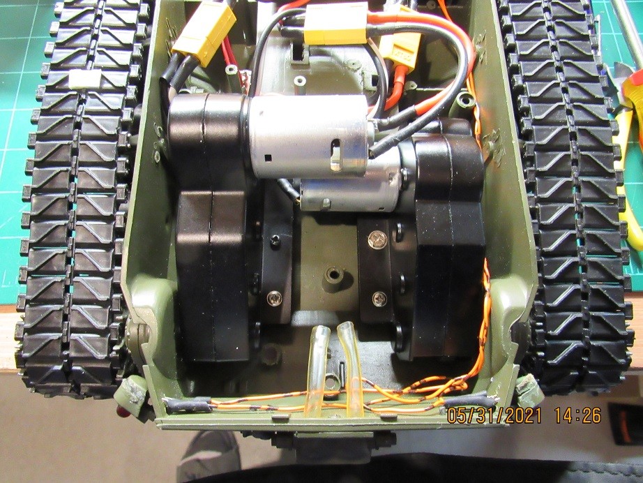

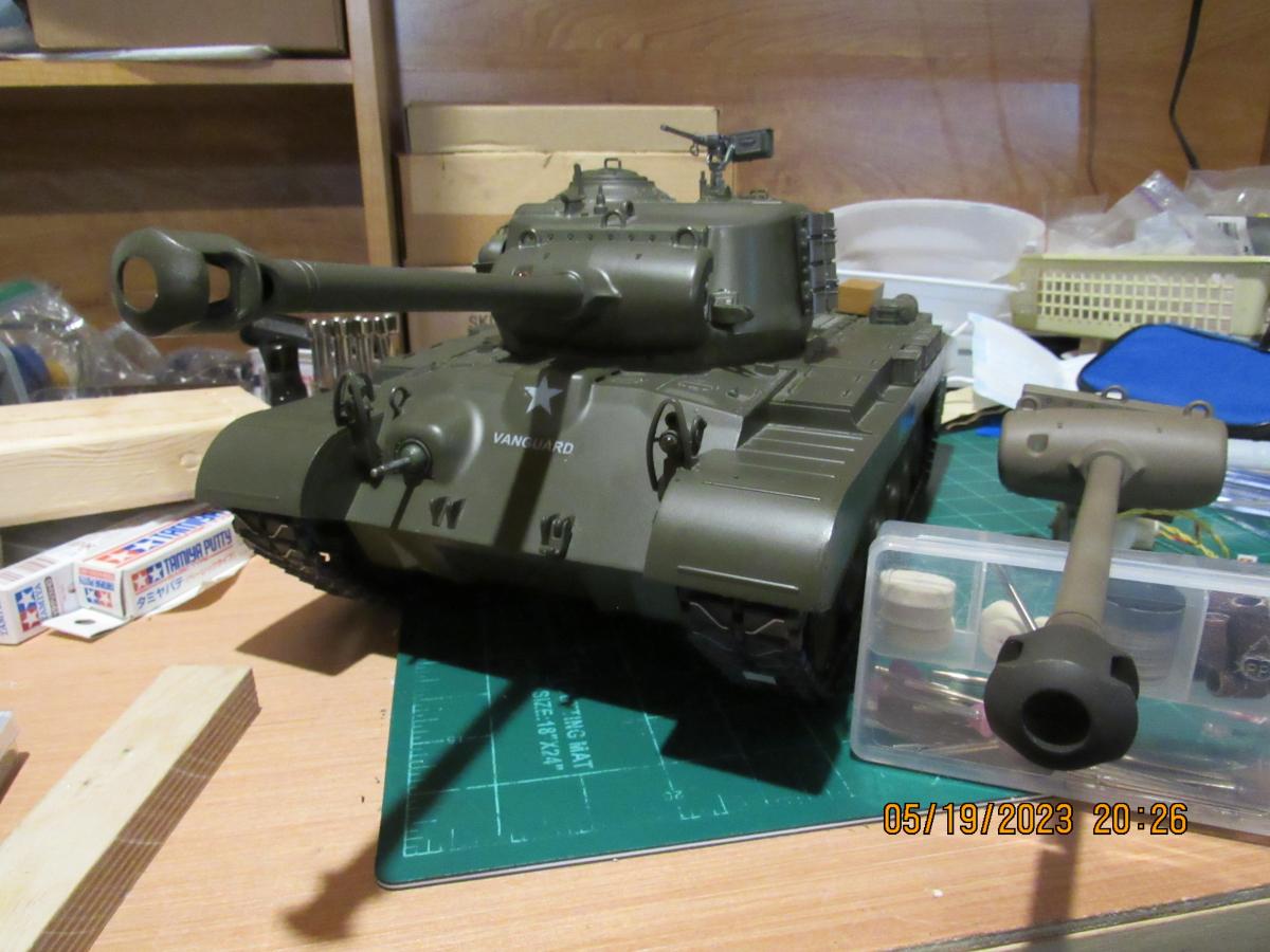

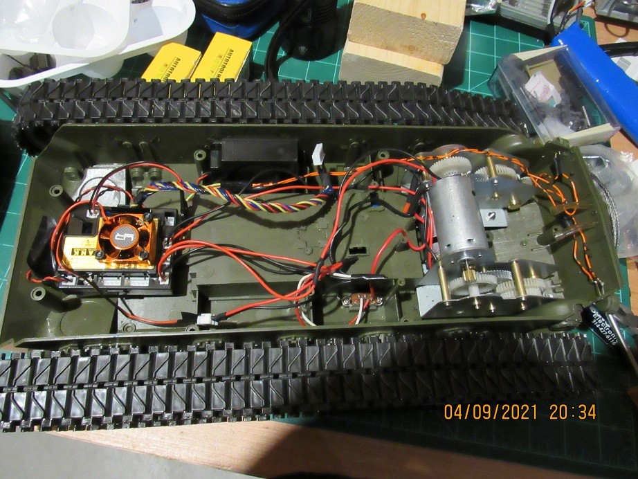

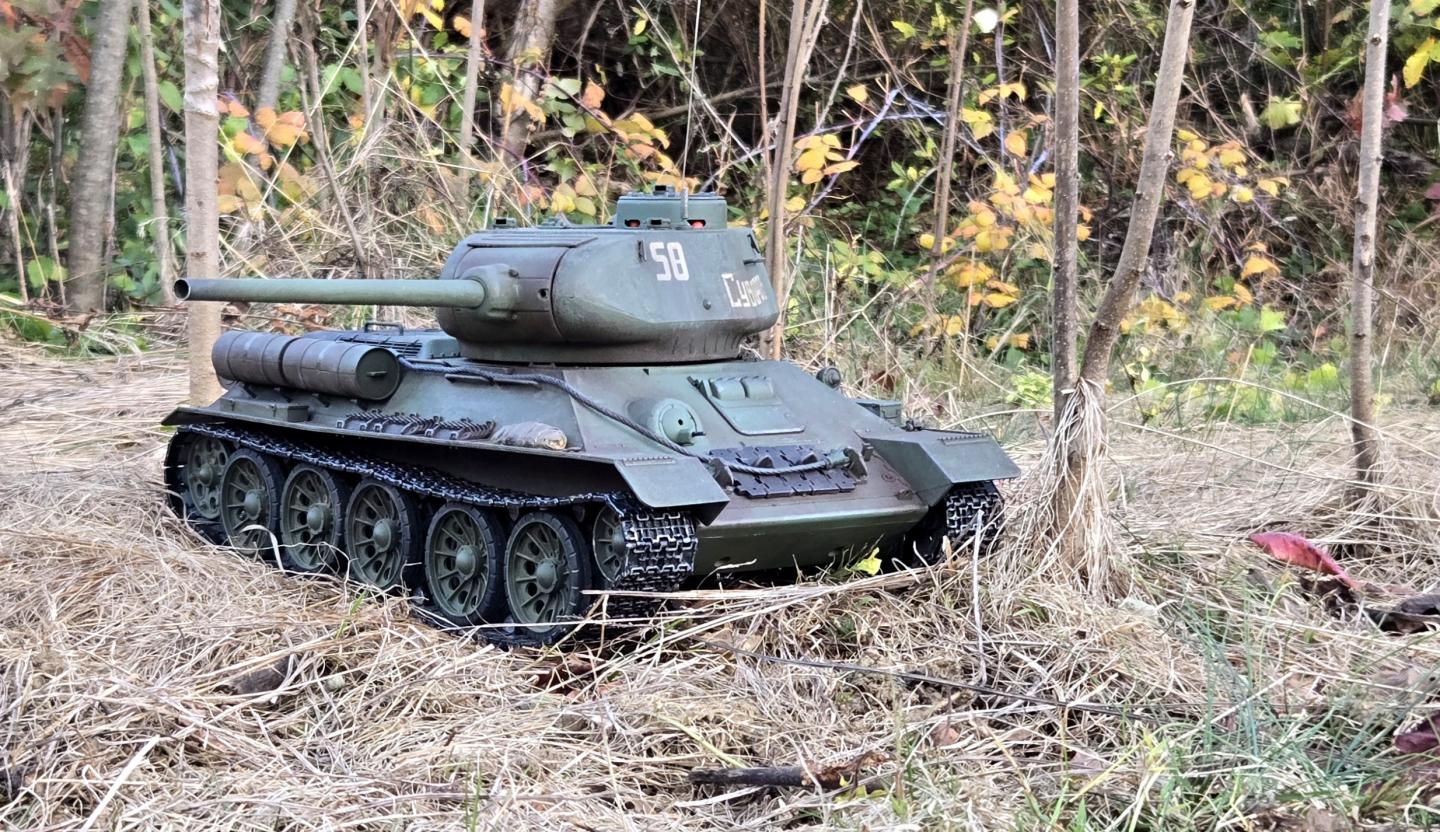

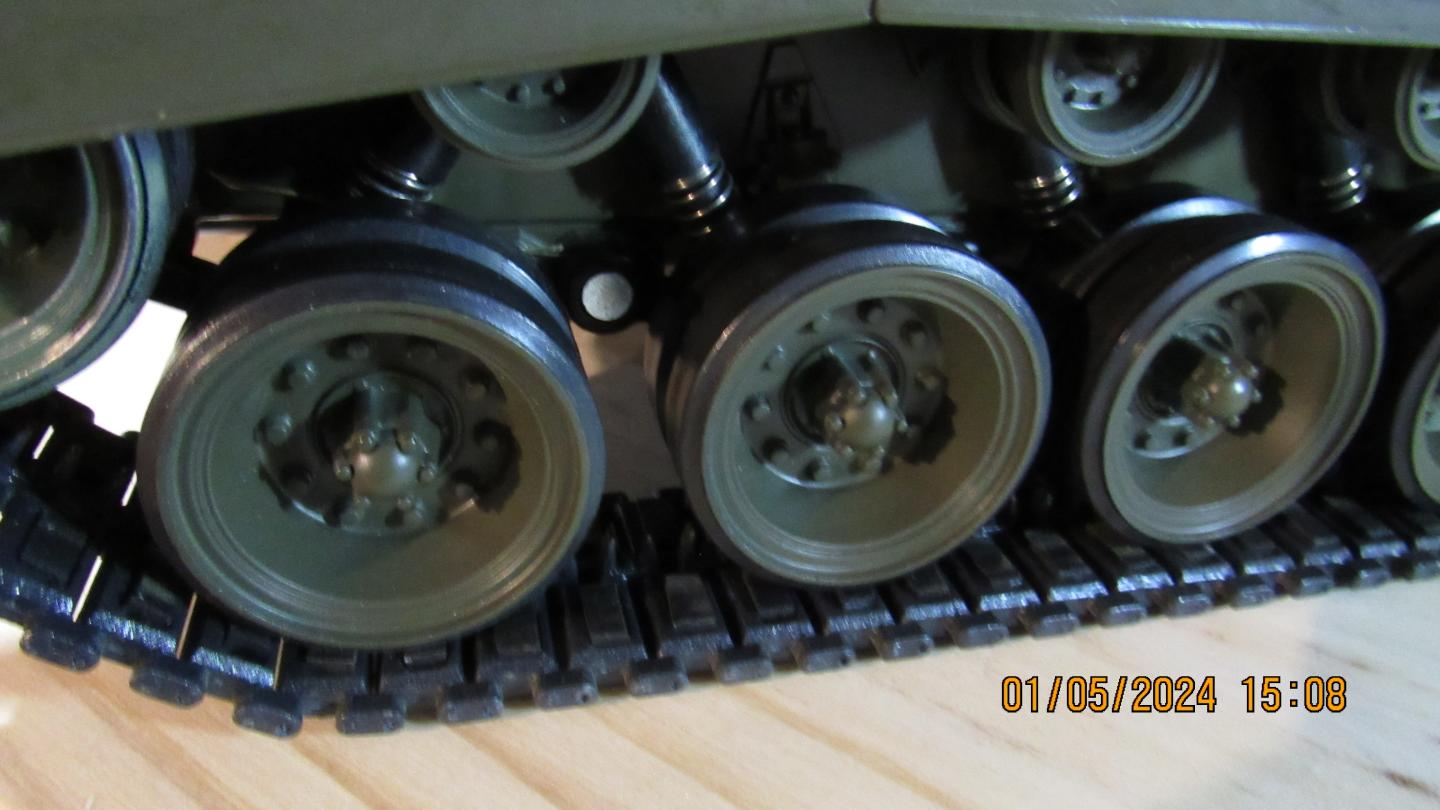

            I will love to see the inside of your refined Taigen M26. I have a 2005 Heng Long Snow Leopard that is 20% Taigen with the Taigen Gen2 metal gearbox.
            The original HL M26 came with plastic gearbox and a short barrel. I made several upgrade of the radio and ended up with the HL 2.4GHz 6.0S.
Name:	IMG_4959 - Copy.jpg

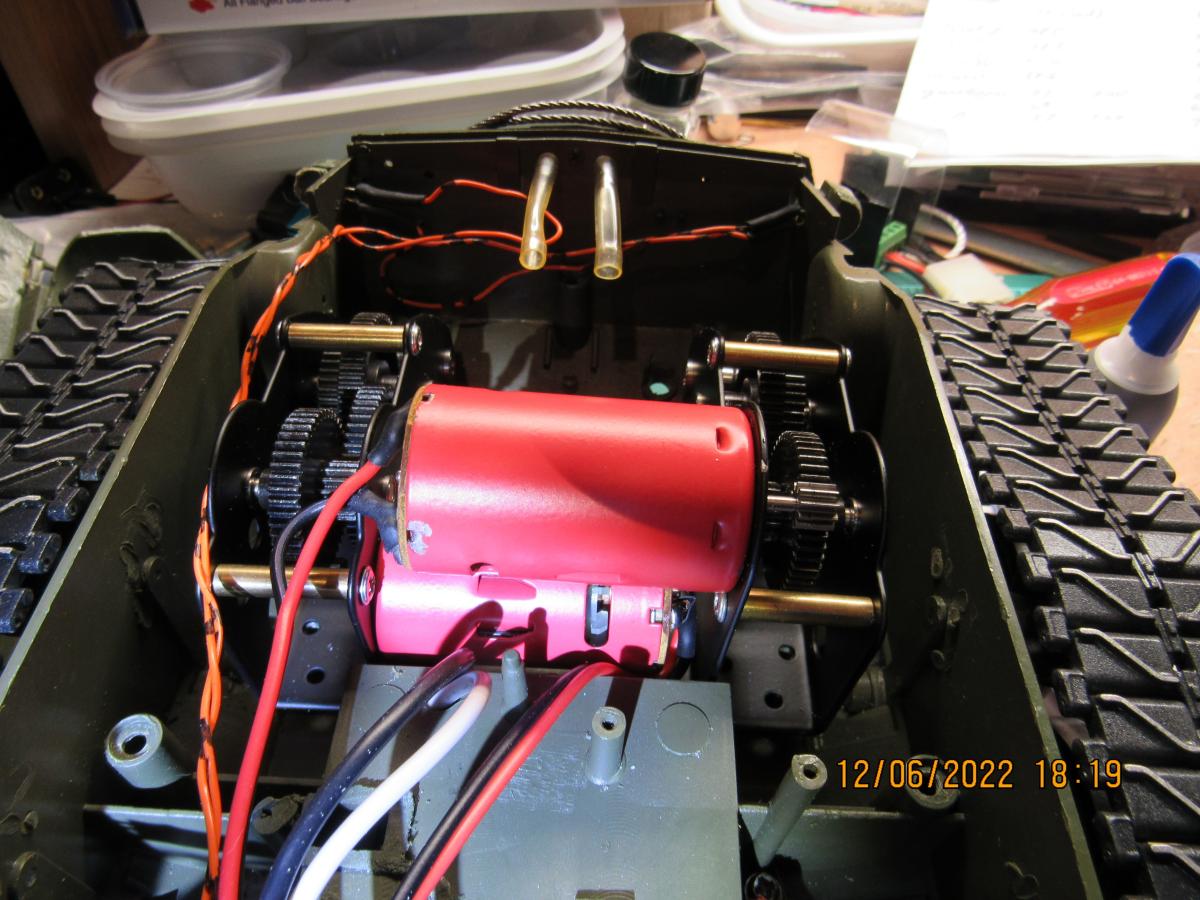

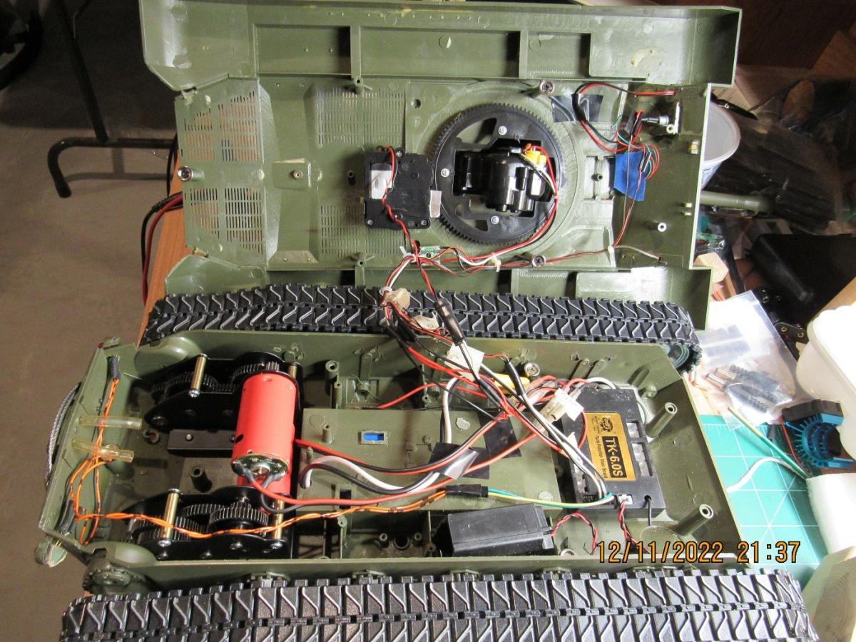

            I upgraded the gearbox to Heng Xin steel gearbox. The mounting approach of Heng Xin limited it to 380 motor. I ran it for about year and want it to run faster than the 26 mph scale speed. The Taigen Gen2 metal gearbox allows me to pair it with the 390 motor. The resultant 40 mph scale speed is too fast for the M26. But it is fun and you will need the metal tracks.
Name:	IMG_5009 - Copy.jpg
ID:	432761 Click image for larger version
Name:	IMG_5123 - Copy - Copy.jpg
ID:	432766 Click image for larger version
Name:	IMG_5130 - Copy.jpg
ID:	432765 Click image for larger version
ID:	432768 Click image for larger version

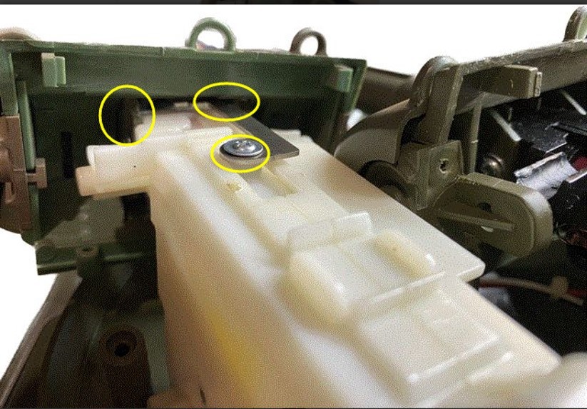

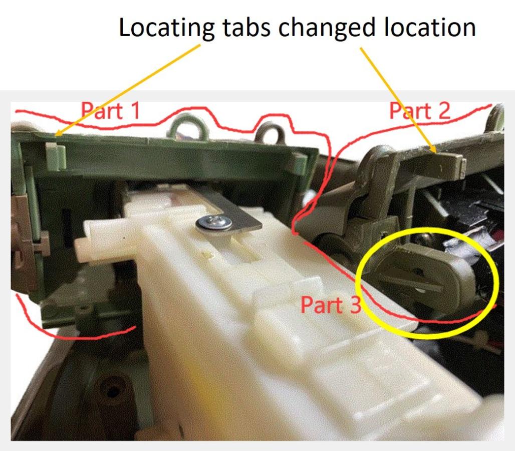

            I added barrel recoil using the HL recoil unit that comes with the long barrel. I like the look of it.
Name:	removebarrel - Copy.jpg
ID:	432762 Click image for larger version
Name:	recoil_cannon - Copy.jpg
ID:	432764 Click image for larger version
Name:	IMG_5167 - Copy.jpg

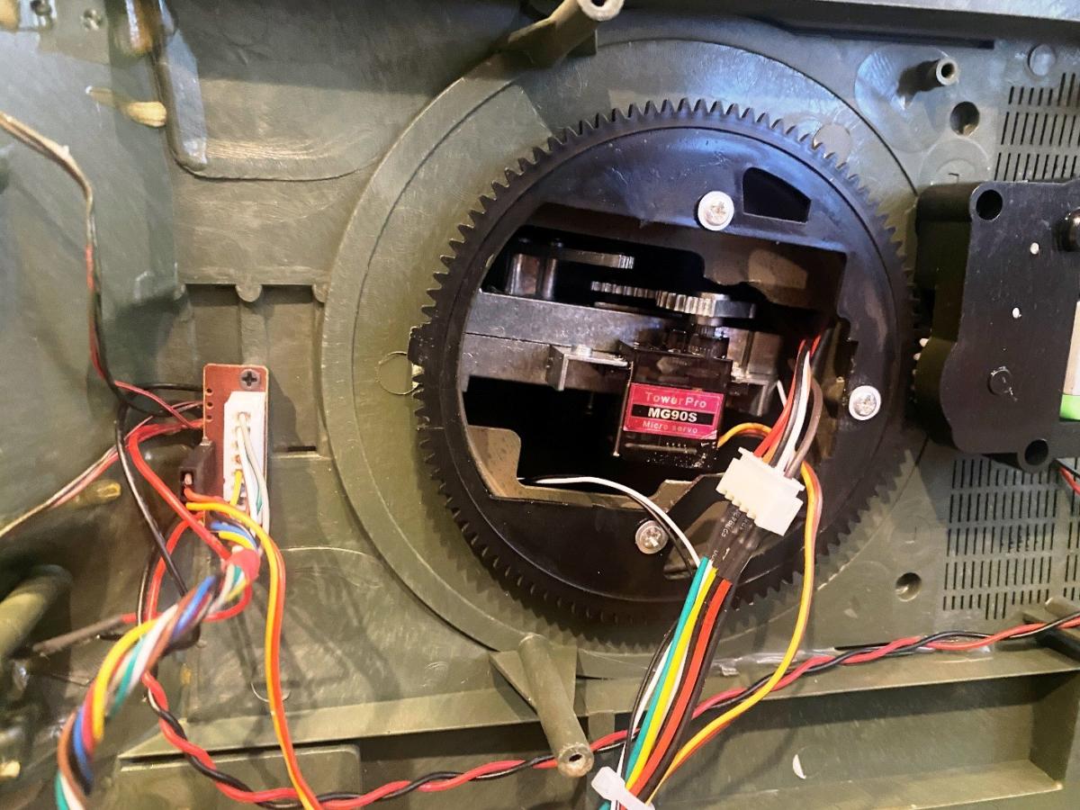

              The recoil unit was the high end metal recoil set from HL (if I remember correctly). The board is from Sbus Clark TK-50. The gearboxes are just the regular metal Henglong HL 59. And you are right; the metal tracks from this tank are so nice.

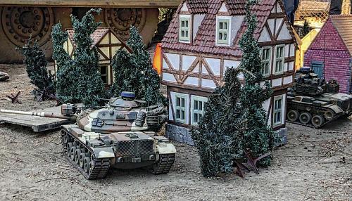

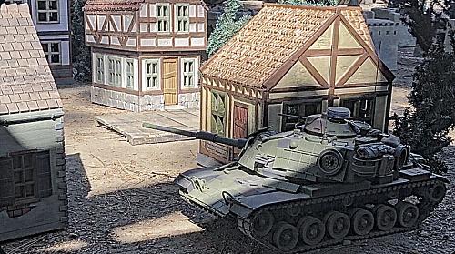

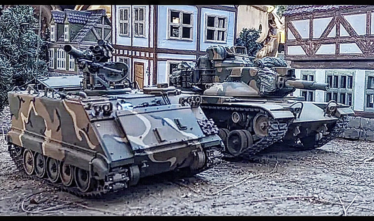

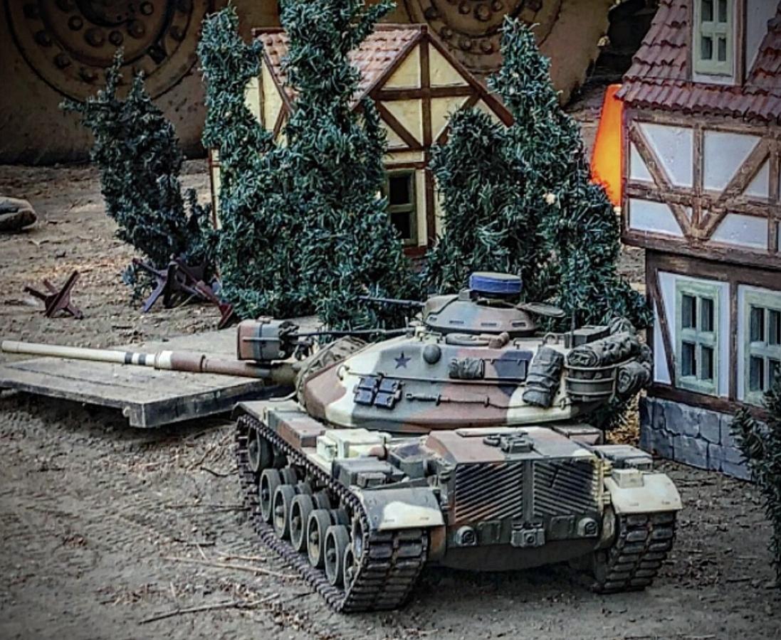

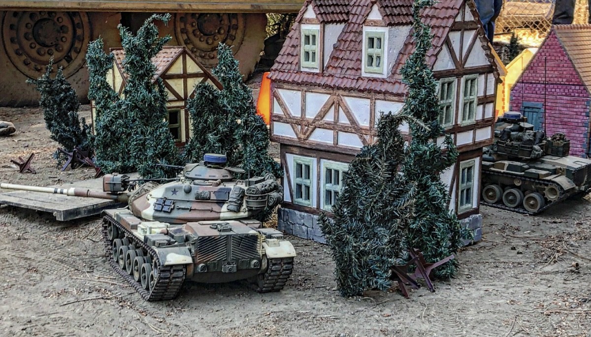

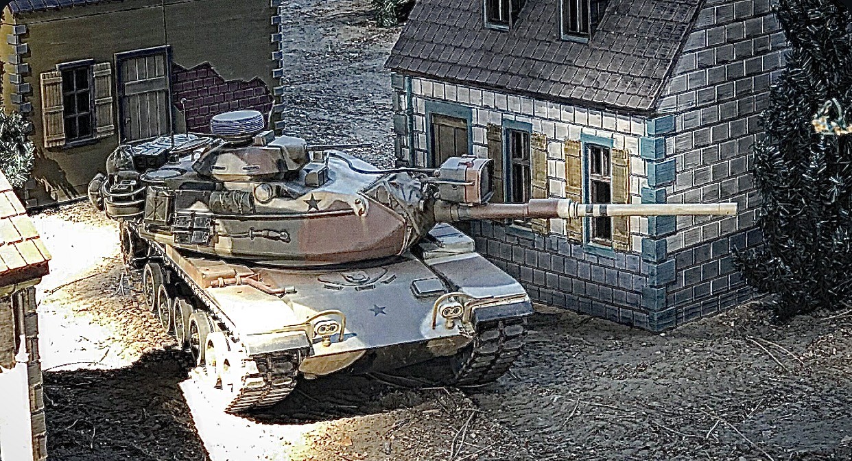

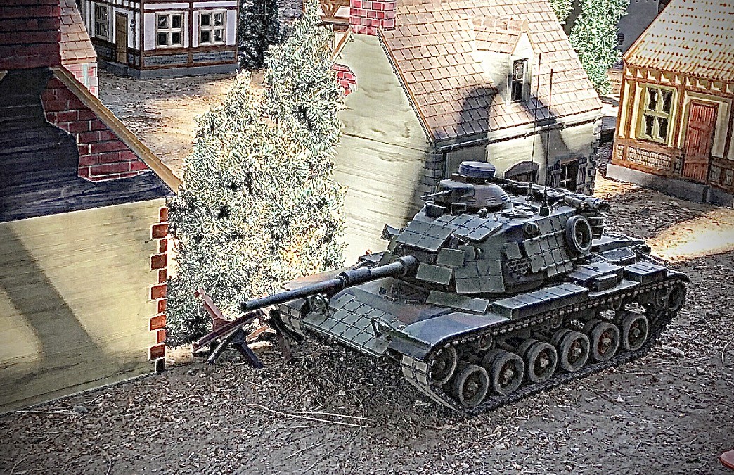

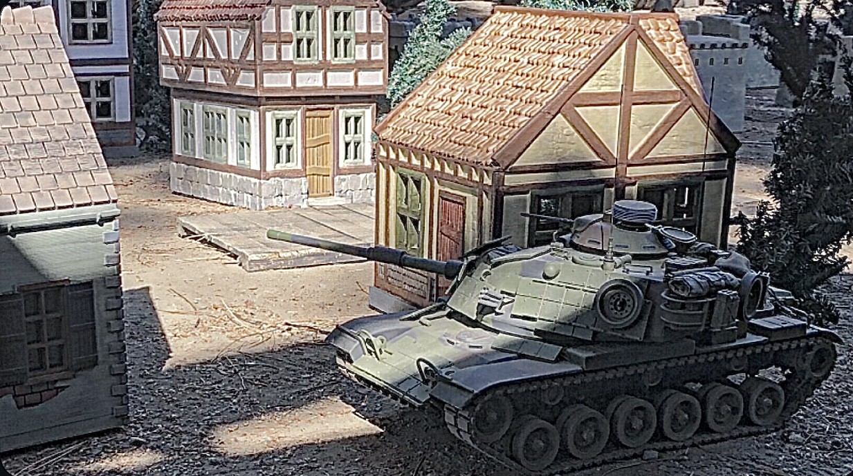

                    Two of my TongDe M60s (highly modified) at the L.A.Tank 2025 October battle day event. They performed well in the tight streets of the new European village but hand their hands full deals with the smaller more nimble tanks when they got to close. Click image for larger version
ID:	434142 Click image for larger version
ID:	434141 Click image for larger version
ID:	434143 Click image for larger version
ID:	434144 Click image for larger version
ID:	434145 Click image for larger version
ID:	434146 Click image for larger version
ID:	434147 Click image for larger version
ID:	434148 Click image for larger version
                      Incredible work, Sir.

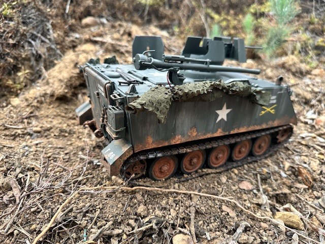

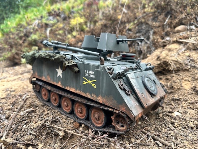

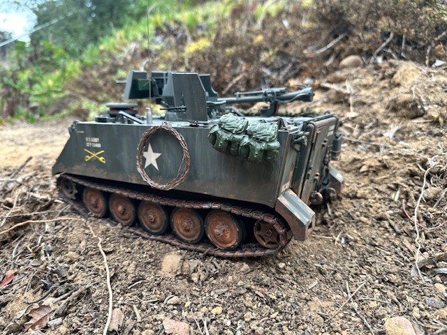

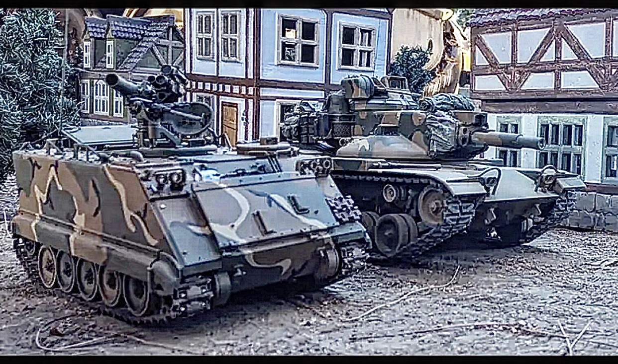

                                  My M113 ACAV with a M40 Recoilless Rifle. The M113 is from Tongde, the rifle and backpacks are from Rich Johnson's Models n Stuff. A 3mm IR emitter is installed in the rifle, which traverses about 45 degrees. The driver's hatch was removed for a LegoDEI IR receiver.
Name:	M113 ACAV 14.jpg
ID:	439340 Click image for larger version
Name:	M113 ACAV 15.jpg
ID:	439341 Click image for larger version
Name:	M113 ACAV 16.jpg
ID:	439342 Click image for larger version
Name:	M113 ACAV 17.jpg

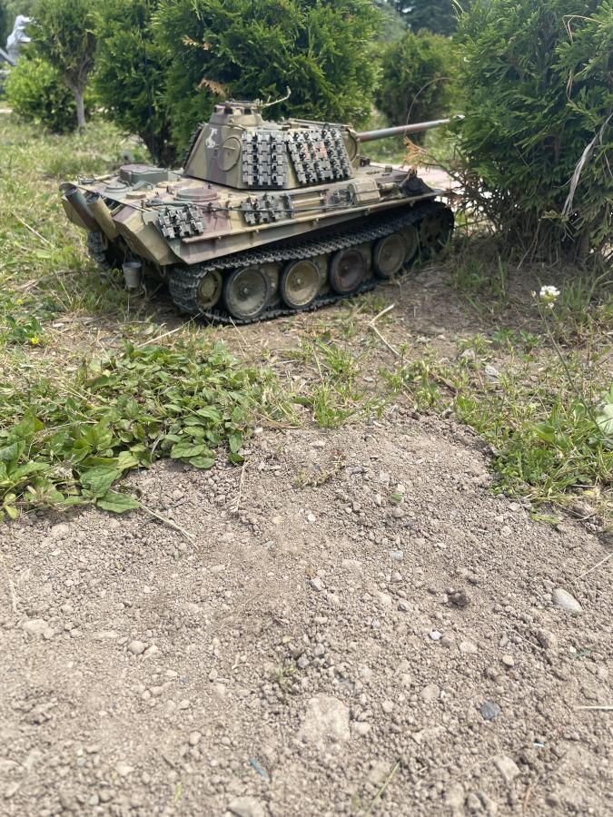

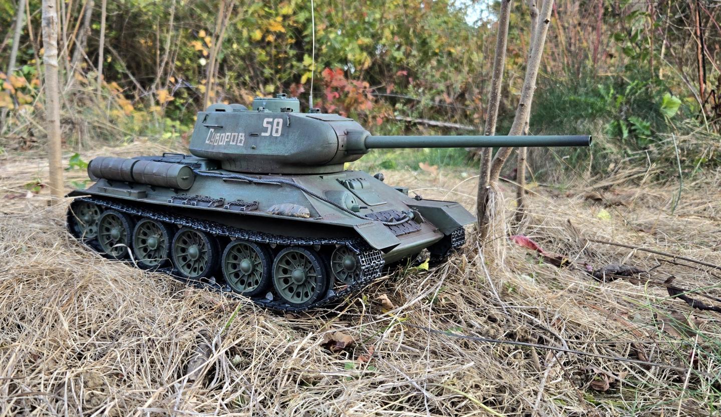

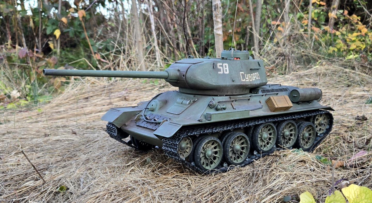

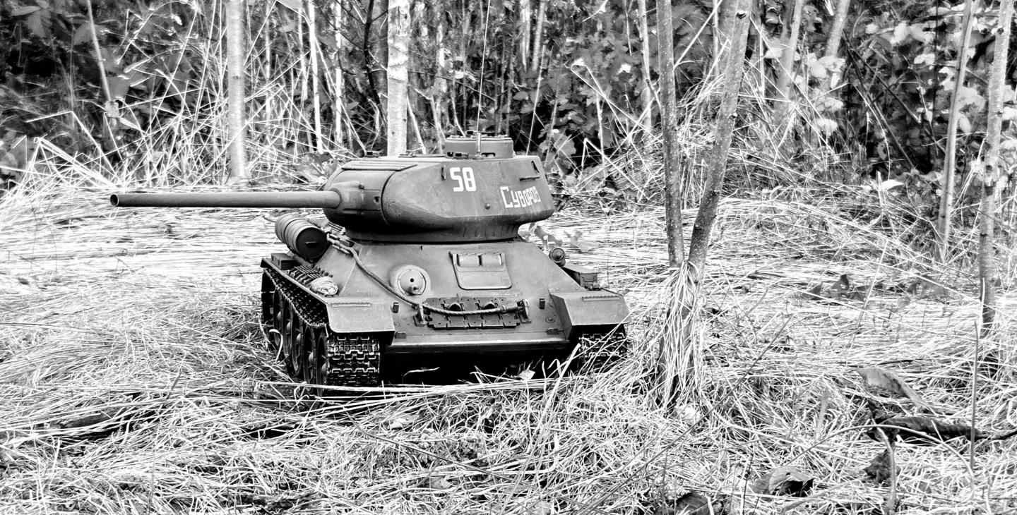

                                    I'm brand new to RC tanks. I previously only collected 1/32 and 1/18 tanks (Forces of Valor and 21st Century Toys). When I couldn't find a suitable 1/18 T-34/85 I settled on an RC Heng Long despite being slightly larger. Never *needed* an RC. Only wanted a static model. Now I'm hooked. I'm ready for my next addition. Most likely a Sherman. Here's my T-34. I actually ended up changing the turret number three times 😆. First was 457, then 97, now it's 58 and staying that.
                                    • Geiser100
                                      • Nov 2025
                                      • 15
                                      #1438
ID:	439365 Click image for larger version
ID:	439366 Click image for larger version
ID:	439367 Click image for larger version
ID:	439368 Click image for larger version
ID:	439369 Click image for larger version
ID:	439370 Had to upload pictures to different post. I couldn't edit my first one. Got strange error messages.

                                        Wecome to Hobby Squawk, Sir, glad to have you onboard.
                                        Seriously great photos and one good-lookin' tank.

                                          Welcome. I see you took your photos where they should be; outside! Since you're coming from a modelling background, you are going to have twice the fun. Building, painting & driving, along with the fun/frustration of maintenance and repairs.
