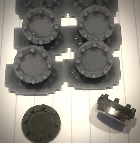

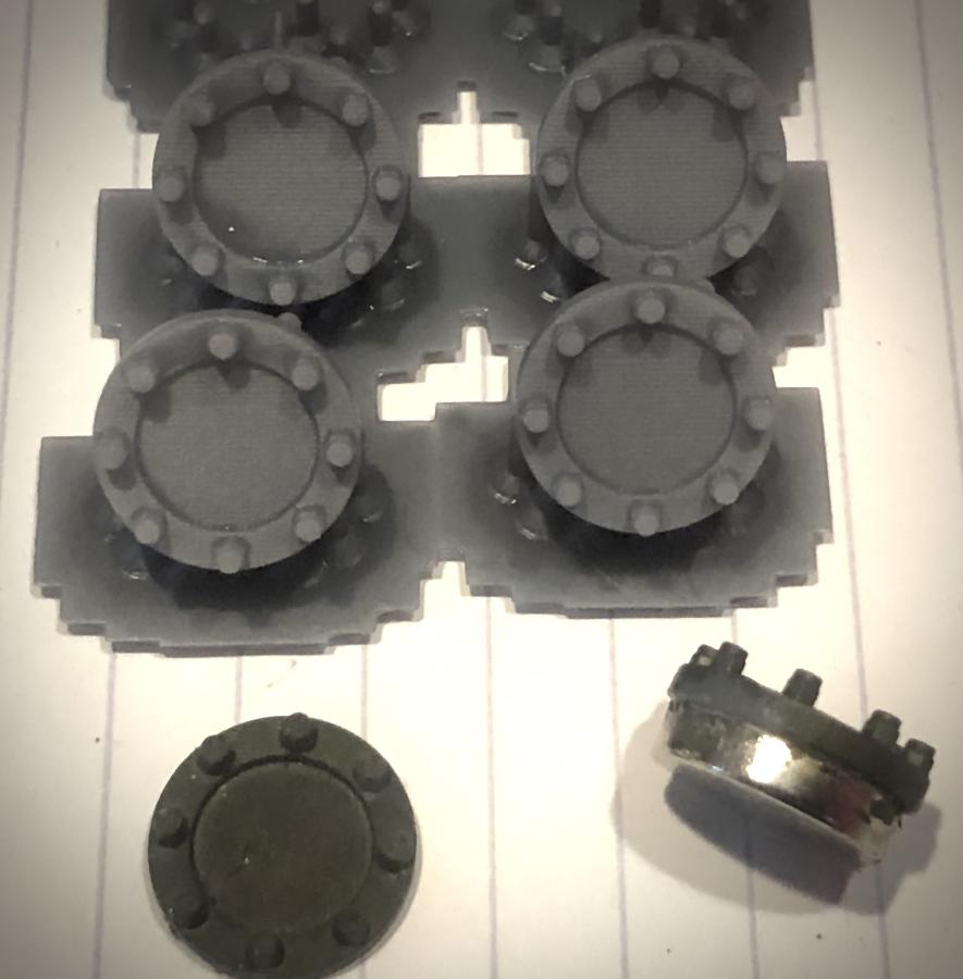

A few updates. The M60 continues to run well and I have a few new parts from JVM3Dconcepts for the M60 to show. If you are interested in one or both contact me via a PM.
First the are the replacement torsion bar "lock down covers" these are made of engineering resin which is rather strong material.

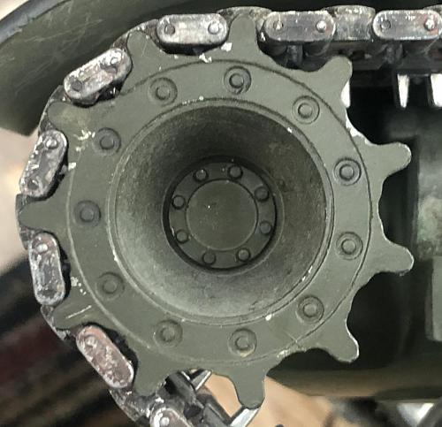

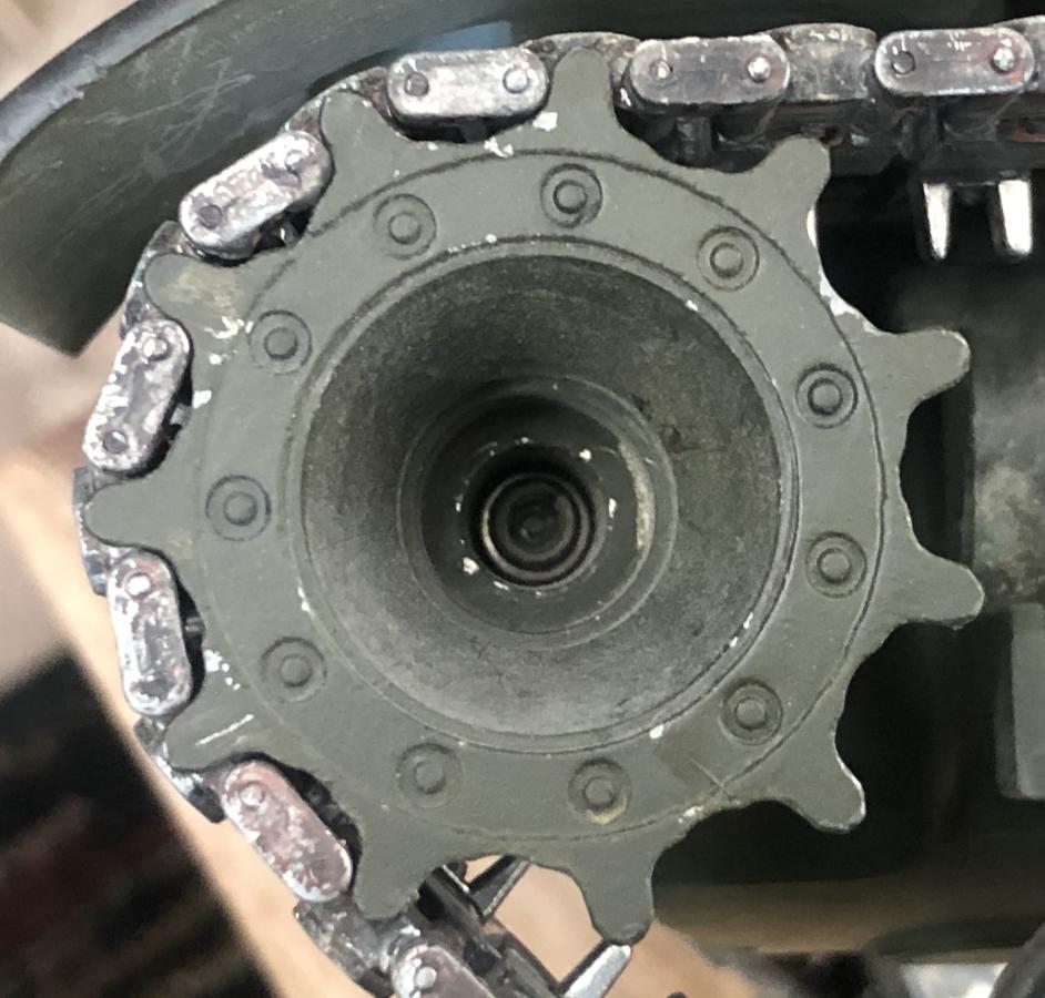

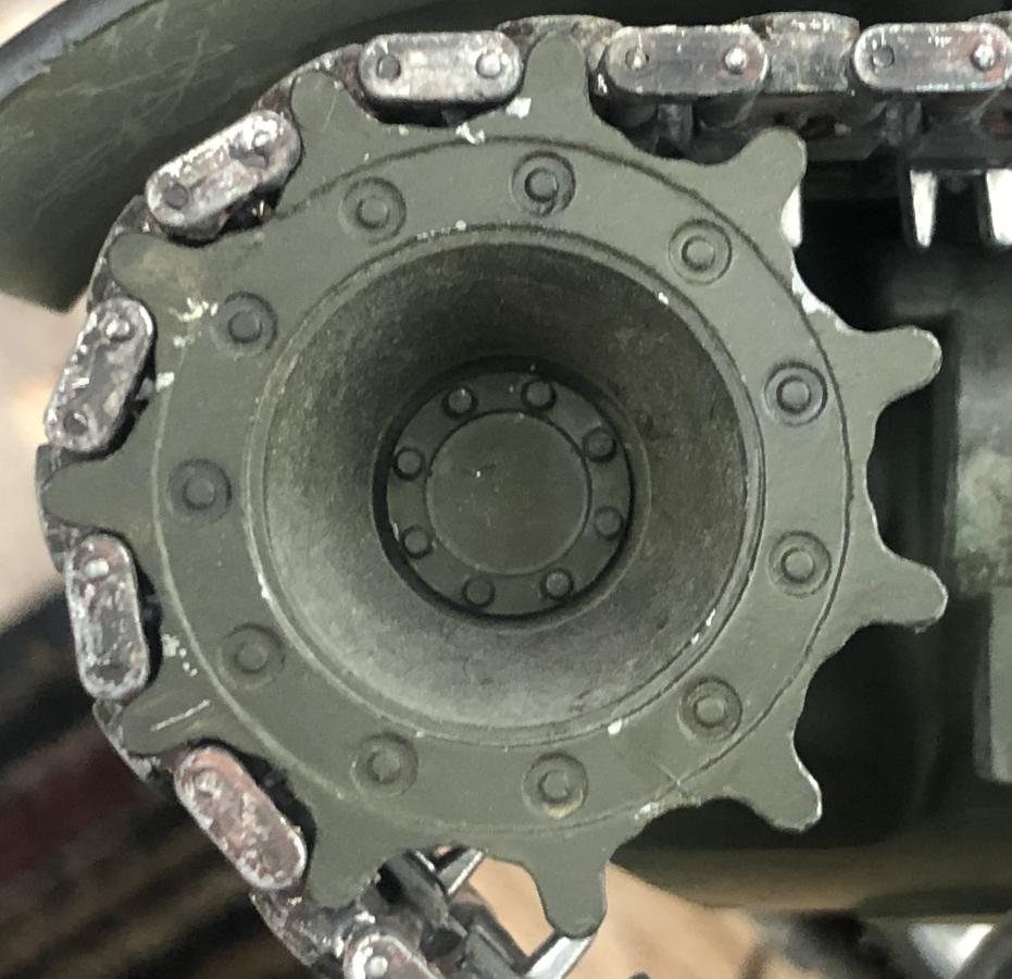

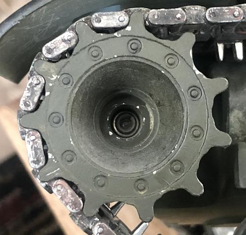

Next are sprocket "detail" hub caps. These are made to cover the sprocket screws and provide for a finished look. They are held in place by neodymium magnets (not included). So once on they will not fall off.The sprocket before the caps are added.
After caps are added.

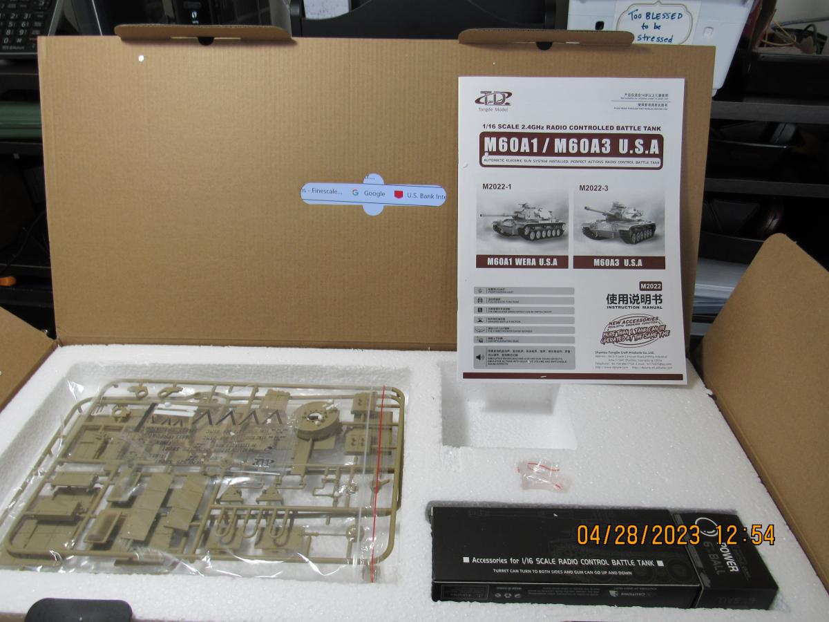

On Friday, 4/21. I ordered a TongDe Patton M60A1 plastic version from Nova Hobby in Canada. On 4/24, Monday, Nova Hobby emailed that the processing of the order is completed and waiting for flight carrier. Today, 4/25, UPS emailed that package was received and export processing completed. Estimated delivery date is 4/28, Friday. I give Nova Hobby five stars for quick shipping and communication.Originally posted by keilau View PostI just ordered a TongDe Patton M60A1 plastic version from Nova Hobby in Canada. The shipping is US$42. I will report back the overall shopping experience including shipping when I get the shipment.
Canadian Postal Service used to be much slower than USPS, but USPS is slowing down fast. I still expect it to be faster ordering from DKLM in Hong Kong.
I asked Nova Hobby about the other TongDe tanks such as the M60A3. They said the next shipment from TongDe is in late summer or later.
In Canada, UPS is much faster than Canadian Postal Service for package. I ordered the metal gearbox from DKLM on 4/22, Saturday. No update on that order yet.

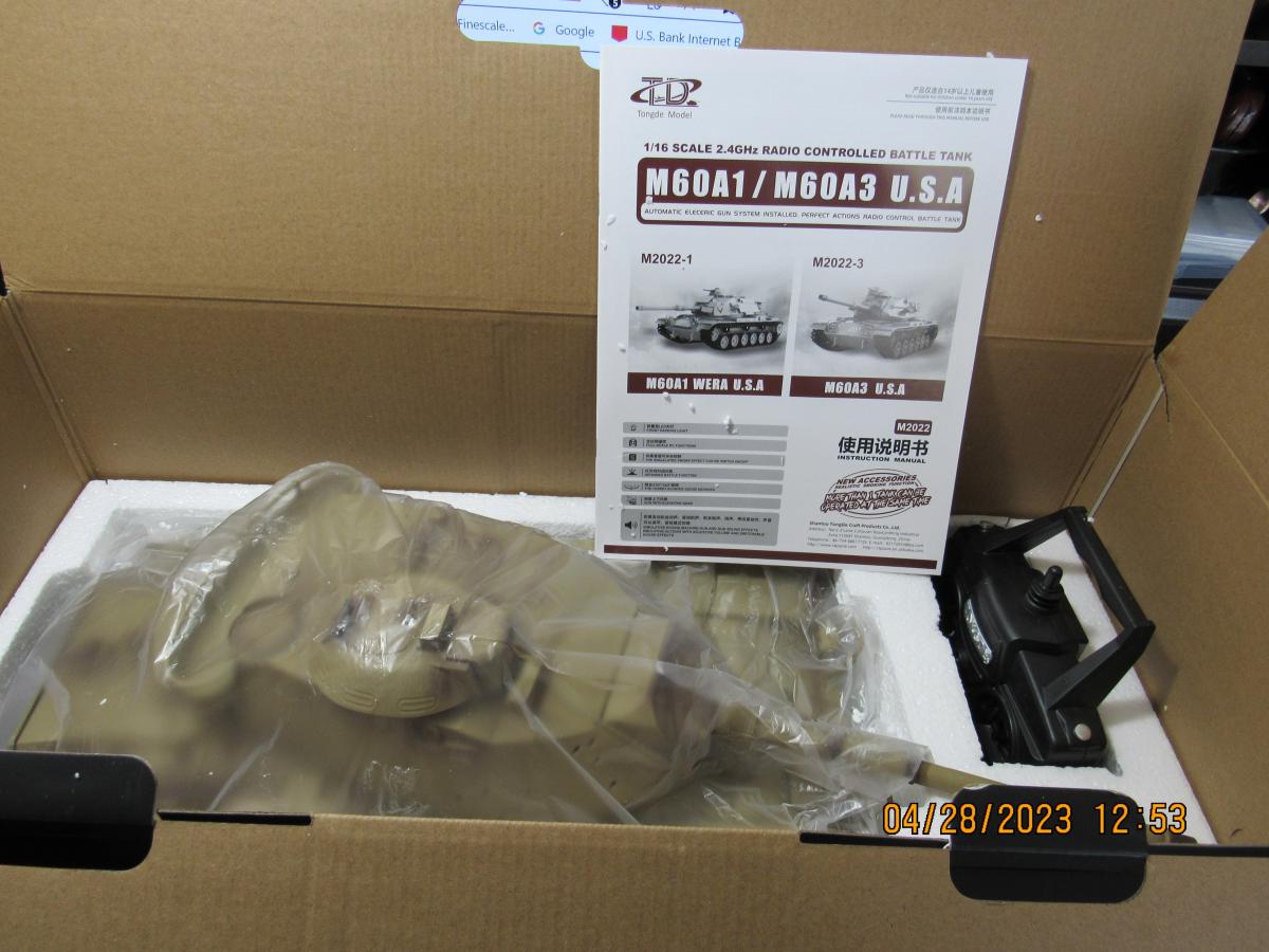

The good news is that there is no obvious broken parts off the box. The tank runs fine as is, but no sound.Originally posted by keilau View Post
The fit of the tank is not good. There is a huge, 1 mm gap between the body and the rear grill panel. Even my 2005 Pershing has better fit. The problem is only cosmetic, but a very important one for military plastic modeler.
The worst problem is the unprotected battery that runs only half an hour, but takes 4 hours to charge. There is no easy way to exchange battery without de-coupling the upper and lower half of the tank. Magnetizing the tank is a must. But I am not sure how well it works due to the poor fit problem I mentioned earlier. Any lithium battery without build-in protection circuit should NOT be used. The TongDe manual keeps emphasizing not to overcharge or overdischarge the battery, but there is no indicator on the tank or the charge wire to help the tank user.
The foam seems to have the right shape and worked fine for my shipment. It needs only a few adjustment of the hot wire cutter machine to get it right. Coldbang Wang just need to hire an experienced packaging designer. I have purchased 4 tanks in the last 3 years. Three were HL shipped from New Jersey. This last one from Canada. All of them survive with no major problem. However, shipping individual tank package across an ocean by sea shipment is going to be a challenge.Originally posted by Rubicon99 View Post

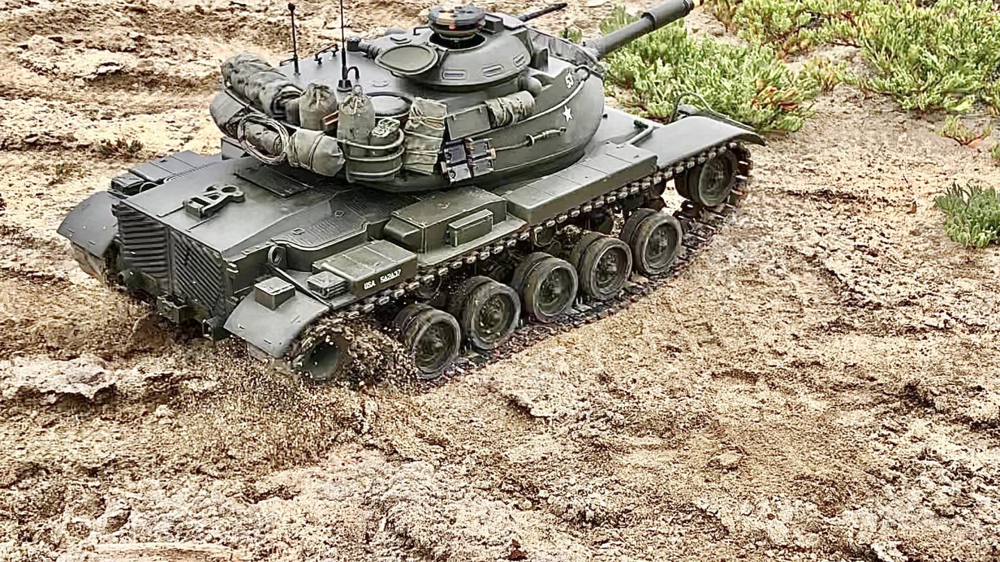

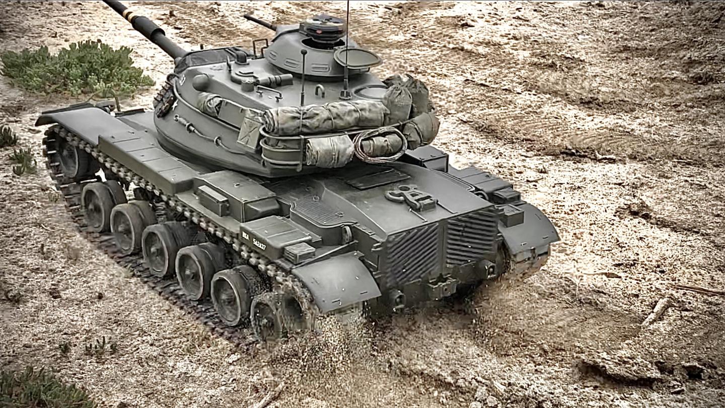

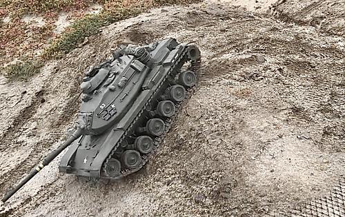

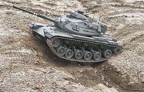

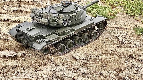

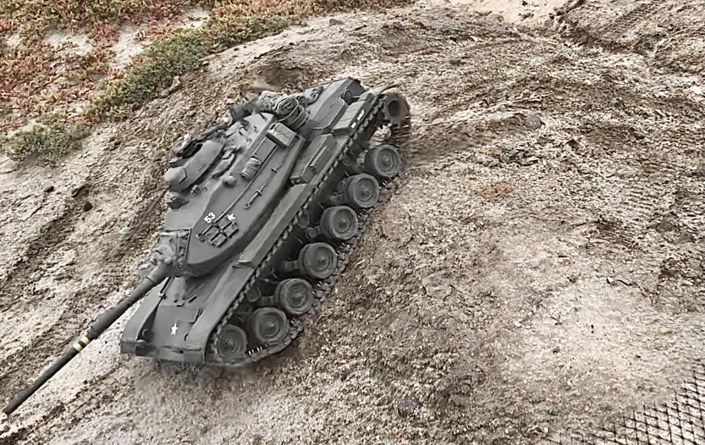

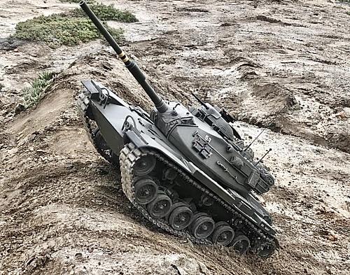

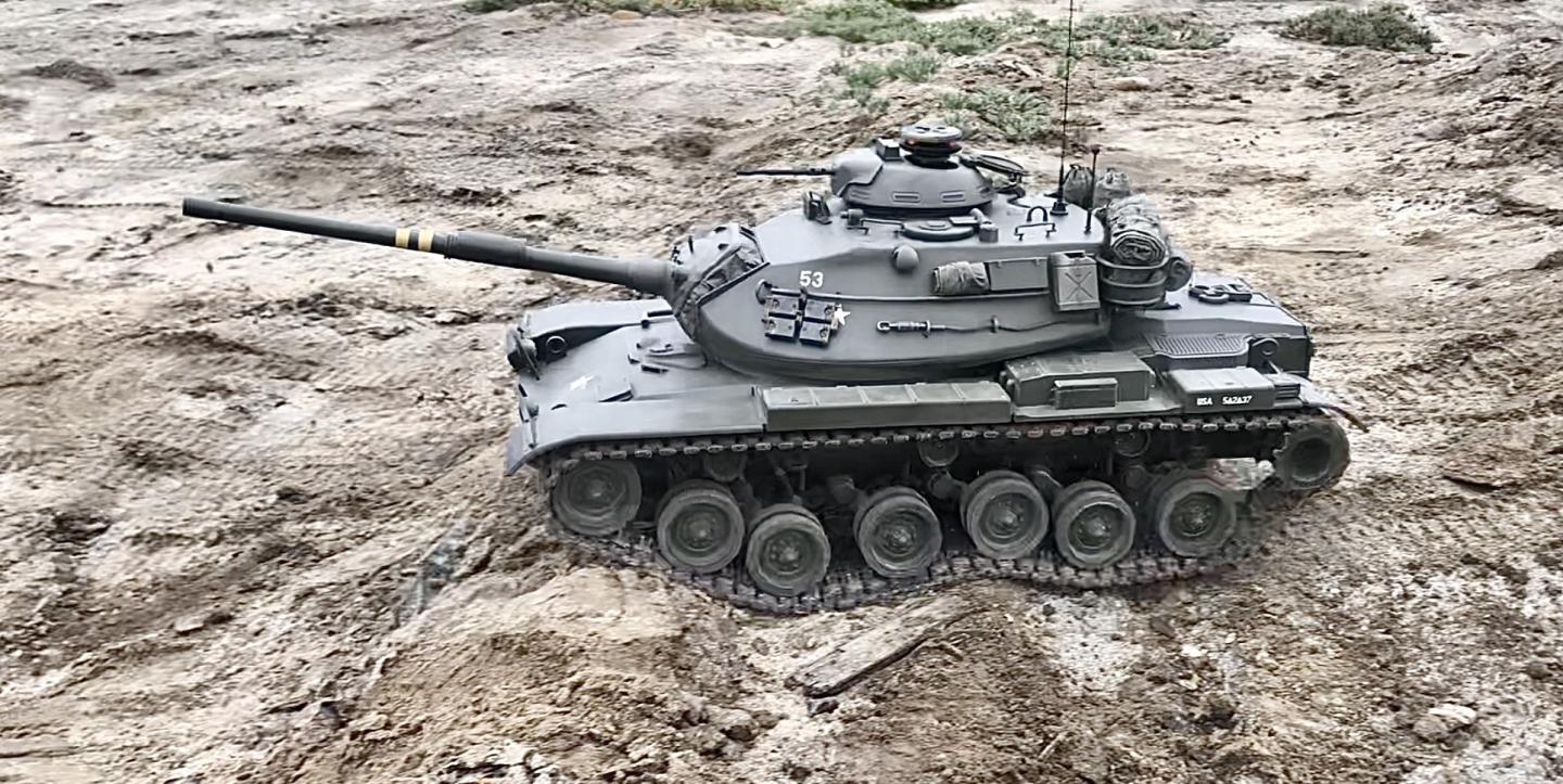

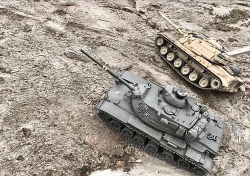

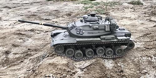

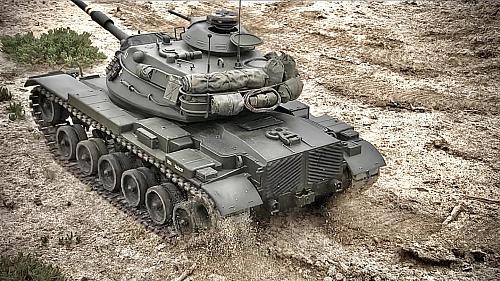

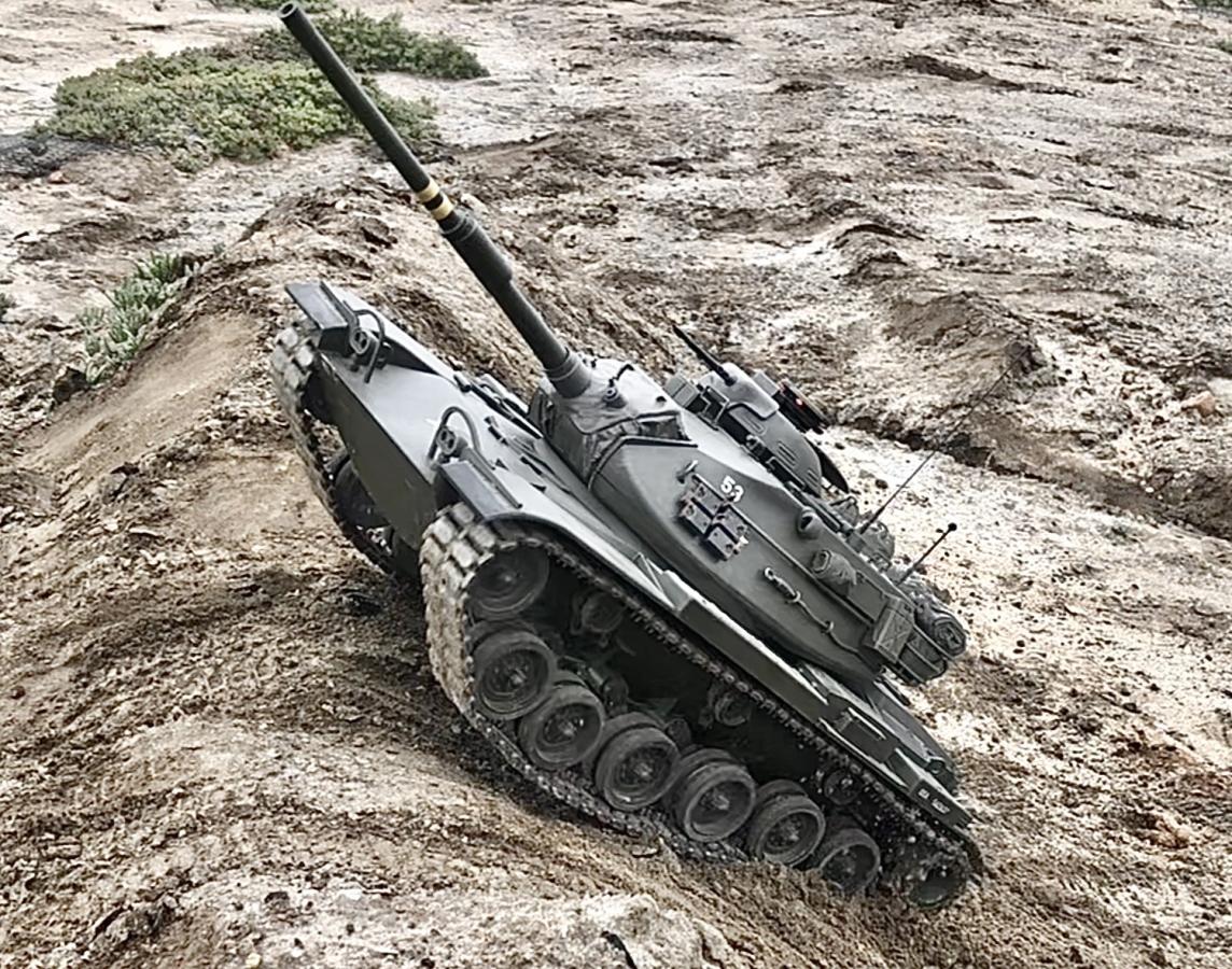

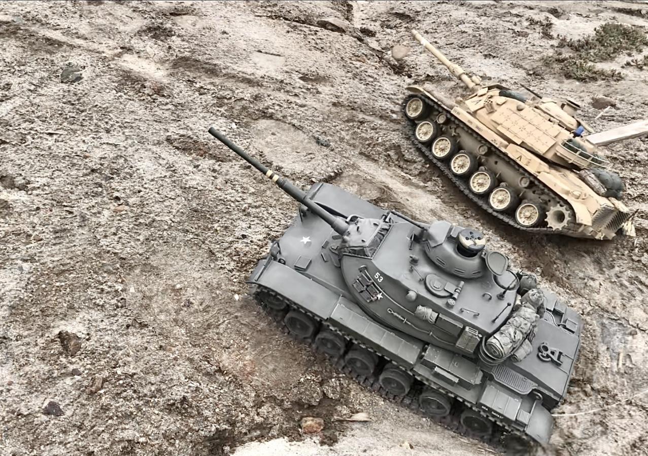

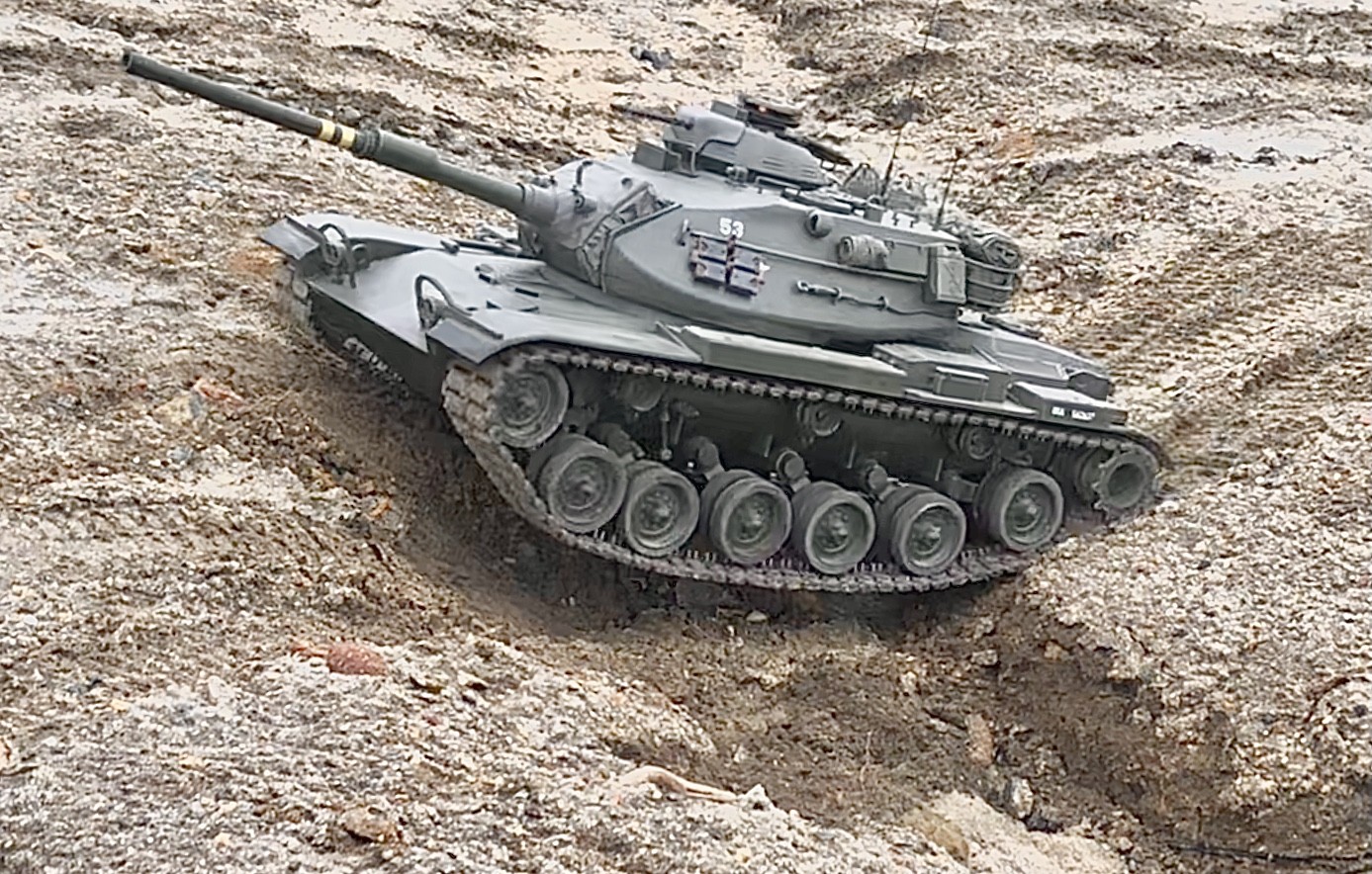

Had a chance to get the TongDe M60 down to San Diego for the April 2023 tank meet. The field in San Diego is silt and sand combinations and must be driven with care as not to "over pack" the sprockets and road wheels. The TD M60 had no troubles with the terrain and evacuated the silt and sand from the tracks/sprockets with ease. The field was also heavily rutted from recent winter rains so there was ample opportunity to test suspension flex and ditch crosses capabilities. Again the metal TD M60 has absolute no issues and was a pleasure to drive.
Some screen shots from today. Video can also be found on my Instagram @ fsttanks.
- Likes 1
I have the "tan" M60 in the photo and videos. I have an observation for prospective owners. Good tank, good size, good suspension, did well at the field. There are two potential weakness with the TD drive train; the gear boxes, and the sprockets. R99's tank has metal gearboxes and sprockets, I have plastic sprockets and gearboxes, although the gears are metal in both our tanks. In regular driving, my setup is sufficient. However, in the extreme operations we conducted, a gear box has failed. Under load, the motor will run but something is slipping, causing the sprocket not to rotate.
Since R99's M60 has been subjected to substantially more abuse than mine and is running flawlessly, my solution is clear: replace the plastic gear boxes with metal, and that solution has been ordered.
The other flaw I mentioned is the sprocket itself. Mine and R99's are fine. The story here is that when I originally got my tank, there was gearbox damage maybe from the factory or more likely during shipping. This would cause severe jamming, and put stress on the sprocket which ultimately cracked where it fit on the axle. Although this has not reoccurred to me, or at all to R99's metal setup, my preemptive solution is to also obtain metal sprockets. I won't install them unless the plastic ones beak, but it's "better to have them and not need them then....."
I recommend buyers add metal gearboxes and sprockets. I'll let R99 address the relative merits of metal roadwheels, etc., so buyers can decide whether to get the standard tank plus extras, or full metal setups. We both are very happy with the product, with the above provisos.
Oh, and in the photo with my tan tank, it had no trouble extricating itself from that ditch!The more screws it takes to reassemble a tank, the more likely it is you left something out!
