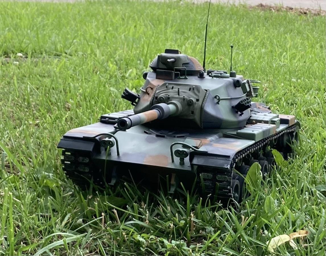

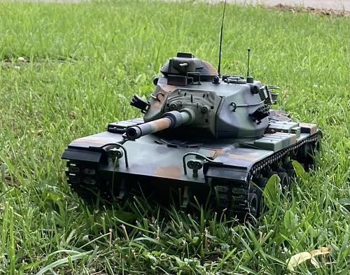

  • MaverickTank
    I finally purchased a Tongde M60 A3 after waiting to see how it faired with early adopters. I read all the threads and decided to get a metal track and gear box version. Bottom line up front: Pro= appearance, torsion suspension, diesel sound, Negatives= battery charging, backing up over obstacles, radio controls are poor, sprocket screws back out.
    Was it worth the purchase? Maybe. I am thrilled to have an M60 and it looks great. It sounds like a diesel. The suspension looks awesome rolling over terrain.
    But, there are issues that put a damper on my enthusiasm.
    - I don't like the battery being buried in the chassis, and it isn't a simple fix to make it removable. I don't care for magnetic upper hull attachments.
    - The radio does odd things at random times, failing to respond immediately to control inputs. I'm getting a Heng Long radio ASAP.
    - I lost both sprocket screws in my yard on the test run. Luckily, I had two screws to replace them with and used washers and blue Loctite. The screws should have been cap screws with washers.
    - I discovered the reported suspension arm over-travel when backing up over a 1.5" obstacle.
    - The turret motion is shaky.
    Minor bits-
    - It feels fragile...I'm constantly worried that I'm going to bust something on it when I'm picking it up. The mounting holes in the hull for detail parts were larger than need be.
    - The tracks are HEAVY. I'm getting plastic as soon as I can locate a pair.
    I love having an M60 A3, and I did it up in NATO 3-color. It looks awesome crawling across the terrain.

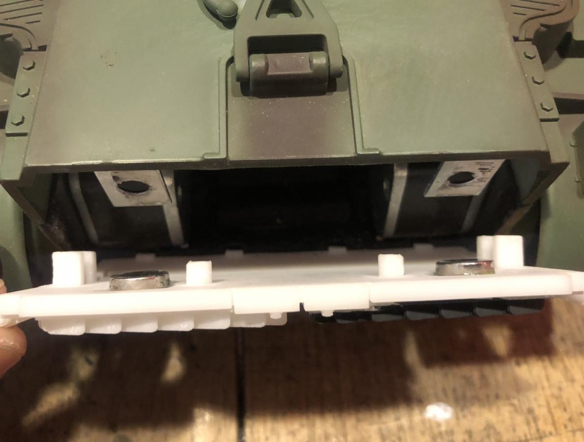

  • Rubicon99

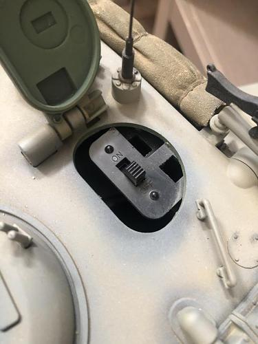

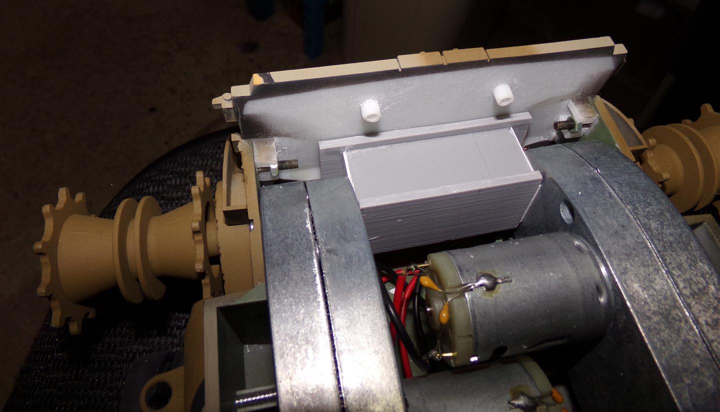

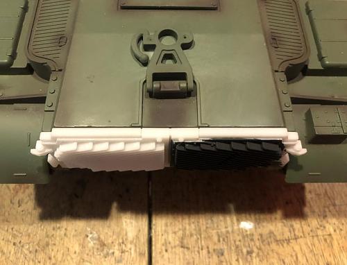

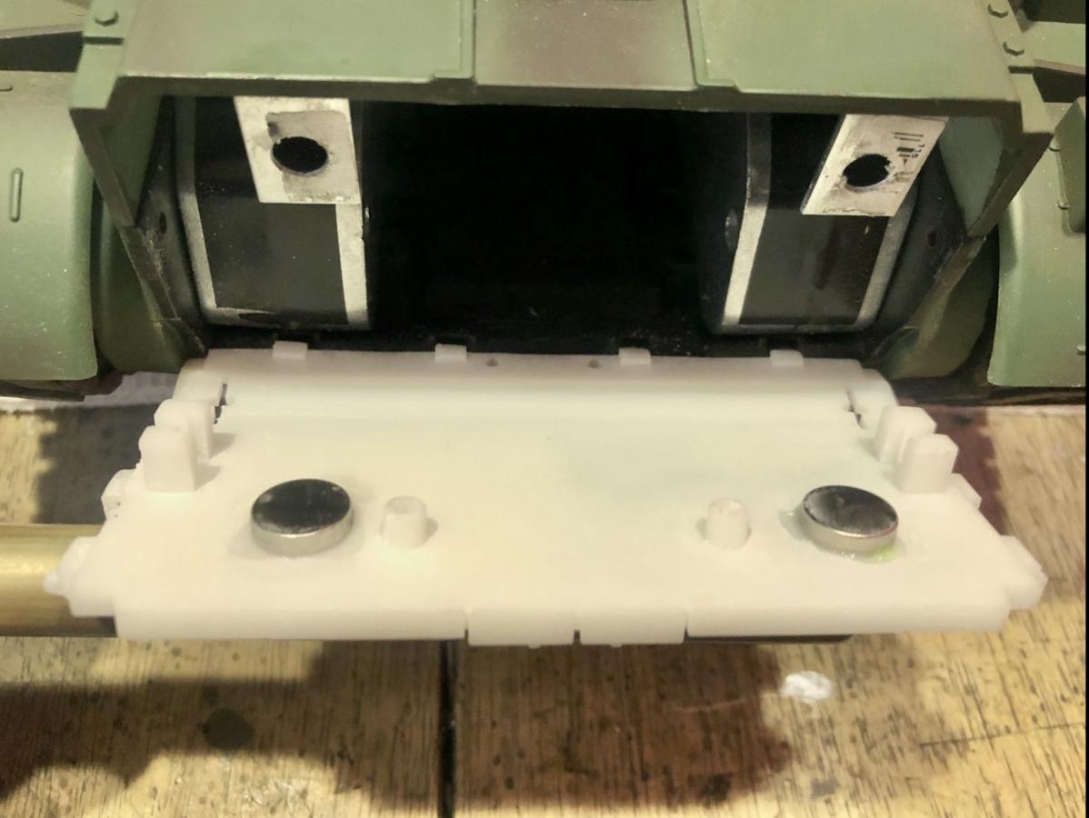

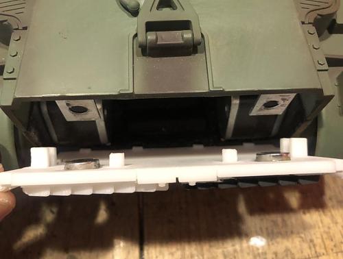

    R99, I seem to recall a while back that you modified your M60 to have the rear panel removable, for easier access to the battery. I couldn't find it on this thread. Did you post what you did? Thanks.

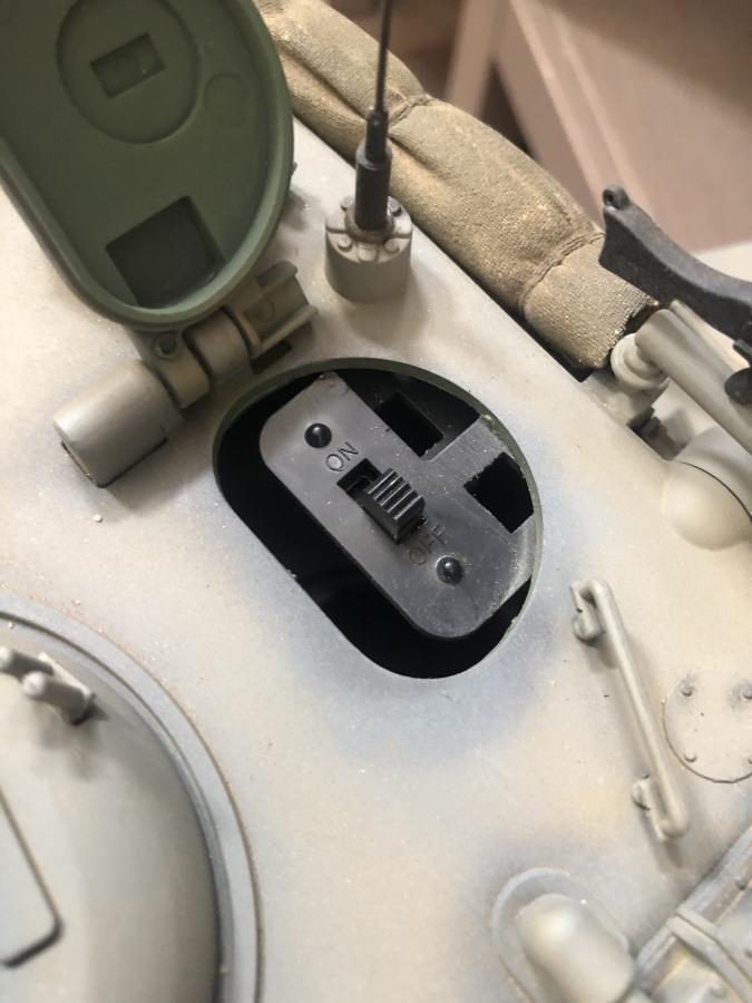

    The modification I do is for easier access to the battery connections as I do not like the TD charging set up being under the turret and having to force the turret around each time to make clearance to access the charging "port" nor do I care for the batteries that TD uses.
    Also I move the on / off switch to the "loaders hatch" which makes turning the tank on / off super easy and convenient.
    It is a simple modification to do as shown below. Depending on the battery lead line length you might have to add a few inches so there is enough slack in the lines to reach. I removed the useless smoke system so I have plenty of room for the battery and MFU power lines to reach.
    With the magnets and metal "L" brackets shown you no longer need the two side screws to hold the rear exhaust panel on.
ID:	398714 Click image for larger version
ID:	398713 Click image for larger version
  • SoCalBobS

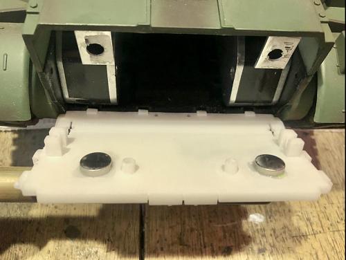

    I am thinking that the magnetization problem could be my fault. I may not install the pairs close enough. I have been thinking about experimenting putting some shims underneath them. What is the source of the magnets that you used?
    I put a piece of the TO-66 (power transistor) mounting washer above the upper magnets. It works perfectly. The washer is about 1.5mm in thickness. Now I can hear the clicking sound when the magnet hits each other. The mount is much stronger than before. I still think that 4 pairs of magnets is not strong enough for the TD M60 size.
    The M60 is my 4th attempt in magnetization after 3 successful conversion with HL (Leopard, T34 and Sherman). I cut off a small piece equal to 2 magnet thickness from the upper mounting poles. The M60 is my first failure of weak magnet adhesion. I suspected that the original plastic poles had a gap between them. However, since I have not heard other TD tanker to have similar problem, It is possible that I just made a mistake in measuring the length needed to be cut.
    I am still struggling to fix the headlight connections. It does not affect the tank running, but it does not look good to have a pair of dark headlights.

  • RichJohnson
    I would not be able to magnetize the new m60a3 I just got. The upper deck is warped upwards to where if the front screws are secured the back is up in the air enough the back of the turret rubbs on the hull and it also doesnt rotate well with the bind in the barbett ring of the turret. Its not high but it is warped. I just have to hold it together to screw the back down when I attach it.
    Rubicon has the best design with his. He magnetized the rear panel and has extra long wires to charge his battery in the tank which is ok with NiMH batteries we use. I am thinking I will go this route eventually as I have a few M60s now and one or two more planned. I pretty much build shermans, leopard 1s and M60s lol.

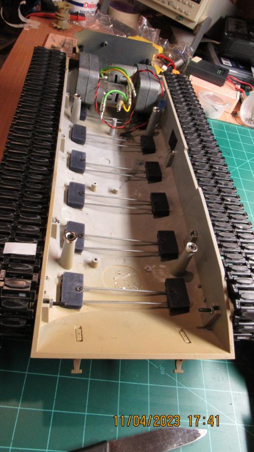

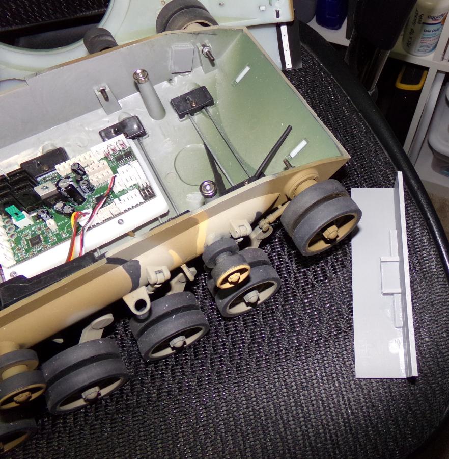

  • keilau
    Originally posted by tank_me
    I magnetized my upper and lower and it is rock solid when connected. As an added precaution for running the heavy metal tracks, I did make two braces around the gearboxes.
    The one in front of the gearboxes that uses a modified I-beam design. I made it from failed ASA print material I kept and it slides in place so I can remove it for maintenance. I added it as I could see the hull bowing inward at that point. The following pics are of the brace and showing it pulled out. Since it has a little extension on the top, it also acts as an additional brace in the middle of the two motors.
    The second brace is for the gearboxes themselves. One of my gearbox screws was stripped from the factory and being that they mount from the side, I braced them from the inside against each other. That rear brace is also easily removed, but it takes all the stress off those side mounted screw points.
    I also boxed in the front end just for the hell of it. That brace also just slides out. Gonna be adding some velcro to the side that faces the Clark and that will hold the Li-Ion battery in place.

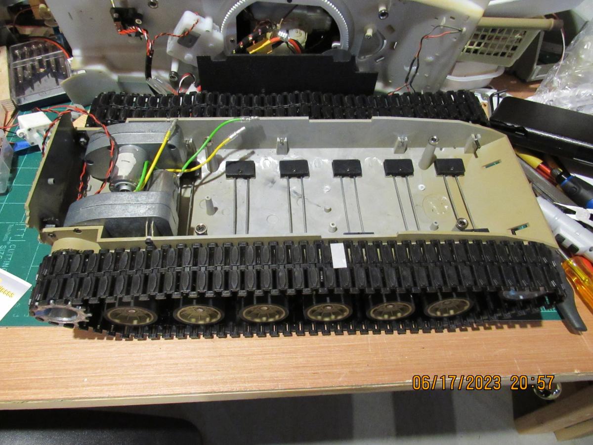

    Are your braces glued or fixed to the chassis sidewall? Or they are against compression stress only? I am very interested in copying your work. I have no 3-D printer. The pieces will be cut from plastic stock manually.

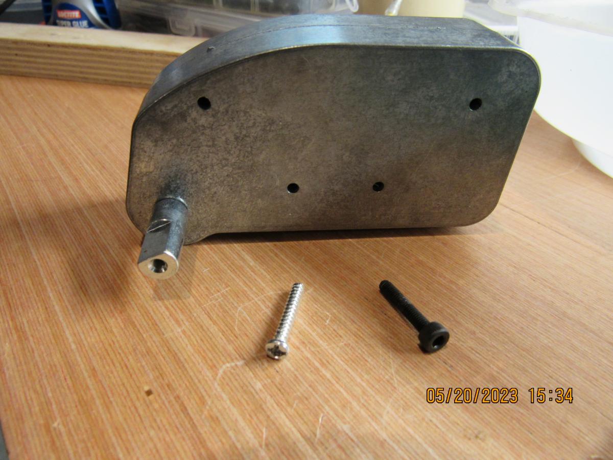

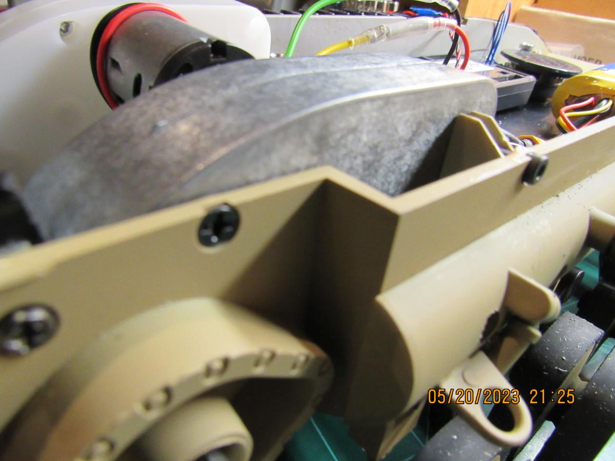

    Click image for larger version  Name:	IMG_5250.jpg Views:	14 Size:	75.2 KB ID:	393395 Click image for larger version  Name:	IMG_5251.jpg Views:	15 Size:	154.1 KB ID:	393394 Click image for larger version  Name:	IMG_5252.jpg Views:	18 Size:	126.4 KB ID:	393393
    The original Tongde screws are soft and very coarse thread. I was able to re-tap the metal gearbox mounting holes for steel M3 machine screws. The case is made of soft alloy making the re-tapped fine thread screw hole very secure. There are 2 factors making the gearbox mounting secure.
    1. Do not use self tapping screw. Use sharp machine screw tapping tool all the way through the hole. I did it when I changed the motor when the mounting hole case half is free standing.
    2. Use exact screw length as the original screws to avoid interfering or damaging the gears. I had no problem matching the 2 shorter screws. The longest screw is 18mm long. You can buy 15mm or 20mm M3 screws, but not 18. I gridded a 20mm screw down to 18mm. It is not difficult to do if you have good carbide gridding wheel for the Dremel. I drilled a small hole on a 1/2" plywood to pass the screw through to hold it firmly while gridding.
    Click image for larger version  Name:	IMG_5170.jpg Views:	15 Size:	125.1 KB ID:	393396 Click image for larger version  Name:	IMG_5171.jpg Views:	19 Size:	92.8 KB ID:	393397 Click image for larger version  Name:	IMG_5190.jpg Views:	16 Size:	153.9 KB ID:	393398
    I changed the motors with Tamiya380 standard. They are genius Mubachi motors with better shaft bearing than the HL grey 380. I have no tool to actually measure the torque for comparison. Unscientifically, you can try slowing down the track while running the tank on a dynamo. Don't stop it completely to avoid damaging the motor. The difference in power is obvious.

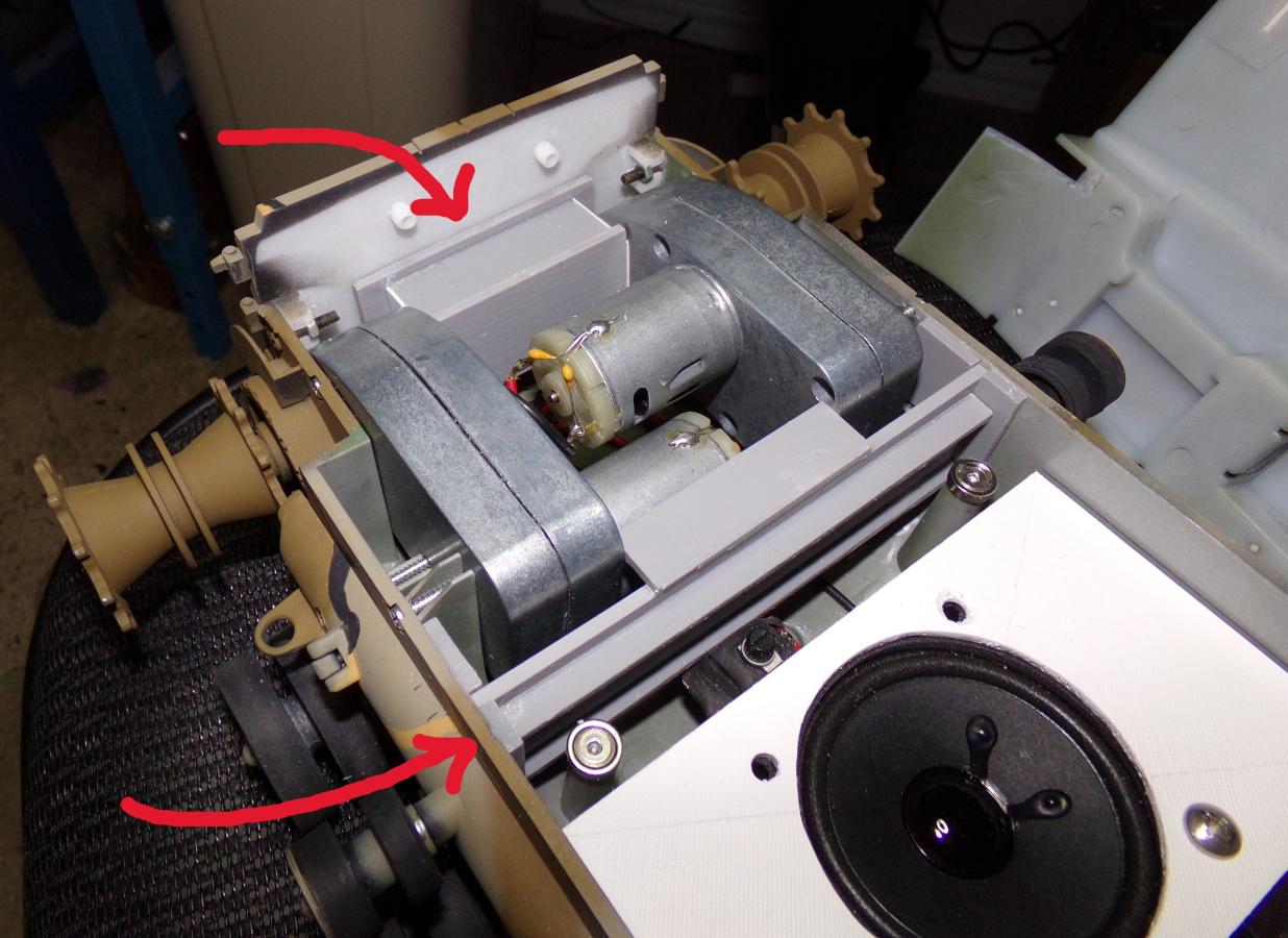

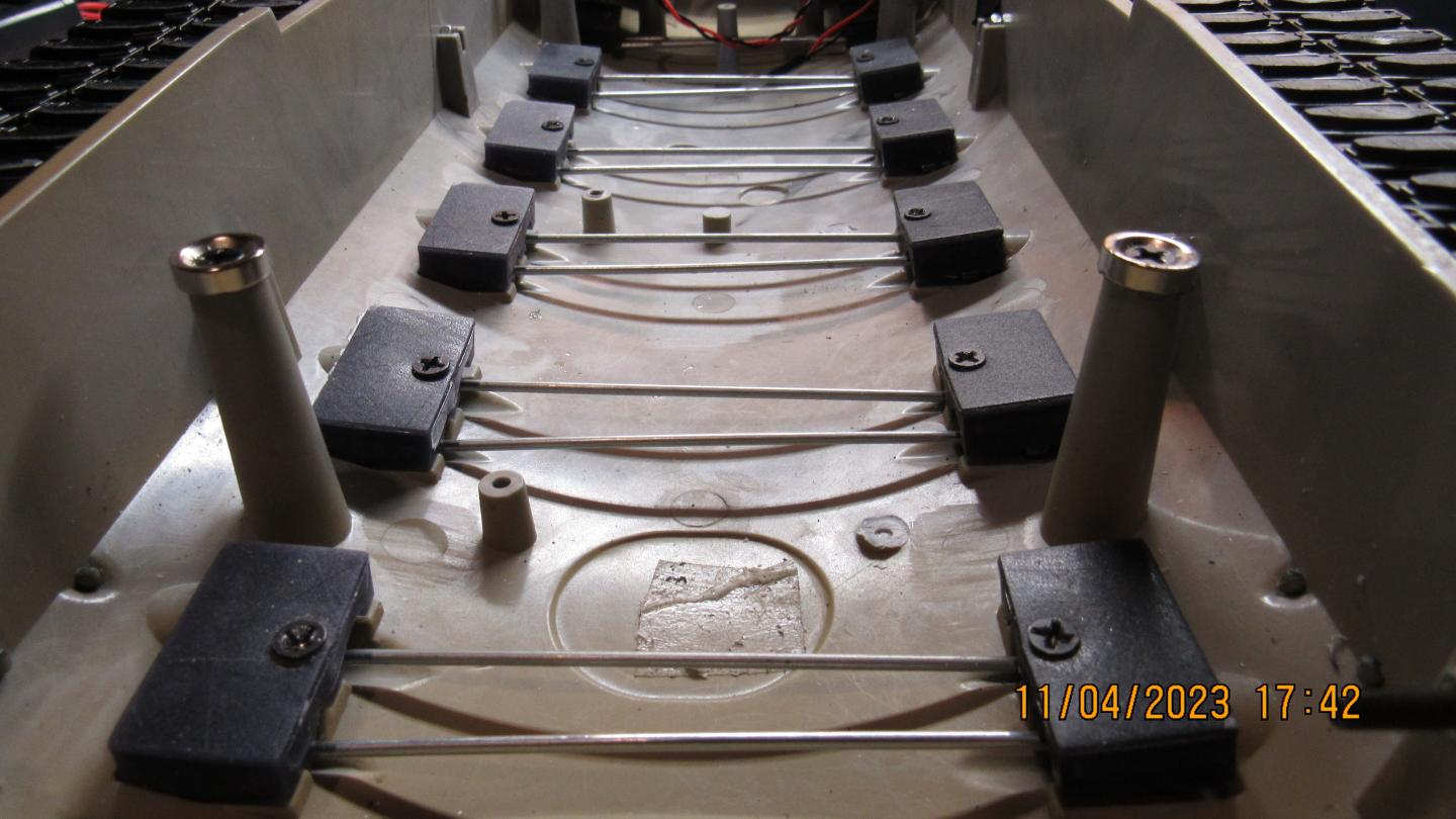

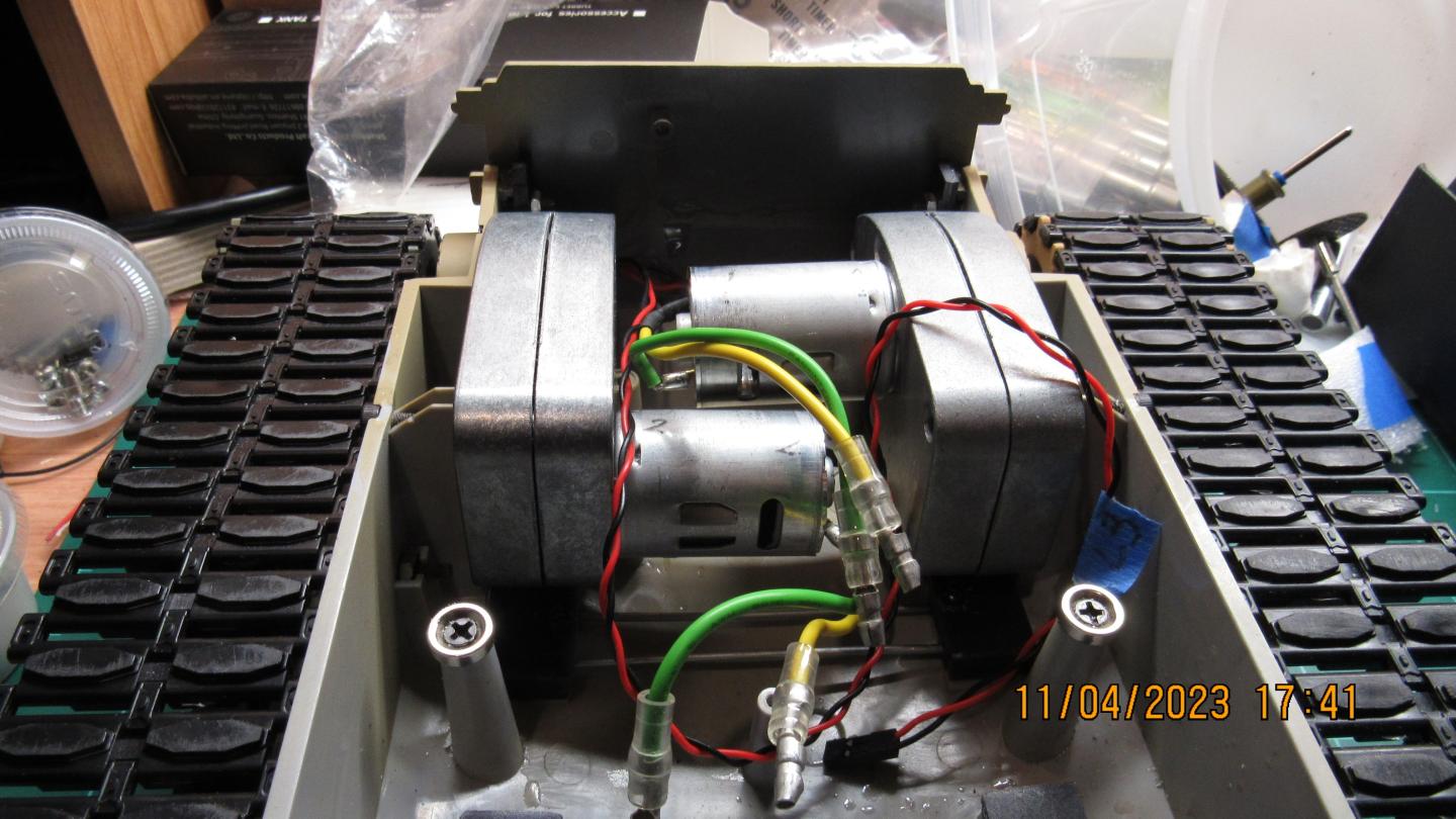

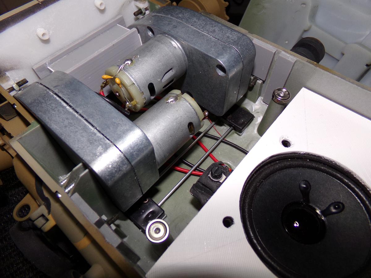

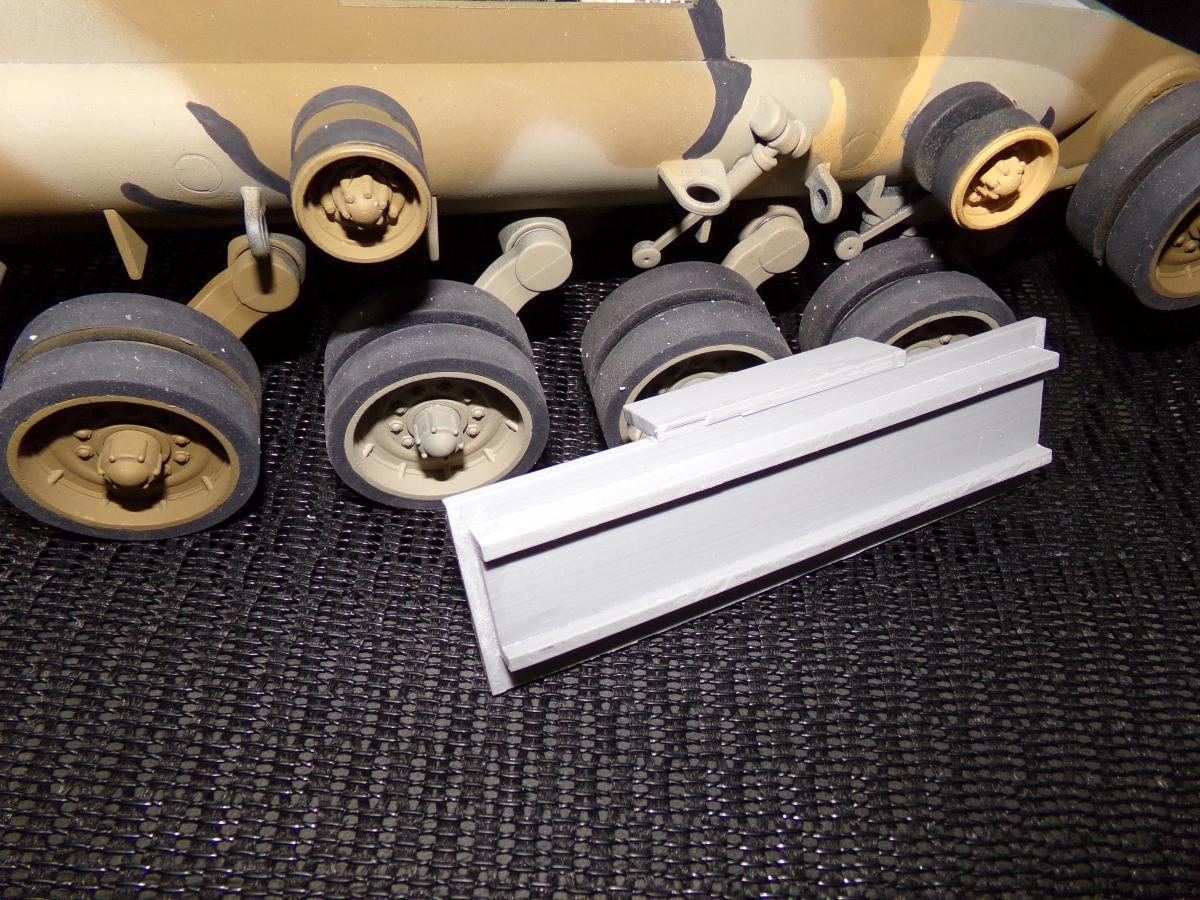

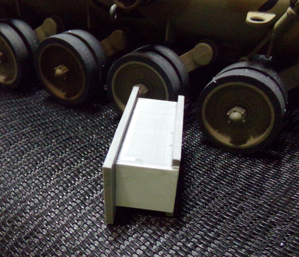

  • tank_me

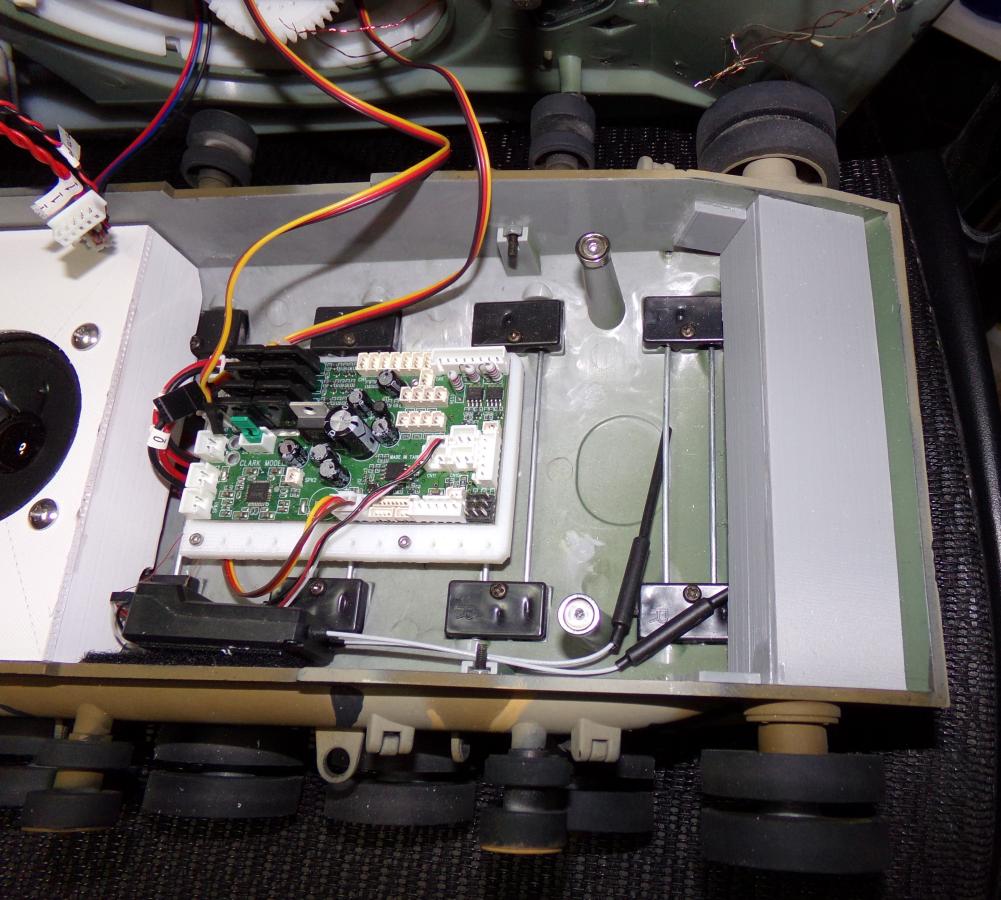

ID:	393388 Click image for larger version

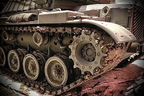

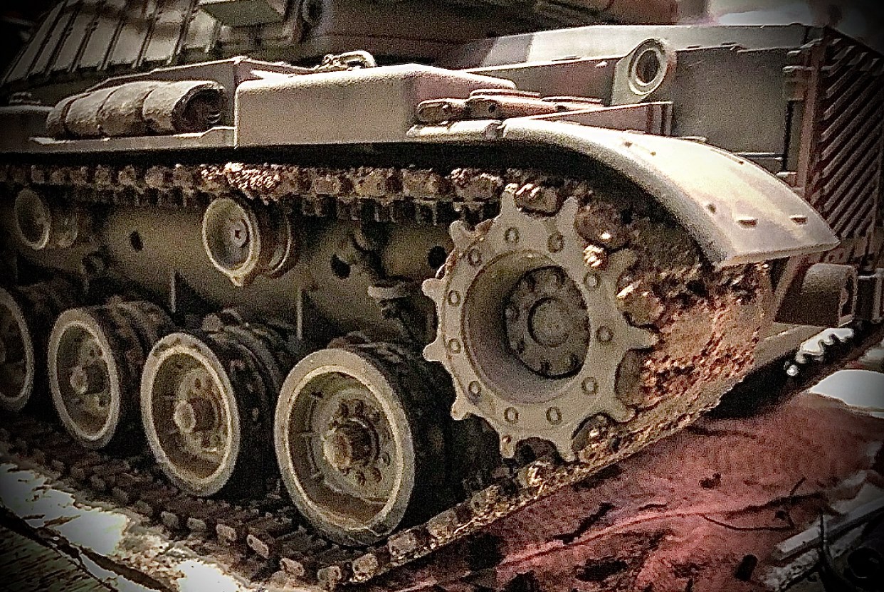

  • Rubicon99
    Out of curiosity and knowing not to do so, I threw caution to the wind and took two M60 out to play in the some medium thickness of mud. Surprisingly both did really well and nothing broke....LOL. Mud is the one thing that will break and gum up an RC tank fast. It is something I have learned to avoid if possible.
    Here are a few photos after most of the mud washed off/removed. I left some on tracks since it looks good when dried and adds to the overall weathered look.

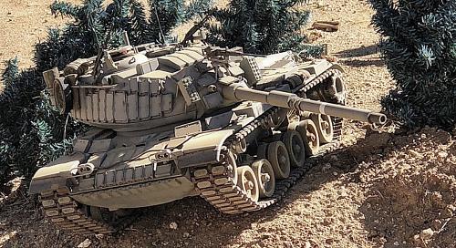

  • Rubicon99
    Originally posted by keilau
    I have the M60A1. For all practical purposes, the parts are interchangeable with the M60A3. I have to agree with you that the weak, brittle torsion bar suspension bracket is the number one problem. Hope that you get the upgrade bracket back for sale soon.
    The problem is not limited to there. Tongde use soft plastic and mold in thinner chassis wall that need braces. Tongde use soft metal screws that strip easily. I replaced all of them with hard steel screws, most of them are metric M3 size. The plastic gearbox came with a 1" long crack on the case. I ordered a metal gearbox from dklmrc.com and mount them using steel screws.
    I upgraded the plastic suspension arms to metal arms. I replaced all the nylon bushings to standard ball bearings. 2 bearings on the metal arm and 2 on the plastic road wheel. The Tongde chassis has perfectly molded channels for the bearings. It is not cheap to do this upgrade, but it greatly improve the running and durability. It is possible to build a strong, good running and durable M60, but not necessarily cheaply.
    Overall, the Tongde M60 series of RC tank is an excellent choice in subject, very good design, but extremely poor in manufacturing execution. I heard that they are improving. I will need to read a little more in review before I order the TD Centurion V.
    I don't necessarily disagree agree with you. There is room for continued improvements and they are showing up. Examples are the improvements to the hexagonal track detailing, mantle/breach mount, tougher black "plastic" and backing issue which is not present in my newest M60 (below) so something was (?) changed.
ID:	393294(TongDe M60A3 converted to a Magach 6B with custom 3D printed ERA, accessories and proper M68A3 barrels.)
    The return roller issue is not exclusive to the TD M60 and IS a problem on Heng Long modern "plastic" tanks like the Abrams, Leopard 2, T72 / 90 and Challenger 2. All have the same issues as the TD M60 rollers. The difference is TD is listening to customer input and has been made aware of the problems. They have said it will be addressed shortly, something Heng Long would never say or do.
    Now I do have to disagree "sort of" with your assessment of the M60 needing hull supports. This is absolutely NOT the case if the stock mounting screws are used to hold the upper and lower hulls together. In fact I have run my M60s (four of them) quite a lot without the upper hulls attached and done so over rather rough terrain with absolutely no issues. That does not mean support are not helpful, they can be especially if the end user converts the hull mounting method from screws to magnets and is also running the extremely heavy metal TD tracks.
