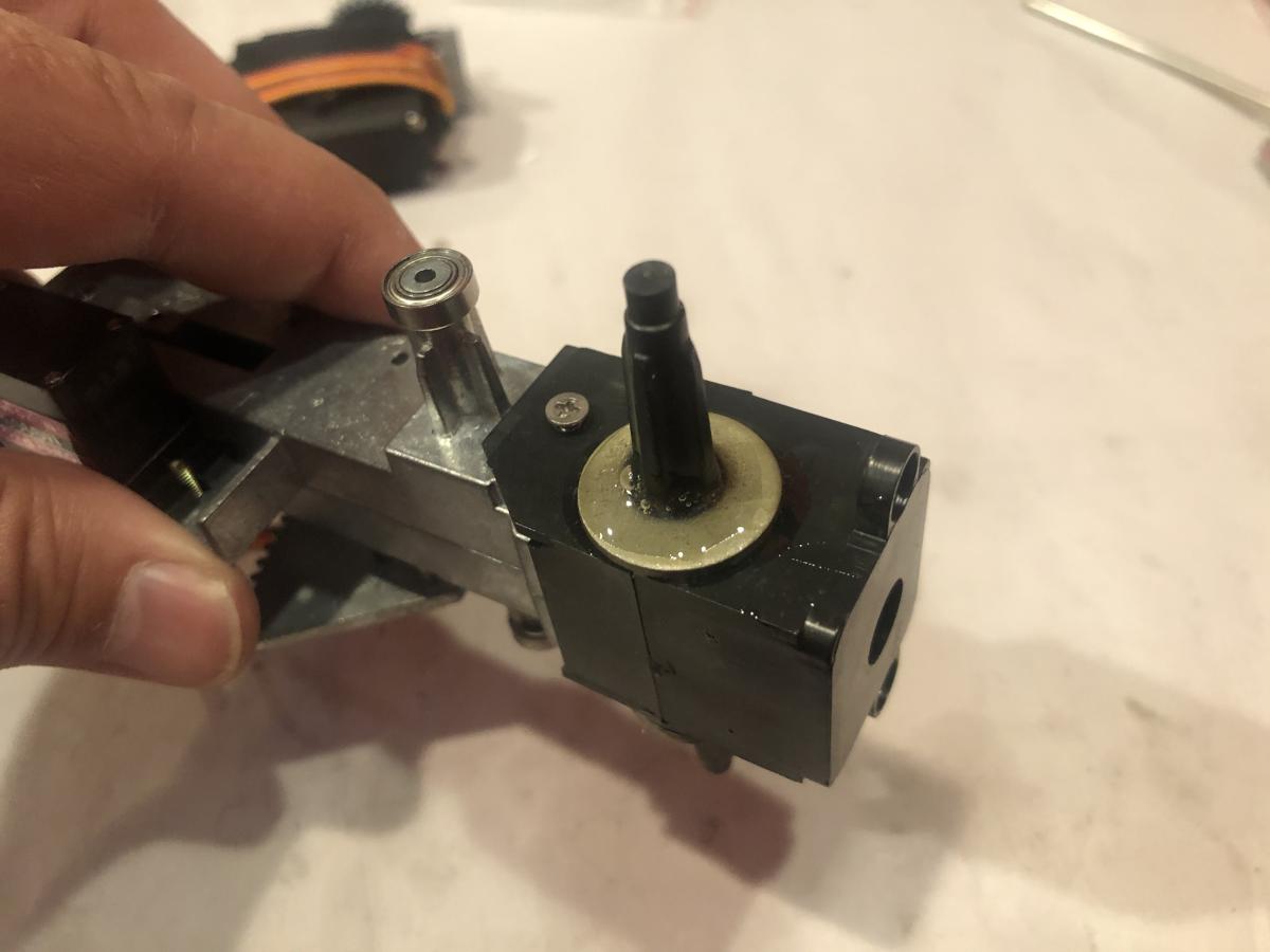

    Now that most of the mechanical issues have been tweaked to my liking and a new 7.1 HL control system is installed it is on to the next item. The metal road wheels.
    The metal wheels are one piece with both an inside and outside bearing. They have rubber "tires" that are a bit loose and should be glued on to keep them from coming off (something I did after the first test drive).
    The wheels are held on via stainless steel axles bolt to the suspension arms. This is similar to how Tamiya wheels are attached and it works very well.
    The plastic hub caps do not "pressure fit" in place like HL caps they need to be glued on, again similarly to Tamiya hub caps. I use a black auto gasket silicone to hold the caps on. This has worked well for me over the years. It is strong holding but easy enough with a firm twist of the hub cap to remove should maintenance be needed.
    Overall the road wheels and the way they attach to the suspect arms is very good and I foresee years of trouble free operation from them.

    Silicone glue to hold hub cap on.

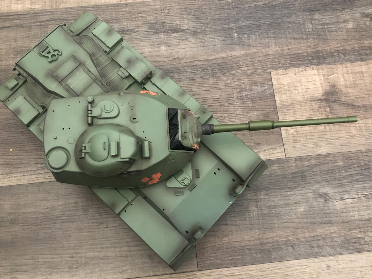

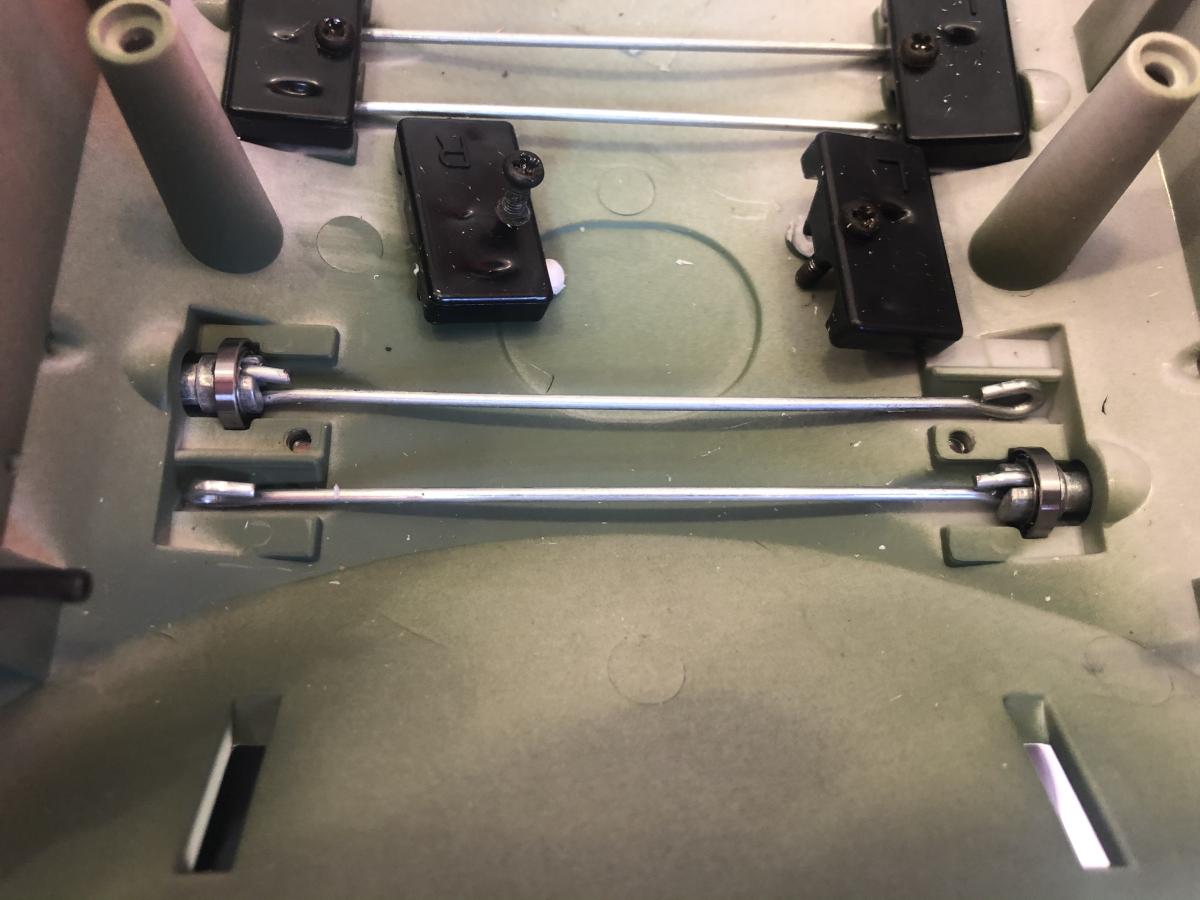

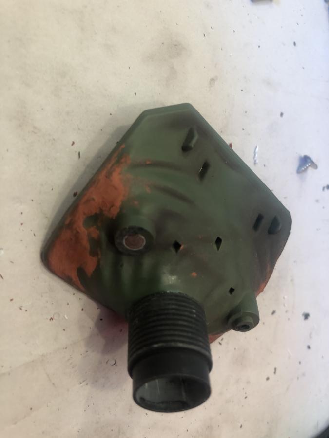

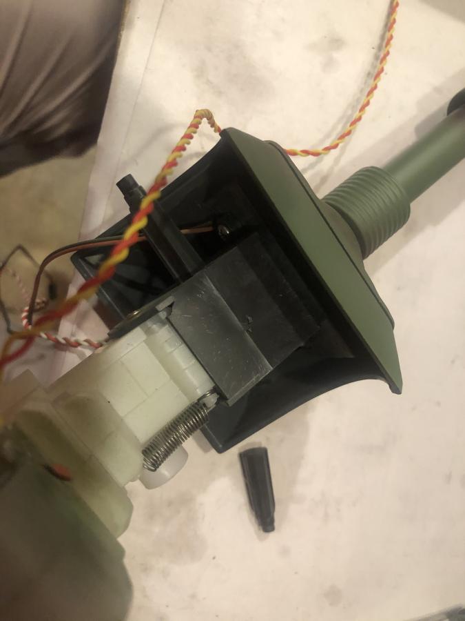

    Worked on repairing the broken gun mount and decided to strengthen them in the process. Added a large metal base ring to them and epoxied the ring and mounting arm together. Used this method a few times before and it works well for me (see photos below).

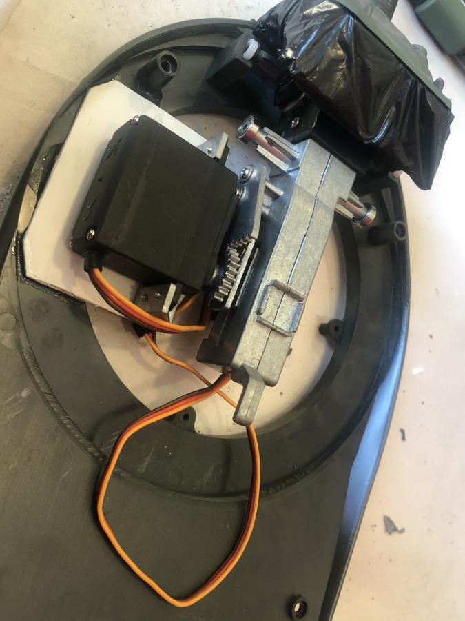

    While I had the turret apart I stripped everything out and installed a metal HL servo recoil and servo elevation system. Along with this I added a more accurate/scale 105mm M68 canon made by JVM3Dconcepts. The barrel REALLY changes the overall look of the turret from what was very toy like to now something more hobby grade model like (see photos below. Barrel is primer painted only).

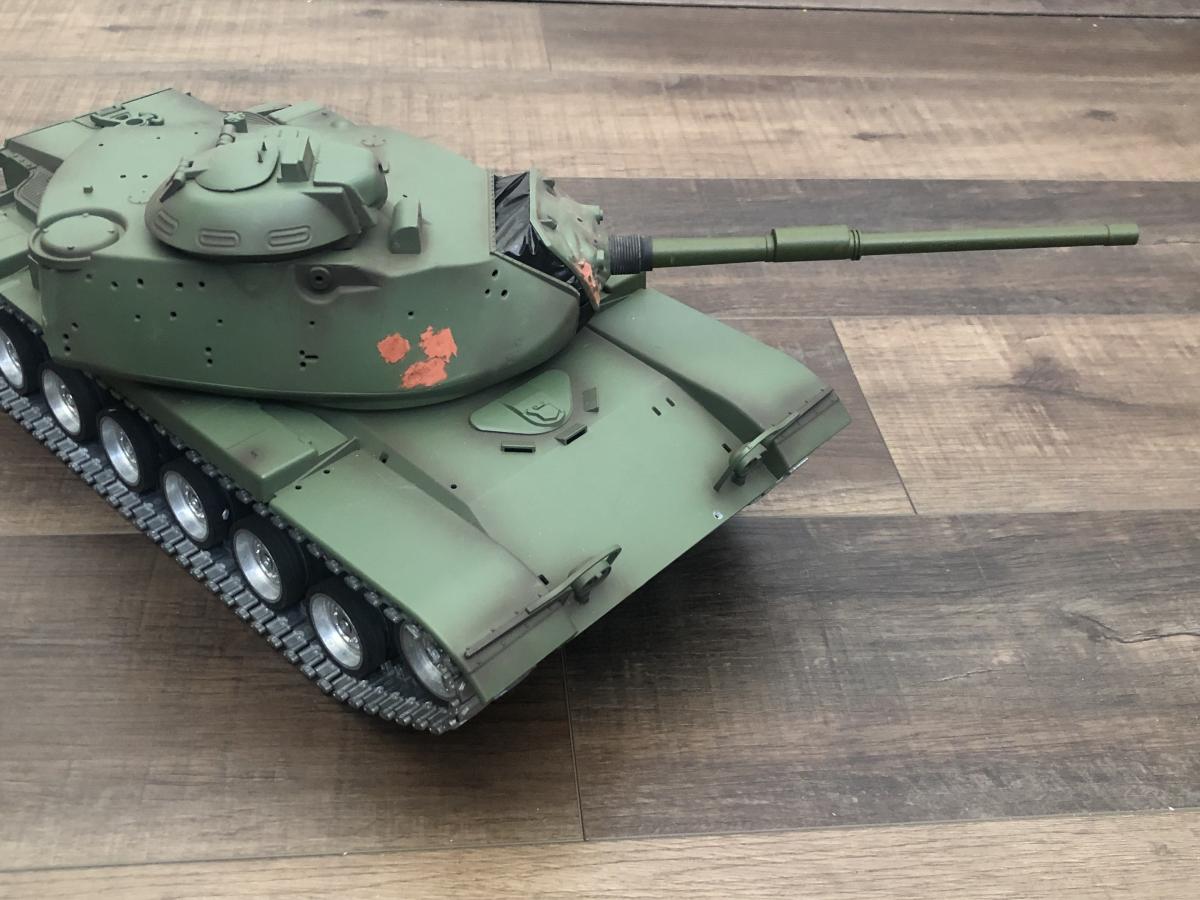

    A few other little turret detail changes. I added a cover to the stock mantle that when painted will have more of a correct "canvas" look vs the smooth sided plastic that TD used. Also I am sealing off the extra mounting holes on the mantle that are for use with the A1 versions ERA plates. Since I also do not like the way TD did the smoke launcher I am sealing those mounting points as well and will be adding more correct smoke launcher mounts once they are printed. Again JVM3Dconepts is designing those and will be available soon.
    Main gun mount and strengthening fix. Click image for larger version  Name:	F25AFEAA-8862-4915-A601-553073837B60.jpg Views:	0 Size:	58.4 KB ID:	375168
    HL metal servo recoil and elevation system.
    Click image for larger version  Name:	F1E0941A-D021-41A6-869A-64468C9E125D.jpg Views:	0 Size:	66.8 KB ID:	375169

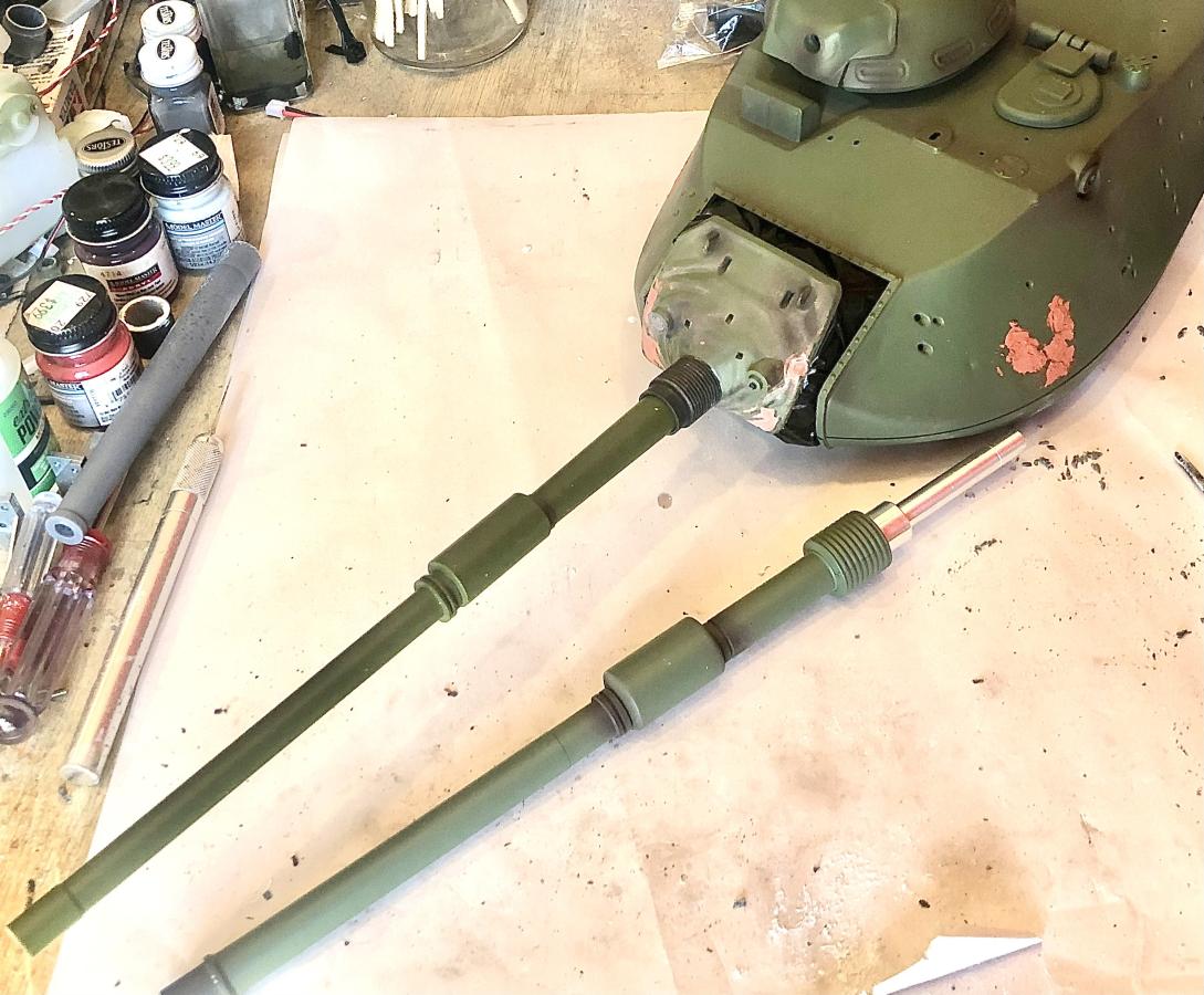

    Filling the extra mantle holes and attaching a more correct barrel baffle. Click image for larger version  Name:	BD0B246A-D183-4FAB-A319-E4FDC43C3694.jpg Views:	0 Size:	37.5 KB ID:	375171
    Installed new more accurate 105mm M68 cannon by JVM3Dconepts. You can see the difference compared to the stock TD barrel laying next to it.
    Click image for larger version  Name:	5F0B8769-65FF-4029-AD74-9D64E5E52277.jpg Views:	0 Size:	135.7 KB ID:	375170

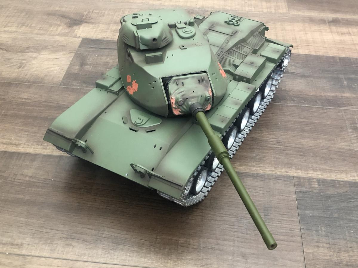

    Misc photos of the current build status.
    Click image for larger version  Name:	B83DC19D-A204-4C1B-9A99-2E76849390F5.jpg Views:	0 Size:	122.5 KB ID:	375172Click image for larger version  Name:	B906BBBC-9375-4623-80F7-6CB79BD8DE73.jpg Views:	0 Size:	152.1 KB ID:	375174Click image for larger version  Name:	576514AC-CC23-4D14-8505-ACFB0C7404DE.jpg Views:	0 Size:	132.3 KB ID:	375173
    Next I will be finishing up the turret and replacing the TD control system with a HL 7.1 system. Don't worry I will be getting to the suspension and road wheels soon.

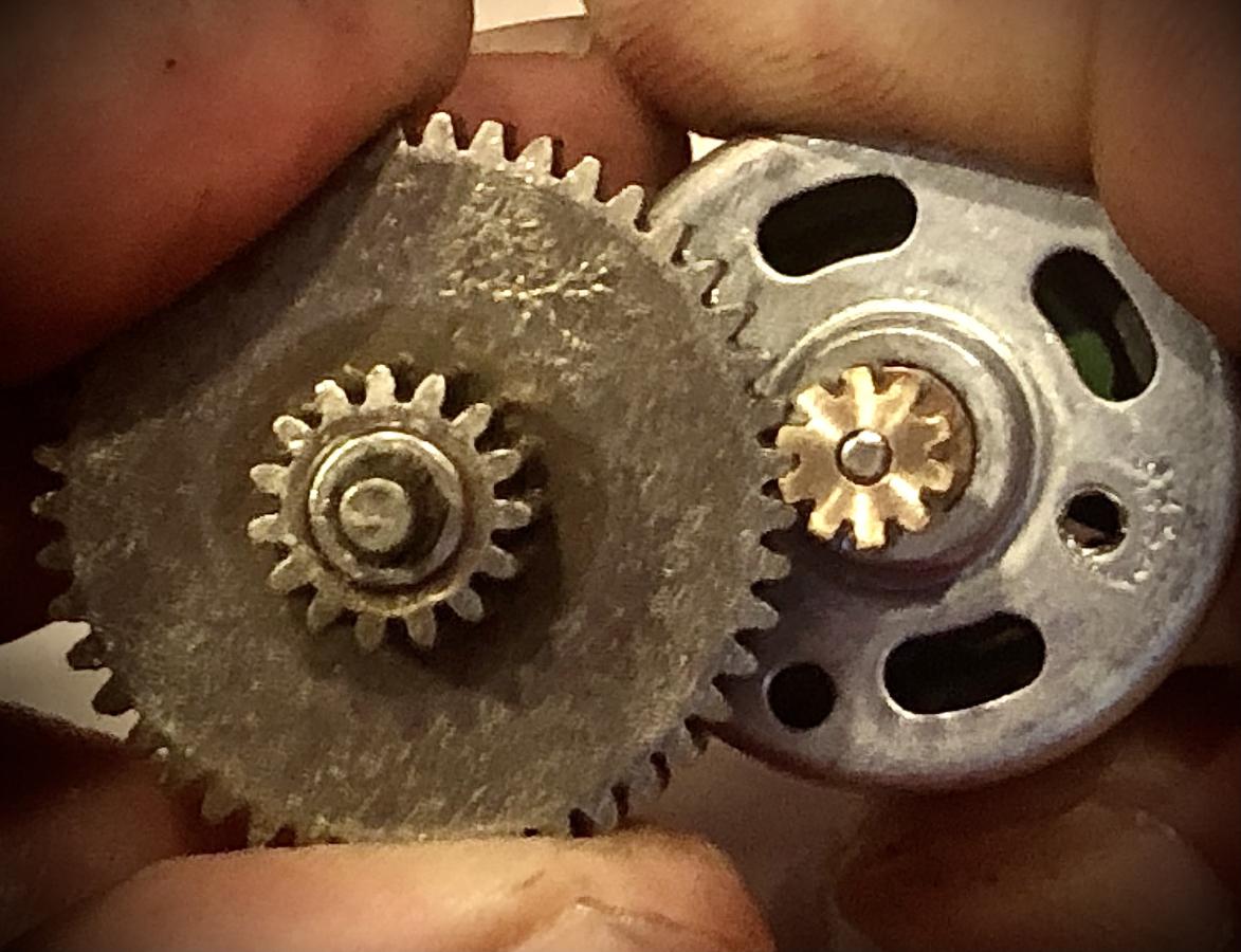

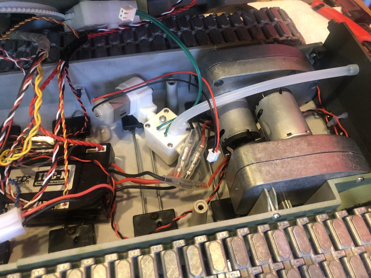

    Removed the left gearbox and found the reason for the jamming. The motors pinion gear has "flat" gear teeth that are not able to fully and smooth mesh with its corresponding gear. I replaced the stock 380 motors with HL blue 380 motors as these have more torque and a much smoother fit/mesh. See photos below.
    TD stock 380 motor pinion gear mesh up. As you can see the mesh is not very good and as such would "catch" and cause the motor to stop turning.
    Click image for larger version  Name:	207CAC69-53E6-430E-9734-0B0DA0CA579C.jpg Views:	0 Size:	123.6 KB ID:	375126
    Heng Long blue 380 motor. You can see how much better the pinion meshes with its corresponding gear. Click image for larger version  Name:	93130B61-AFCD-4895-80FB-B50DC8BE1E36.jpg Views:	0 Size:	93.4 KB ID:	375127

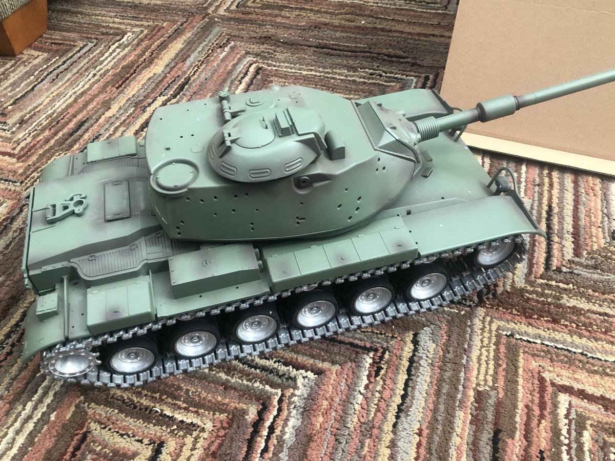

    Finally got in a metal version TD M60A3. Unfortunately things are not starting off well. It arrived with a broken main gun mount, broken rear engine exhaust panel and jammed left side gearbox.
    On a positive note the gears are steel and the gearboxes are all have bearings. Also the arrangement is the same as used in HL gearboxes and it would be as simple changing of the bearings to use HL gears. I tried.....they fit.
