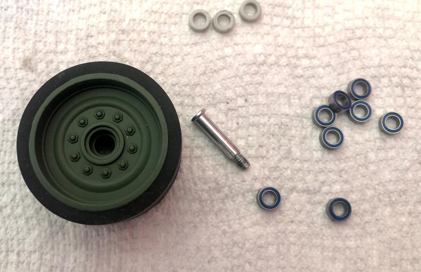

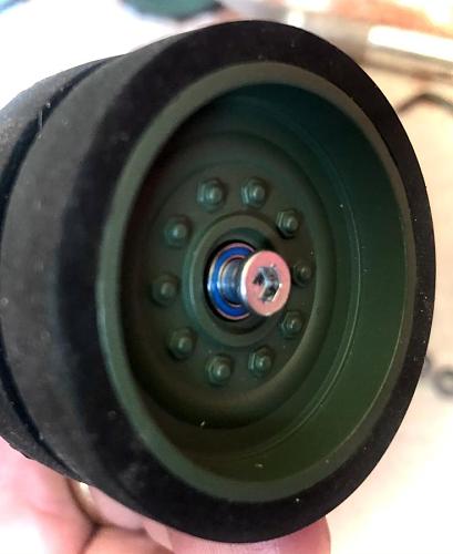

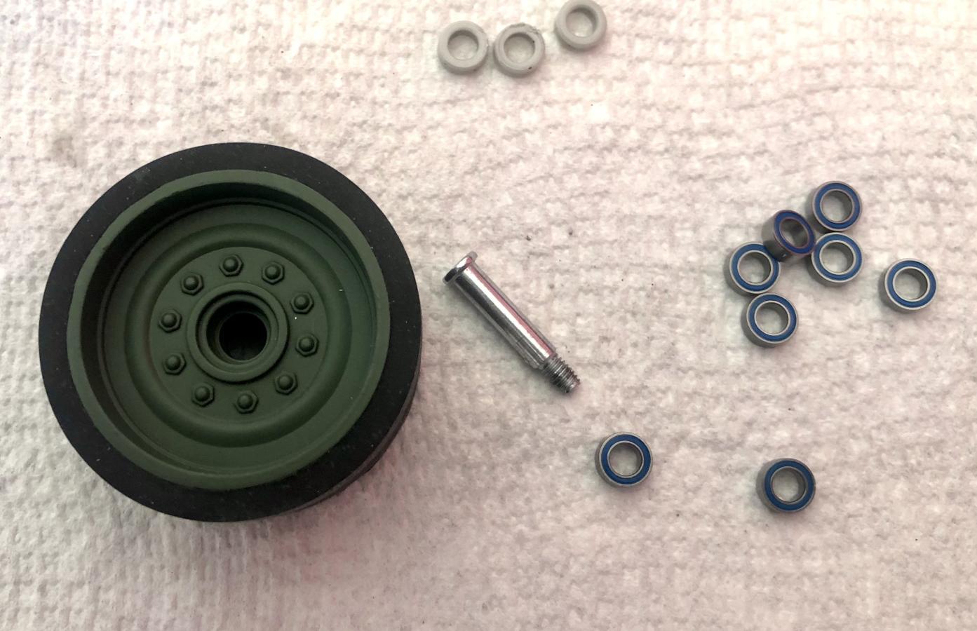

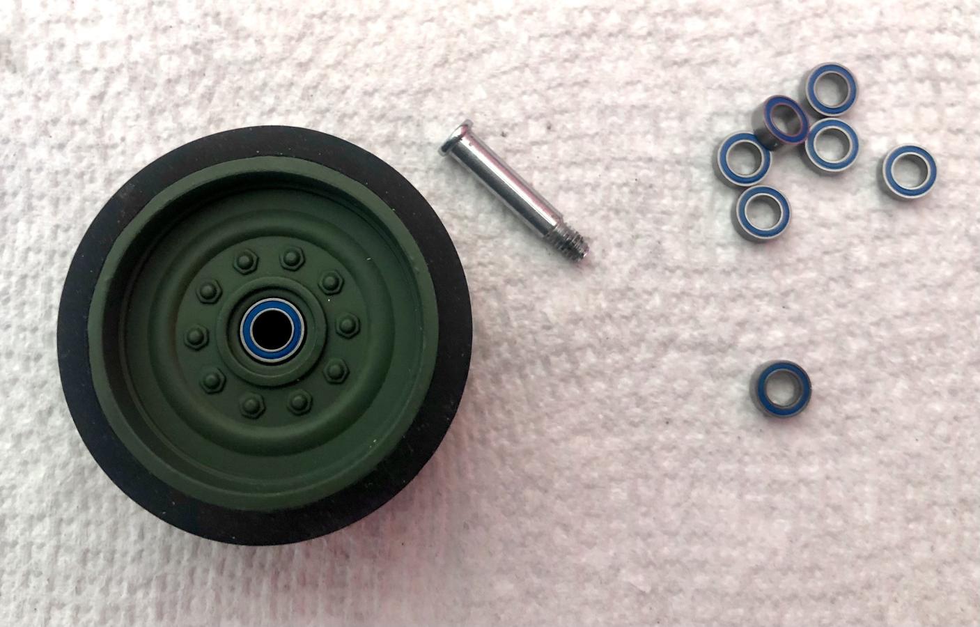

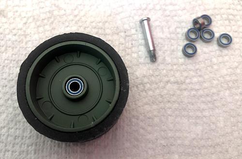

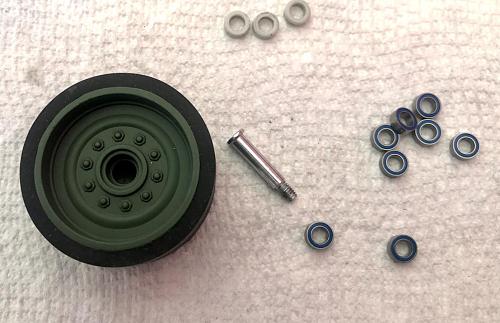

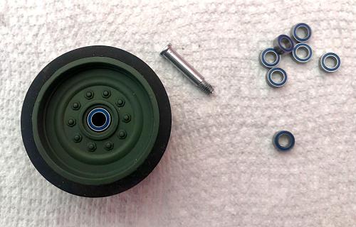

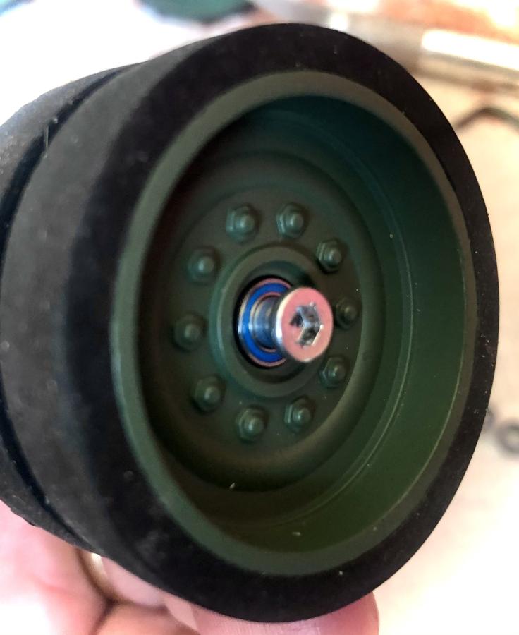

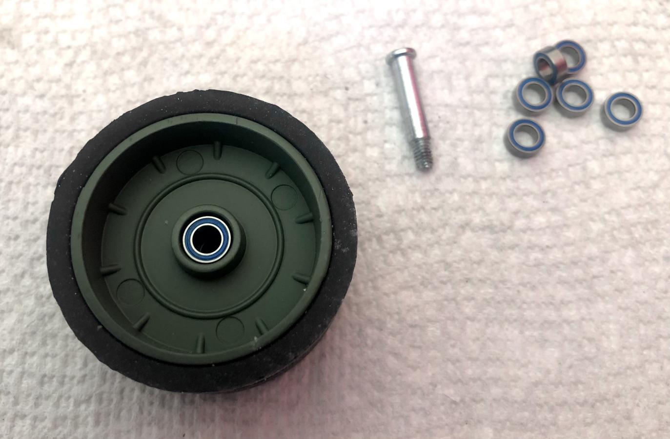

    Bearings for the plastic TD M60.
    The bearings size for the TD plastic M60 wheels and idlers is 4x7x2.5mm. I am using sealed bearings I bought off Amazon shown below.
    I did not buy flange bearings, I think that flange bearings might improve the wheel performance even further if used on the back side of the wheels as they would eliminate all remaining movement "in/out" if one desires absolutely perfection.
    Note: TD did NOT use flange bearings in the "metal" wheels the little in/out movement there is has had no effect on track retention performance.
    Click image for larger version  Name:	8116F1BF-8B7F-458B-B337-C531C5066713.jpg Views:	24 Size:	140.8 KB ID:	376995Click image for larger version  Name:	A6EF9050-7ADD-4F9E-8003-D3C8E1E14BDB.jpg Views:	24 Size:	132.5 KB ID:	376993Click image for larger version  Name:	544661EB-B7AD-4E77-9706-1C164359F383.jpg Views:	34 Size:	49.9 KB ID:	376991Click image for larger version  Name:	B027432C-2B38-4099-9465-0F82089446B8.jpg Views:	24 Size:	109.0 KB ID:	376992
