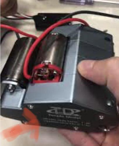

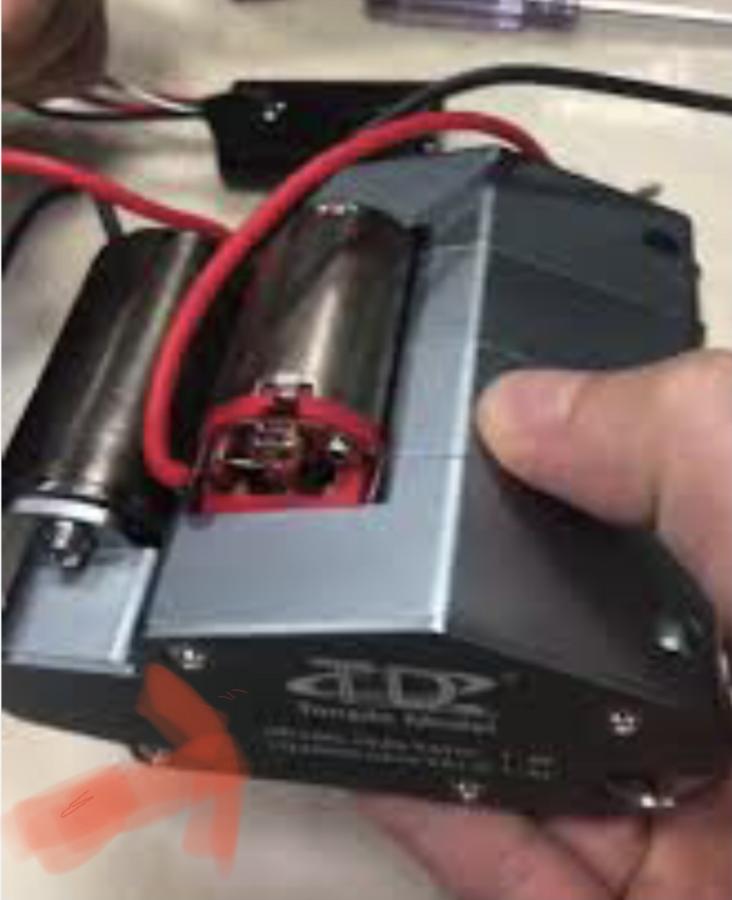

    Looks like I was correct about the mounting points underneath the M60 gearboxes. This is a copy of the HL cross drive gearboxes that TD is realizing soon. Click image for larger version

    None of the parts will fit *. I have tested everything that is even close. The tracks and sprockets are wider then anything comparable and the sprockets have a rather aggressive negative backspacing/axle mount that is needed to a-line them with the road wheels.
    The TD metal gearbox are actually quite nice, very comparable to the Heng Xin. They use steel gears, full bearings and are completely enclosed. The gearboxes disassemble and reassemble rather nicely. They also are super easy to manipulate both taking out and put back in. The screws mounting arrangement looks questionable, but it works very well. I have not experienced any issues with the mounts or screws. The only issue with the gearboxes I have experienced is with the motor pinion gears, they did not mesh well. But simply changing the 380 motors to something nicer solved that issue. There is and is not enough room for 390 motors. They can be made to fit, but it's not simple drop in, some minor modification are needed.

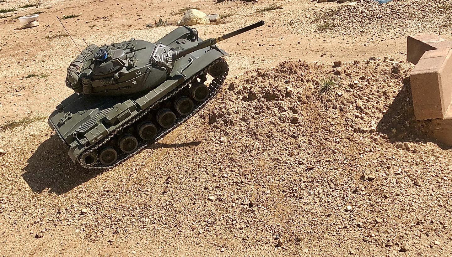

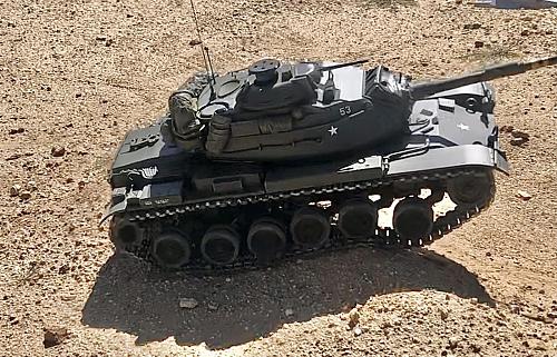

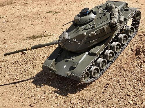

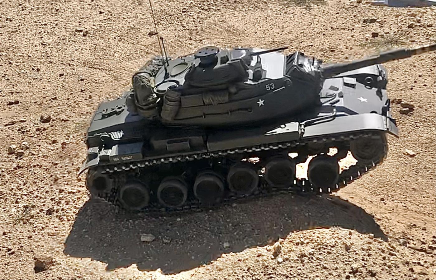

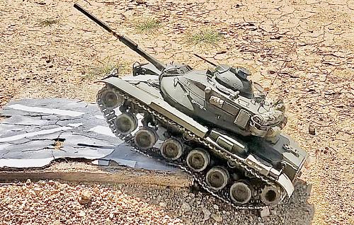

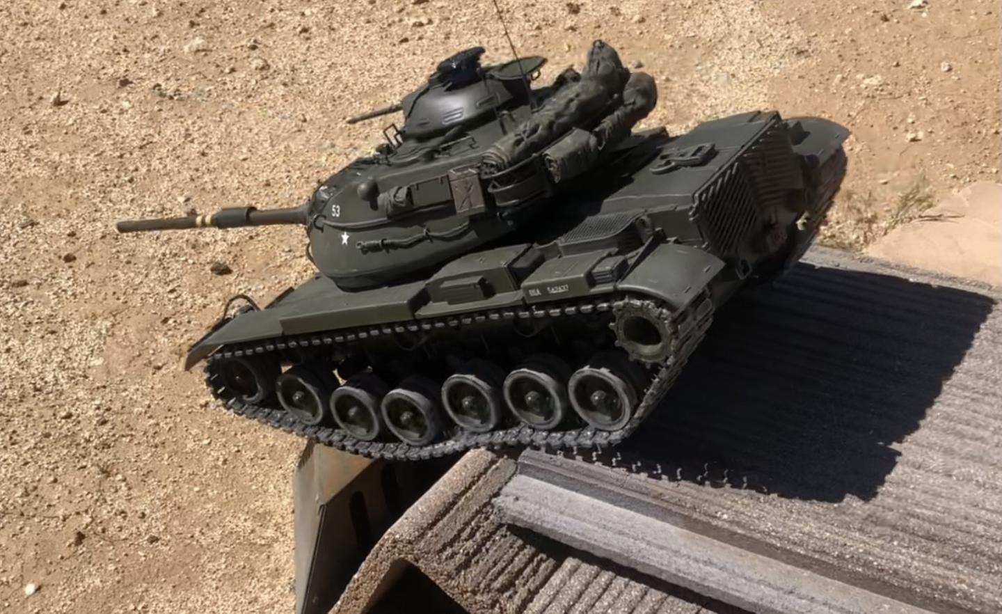

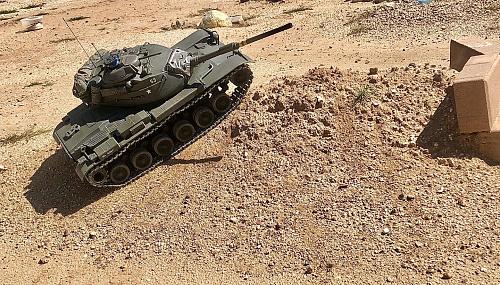

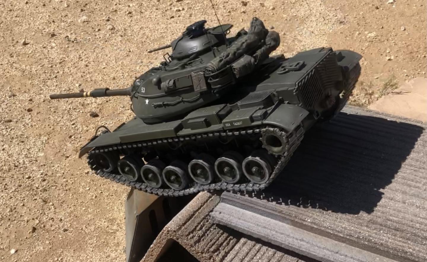

    Test photos continued.
ID:	375679Click image for larger version
ID:	375680Click image for larger version

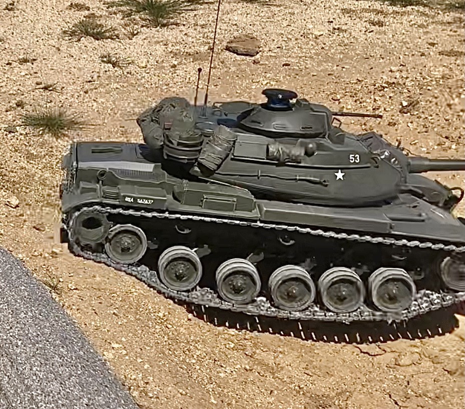

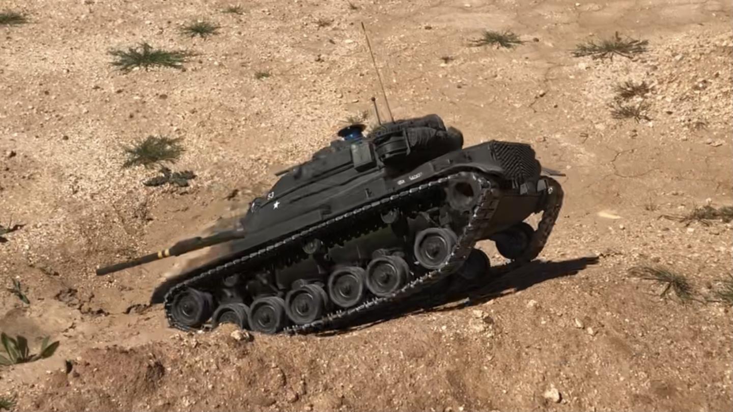

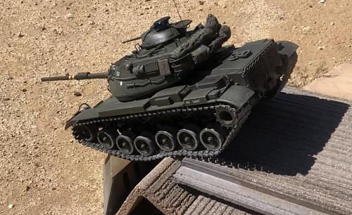

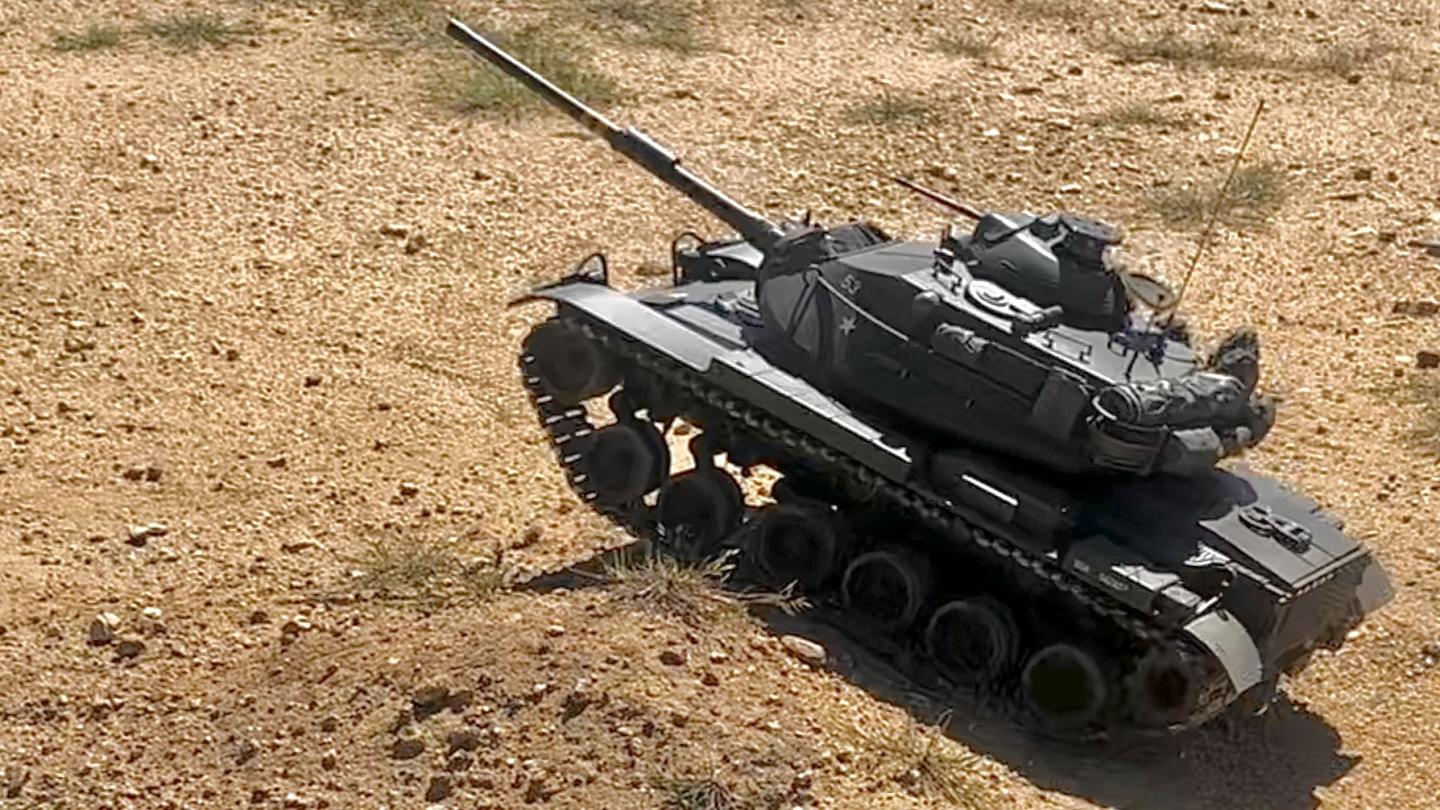

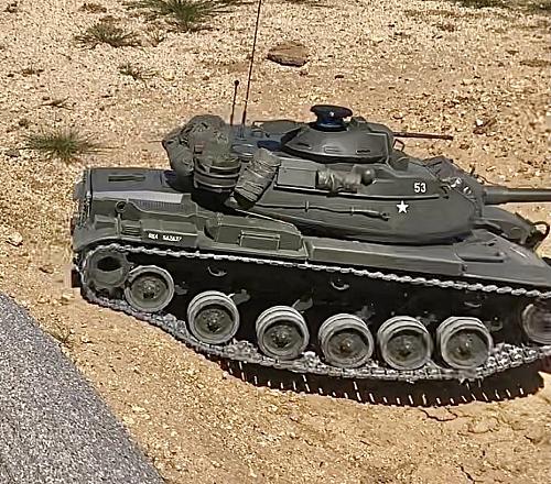

  • Rubicon99

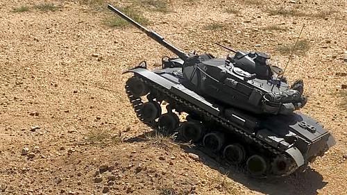

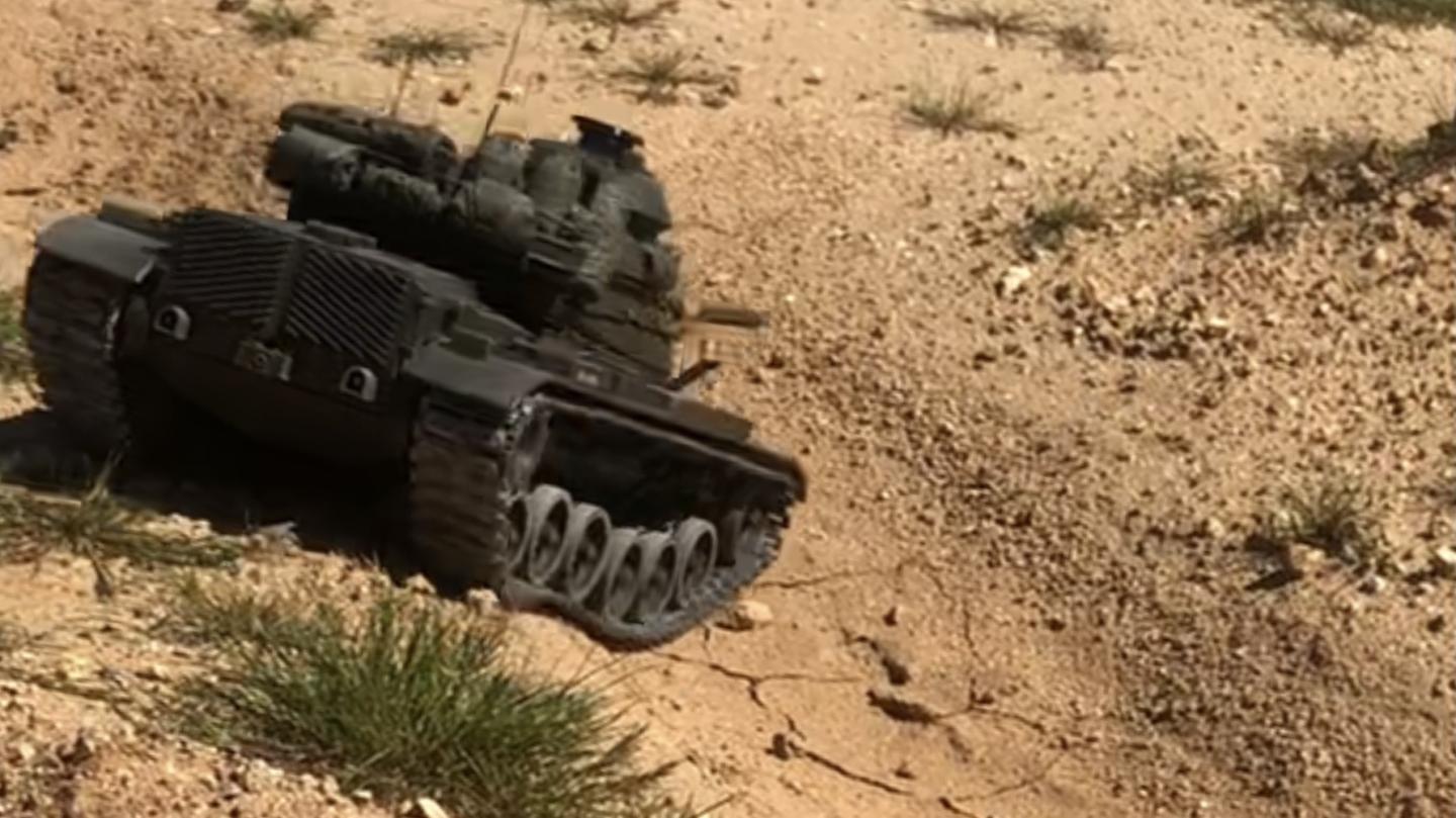

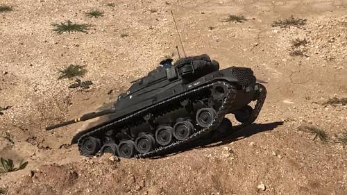

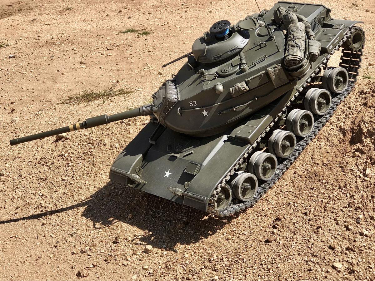

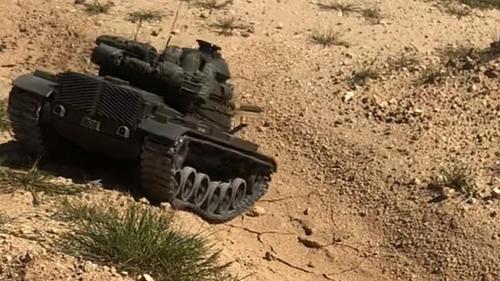

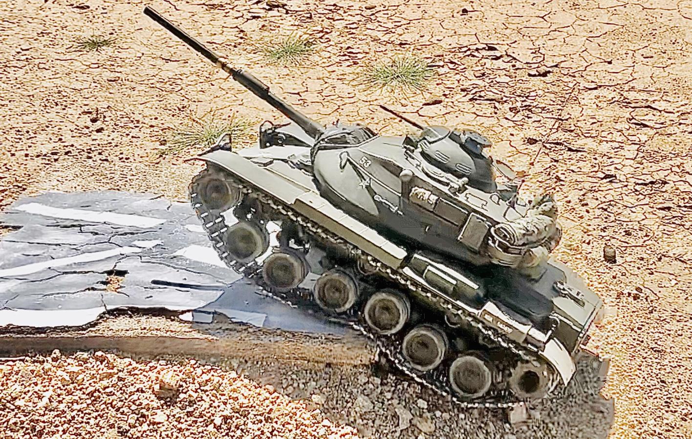

    After installing the travel limiters on the rear suspension arms I was able to get out and thoroughly test the M60 and all the issue with over travel are gone. So now I can give my overall impression of the M60s driving and handling performance.
    The TongDe metal version M60 with the improvement of a HL 7.1 control system drives similar to a large HL metal version Abrams, Leopard 2, King Tiger or Challenger. Where it differs is in the way the suspension / road wheels interacts with the terrain. The M60 is smoother because of its torsion bars vs the torsion springs used in HL tanks. The torsion bars work better with heavier tanks which the M60 and the others are.
    The metal M60 excels in rough uneven undulating terrain when compared to HL metal Abrams, Leopard, Challenger and T72/90. The M60 is a little short then the NATO tanks, but about the same length as the T72/90. It was able to surpass the excellent performance of the T72/90 in the undulating terrain test because the M60 has far better ground clearance, wheel travel and better approach/departure angles (with no tow hook mounts attached). It also had above average track retention and did not have any difficulty with holding its tracks on throughout testing.
    Over all (mechanically) I have to give the out of the box metal version of the TongDe M60 a solid 7 out of 10 rating when compared to comparable HL tanks such as those mentioned above. It has some minor mechanical issues that can be corrected easily for those with some RC or model hobby experience. When corrected the rating goes up to 8.5. Even with the minor issues I see more positives and potential going for the M60. So yes I would recommend it, but not as someone's first tank.
    Please feel free to ask any questions you may have about the TongDe M60.
    Photos from trials (testing) course. Sorry some of the more dramatic photos will not load they are to high in resolution, but I think these give a little idea.
