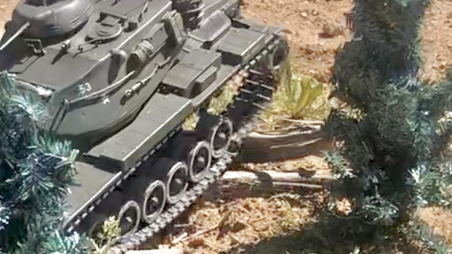

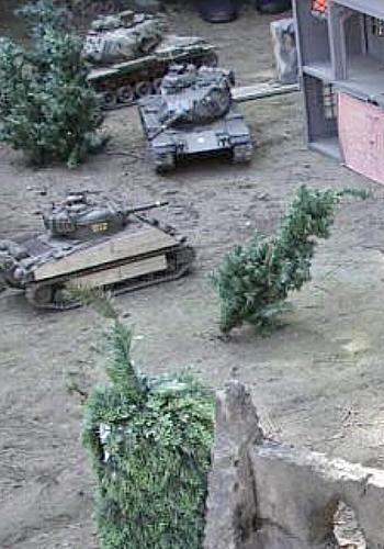

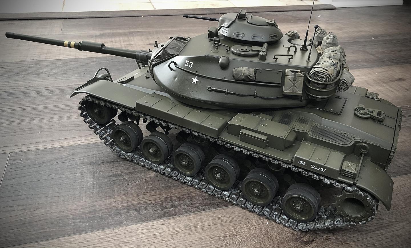

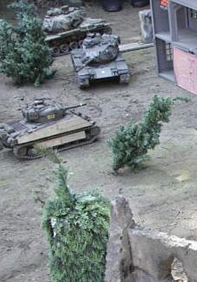

    The M60 completed it first official organized IR battle day at the April 2023 LA Tank Clubs monthly event. Overall it did well for a large tank on what is a CQB battle field that largely favors small tanks. Below are a few photos of the M60 on the field.

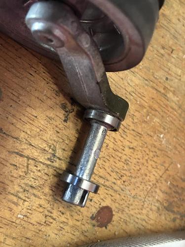

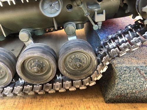

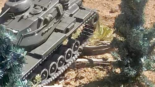

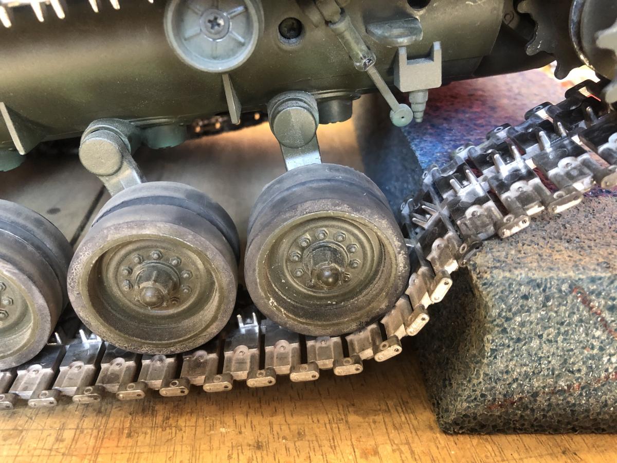

    Just prior to the LA event I discovered an issue with the M60. When back up even small steps or obstacle the Special rear road wheels/suspension arms have a tendency to over extend and then rotate forward (towards the front of the tank). This causes a huge amount of stress to be placed on the torsion bar "lock down" covers and can snap them in half. This issue I first thought was cause by my "tightening" of the torsion bars to produce more down force as the "metal" M60 is rather heavy and sags in the rear. By swapping out the rear torsion bars with ones that were not "tightened" I discovered the issue was still present and appeared to me to be even worse.
    The M60 does not have any suspension travel limiters either up or down. This is not a issue for the up or down travel while driving forward or reverse on relatively flat or moderately uneven ground, but the lack of limiters when the rear wheels are "weight unloaded" as in creating a hill cause them to drop beyond what is safe and into the range of over traveling. Then when backing over an obstacle the rear wheels do not travel upwards but instead travel downward into and often past the over travel range(see photo below).
    To correct this flaw in the rear suspension I am installing suspension travel limiters. These will allow for unlimited up travel but stop the down travel before the suspension arms/wheels rotate to far. The point I chose to set the down travel maximum at was the "resting point" of the suspension with the tracks off and the tank is elevated off the ground. With the limiters installed I believe the issue with over travel with be solved and the M60 will be a more durable and reliable tank. Why limiters were not installed during the design process I have no idea except to believe they never drove the prototypes in reverse over obstacle or even over hills.
    Battle day photos.
    Click image for larger version  Name:	3DC4A92E-3744-4C44-8C9E-307E7F471F75.jpg Views:	0 Size:	552.5 KB ID:	375471Click image for larger version  Name:	2AD9C974-F7A9-473F-A0FB-44D6ECF9A4AE.jpg Views:	0 Size:	81.8 KB ID:	375472Click image for larger version  Name:	794260E6-81A7-4532-90EA-84AABEFBD2B7.jpg Views:	0 Size:	606.0 KB ID:	375470
    Examples of what the over travel looks like. The suspension arm will still move quite a distance more towards from of the rear of the tank. I did not want to break anything just to get more dramatic photos. It was not fun fixing it when it did break.
    Click image for larger version  Name:	3FBCEB37-14D7-424C-8393-C84DF3B4D090.jpg Views:	0 Size:	180.5 KB ID:	375473

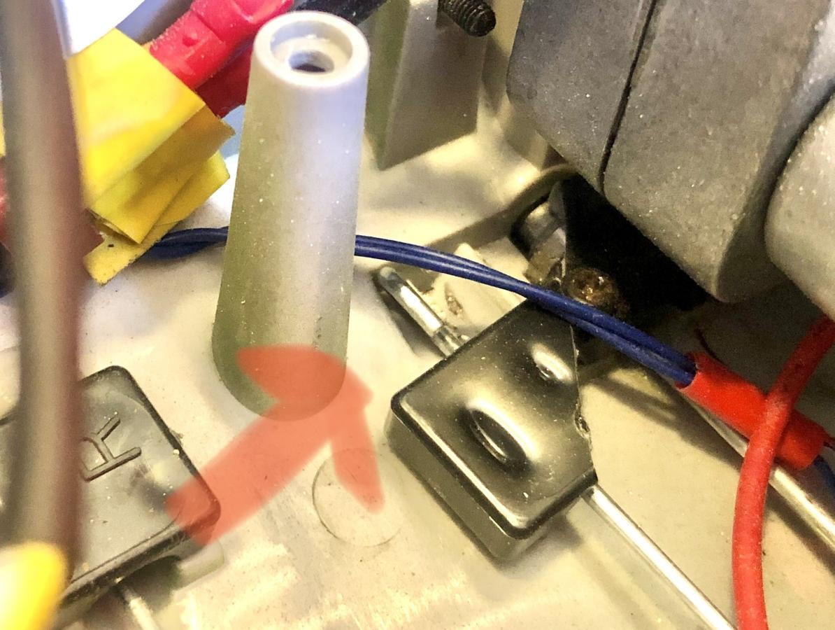

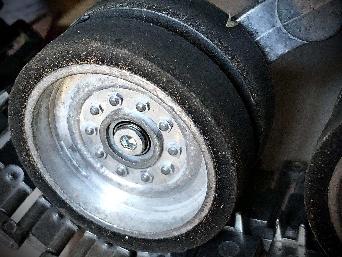

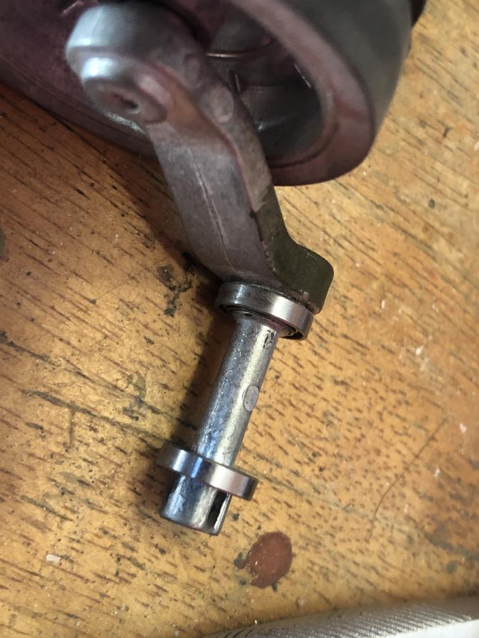

    Prototype of limiters I will be using. These are typically called collared or sleeve limiters. Click image for larger version  Name:	DCB73CAF-9033-4D8A-8F5D-5263CB25DAB0.jpg Views:	0 Size:	73.8 KB ID:	375474
    Oh and I discovered the suspension arms have two bearings not just one. That's a good thing👍👍 Click image for larger version  Name:	E4E3717F-9B93-4EAA-9DD7-1A8ECF24F5F5.jpg Views:	0 Size:	85.0 KB ID:	375475

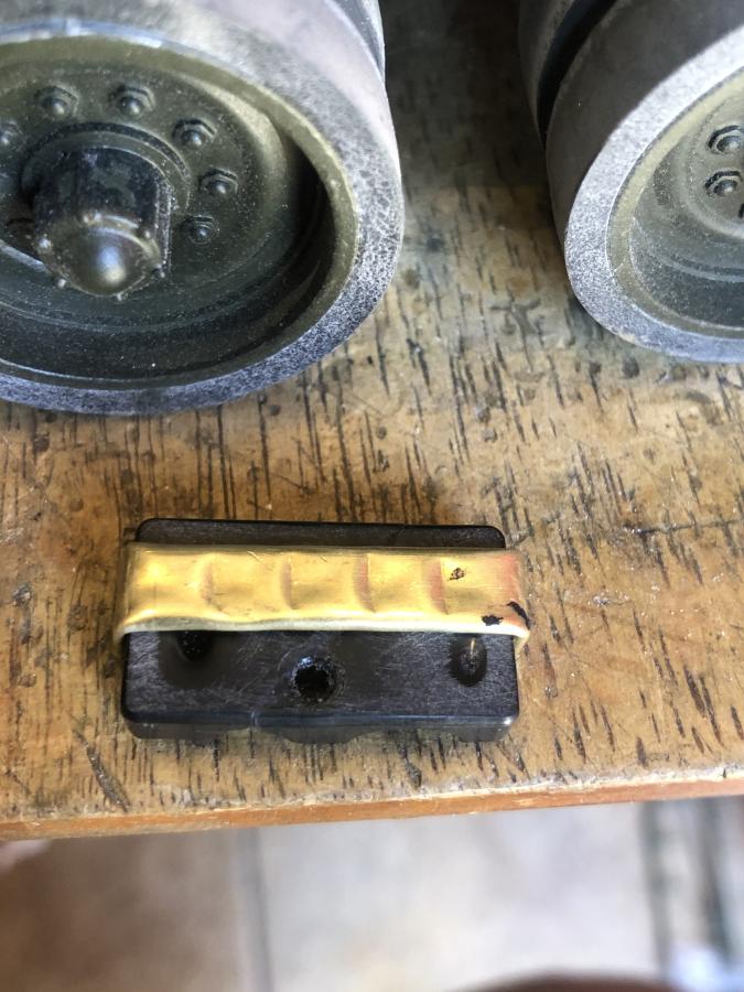

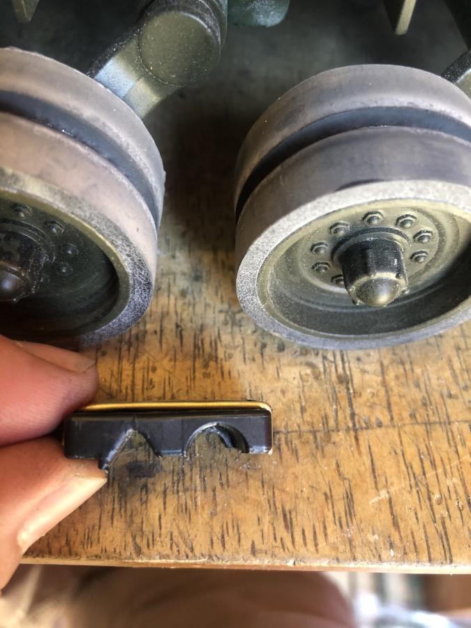

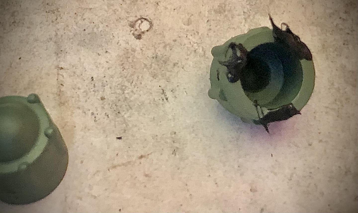

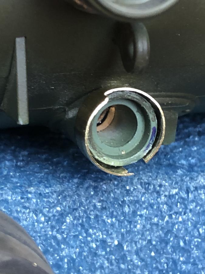

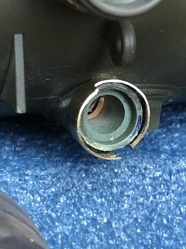

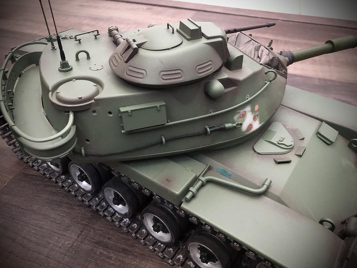

    Finished up weathering and got the M60 out for a solid T&E run. Ran great right up to the last moment when I decided to climb some rocks driving in reverse. As I did I over extended the left rear road wheel and it rotated over the wheel just I front of it. This caused a rather loud SNAPPING sound to be heard. Aka something just broke....
    The left rear Special road wheel was able to move as it did for two reasons. One it does not have a working shock absorbers attached(cosmetic only) to limit the range of travel and two I have the torsion bars "tightened" for more down pressure which caused the wheel to travel even further forward. Had I not "tightened" the torsion bar the SNAP and subsequent broken torsion bar mounting cover would not have happened.
    So what was learned? The torsion bar covers need be be strengthened and a simple re-enforcement/modification to the cover will add great durability for harder use. Also I will be looking at adding a down travel limiter to the Special right and left road wheels
    See photo of broken covers and my simple fix / modification.

    The brass C brace was made to fit snugly and was attached via an epoxy resin. I will be installing this modification to all the covers at some point in the future.

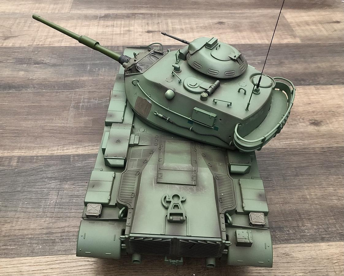

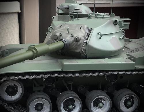

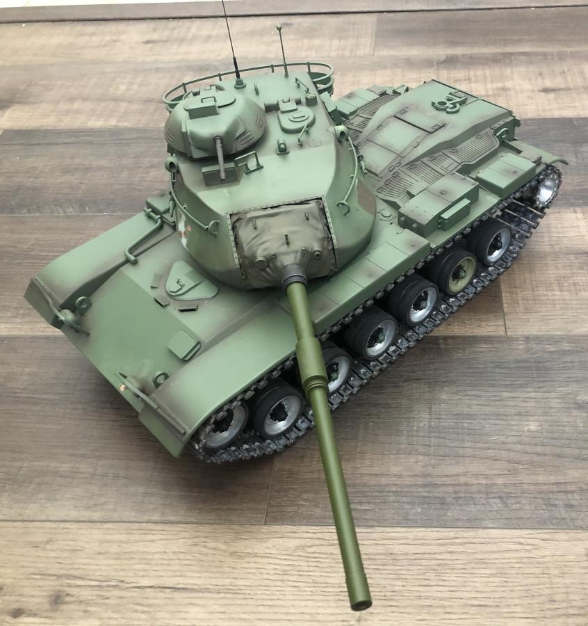

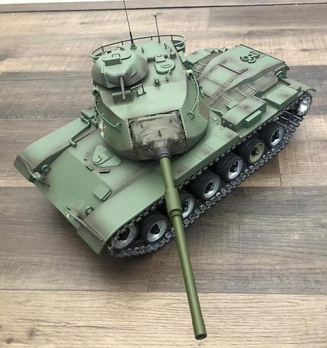

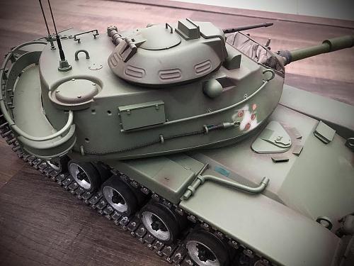

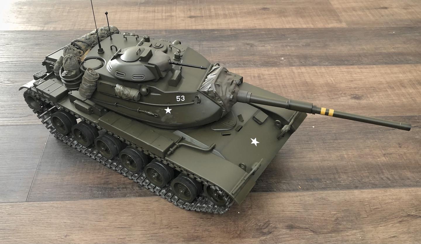

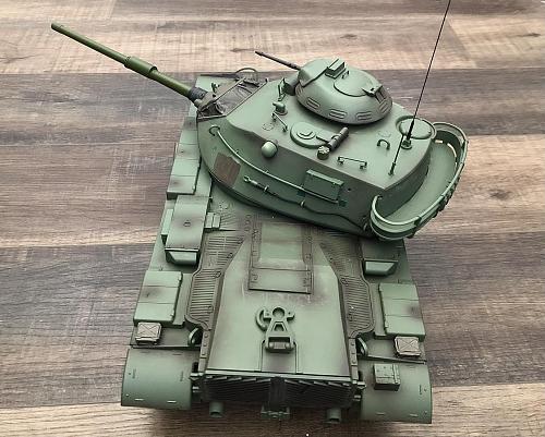

    Fresh out of the paint and detail shop and will be heading off to weathering next. Quite the transformation vs stock so far if I might say so....
    Click image for larger version  Name:	ADD40A2A-7689-4458-9E8F-0AE67C182A5D.jpg Views:	0 Size:	229.9 KB ID:	375279Click image for larger version  Name:	B9B3062C-C204-49D6-A538-1AC9FEA2EF66.jpg Views:	0 Size:	166.0 KB ID:	375278

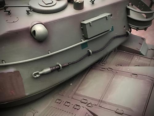

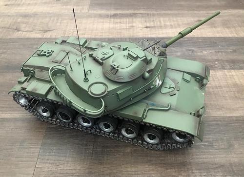

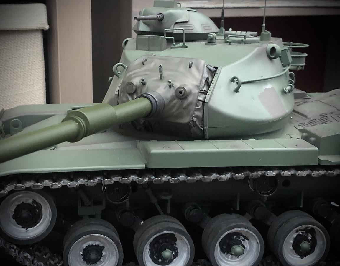

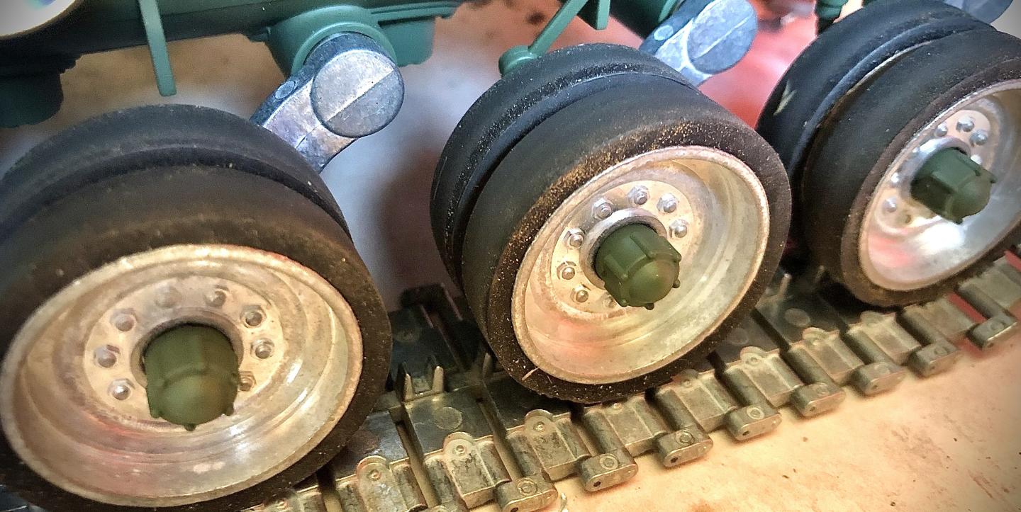

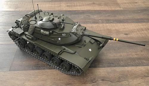

    Accessories have been installed and the tank is being taken out for it last test test run prior heading to the paint shop. Not overly impressed with the detail of most of the accessories especially the turret side "gas cans" fortunately I have others nicer ones to replace them with. I also had to modify a few other parts to look and fix correctly, namely the turret tow cable.
    Some parts were left off (hull tow mount/hooks and smoke launcher) because I have better more detailed version coming shortly. Even still I might not use all of them as front two hooks tend not to last very long give the way I drive my tanks.
    Shown below: Tank with most of the accessories on prior to painting. The black on the wheel hubs is paint not the silicone I mentioned earlier in this thread. Also the main antenna is not part of the kit accessories note is the main gun. Click image for larger version

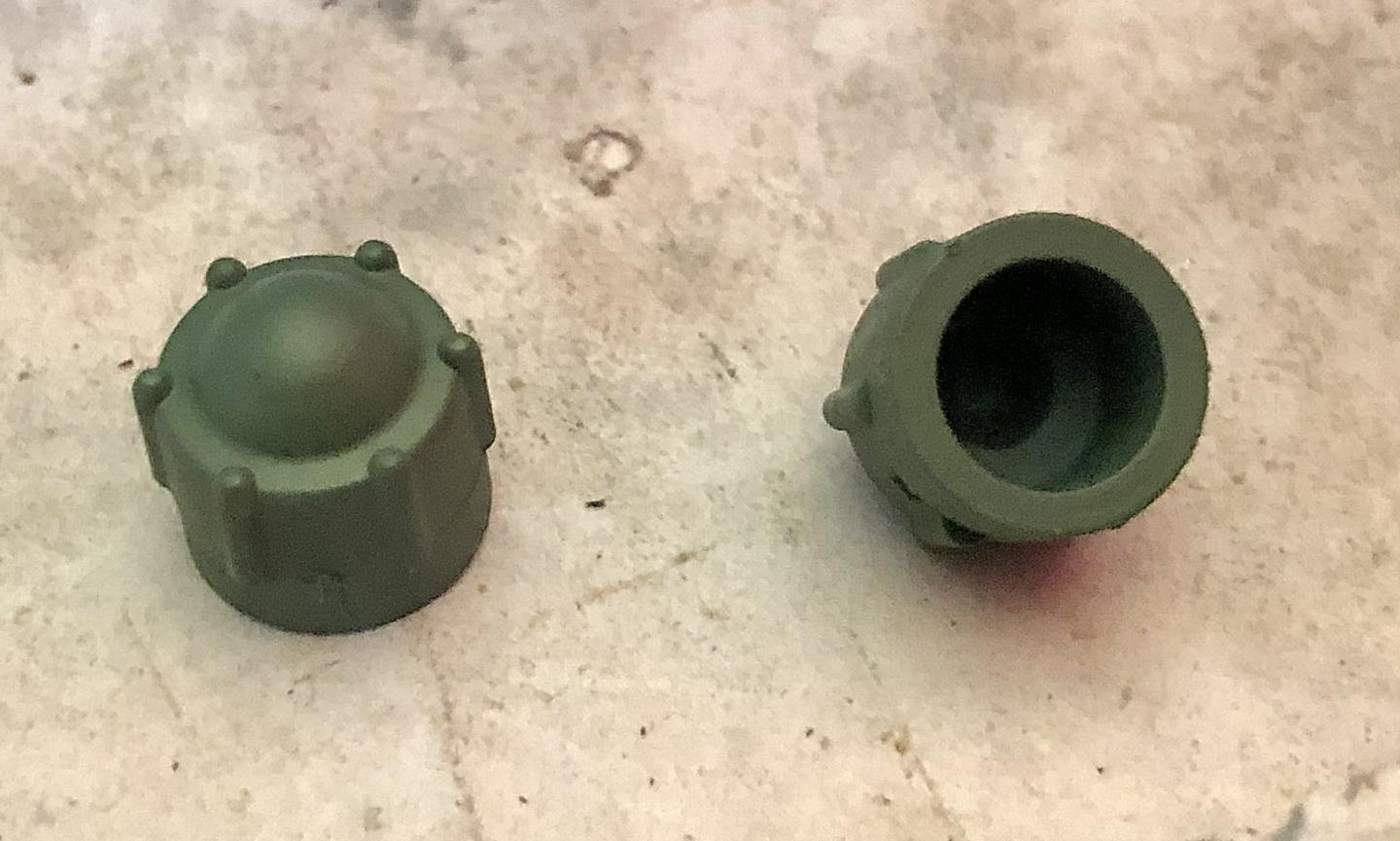

    Personally I think the metal ones would fall off easier as they are heavier so that's not an issue for me. I will use a rubbery glue or silicone to keep them on. What is strange to me is the plastic. It sands very strangely as in it sands much easier than both ABS or styrene. It doesn't seem to glue with Tamiya thin or Plastruct white bottle. Like I said before it did glue with Weld-on "#4" (IE: MEK), but it did require holding the parts together for a bit while the MEK dried. Paint seems to scratch off of it very easily. To me they aren't 3D printed as the parts on the sprues are injection molded and I see no difference between the plastic on the sprues from the plastic on the turret and hull as the glue melts both equally. I'm just not sure why kind of plastic they used for the injection molding.
    Derek

    You would have to ask TD. But metal or not they would still need to be glued on because they would still not pressure fit onto the wheels. Once painted no one will be able to tell if they are metal or plastic, besides metal caps offers no advantages over plastic caps IMO.
  • cmdrcody
    The plastic hub caps do not "pressure fit" in place like HL caps they need to be glued on, again similarly to Tamiya hub caps. I use a black auto gasket silicone to hold the caps on. This has worked well for me over the years. It is strong holding but easy enough with a firm twist of the hub cap to remove should maintenance be needed.
    They didn't supply metal hub caps?? All HL Pro Edition RTR tanks (full metal tracks, drive sprocket, idler and running wheels) come with metal hub caps for everything.
