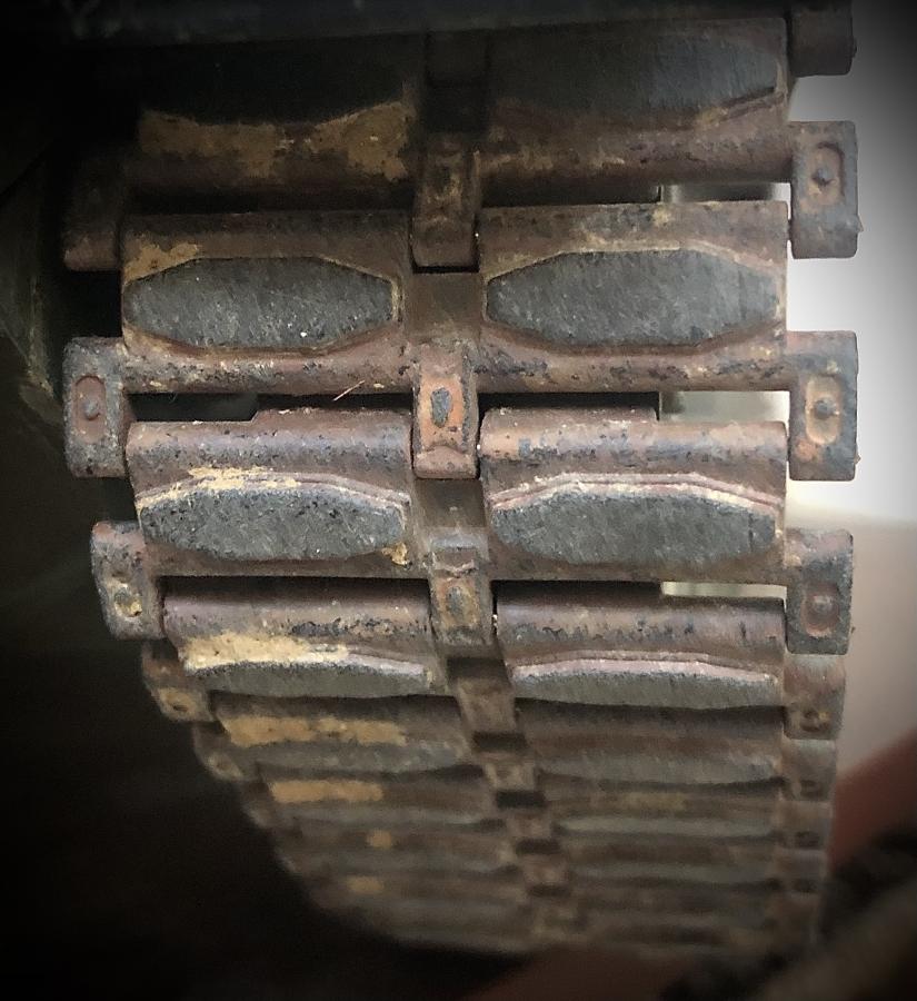

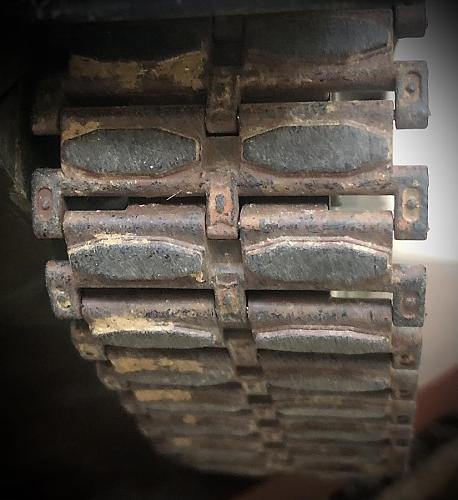

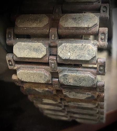

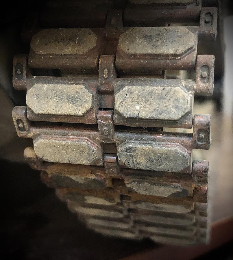

    Seems TongDe is listening to customer feedback on details. A change was made recently to the "hexagonal" style of M60 track. They are now more correct. Its a small change in detail, but overall it does make for an effective visual improvement.
    Old style hexagonal tracks.

    New style of hexagonal tracks.

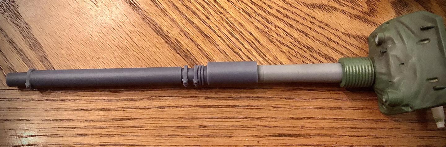

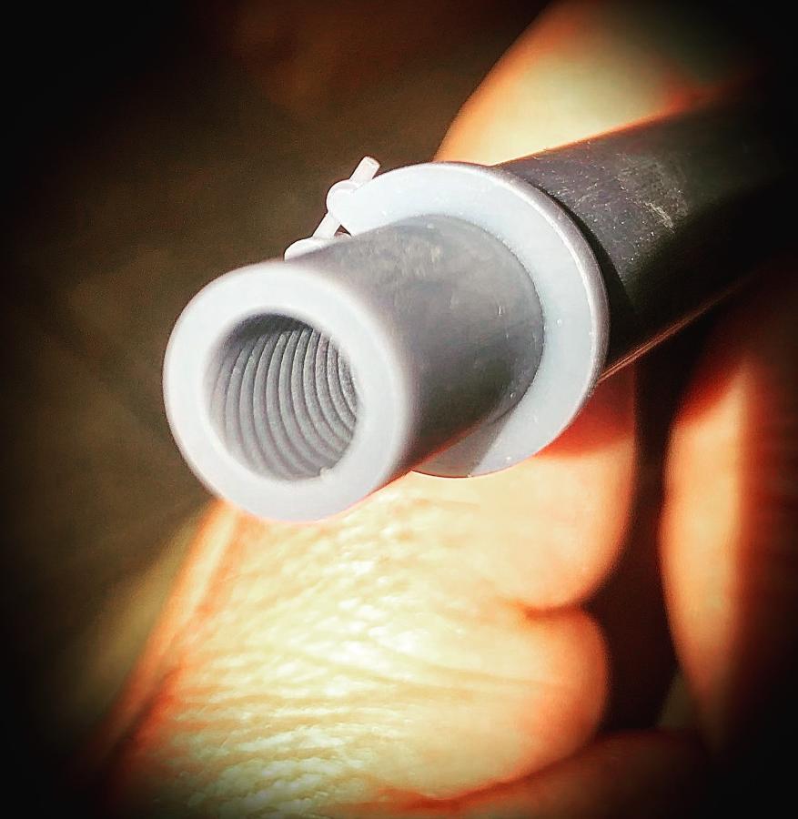

    Some cool new detailing parts for the TongDe M60 coming out.
    A new "M68 A3" barrel for use with barrel flash, IR battling or simply to improve the static look of the TongDe M60A3. The barrel even has "scale rifling". No it does not support airsoft.
    The barrels just finished production and will be available soon I am told through RichJohnson models.
    Show below is one of the prototype barrels during development.
