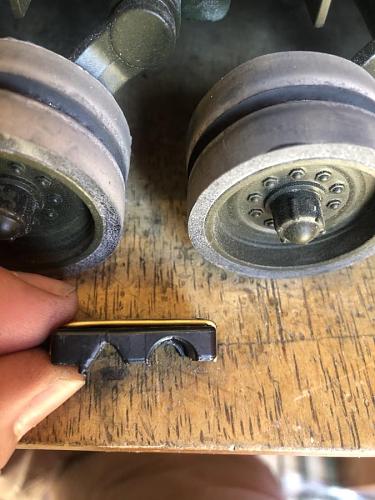

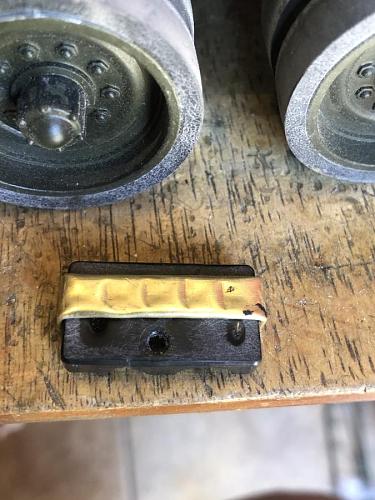

    After I completed mounting the components on the platform, I buttoned up the tank for a test run. It makes funny noise. Close inspection showed that one of the road wheel is flapping up and down. I inadvertently broke one of the torsion bar covers when trying to tighten down the platform. Go back to the workbench to repair and reinforce all the covers per Rubicon99 style. Sign!!
    The photo shown above of the repaired "lock down" cover was my first attempt. I ended up having to go back and add a full brass plate covering the glued back together black plastic cover. This worked much better and has not failed. I have since had the covers reverse engineered by JVM3Dconcepts and printed in a high strength engineering resin which is slightly thicker on the top section and stronger then the factory plastic.

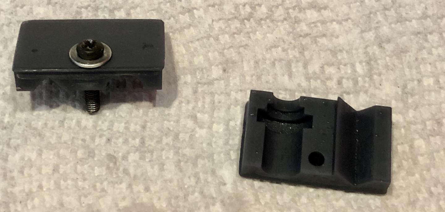

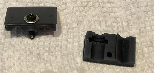

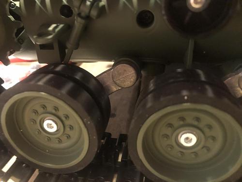

  • keilau
    I have the torsion bars "tightened" for more down pressure which caused the wheel to travel even further forward. Had I not "tightened" the torsion bar the SNAP and subsequent broken torsion bar mounting cover would not have happened.
    So what was learned? The torsion bar covers need be be strengthened and a simple re-enforcement/modification to the cover will add great durability for harder use. Also I will be looking at adding a down travel limiter to the Special right and left road wheels
    See photo of broken covers and my simple fix / modification.

    The brass C brace was made to fit snugly and was attached via an epoxy resin. I will be installing this modification to all the covers at some point in the future.

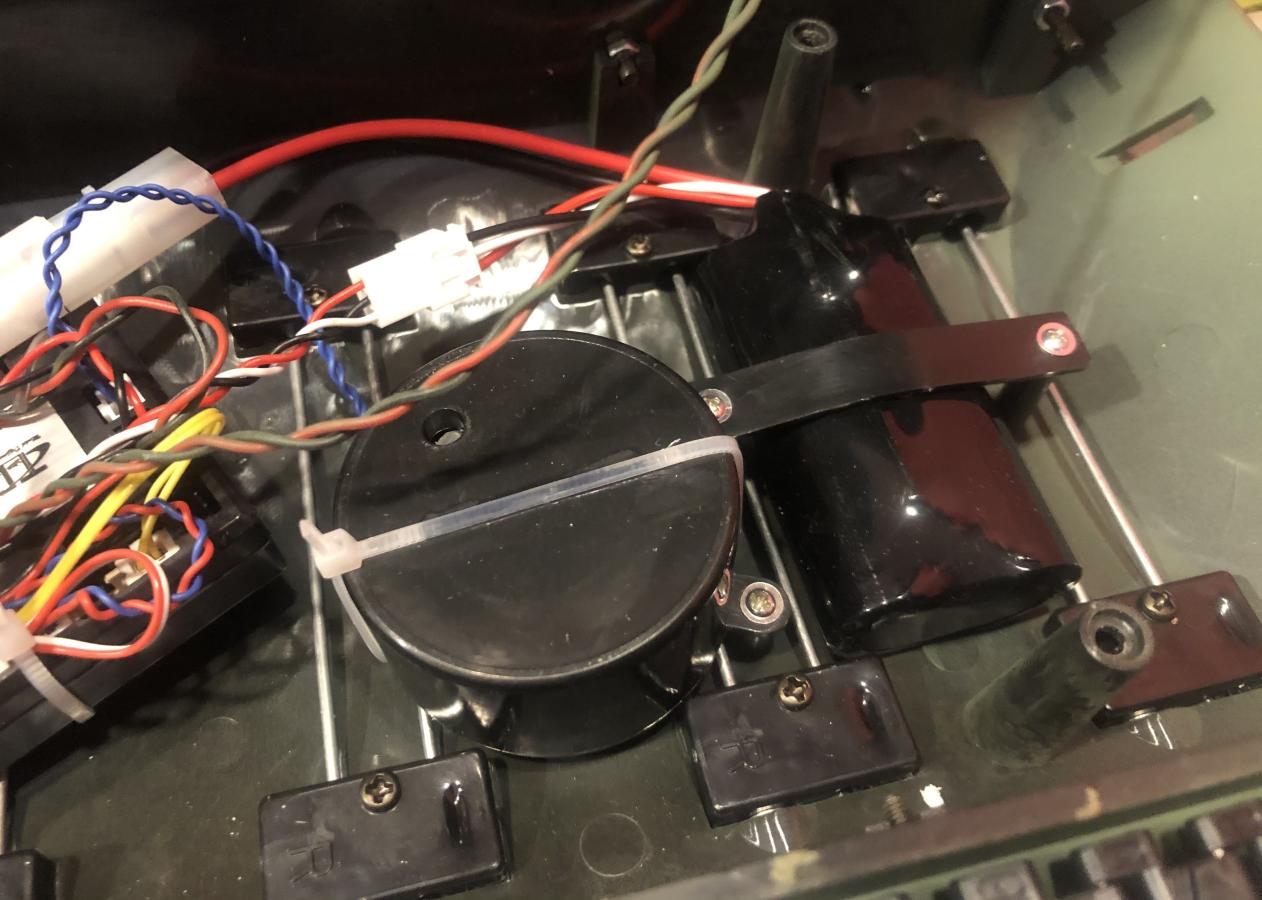

  • keilau
    Originally posted by keilau

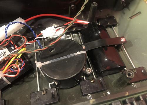

    Just finished the M60A1 upper and lower chassis magnetization. The fit is very good, no visible or feelable gap. It does not feel as snappy or as steady as the HL M4A3 Sherman magneted chassis. Being a much bigger tank (than the Sherman) with only 4 mounting posts, it is not unexpected. Magnet may be a poor choice for a M60 size used as a battle tank.
    I cut a 7"x5"x1/16" plastic for the platform above the torsion bars. Marked out the notch on the side and will finish it tomorrow.
    I used an unused mounting post to fix the plastic platform in position. It simply lay on top of the torsion bars.
    The 5x7" has plenty of estate for the loose receiver motherboard, loudspeaker and battery. The 2S1P Lithium-Ion26650 pack can provide 2,5 to 3 hours of continuous runtime which should be good for a whole day's activities. It is velcro mounted to facilitate removal for charging. The MB and speaker are fix mounted.
    The M60 is the perfect size tank for DIY upgrades. With torsion bar and metal suspension arms, it offers a lot of upgrade potentials.

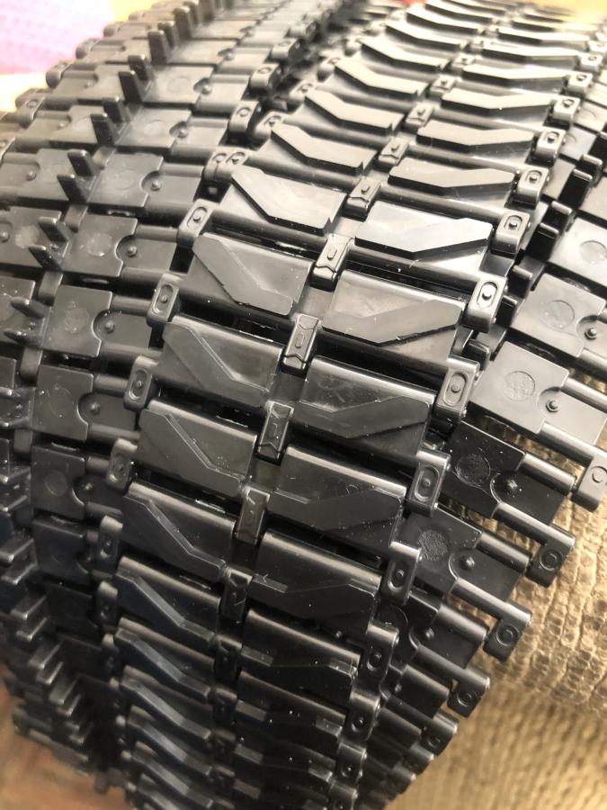

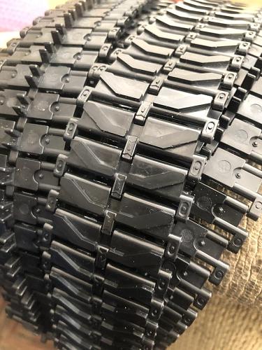

  • keilau
    I finally got the plastic replacement tracks in and swapped them out with my metal tracks. The plastic tracks matted to the "metal" M60 are IMO a far better match. The tank is lighter handling, more responsive and much quieter.
    Shown here are the new plastic tracks rust weathered and just after driving for a 20 minutes of testing. They ran perfectly!!
    I assume that you leave the metal sprocket and metal idler wheel on?
  • Rubicon99

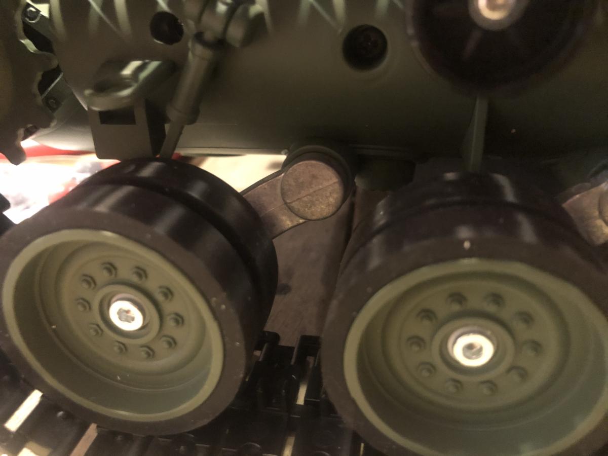

  • Rubicon99
    Got my second M60A3 in today that will be used as donor chassis for an upcoming M60A2 "starship" build.
    I ordered the all plastic version, two sets of plastic tracks and metal gearboxes to replace the stock plastic ones. When it arrived I saw that the spare track I ordered were "chevron" tracks which have not been offered yet in plastic (very pleasant surprise as these are what I wanted more) but there was no metal gearboxes included in the packaging. Thinking they might have stuffed them in with the tank, I pulled the tank out of the box, no metal gearboxes there either.
    BUT then I saw something exciting. The all plastic tank I ordered came with the metal suspension arms not plastic ones!!!
    So where were the metal gearboxes I ordered? They were finally located installed in the tank!!
    I don't know why it was sent with metal suspension arms and the gearboxes installed but I am not complaining as this is how they should all come standard.
    A few other notes. The battery and speaker now have mounting brackets and are secured tightly in place.
    I am pleased to see that TongDe is listening to feedback and making changes that improved their products.
