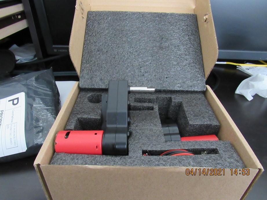

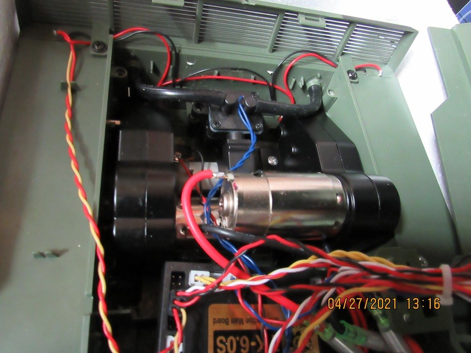

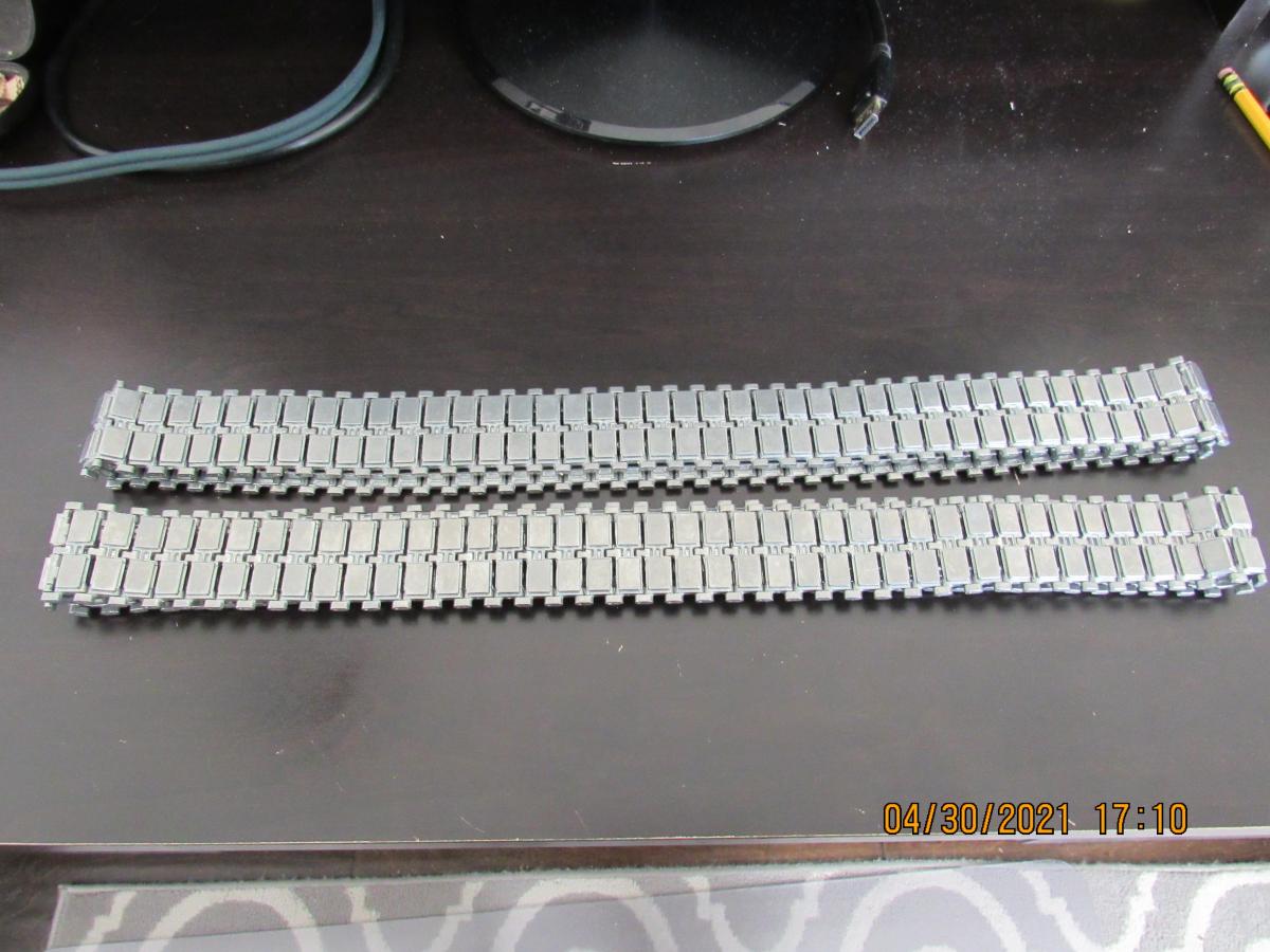

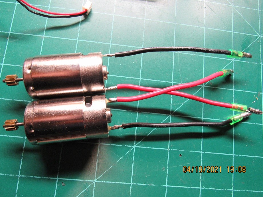

                        I will use the German Leopard 2A6 main battle tank as an upgrade example. You can get the metal version RTR from Toucan for $300 plus shipping. My perferece is to start with the plastic version.
                        https://www.toucanhobby.com/products/th17573-dzn1?_pos=1&_psq=Henglong+1%2F16+7.0+plastic+Leopa rd2A6+RC+Tank+3889&_ss=e&_v=1.0
                        The final cost of a do-it-yourself metal upgrade will be $500-900 depending on the upgrade parts you select. The limit is your bank account. Some of my upgrades shown below met my expectations, but are far from the top notch choices.
                        Click image for larger version  Name:	IMG_4962.jpg Views:	0 Size:	198.4 KB ID:	387630 Click image for larger version  Name:	IMG_4980.jpg Views:	0 Size:	154.0 KB ID:	387631 Click image for larger version  Name:	IMG_4969.jpg Views:	0 Size:	187.0 KB ID:	387632 Click image for larger version  Name:	09.jpg Views:	0 Size:	60.6 KB ID:	387634 Click image for larger version  Name:	12.jpg Views:	0 Size:	75.5 KB ID:	387635 Click image for larger version  Name:	IMG_4988.jpg Views:	0 Size:	118.8 KB ID:	387633
