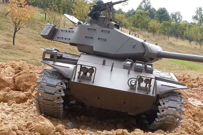

                • #68
                  Another question.
                  Is it normal the tank with the tracks reversed?
                  Not both on same way?
                  I have seen some like the one in bellow and i dont know what is the correct position of the tracks.
                  Anyone can reply?
                  • #69
                    In that pic, the driver's side track is on the wrong direction. Not sure why. No reason it should be. No benefit.
