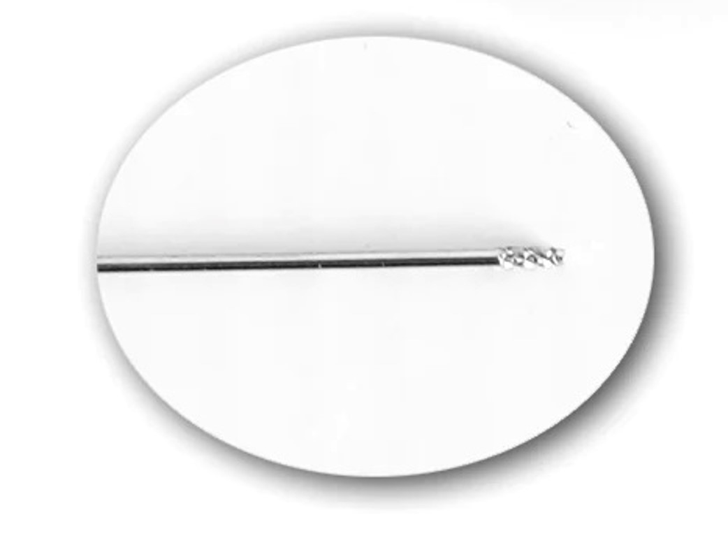

            In the good old days, the track pins are smooth. The smooth pin works well with plastic tracks, but it falls out easily from metal tracks. Recently, most major tank maker had changed to pins with a knurled end to make it more secure. A drop of CA glue is the best insurance policy. Leave at least one pin not CA glued in case you have to remove the track.

              thank you for the advice, it just happened in one pin on each track and the track was almost getting loose that why i get worried.
              but it was -4 degrees and i was running the tank non stop to try to finish the battery and make the first outdoor test at nigh i only spot the pin loose when i saw the track with a jerky movement because at first i thought it was ice that stayed harder in the idler and sprocket because it have stopped a litle bit.
              i will check it when i run it and if needed i will put a dab of CA glue on each pin but its lots of pins on each track.
