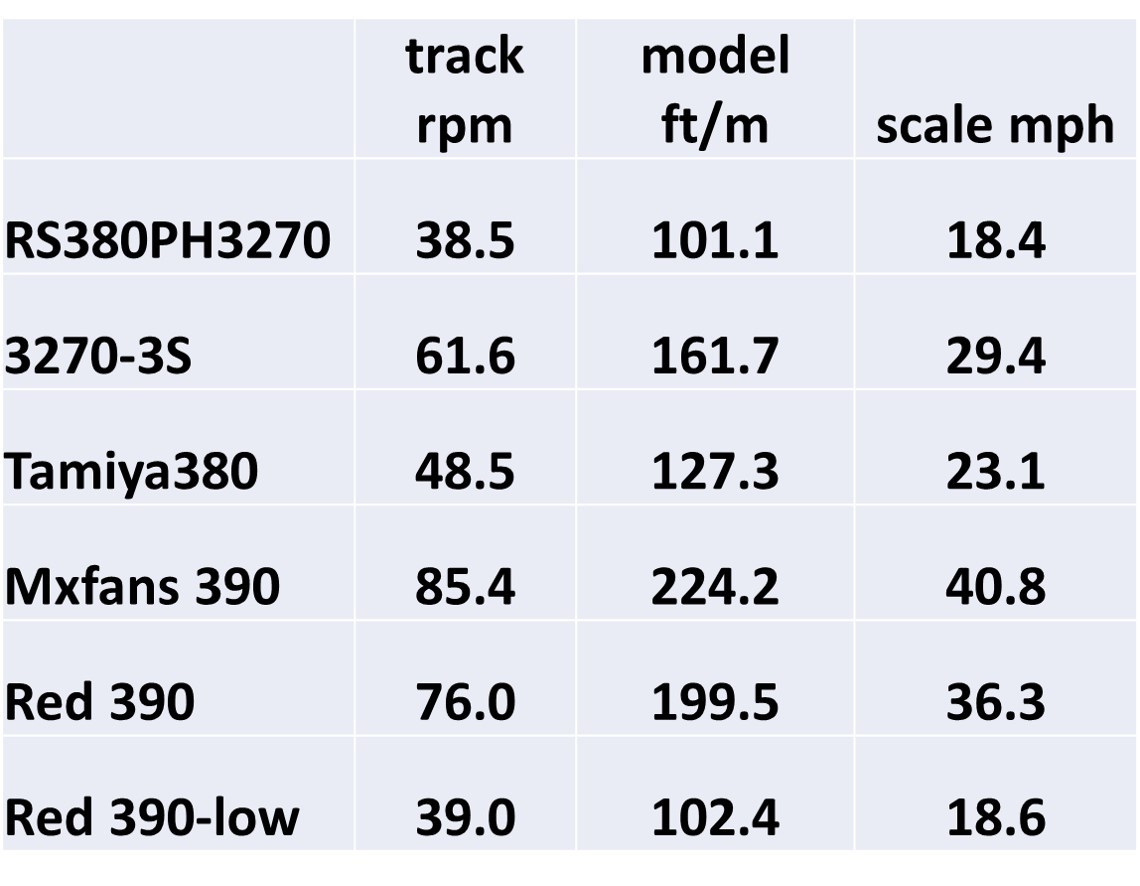

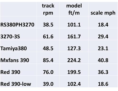

    LegoDEI , thank you for correcting my huge mistake. That's what a 7 years retirement can do to a used to be sharp mathematics mind. I never used those equations to calculate the track rpm and should not have list them. Much less arguing that others were wrong. A big red face.
    After I complete my RC tank, I tested different 380/390 motors. The tank was put on a 2x4 dynamo. I use a hand held tachometer to measure the track rpm and calculate the scale speed. Below is a table of the 1/16 scale Heng Long Pershing with a Torro series 2 gearbox. Just an example.
