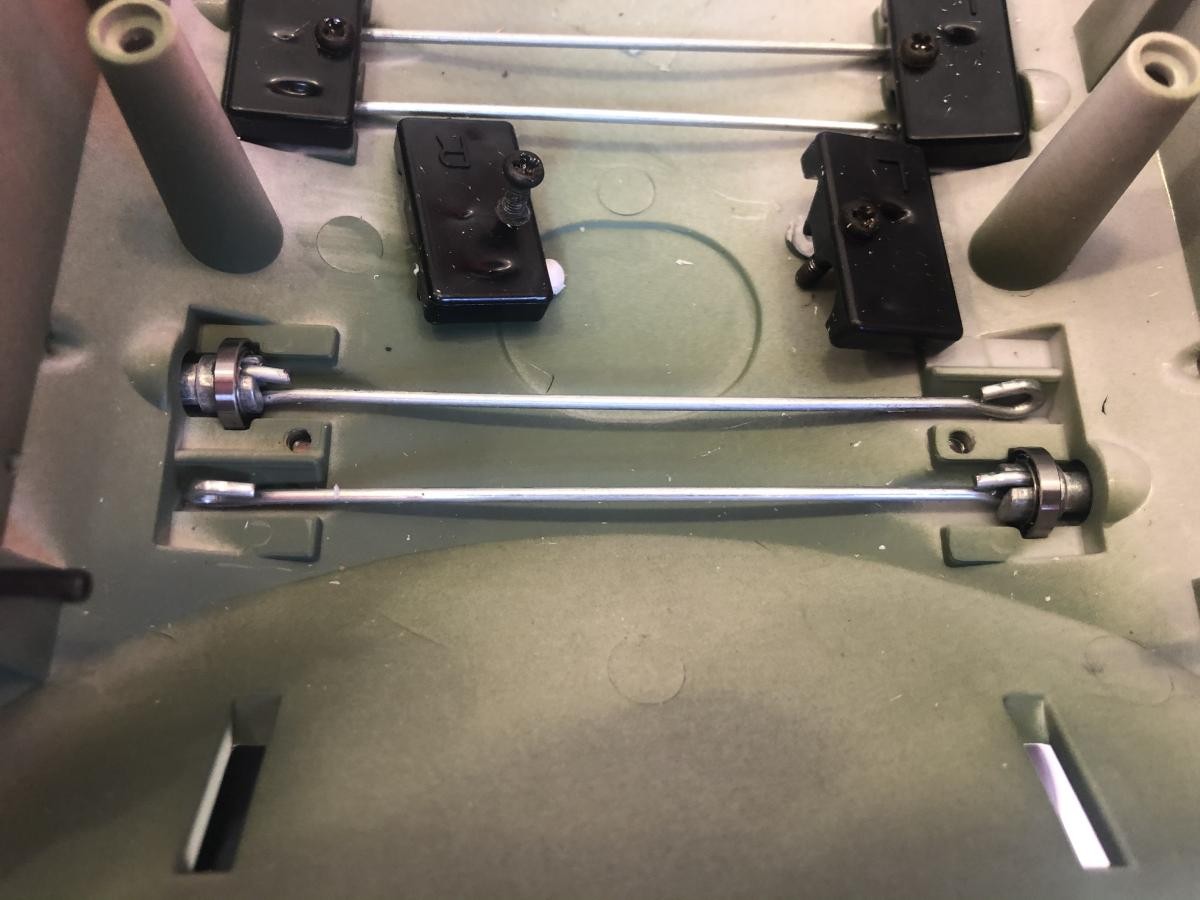

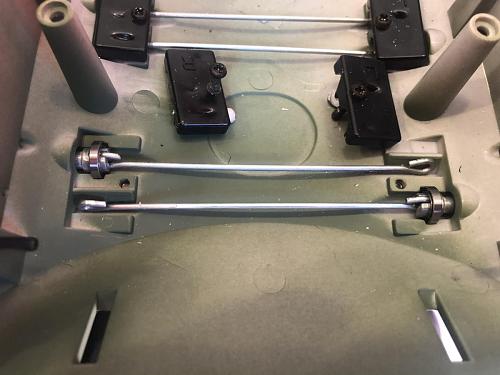

    One of the best Rubicon99 suggestion for the TD M60 was to replace the nylon ring on the torsion arm with a ball bearing, 12 pieces in total. I wonder if Tongde do that on their professional version M60?
    Click image for larger version  Name:	fetch?id=375185&d=1680654333.jpg Views:	0 Size:	128.8 KB ID:	398311
    The 12 per side, two on each suspension arm for a total of 24 bearings are only including on the "metal" versions of the TD tanks. We could try and encourage Motion RC to order the all "plastic" tanks with bearings or even brass bushings. Would cause the price to go up a few dollars, but would also add a lot more to the overall quality.
    More importantly IMO I would like to see Motion follow what they do with HL and only offer tanks with "steel" gearboxes. Plastic gearboxes in any tank are just one drive outdoors away from breaking. They just do not have the durability for outdoor use.
