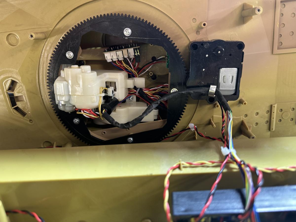

        Got some action in. Stripped the Abrams almost completely.

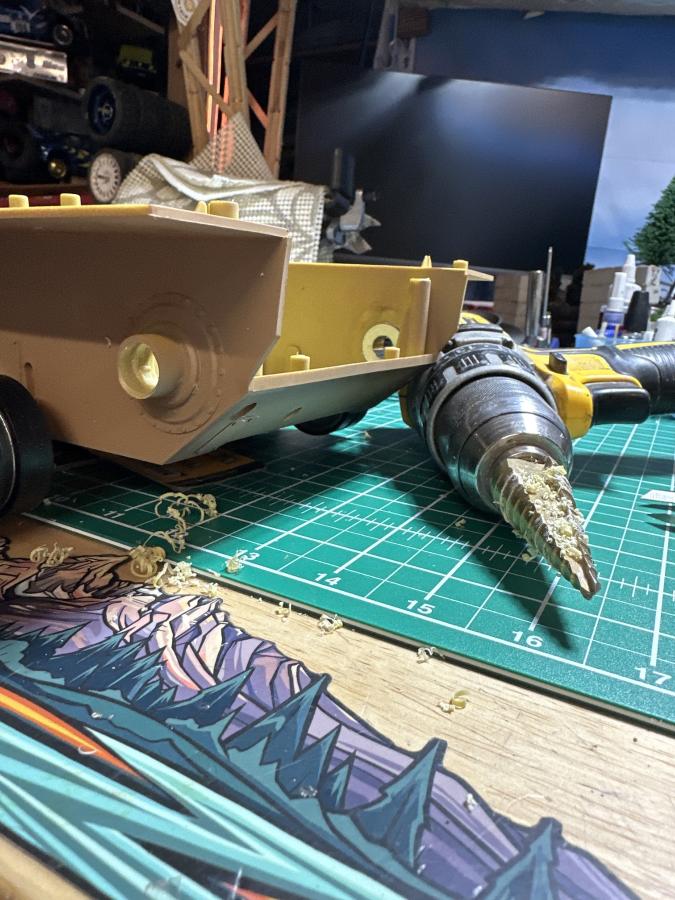

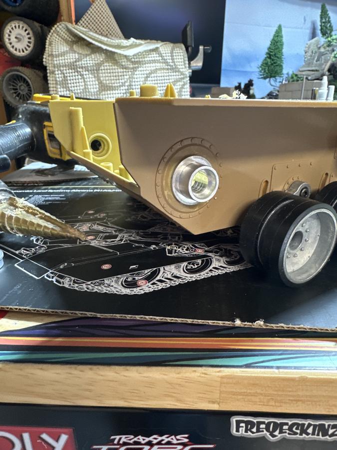

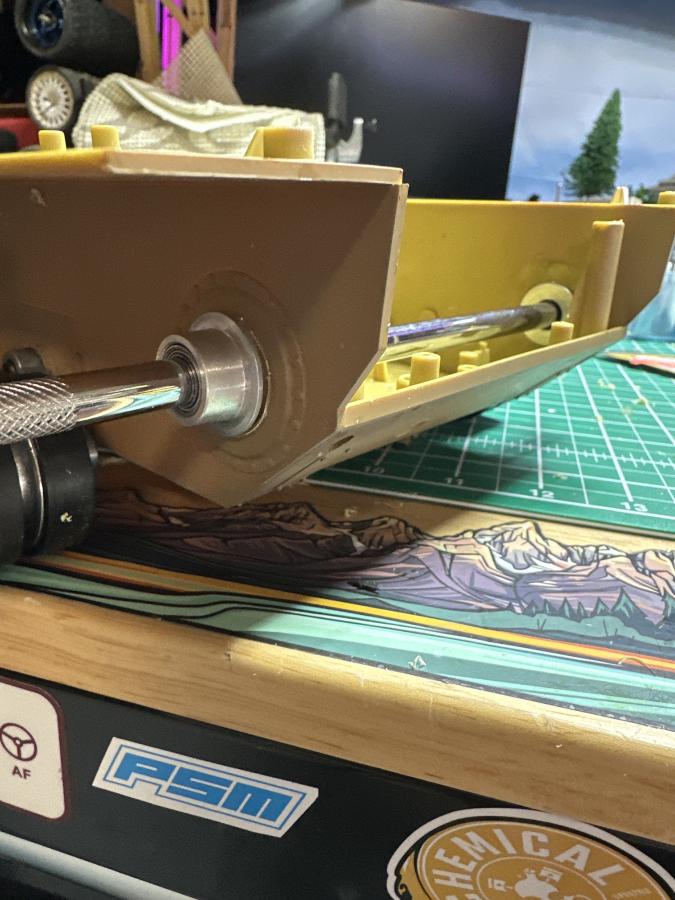

                Installed metal axle carriers. Slowly used a step bit, worked perfectly. Carriers pressed in tight. I can use a 1/4 ratchet extension as a perfect alignment tool!!! Fits amazingly well. Should have perfect alignment. The shavings will be saved to make a slurry with acetone. I’ll use it for lots of glueing, reinforcement, details.

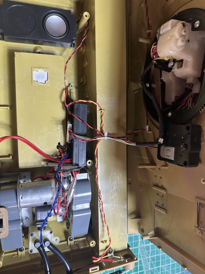

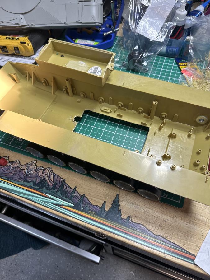

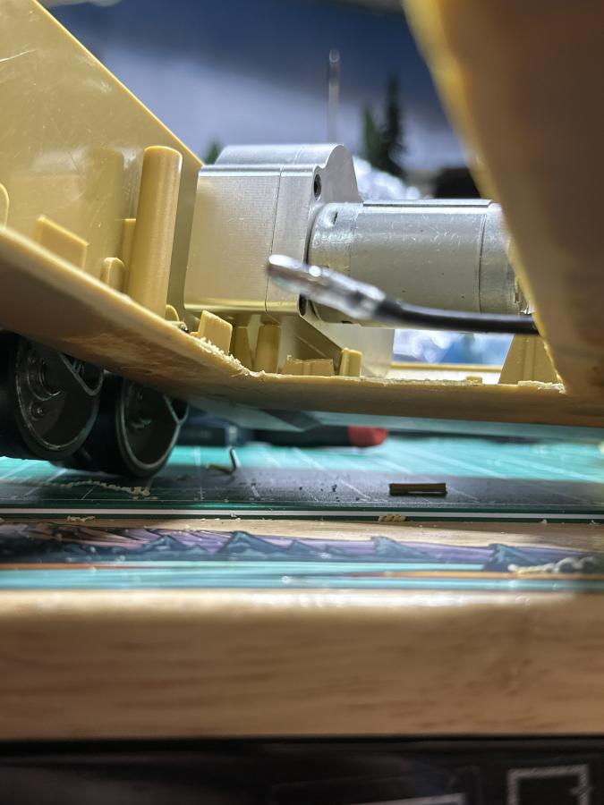

                    New transmissions are mocked up. I was not aware I would have to fabricate my own mounting solution. Be warned. While the hole from the battery box was cut open in the chassis, I took a pic from a view we don’t see much. I will be adding 3-D printed mount, strengtheners (black washers around posts) They will extend all the way up the mounting posts. Picture is prototyping so I didn’t need to waste much filament. They are made of ABS too, so when I glue them with the acetone slurry, it will all become one piece.

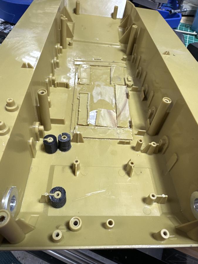

                        #31

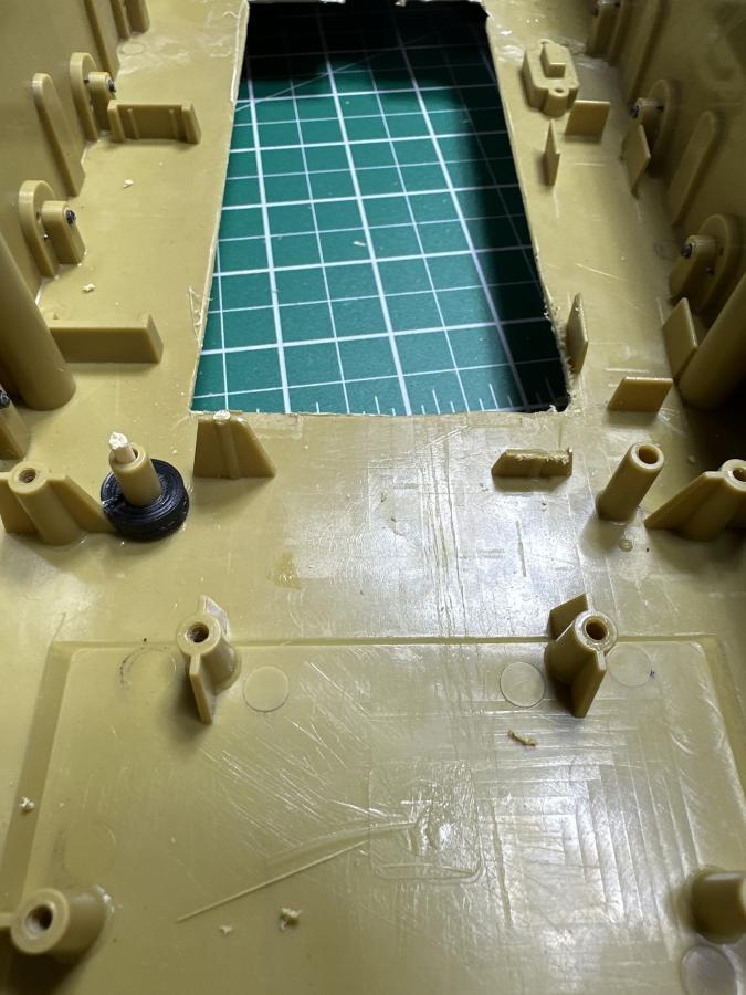

                        Upgraded transmission mounts on left (black in pic) .“Plan”is to drill down through mounts/hull and put screws up into tranny from bottom. Mounts grew from 6mm to 12mm thanks to 3d printed sleeves. Super beefy! Poor looking but highly functional hull patch. I used the old battery box (chopped up) as a patch. All ABS 3d prints weld to the ABS hull very well I use a q-tip dipped in acetone, wipe down both abs pieces, add a bit of pressure and wait. I will put a platform on 5-10mm standoffs, over the patch (to mount stuffs). 🤣👍🏻 no one will ever know how it looks.

                          I've done the same thing on some of my tanks, only I used 1/4 inch brass tubing. Just cut a slot with a hacksaw or dremel and slip the tube over the post and wick some superglue down the sides. It will be interesting to see how the plastic sleeves hold up, so do keep us posted. Did you print those solid, with zero infill? Did you use PLA or ABS for the sleeves?
                            Printed solid, these are ABS the hull is ABS too. They become one with the chassis with acetone (think weld not glue) . The strength improves tremendously with these, as the available hull plastic to support the mounts is effectively doubled.

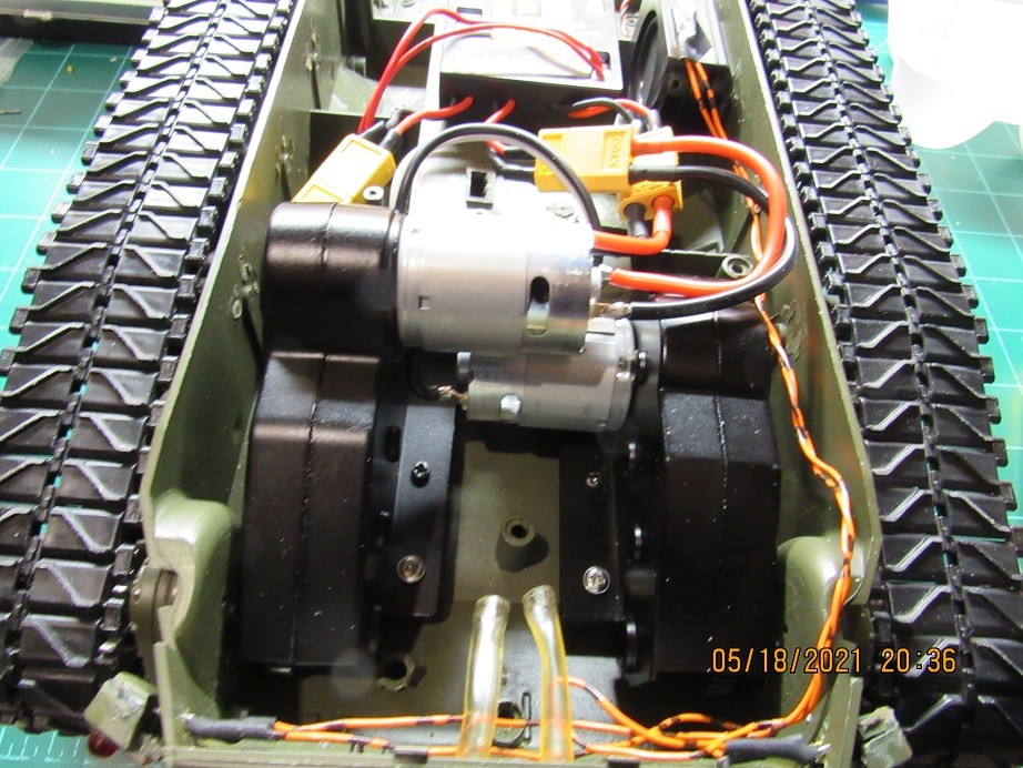

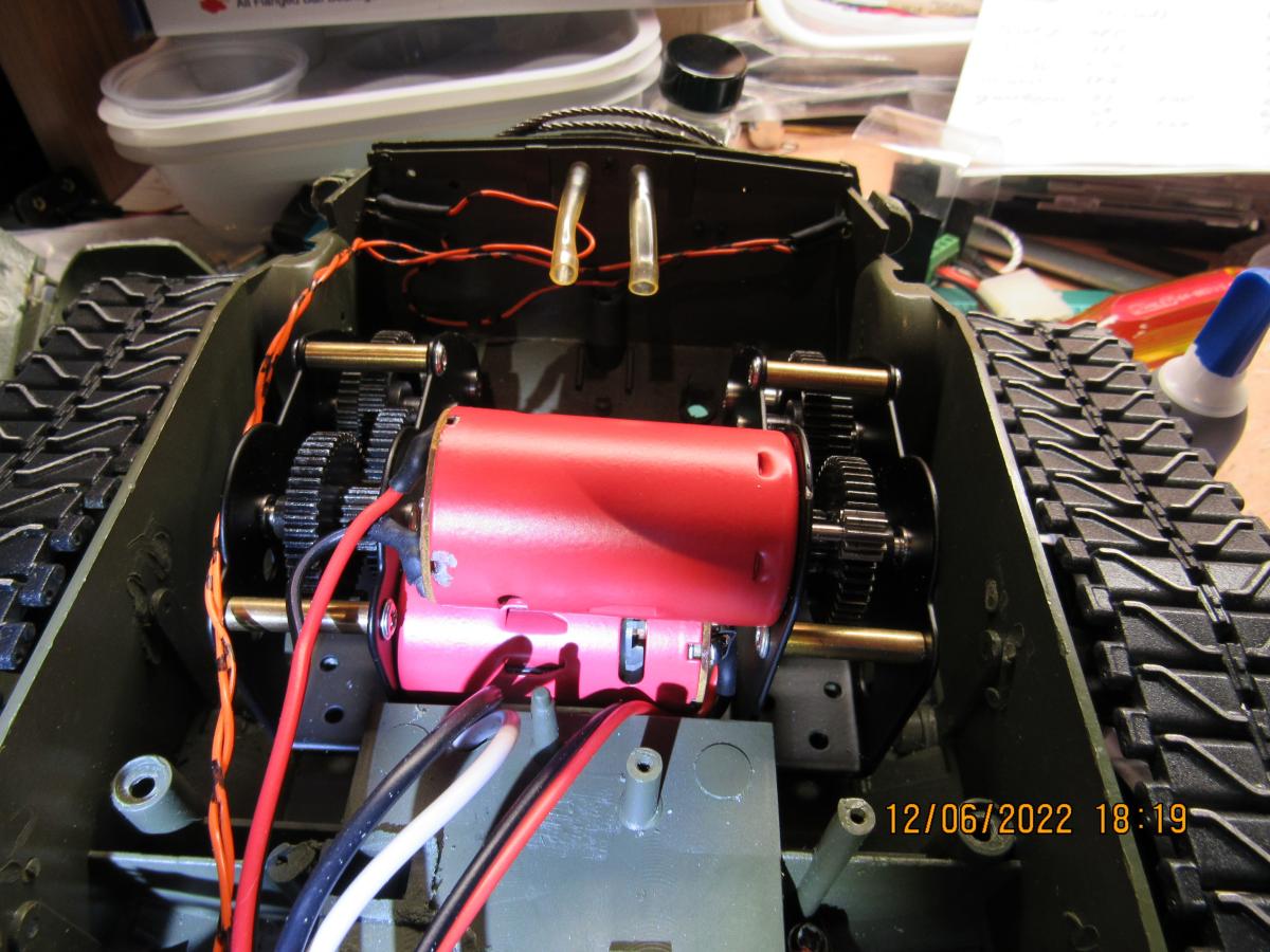

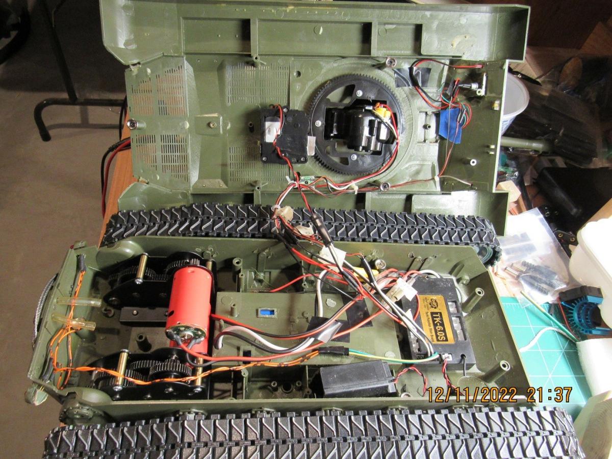

                              I have done something very similar to my 18 years old Heng Long Pershing. I drilled through the gearbox mounting poles to use bolts and nuts for the gearbox. I did not use any ABS sleeve. The original poles became locators of the mounting bolts. The idea is to transfer the gearbox loads from the filmy mounting poles to the chassis bottom.
                              I did this when I changed the Heng Xin gearbox to a Torro Series 2 gearbox. The change allowed me to use 390 motors on the Pershing.

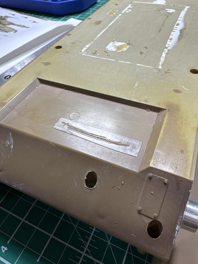

                                Battery box delete went smooth. It’ll paint up nice. It’s strong, better than new for sure. It’ll hold the entire tank👍🏻

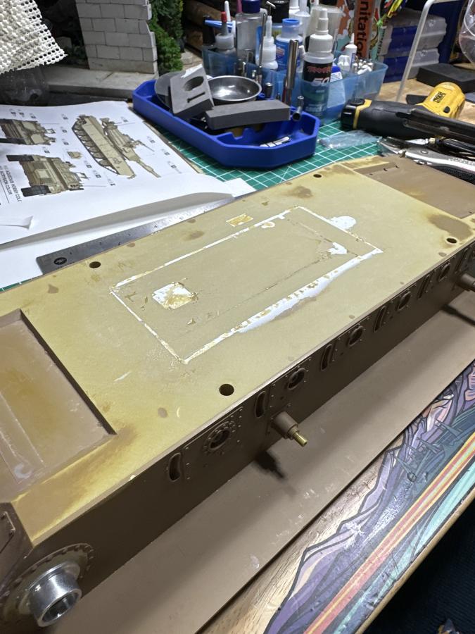

                                  #36
                                  Upgraded the idler wheel setup. Now each tensioner is connected into a threaded aluminum tube connecting the whole system Some additional supporting comes from the black anti torque support welded in tight, containing two grub screws to hold the tube nice and tight. Much stronger. I’m having a good time.

                                          Transmission mounts are in! So tight, countersunk perfect. The added sleeves helped a ton. Got the bottom plate mocked up and chassis braces started.
