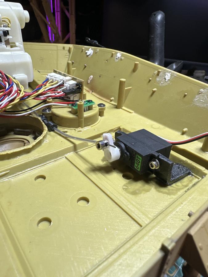

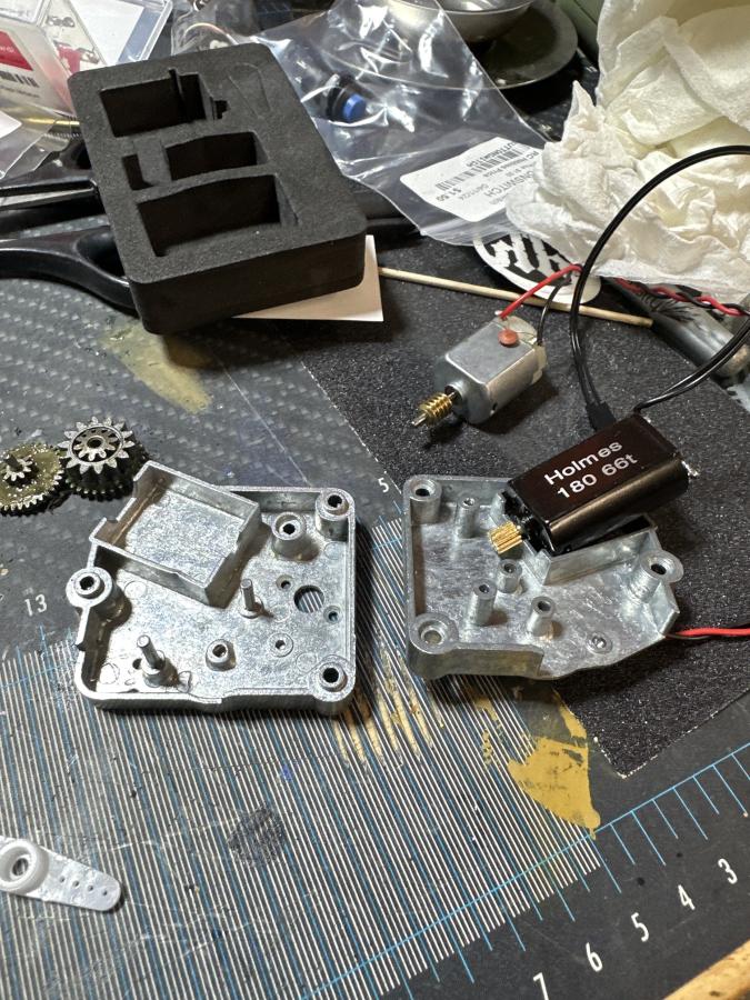

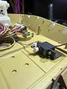

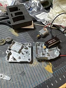

            I’m upgrading to Holmes 180 66t for the turret rotation motor, I needed more speed and smoother movement. Disassembled turret rotation tranny and have to modify to fit new longer motor.
            My pushrod recoil works perfectly, a little ECO Power servo works great. I like the airsoft, now i can keep it and have servo recoil.

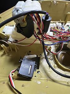

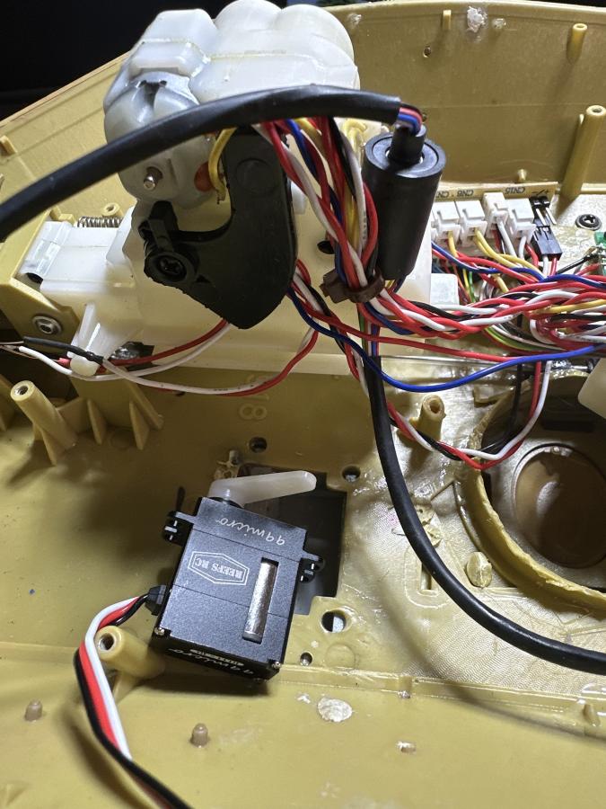

            Installing a top of the line Reefs 99 micro for barrel elevation, crazy hold power for the size. Much smoother elevation now. Its speed is needed for the next big thing I’m going to try.
            After 5 batteries I NEEDed smoother barrel movement. I did not like the herky OEM movement and loud clicking at full travel🤮
            I achieved my goal with flying colors. Vid coming soon.

            Click image for larger version  Name:	image.jpg Views:	0 Size:	95.9 KB ID:	403345 Click image for larger version  Name:	image.jpg Views:	0 Size:	75.2 KB ID:	403344 Click image for larger version  Name:	image.jpg Views:	0 Size:	146.6 KB ID:	403346
