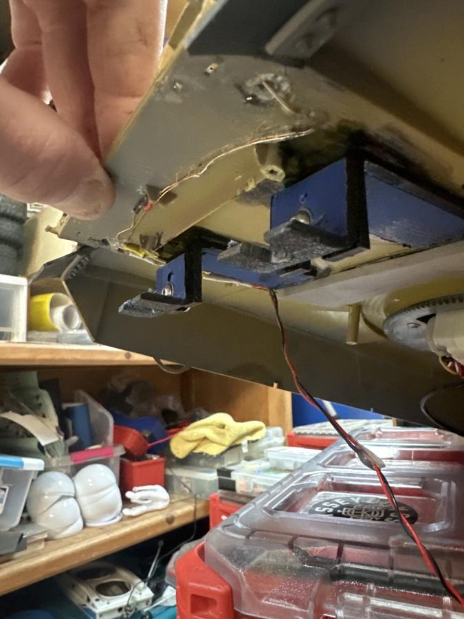

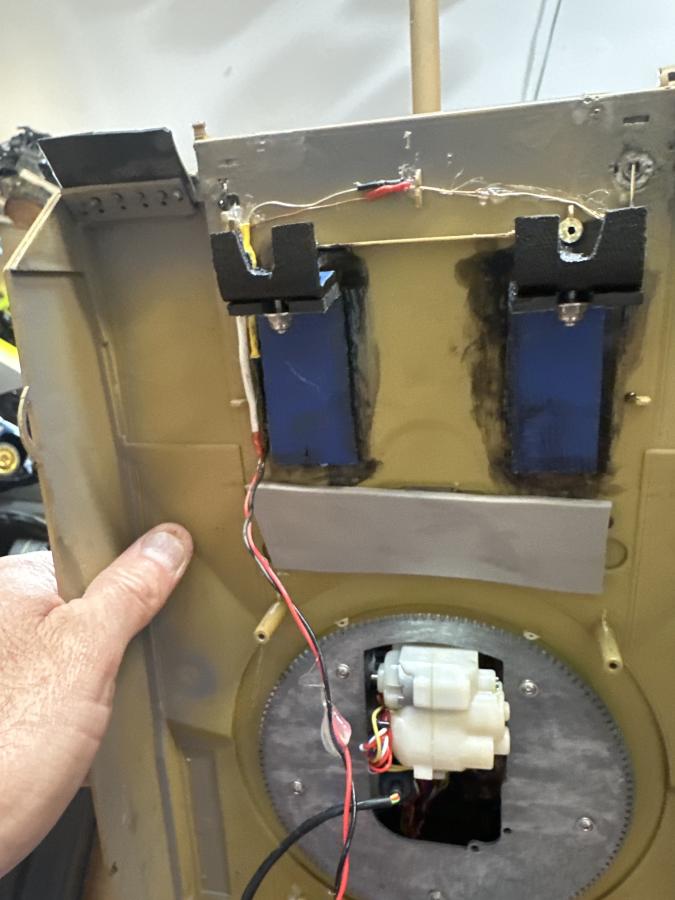

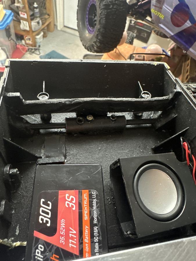

                              ill get better pics if it helps.
                              It’s an adjustable (attached to another L welded to upper hull) L shape piece slotted to grab lower screw towers (preventing any lateral movement) , and another ABS piece with notches to accept the notched L tabs (described above) and attached to lower towers,sides and bottom. I used the oem screw towers on the chassis upper hull and lower as reference points, then cut them off upper as they interfere when sliding forward.
                              Think 2 L back to back one slides on the other
                              2x upper hull L attachment pieces welded to inside of upper hull (slotted on side with M4)
                              2x upper hull adjustable L pieces, with slots wide enough for lower towers,
                              attached with M4 hardware to L attachments welded to hull
                              2x M4 bolt/nylock combo
                              1x lower chassis plate to accept L tabs from upper
                              welded to oem towers, bottom of hull, and sides of hull
                              put top hull down 1/2” back from normal position . Gentle pressure down to hold top down and a firm push forward. Tabs engage lower towers and L fits under plate . Holds perfect
                              I apologize if I’m not making sense.
