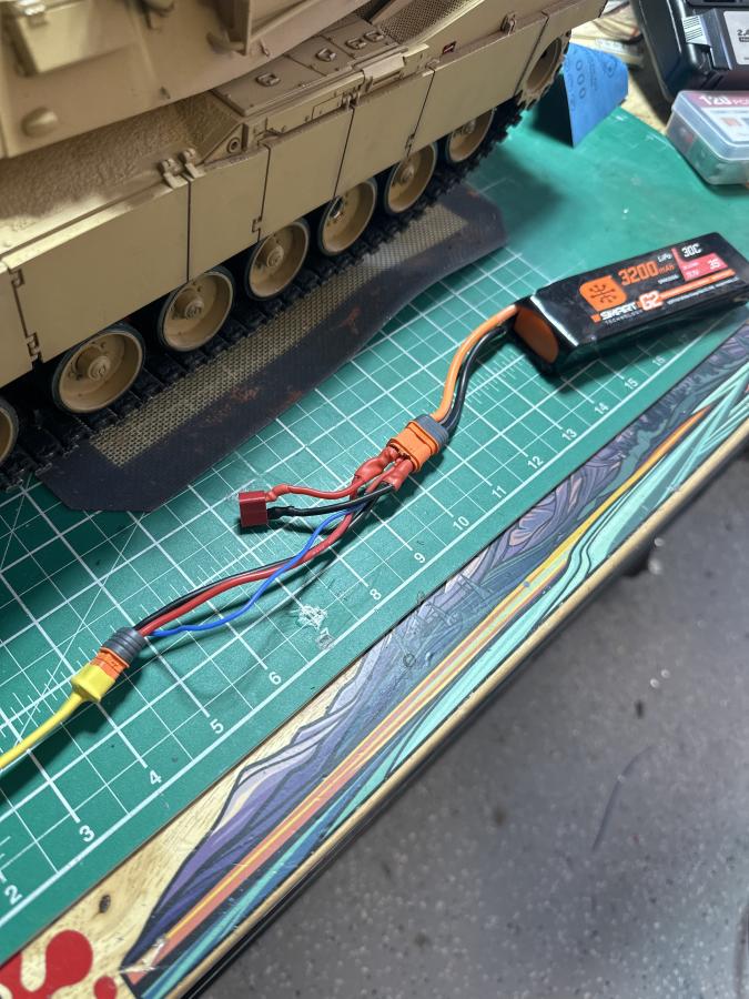

Getting the gear boxes cleaned, shimmed, and relubed, and my Holmes hobbies torque master 380 motors (rated for 11.1v) installed. Shimmed them trannys like I would an airsoft gearbox. They were pretty dirty inside and they use a soul robbing grease that is sparsely applied. I make better. Magnalube. Great stuff
I can’t describe the improvement in quality from ANY Heng Long motor. You can feel it in the motor. Dual Ball bearing and neodymium magnets. 18$ each. These are top off the line RC crawler motors. I use Holmes Hobbies in most my trucks. They also make awesome servos.
here’s my example
the stock Heng Long motor (390) won’t even turn over with a bare shaft on a AA battery
the Holmes Hobby turns the entire transmission on 1 AA with power to spare. Don’t believe me… try some
here’s my example

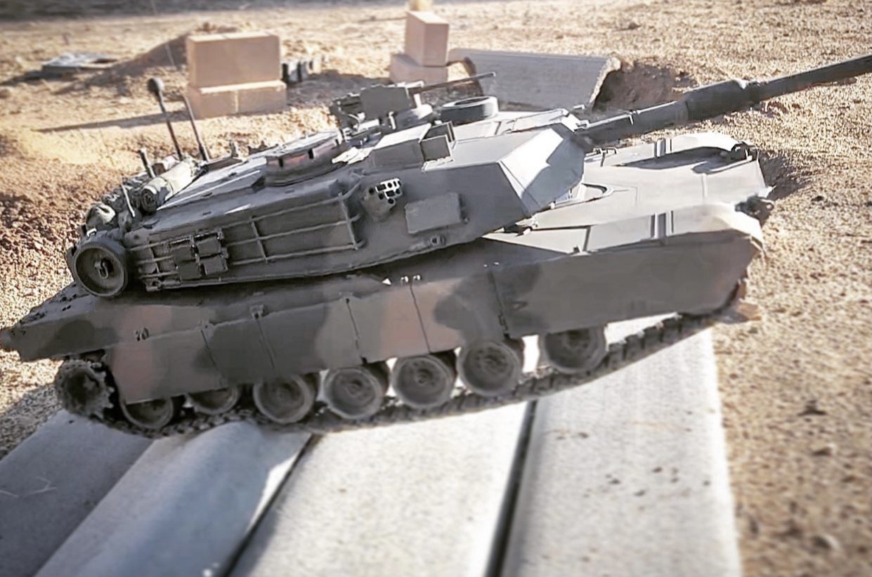

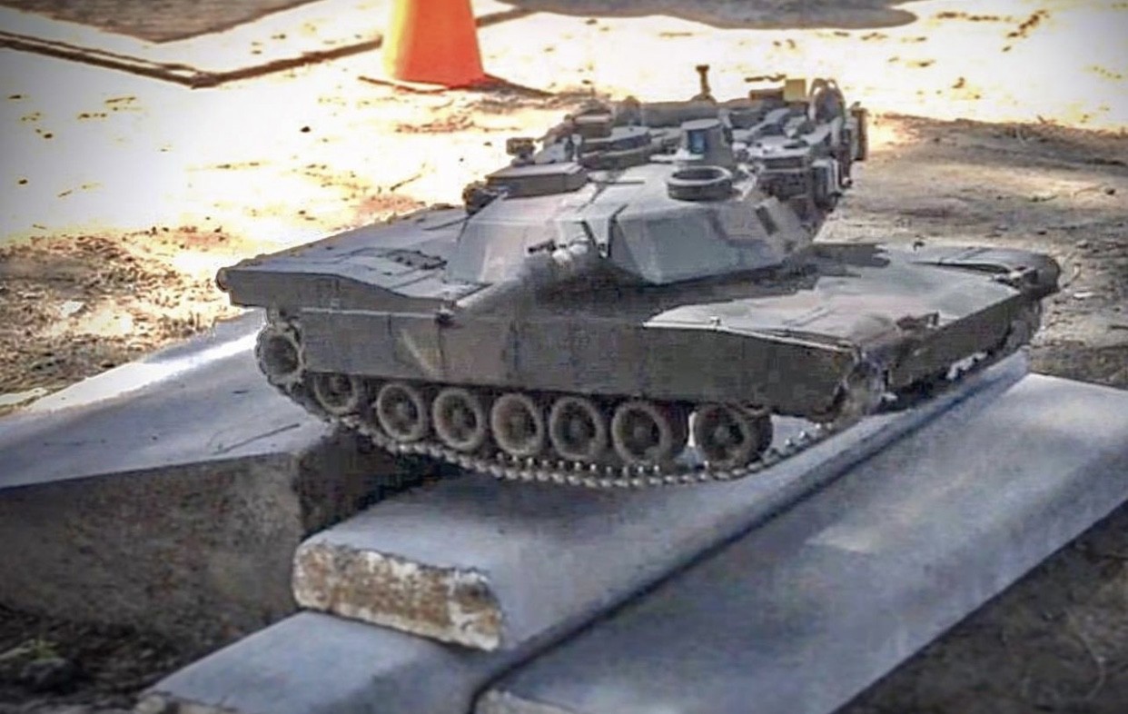

Personally I like to increase the tension on the first and last road wheels on most of my tanks. Helps with track retention. There should be two settings on each road wheel. One is harder and the other softer. On my old Abrams plastic hull I think I drilled an additional hole to increase the tension on the torsion spring to "more harder"...
