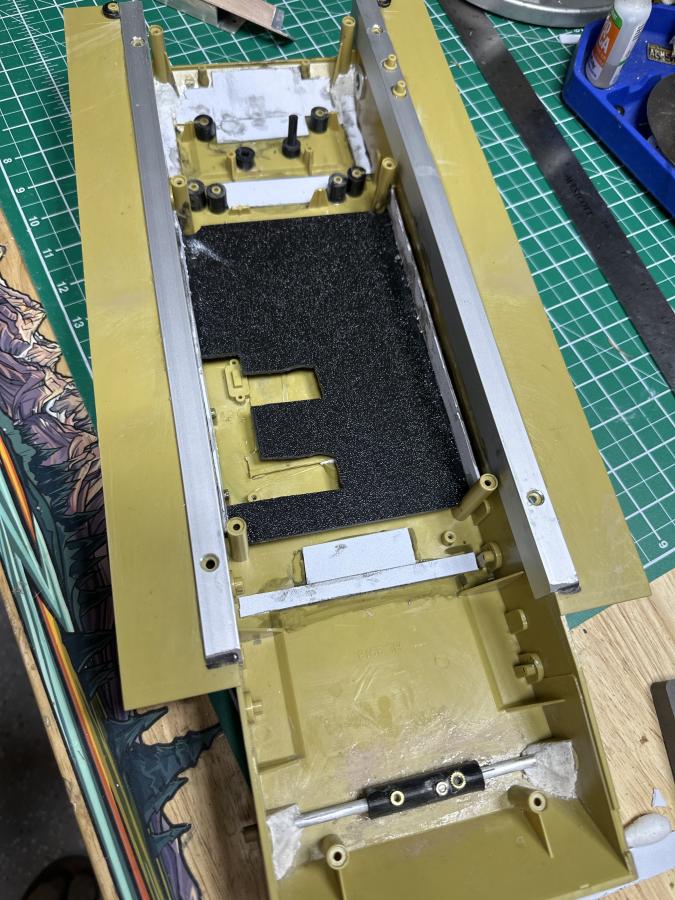

        Here is the last shot before I prime the chassis .
        Black is 1/8 (welded to tops of wheel screw arches and sides of chassis) abs, white is 1/16. I can not describe the difference in strength , yeah more weight, but down low.
        cutouts are for air flow around the 7.1. I will be doing a push pull fan system to keep this nice and cool. I have found that is key to electronics longevity.
        side rails are attached with E6000 a rigid bond will fail between abs and aluminum in this application, so I went with E6000, cross rails will be screwed in aka removable.

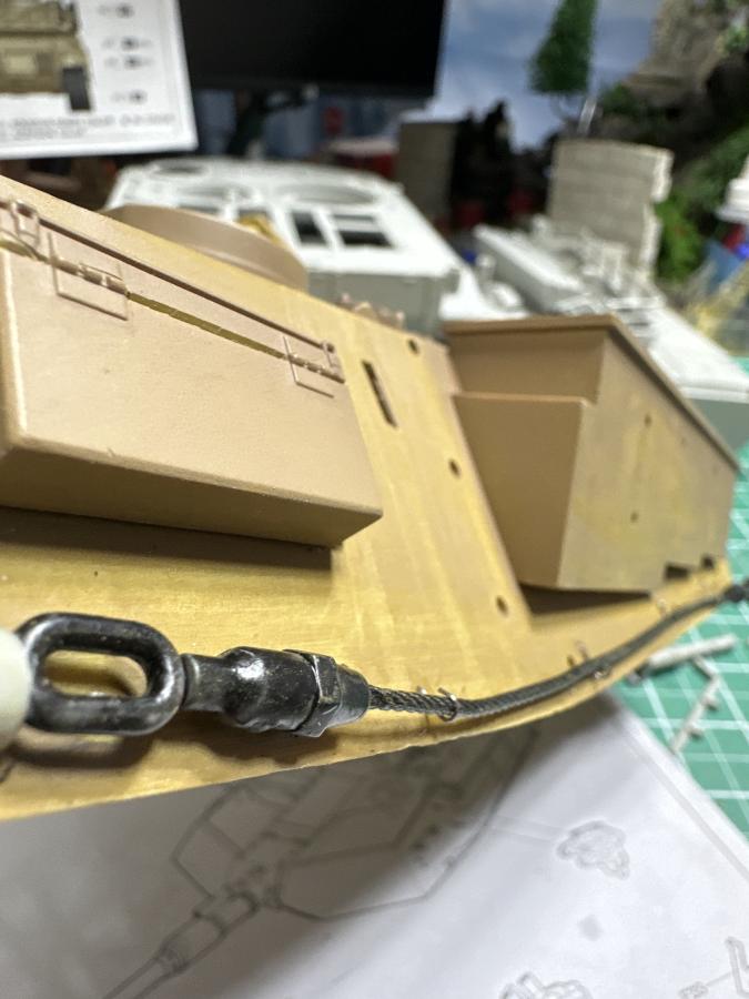

                          Got one side tow cable mounted. Once primed and painted it’s going to be so cool. Although tiny looking, Cable anchors will “grow” with finishing. Contrasting with the black cable perfectly. Cable will benefit from being removable, another great scale feature lacking in both the Trumpeter kit and Heng Long tank.

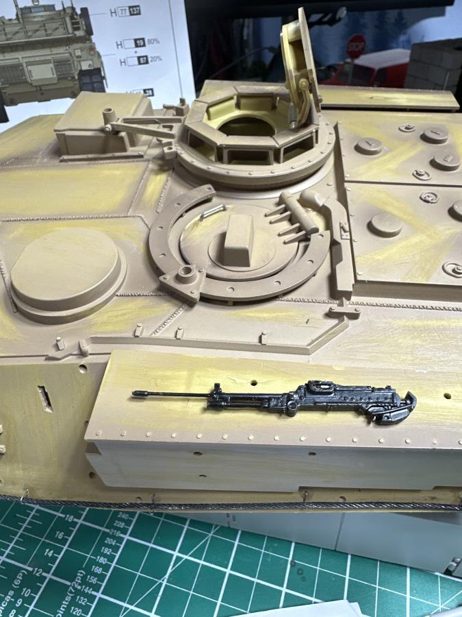

                          I had to put a metal barrel on the trumpeter 7.62 MG
                          music wire with heat shrink for flash suppressor, pin drilled into kit gun. It’s strong now, the kit barrel was going to break for sure during any use.

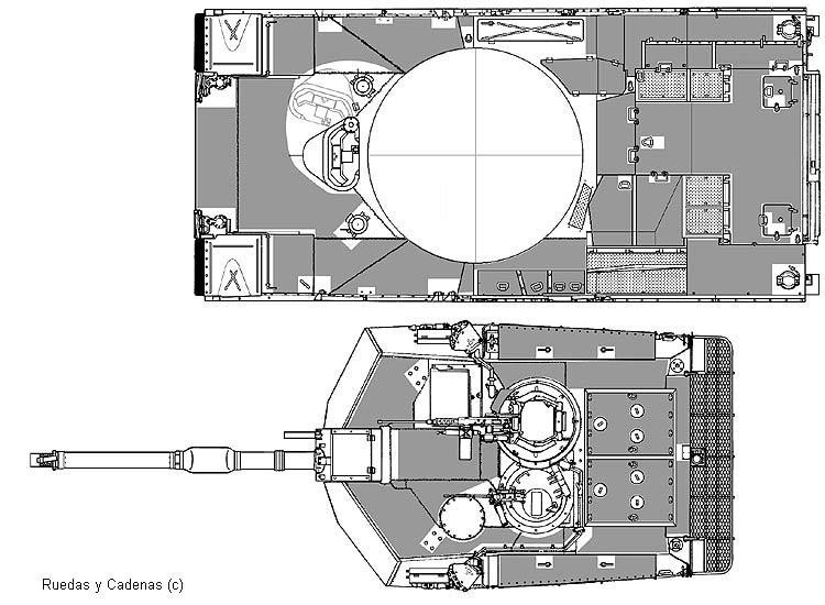

                              I assume you have this for placement of the anti-slip coating?
                                more or less👍🏻
                                copying the Trumpeter kit
