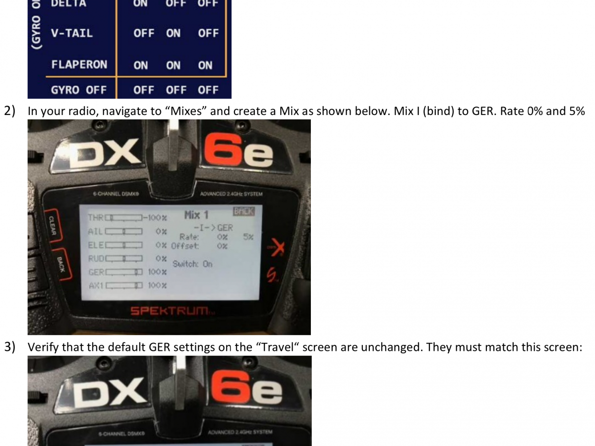

                • If someone could please. What does your monitor (DX8G2) or equivalent show on channel 5 with the correct mix? Switch up and down and please include the numbers (+or-) Thanks all !!!
                  • Originally posted by JmanAZ View Post
                    • Thanks. These I've seen on the Quick Start Guide. I think my channel reverse may be causing an issue. On Combo A. Hoping that someone would observe channel 5 on their Tx monitor while flipping the assigned 2-position switch. And note the number (+or-) for Gyro ON and Recovery. BOTH of my RX600SP's do not function which is unlikely UNLESS I am setting it incorrectly and that IS likely. Thanks again.
                      • Test 1. Combo A. Channel 5 (gear) is on switch A. (pos 0 is Gyro and pos 1 is Recovery) Pots and knob at 12 o'clock. Fly's smooth, can not tell if the gyro is functioning. No Recovery even from inverted....back to the drawing board.
