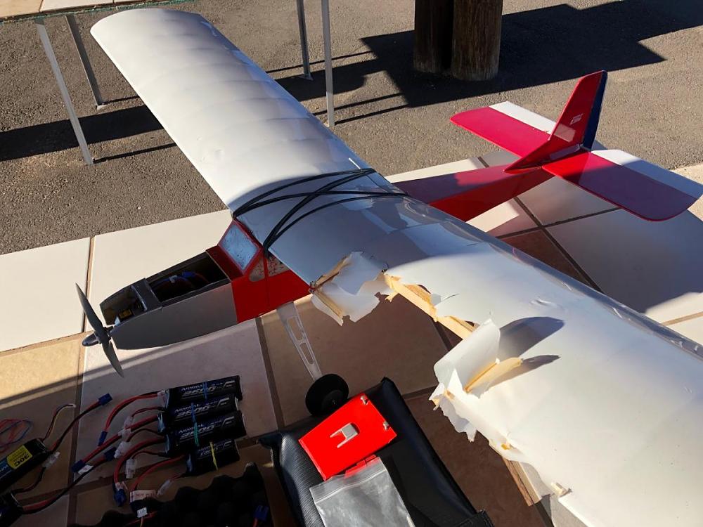

        • The PT-17 and T-6 flew nicely, but I learned I needed to reset TX battery in System Settings when I switched to the Li-Ion rechargeable...did not get a “Transmitter Low Battery” warning.

                Awe crap brother, sorry to see that. Fixable though it looks like. Hardway, Merry Christmas brother!
                • Definitely fixable, and best Holiday wishes to you two fellow Texicans as well!

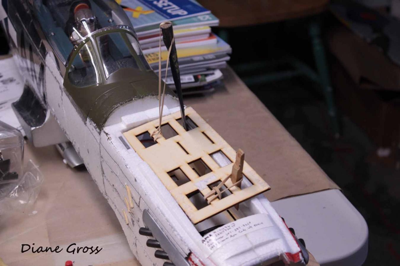

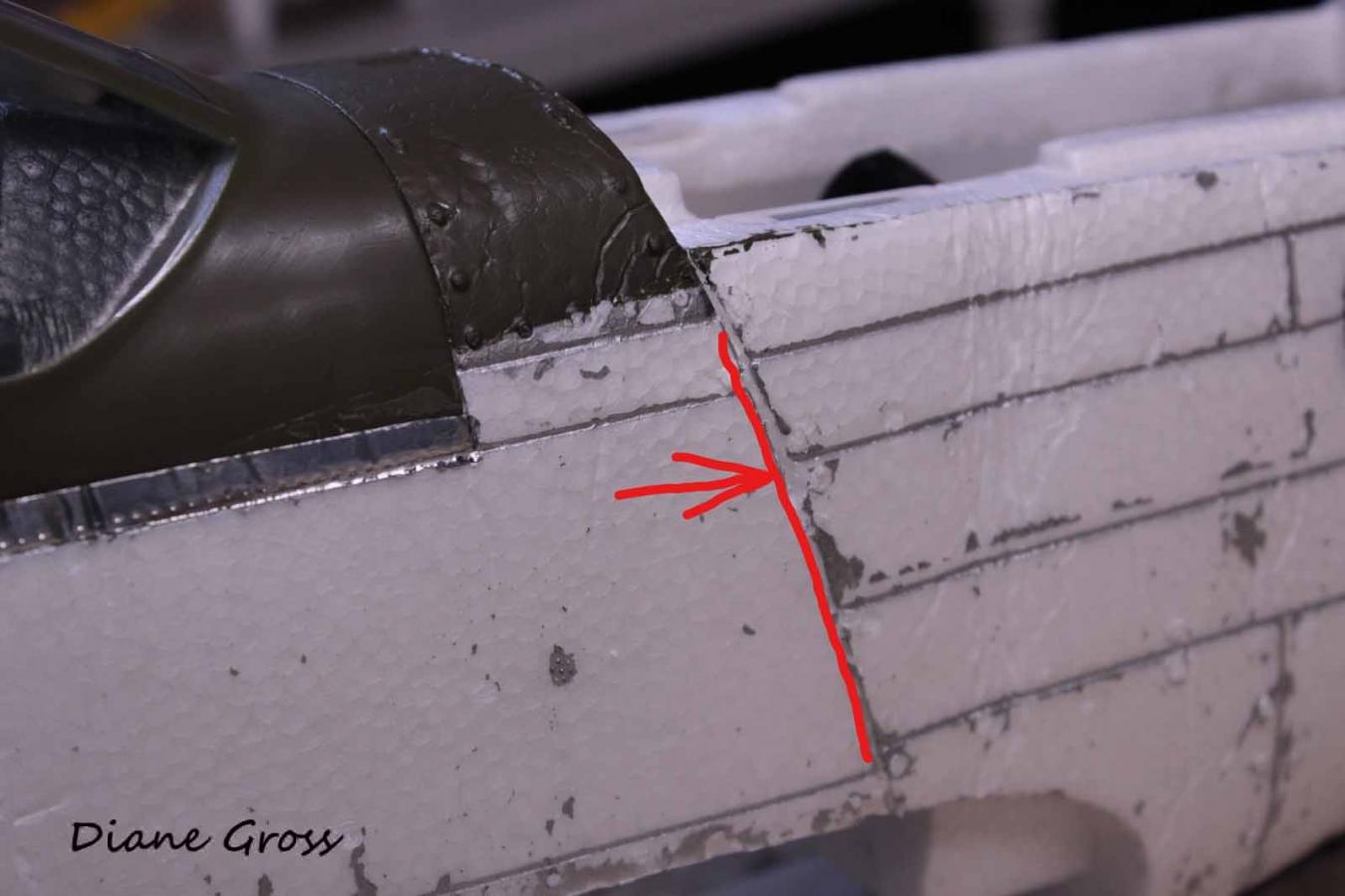

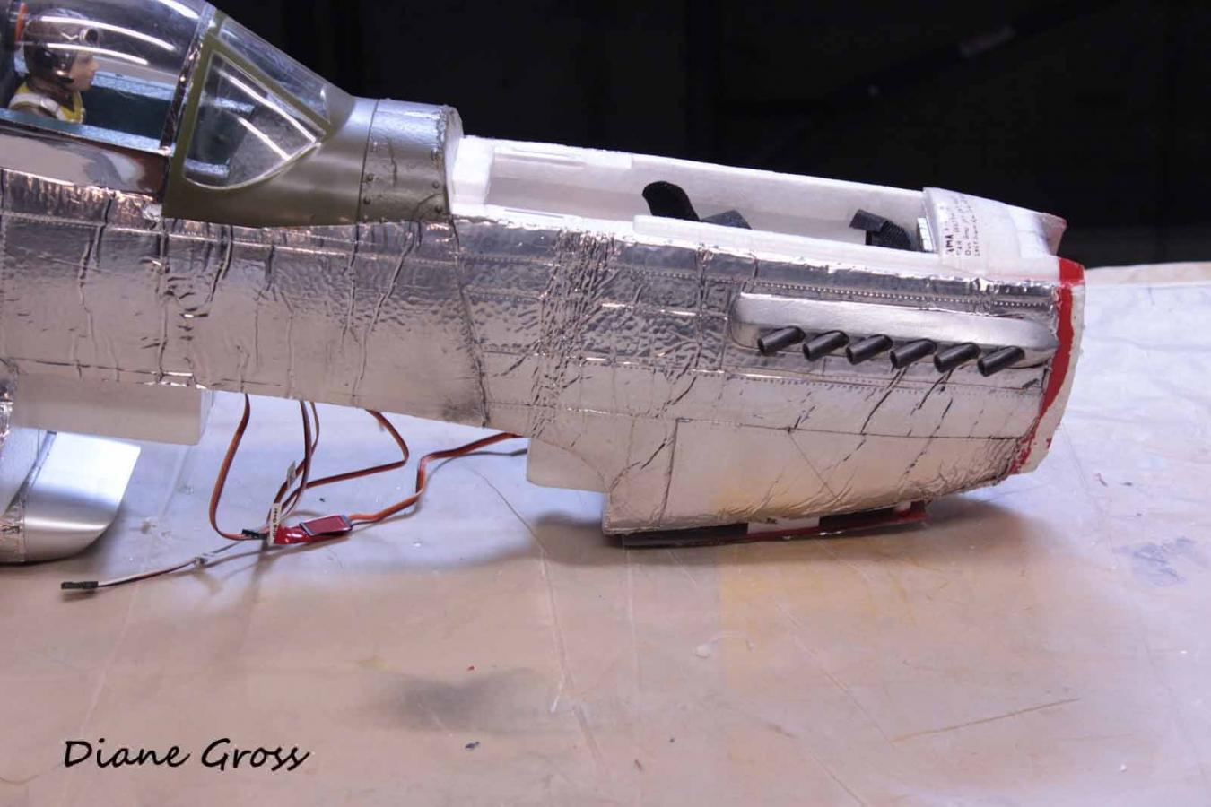

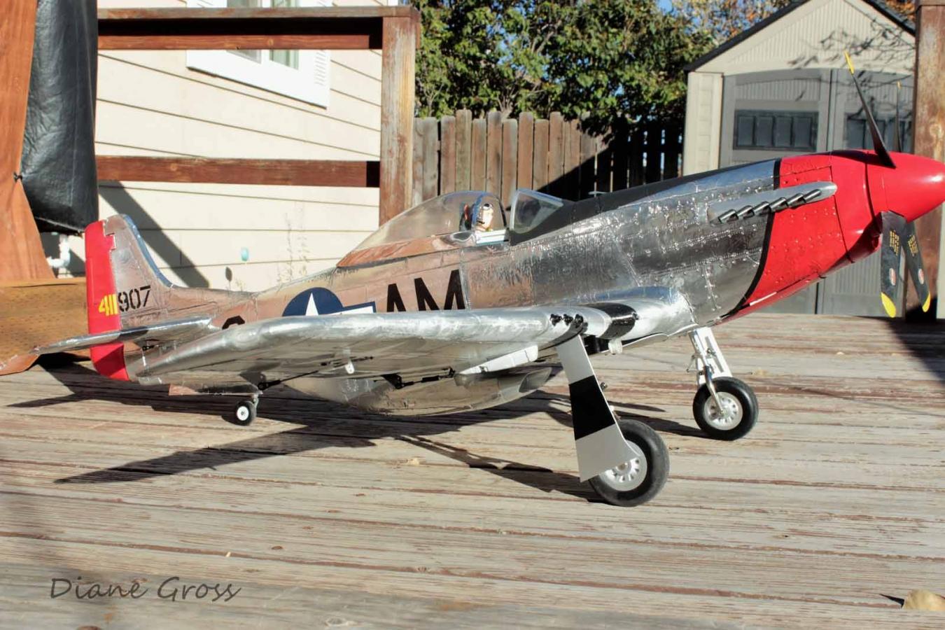

                          Check out my rebuild of the E Flite Spitfire or the Freewing Mustang.

                          She was cracked right where the red line shows and with some skewers and a balsa plate behind the damage, and a bit of putty and sanding, she's ready for the air again. I found that if I use a towle with hot water and hit it with a hair dryer, it helped to saften the foam to a point where you could sort of reform it, then the rest is putty and sanding, it works, consider it a learning experience, you get better and better at it.
