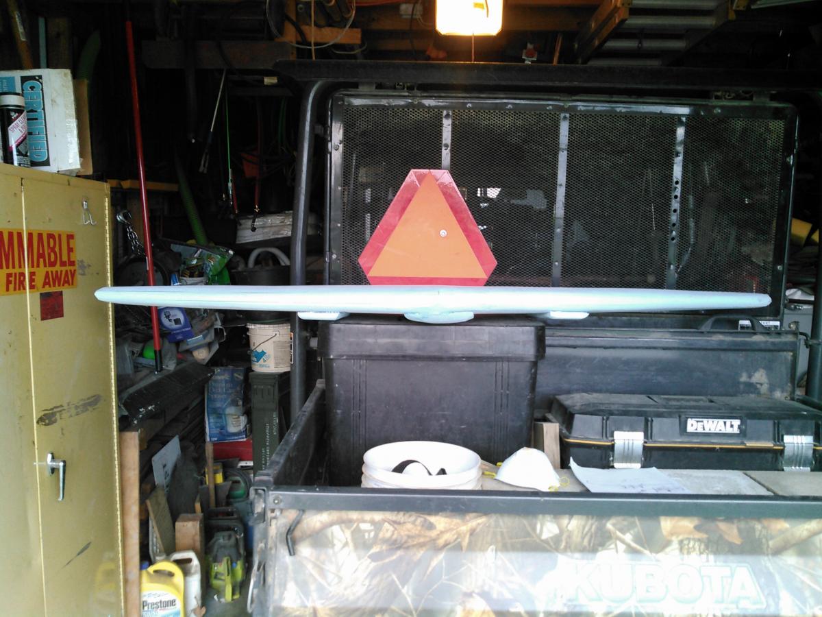

                        Started the sanding process. Looking pretty good sofar
                          #52
                          Wing is ready

                                #55
                                Boy!...You don't waist any time, do you? Really looking good. How did you make both wings the same airfoil when sanding, templates or just eyeballing it? Doc

                                      Eyeballed it, and ran my had over the surface feeling for any deviation. And ups will be here late tonight, so that will slow down progress today. Then the last parts are the landing gear cups from the flight line p38 once those are in I'll be in good shape to push forward again. Right now I'm going to work on the motor mounts. I have alot of flight line/ freewing components in this. And I'm going to try the Istone stabilizer and see how it works
