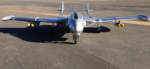

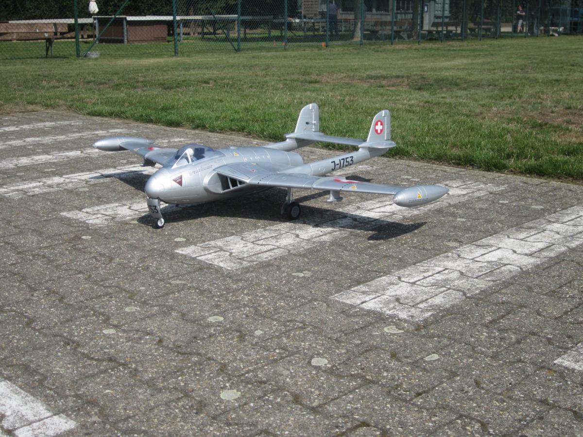

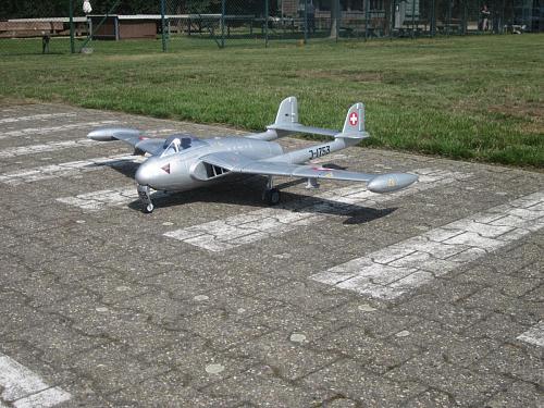

              • The Venom is definetly a great plane. Fly it with the Admiral 6S 5000 and some extra weight in the nose (40g)! The sound of the Venom (stock) is awesome!!! Click image for larger version

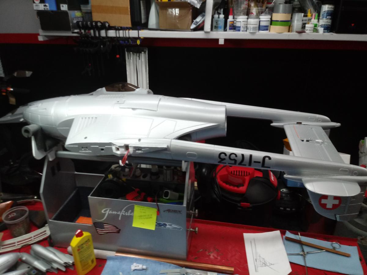

                • Mine arrived on Saturday while I was at Florida Jets, so I didn't get started on it until today. I don't know why I waited so long to get this one, It's really beautiful in a Buck Rogers sort of way. Nobody in my club has one, or seen one fly, so it should be fun. Very simple to assemble. All the lights work, and the tail servos are all tested. Still have to test all wing components, but overall I'm very satisfied with my purchase. One of the nylon hinges in the elevator was glued in askew, so I just softened the glue with some lighter fluid and wiggled it loose and re glued it...no biggie. I just got the tail group and wings glued up. Click image for larger version

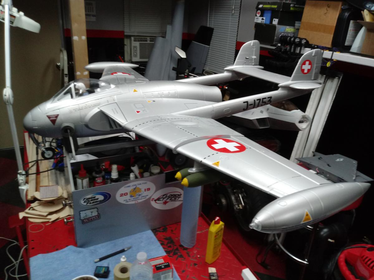

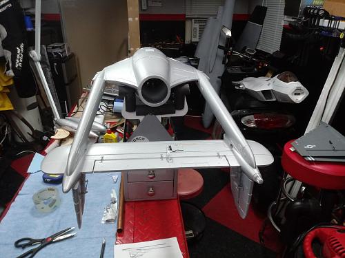

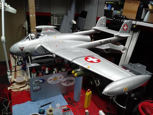

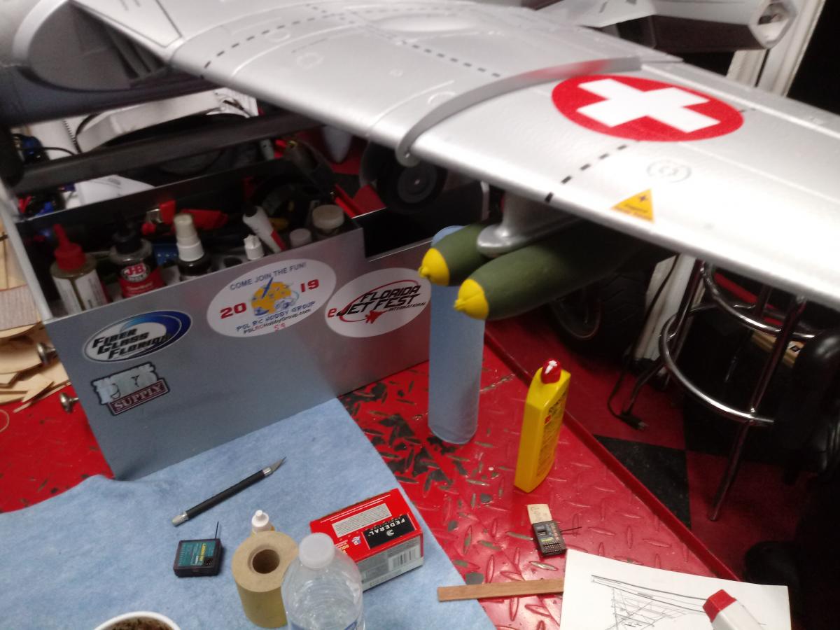

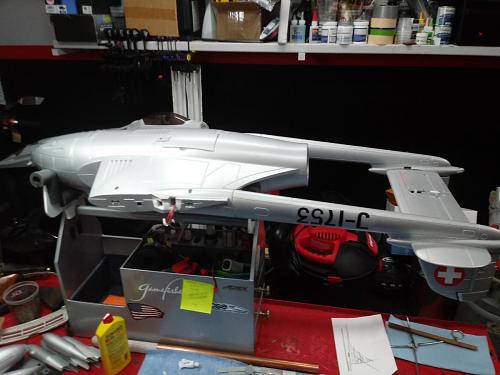

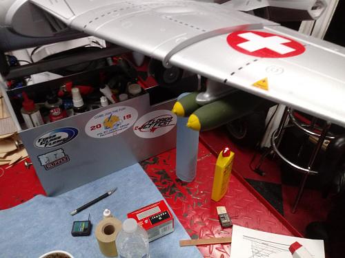

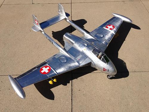

                          • Well, got her all together. Still have to install the receiver and route all the wires. Had fun painting the bombs, and the glue up was a breeze. Should be ready for a maiden soon. This thing takes up some space ! Click image for larger version

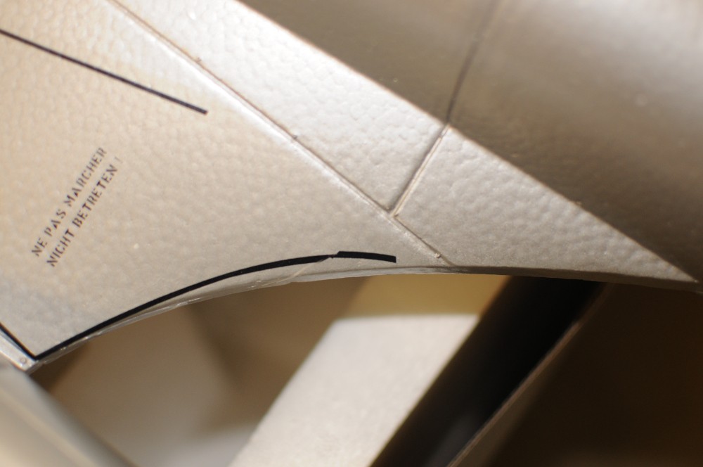

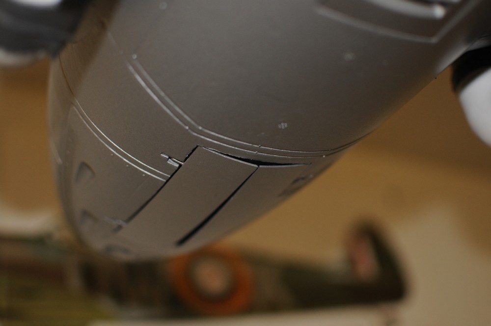

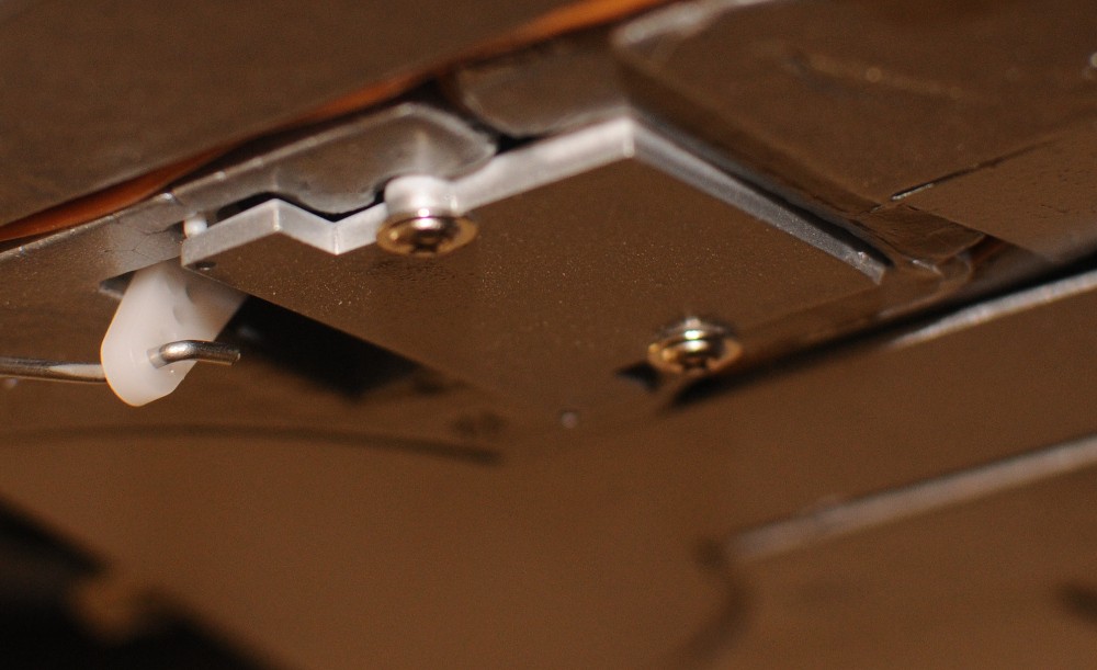

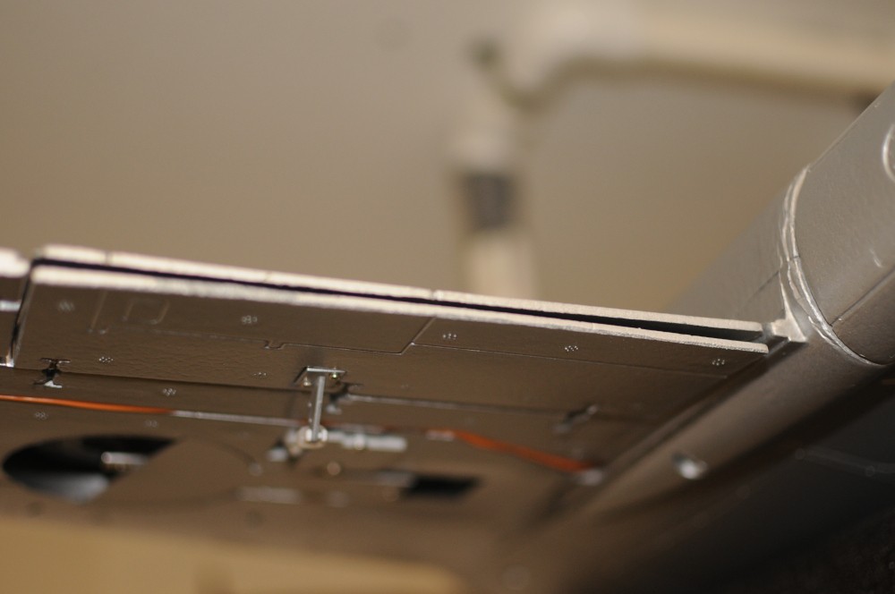

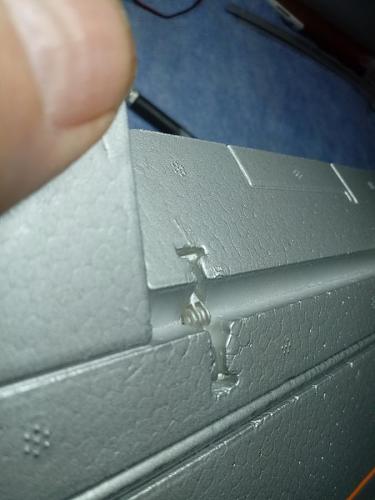

                                      • This is not intended as a rant but I'm not going to sugar coat it. I tend to not fall in the fan-boy category. If a product is good i'll give it props. If its crap, I'll let you know. This model out of the box it seems to be a mix of both. This is also my first freewing EDF, so I was not too clear on what to expect when I opened the box. Also admittedly Im a bit of a perfectionist so little things can really irritate me. So thats why Im posting this. I would like to know from you guys who have more experience with EDFs and specifically Freewing AC whether out of the box problems I saw are actually fatal flaws, inconsequential bugs, or intended features.
                                        1. The manual is a joke. 10 pages in broken english that show how the parts go together. I get it. A lot of this stuff is common sense, but a lot of it isnt. As a relative noob and a total beginner for EDF's Itd be nice to have a little more clarity especially when the the model is promoted as being a good place to start with EDF's. Other than vaguely showing you where CG is there is 0 instructions on initial set up. Is it, as motionrc chat support suggests, you are supposed to go to the forums like this one to get answers. We'll here I am. Regardless an initial recommendation on flap settings with elevator mixed in would have been nice
                                        2. How hard is it to put a decal on straight? not a deal breaker because I intended to customize the paint job anyway, but still indicative of slack QC.
                                        3. Speak of slack QC, the tube in the starboard wing panel used to mount the boom came unglued and was just bouncing around in there. I used some of the epoxy that came with the kit to re-attach and added a bit more to reinforce it. Re-enforced the other side too because I was really becoming unsettled with QC at this point and also wanted it to be balanced.
                                        4. Both flaps were warped. one more than the other. Motionrc suggested using wet towel heated in a microwave to lay over to correct. Which I did and it did help but again not perfect.
                                        5. The canopy had a 1cm deep dent in it about the size of a quarter. I was able to pop it out but it left a noticeable crease. not a biggie but still grrrrrrr

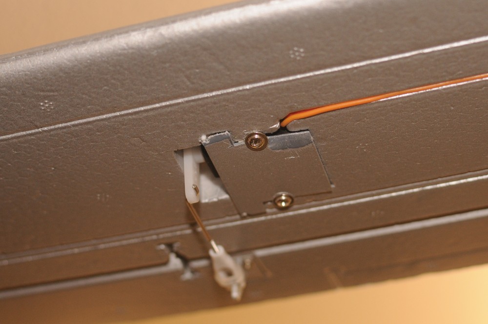

                                        6. All panels covering servos on exposed surfaces do not align with surrounding surface. Even if the tiny holes in them aligned with the registration pin, which none do, I doubt they would still be flush because the servo under them seem to be too wide. this leaves about a 2 or 3 mm hard edge sticking out on horz stab and both wings. I actually filed it down on the stab to help laminate airflow a bit because the high side was facing forward.
                                        7. Nose gear doors misaligned when closed. Im not expecting perfection here but 4-6 mm gap? Thats seems a bit too off not to affect flight since airflow into the nose gear cabin probably pushes them out further in flight.
                                        I was able to get it up in the air. It flew well but way out of trim. Getting back on the ground was traumatic :). But I did somehow manage I think once I get it dialed it will fly great and that is all that really counts but I still go to wonder if some of the things like the servo cover panels and gear doors are un-correctable or just typical stuff you just deal with and fix. I mean, if any you had opened the box and saw some of this stuff listed above, would you have reboxed it and sent it back or moved forward? Again, not trying to start a flame war. Just want some insight. Any constructive feed back would be appreciated.
                                        FWIW, I got a second flight in with an assist from someone more knowledgeable with EDF's. He did ask about recommended set up. I told him there was none in the manual. He seemed surprised. He added a bit more expo on pitch and roll and mixed in a bit down elev with flaps. He also helped me with trimming it out. This flight was better but on landing it didnt quite flare like I had hoped and took a little one hop came back down on nose gear. The door popped off, which I found. the spring that actuates it went who knows where. Encouraging though.
                                        Click image for larger version  Name:	image_54978.jpg Views:	3 Size:	123.1 KB ID:	249310Click image for larger version  Name:	image_54979.jpg Views:	3 Size:	77.7 KB ID:	249311Click image for larger version  Name:	image_54980.jpg Views:	3 Size:	63.4 KB ID:	249312Click image for larger version  Name:	image_54981.jpg Views:	3 Size:	56.1 KB ID:	249313Click image for larger version  Name:	image_54982.jpg Views:	3 Size:	65.2 KB ID:	249314Click image for larger version  Name:	image_54983.jpg Views:	3 Size:	106.1 KB ID:	249315Click image for larger version  Name:	image_54984.jpg Views:	3 Size:	94.7 KB ID:	249316

                                          The Venom's manual, you're right, it's sparse. The servo covers? They were seen as a revolution at the time but yes, today a couple millimeters seems off to someone who flies more recently developed foam jets. The canopy dent... That shouldn't have happened and would definitely irk me as well.
