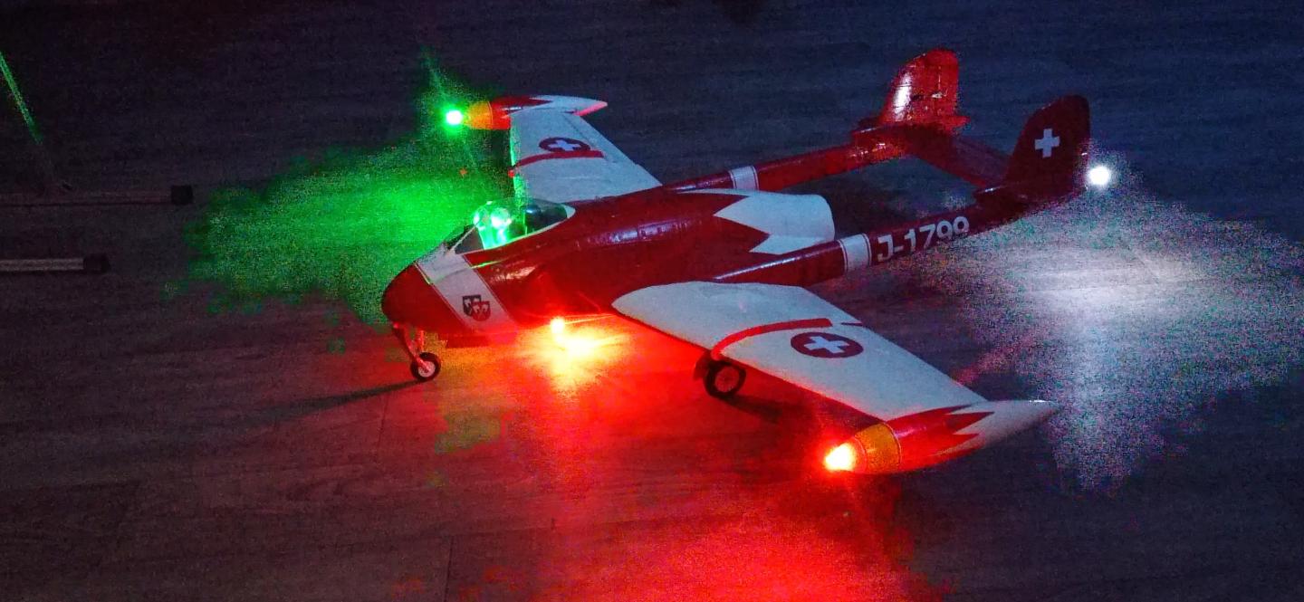

ID:	307776 Hi Guys
        Something different o0n my Freewing Venom..
        Rotating red led on the bottom.

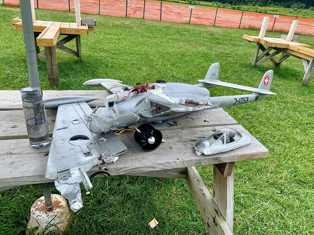

            #305

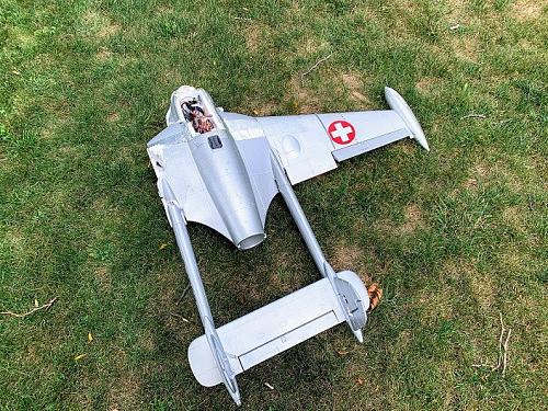

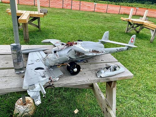

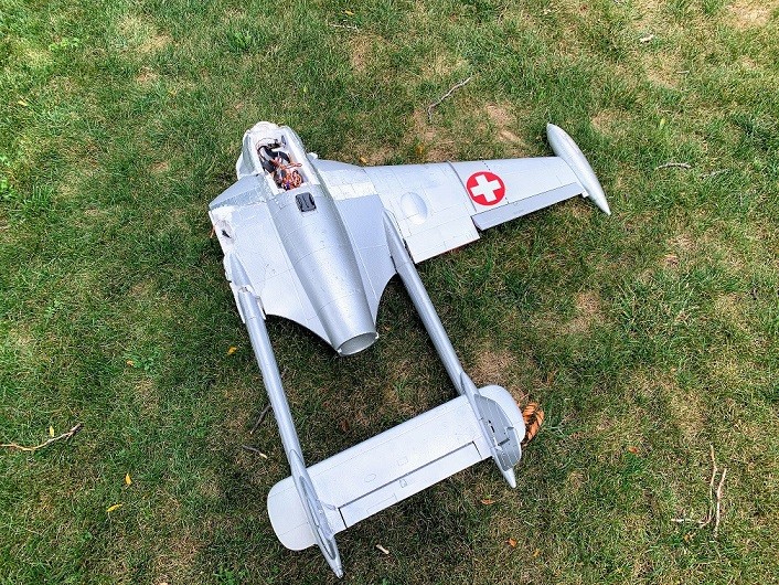

            High speed wing failure, hardware was still intact in the brackets. Waiting on backorder fuselage.

            • BikeMike
              • Oct 2021
              • 45
              • Charlotte, NC
              #306
              Thanks Rocky9! Would you tell us more about the high speed wing failure? This has me concerned. I've seen a couple of crashes on YouTube with the Venom not handling a steep, fast dive.

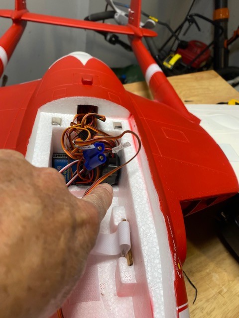

                #307

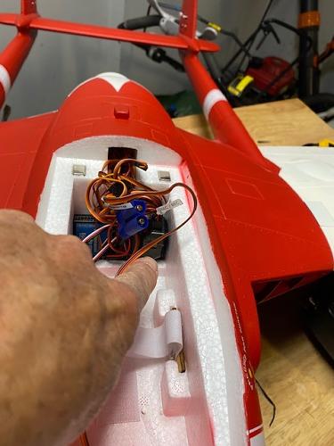

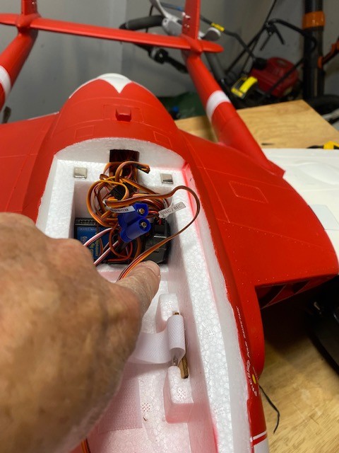

                Click image for larger version  Name:	Rats Nest.jpg Views:	0 Size:	68.7 KB ID:	327358
                Just finishing up my new Venom and I wanted to ask everyone a couple of questions:
                1. How did you handle the rats nest of wires in the top of the photo? I would like to have a neater arrangement, but I can't think of anything but stuffing them back in and hoping for the best.
                2. Where did you put your receiver? I wanted to use a nice AR637T, but I can't find room to orient it correctly. So, I'm using a simple AR620 I had laying around. The only place I can find for it is where I'm pointing in the photo.
                All suggestions appreciated.
                • Dwalkerp47
                  Dew-Man
                  • Jun 2018
                  • 31
                  • Euless, Texas
                  #308
                  It is a tight fit for the receiver, especially when you have to fold the wires back, and be wrapped to prevent that "Rat's Nest." I have an older Venom of which I have an AR636 installed on its edge against the fuselage side. I'm flying with an Admiral 5000 6S, so the receiver is real close to the battery. Even with the antennas on the AR636 pointing towards the nose, I fly with remote receivers typically located as far forward towards the nose so that I know that I'm receiving my RF signal without the battery trying to block some of the signal. I know Spektrum boasts that their AR620 is improved when it comes to the receiving capability, but I still prefer the "Whisker Antenna" that you get on the AR637T. I guess I'm "Old School." I'm working today, so I'm not able to send you any pictures.

                                  There is some room right under the battery . You have to cut a hole but it really frees up space!!
