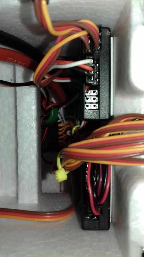

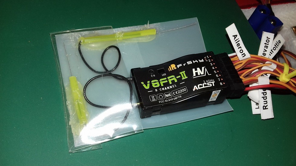

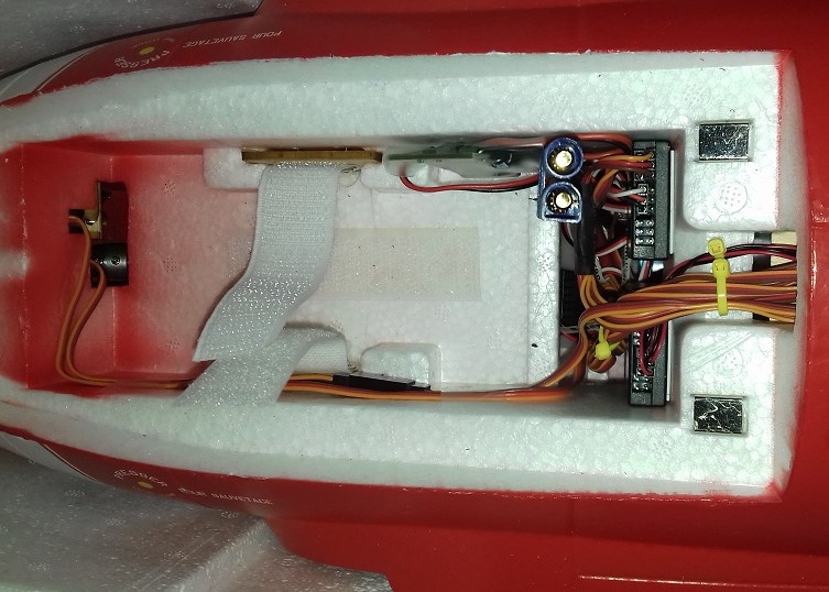

    Thanks for the helpful suggestions on mounting the Rx in my Venom.
    With some careful teasing of the servo cables into the radio bay, I found that there was more spare length on the servo cables than I originally thought. So this allowed me to locate the Rx at the bottom of the fuselage under the rear of the flight battery shelf.
    To keep the 2 Rx aerials at 90 deg to each other (for diversity) I mounted the Rx on a piece of scrap plastic (old milk bottle!) with short lengths of hollow control snake hot glued to it, to hold the aerials in place. I then covered this with heat shrink.
    It was then easy to push the Rx down the slot behind the flight battery shelf and then around the corner to be under the shelf.
    I attach some photos to show what I did.
    Click image for larger version Name:	Rx location sm.jpg Views:	0 Size:	53.0 KB ID:	285293 Click image for larger version
ID:	285294Click image for larger version
Name:	Rx mounting sm.jpg
    Thanks again for your help.

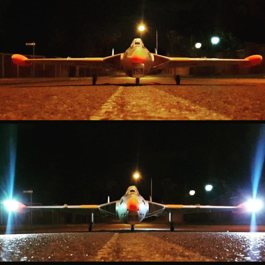

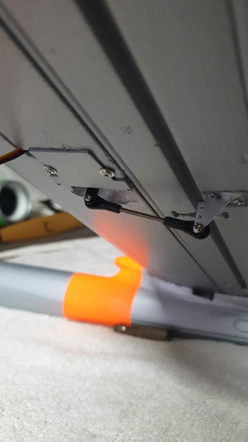

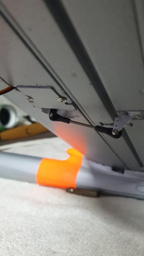

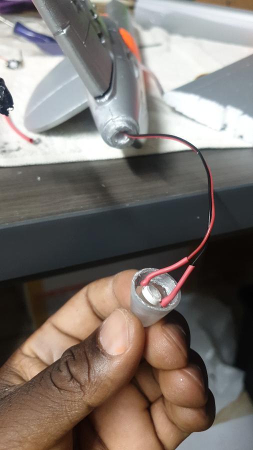

                                  #296

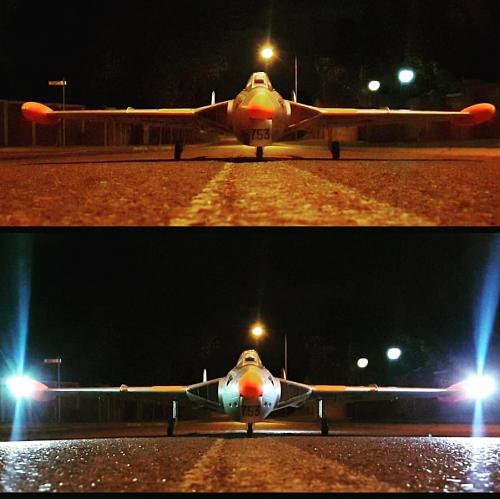

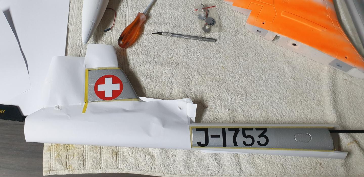

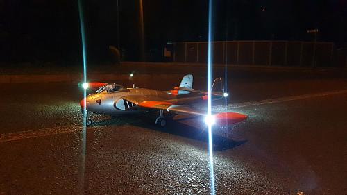

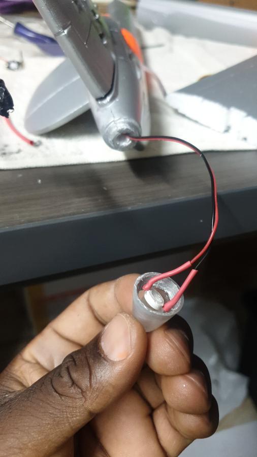

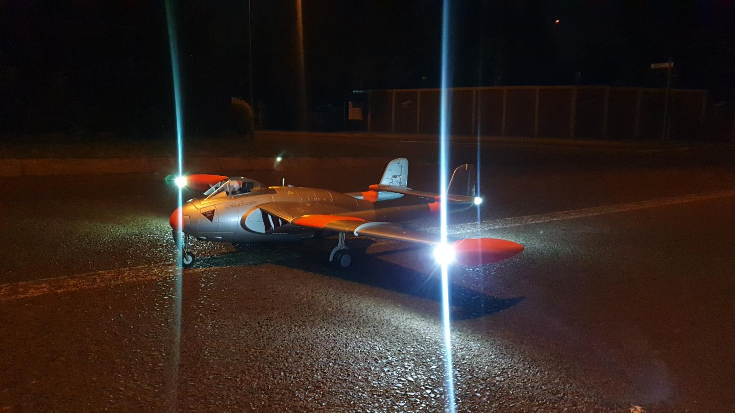

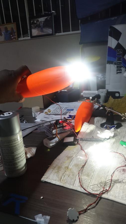

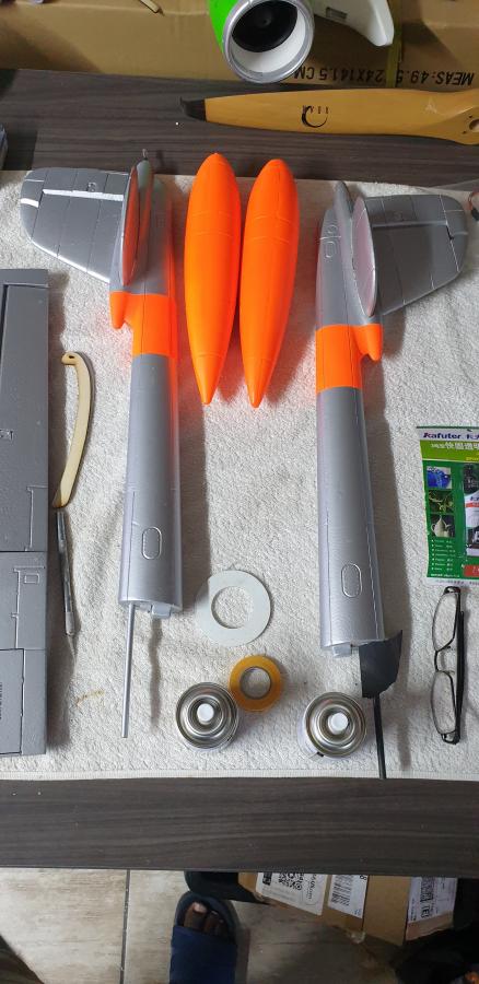

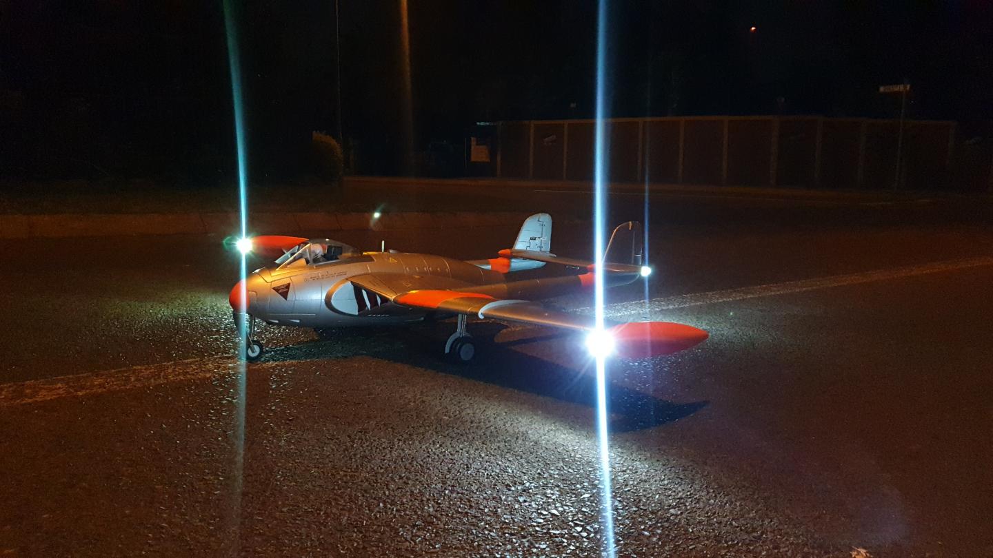

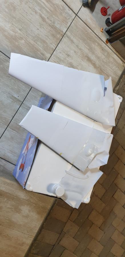

                                  Ready for maiden flight.
                                  This is my second Venom.
                                  The first one Elevator servo failed while coming out of a dive.
                                  So this time around:
                                  1. I installed a Hitec 3kg torque servo on Elevator.
                                  2. Changed the hardware
                                  3. Painted the SAAF Vampire Livery

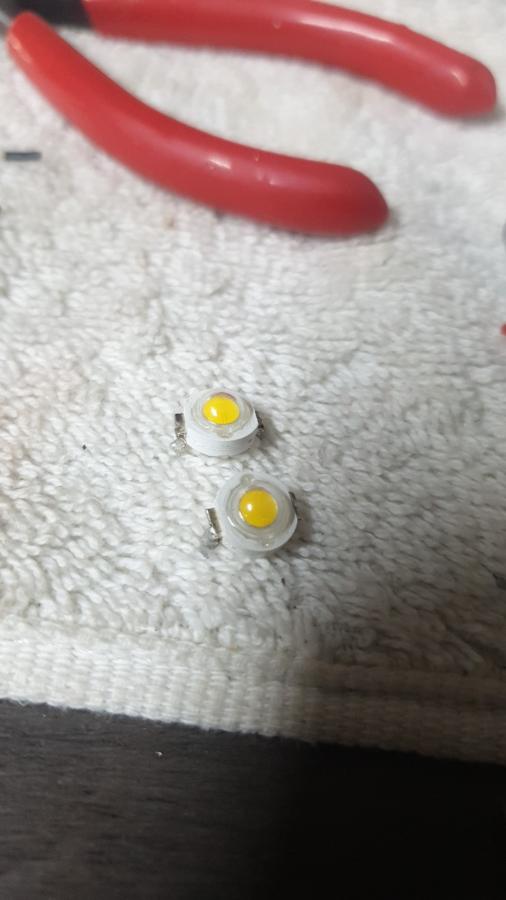

                                  4. Installed 3W Led lights
                                  Maiden flight video to follow soon
                                  Click image for larger version  Name:	IMG_20210106_015541_426.jpg Views:	0 Size:	77.9 KB ID:	293209
                                  Click image for larger version  Name:	20210106_003008.jpg Views:	0 Size:	131.0 KB ID:	293210
                                  Click image for larger version  Name:	IMG-20210104-WA0083.jpeg Views:	0 Size:	33.6 KB ID:	293211
                                  New Hardware Installed

                                    #297
                                    good work there. are you running them through stock led controller? also can you share the link to those leds please
                                    • BraPapaD
                                      • Feb 2020
                                      • 14
                                      #298
                                      Hello Subhan
                                      Happy new Year
                                      Yes, I am running them on the standard controller.
                                      it has 3 slots for 1w to 5w LED.
                                      I bought the lights at Communica is South Africa.
                                      Their Website is : https://www.communica.co.za/

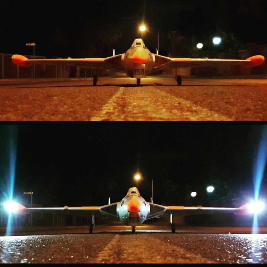

                                        Maiden flight Done and Dusted.
                                        What an awesome EDF.
                                        Handling, speed, whoosh sound and appearance.
                                        Our airfield is at 4300ft, Pretoria Radio Flyers at South Africa
                                        More information is on the video description
