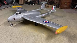

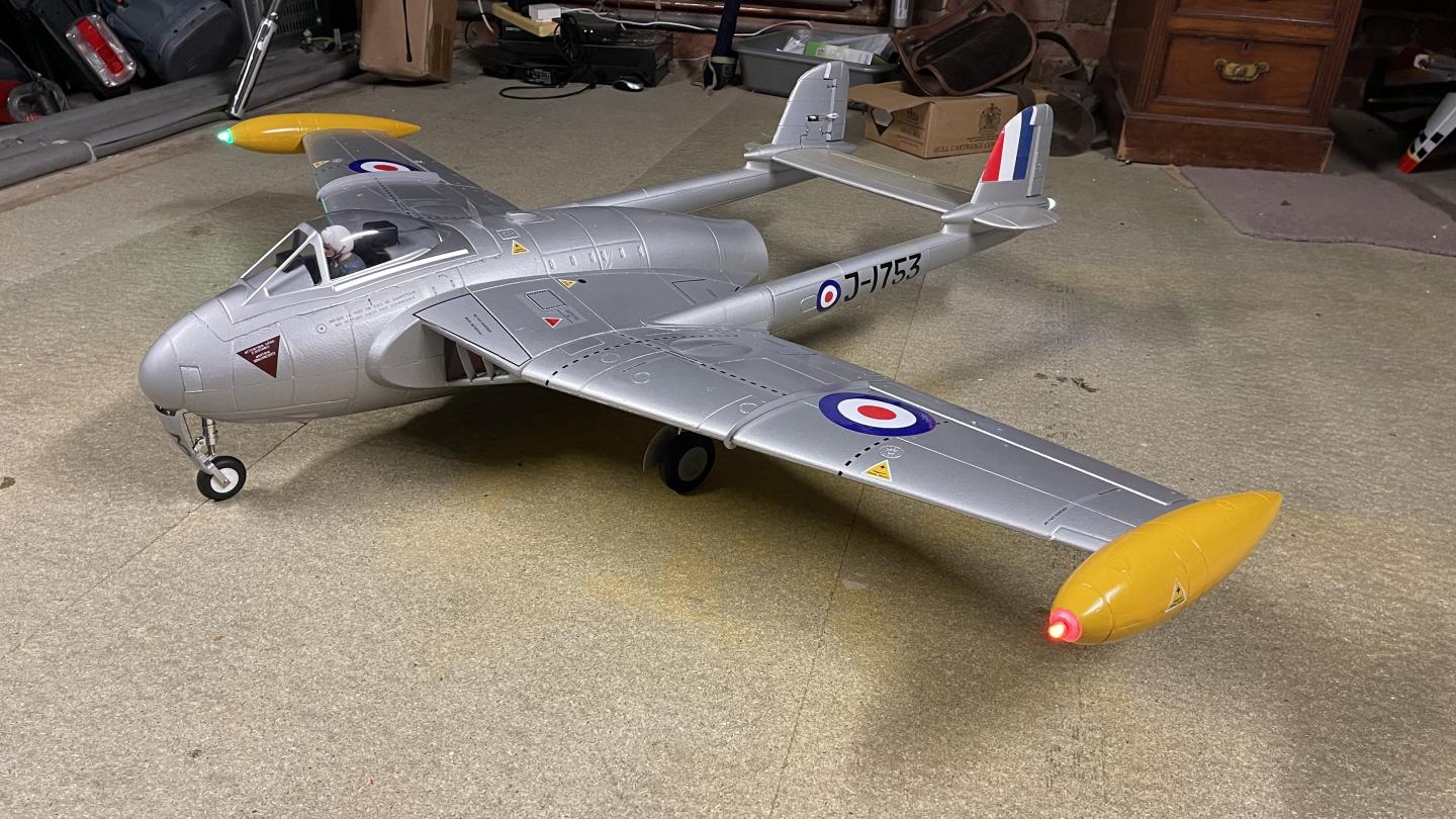

                              Ready for maiden flight 😬 More like RAF Vampire colours than Venom but what the hell

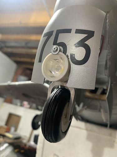

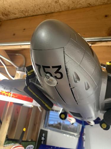

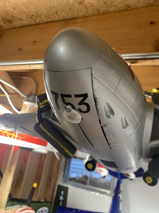

                                Repaired Venom getting ready for Spring. I installed a landing light in the nose gear door, not the scale location but works for me. The light turns on when gear deployed and shuts off when retracted.

                                  Nice !!! Can you let me know what you used to do that ?

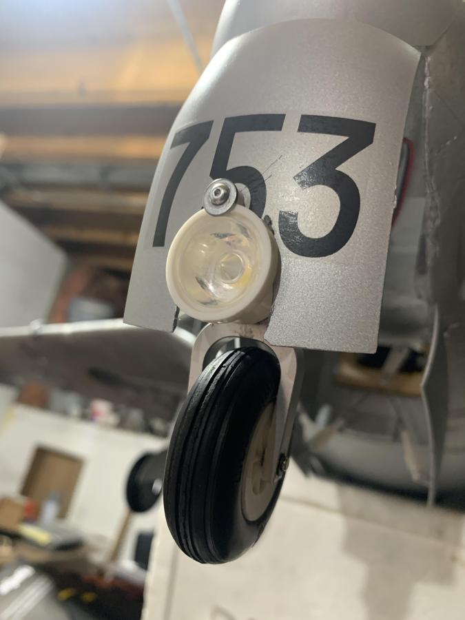

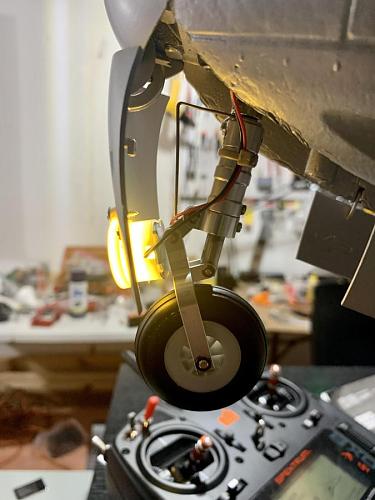

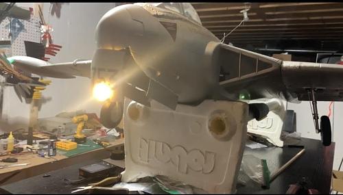

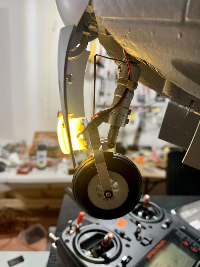

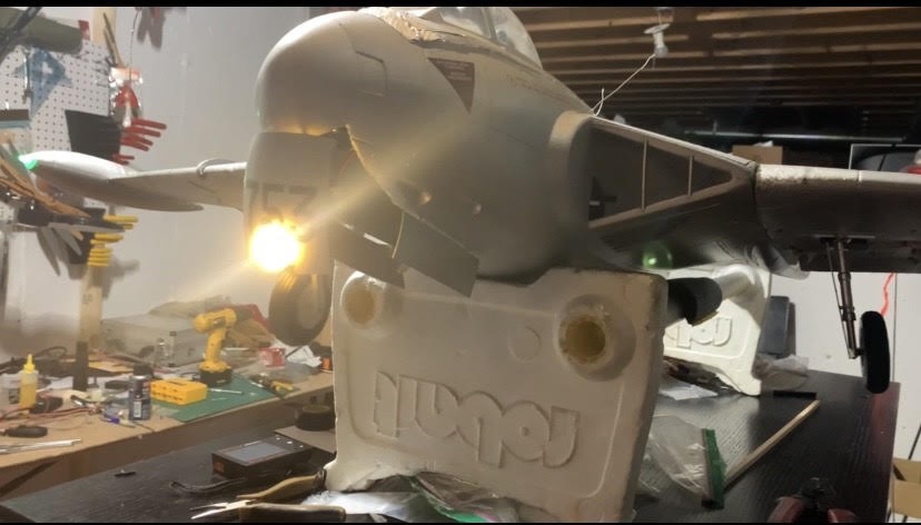

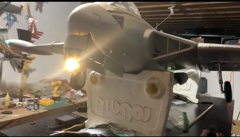

                                    It wasn't too bad of a mod, I used my Dremel to gut a U shape in the fwd gear door and screwed the light right to the plastic. The wiring can be fed up through the gear well and back to the LED Light Controller box. The tension spring is not strong enough to lift the door with the added weight of the light, so I zip tied the wire to the strut for now, I'll need to come up with a way to mechanically link the door to the strut. I used the 5W LED light offered by Motion. https://www.motionrc.com/collections...00mm-lead-e612

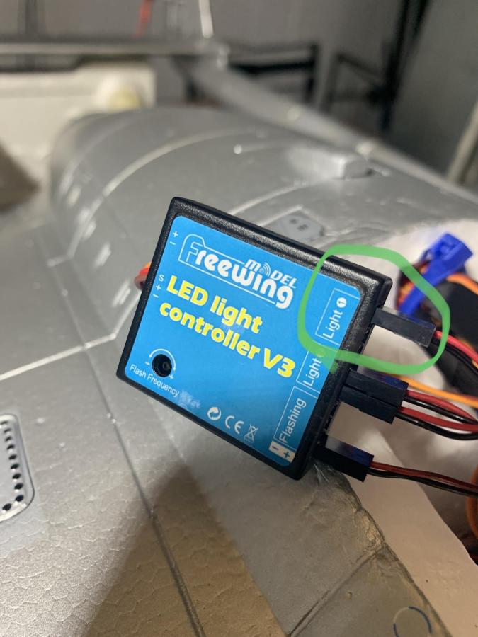

                                      Great thanks very much for that 👍👍 Just one more question, does the light come on when the gear is lowered and if so how do you set it up ? I can’t find any instructions for that light controller.
                                      • Rocky9
                                        • Nov 2018
                                        • 14
                                        • Vernon Hills, IL.
                                        #359

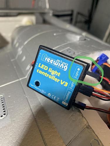

                                        Yes the light turns on when the landing gear is lowered. Plug the light connector into the channel I have circled in green on the LED controller pic.

                                          OK great , just ordered a light from MRC. I was thinking I’d have to link it to the gear channel on the receiver as well as setting it up on the transmitter.
