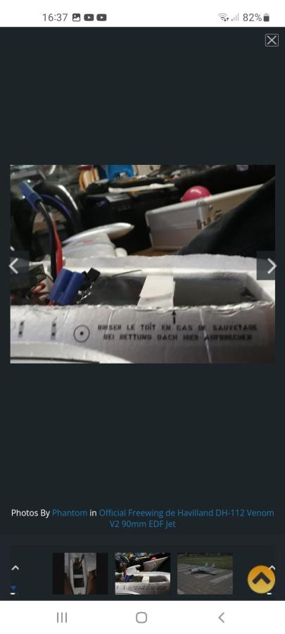

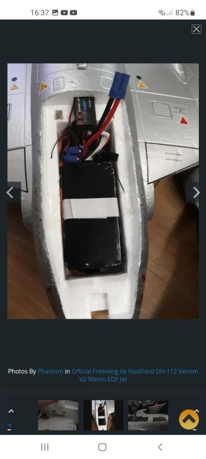

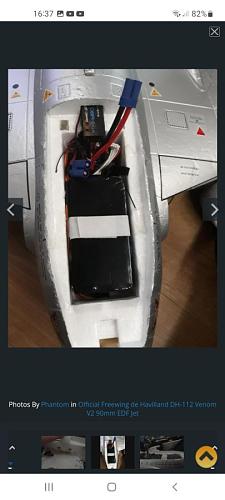

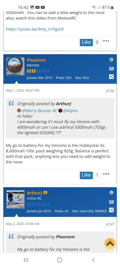

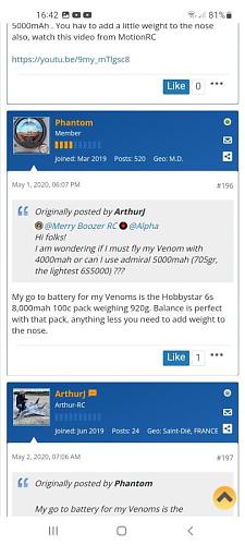

      How on earth are you able to get an 8000mah, 6s battery in there? I barely get a 5000 in there and that's using some of my dimensionally smaller ones. I have 6000mah, 6s CNHL and I doubt I can get one in there and make it balance.

        Xviper, I posted about of using the 8,000mah brick back on post 196 of this thread, page 10 if I'm not mistaken. I posted pics a couple of posts later. After going back and reviewing the pages it would seem that there was a consensus about adding weight to the venom for a more forward CG and increased favorable flight characteristics. Click image for larger version

          I see it now. That was 2.5 years ago. My memory is good, just really really short.

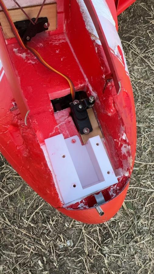

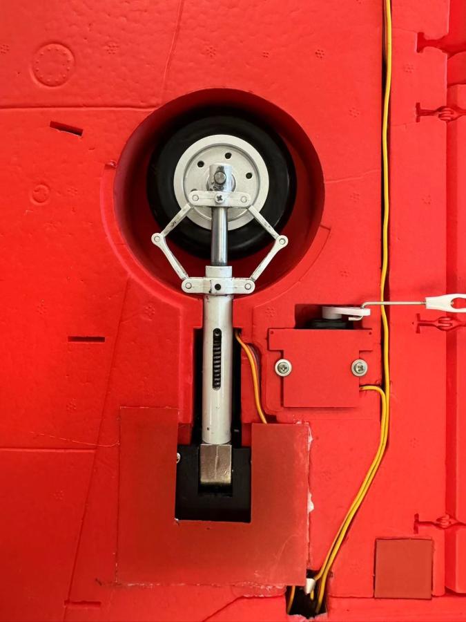

                          Hi everyone, has anyone done any reinforcement to the nose gear mount?

                            yes i did.upgrade nose gear mount with freewing 80mm T33's Landing Gear Mounts,also cut some foam。Click image for larger version

                            and i upgrade main landing gear with F9F's landing gear but the wheel is from fms 80mm F16

                              excellent idea! thanks for that! I will look into doing something similar.

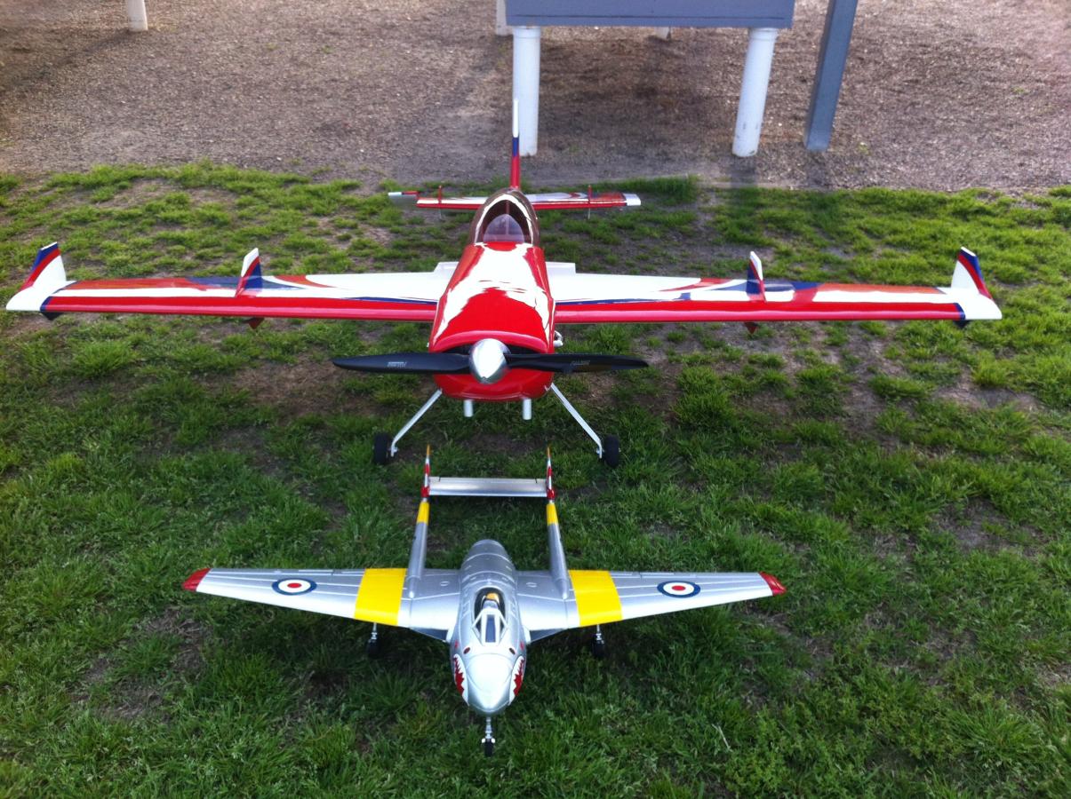

                                I can’t understand why Freewing/motion discontinued this amazing model. It’s sold out everywhere, my 6 year old girl still gets tons of attention and questions… and she’s pretty beat up.

                                  The answer always lies in the sales figures. If it is selling well and consistently, it does not get discontinued.
