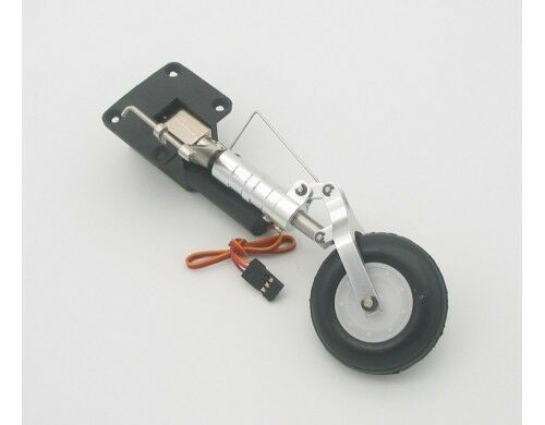

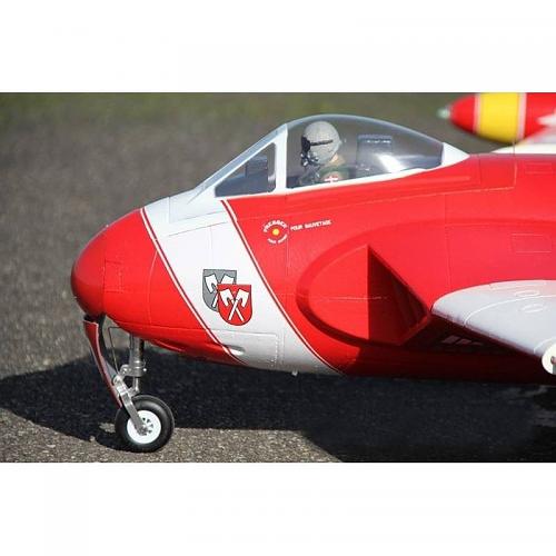

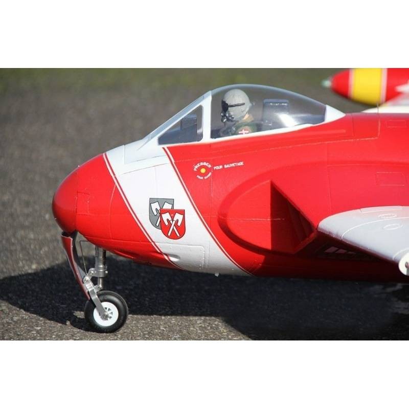

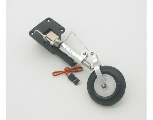

        Does anyone have a DH-112 V2 with a picture of how to attach the square nose gear door (with the 99 on it) to the trunnion using the spring? Greatly appreciate it.
          #264
          fredmills
          The small spring attaches to the hook on the inner face of the door, then clips into a nook under the nose.
          There is also a sprung wire attached to the nose strut (visible in the product photo, below).
          Click image for larger version  Name:	s-l640.jpg Views:	0 Size:	20.5 KB ID:	274384
          Here is what it looks l like from the side, in relation to the door:
          Click image for larger version  Name:	freewing-de-havilland-dh-112-venom-v2-90mm-jet-arf-swiss-red.jpg Views:	0 Size:	68.8 KB ID:	274385

            Thanks Alpha for responding so quickly!! Truly appreciated!

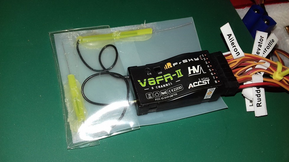

                                Hi. I have recently bought a Freewing Venom (Swiss red airshow scheme).
                                I also bought an Admiral 4500mAH 6S LiPo battery, as this was the only 6S battery of appropriate capacity that was in stock when I ordered the model. I think this a bit longer than some other LiPo batteries of this capacity (length is 158mm). It looks like I will have to cut off the lip at the rear of the battery shelf to mount the battery flat on the shelf.
                                I have assembled the Venom. No serious problems encountered, and it all looks good.
                                Now I am installing the receiver (FrSky V8FR-II 8 channel) and connecting everything up.
                                Problem is that I am not sure where is the best place to mount the Rx – see photos.
                                With the Rx placed flat against the LED light controller, the battery virtually touches the Rx (with the battery as far forward as possible).
                                Any ideas where is the best place to install the Rx? (And the UBEC, although this should fit alongside the LiPo battery).
                                I can see there is unused space under the rear of the battery shelf (behind the nose wheel well), but I cannot see how to access this area, and also the cables are not long enough to reach the Rx in this area.
                                Has anyone else had this problem, and where did you mount your Rx?
                                Any ideas/suggestions would be appreciated.

                                  #276
                                  My RX goes down into that hole at the rear of the battery compartment. If you pull everything out of that hole and then neatly put it all back in, a RX will fit quite nicely down there. I've also seen some people carve out foam where that trench is in the middle for all the wires to go to the rear of the plane.
                                  I have run the old style 5000 Admiral "bricks" and now run the Gens Ace 5000. Both fit quite well.

                                    I hogged out a bit of foam at the rear of the hatch, above where all the servo leads come through, and fit the rx in there. The servo wires have plenty of room still to pass underneath.
                                      xviper - thanks very much for the advice - I shall give it a go. I guess I didn't try hard enough to rearrange the wiring previously!
                                      thanks also mshagg for your response.
                                      very helpful stuff

                                        mshagg's idea is also a good one. I did that to install my gyro in that space. I've since removed the gyro because after flying it with a gyro, I realized that this plane doesn't really need one. I took it out to put into another plane that needed it more.

                                          Thanks for the helpful suggestions on mounting the Rx in my Venom.
                                          With some careful teasing of the servo cables into the radio bay, I found that there was more spare length on the servo cables than I originally thought. So this allowed me to locate the Rx at the bottom of the fuselage under the rear of the flight battery shelf.
                                          To keep the 2 Rx aerials at 90 deg to each other (for diversity) I mounted the Rx on a piece of scrap plastic (old milk bottle!) with short lengths of hollow control snake hot glued to it, to hold the aerials in place. I then covered this with heat shrink.
                                          It was then easy to push the Rx down the slot behind the flight battery shelf and then around the corner to be under the shelf.
                                          I attach some photos to show what I did.
