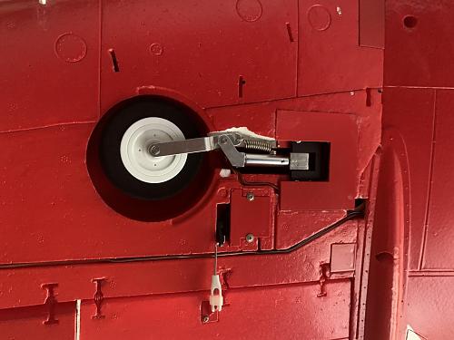

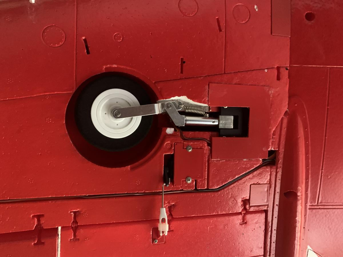

                              I found this plane to be a "bouncer" on landing. Landing on grass is better than landing on a smooth, prepared runway, but it was still difficult to "grease" the landings consistently. I replaced the stock main struts with trailing link struts from another plane of a similar size and the bounce has been dealt with. I still do the occasional bounce but not nearly as much or as bad as before. I also found that landing without flaps produced better results. Using flaps for landing can tend to cause the plane to be too floaty and any kind of bounce can cause the plane to rise again. Without flaps, the bounce seems to be absorbed better. Landing with flaps and no bounce is quite possible but requires more finesse and better throttle management.

                                Thanks for the info' about the main struts - you don't happen to have a handy link to where I could buy some do you (or a picture of yours)?

                                    It's been so long since I did that mod, that I can't remember which plane they came from. Here's a picture of that strut. As you can see, it needs a little foam removal to fit. I went to the Motion site and looked at all planes about the same size as this Venom and found one that had the trailing links and bought a pair of struts.

                                      Thanks for the replies - I might give that landing technique a try (I have been trying to bring it in fast like a jet!). I've nothing to lose. If I end up making repairs again I'll add some different struts like Xviper suggests.

                                        Think the Avanti rear mains would work?
