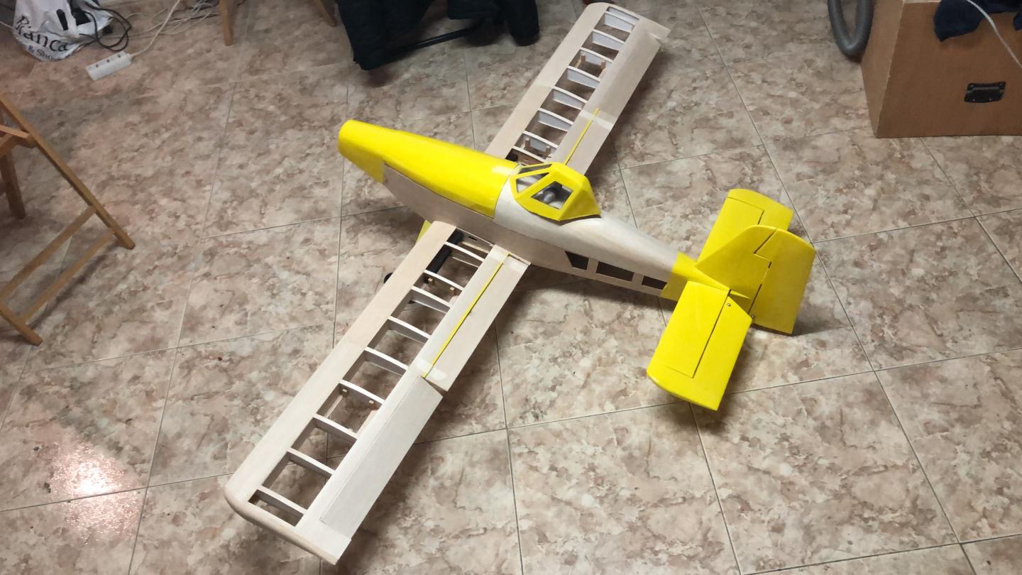

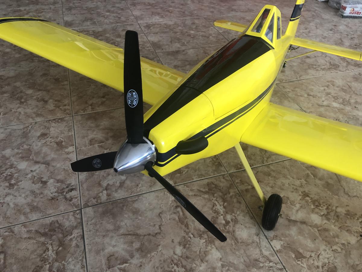

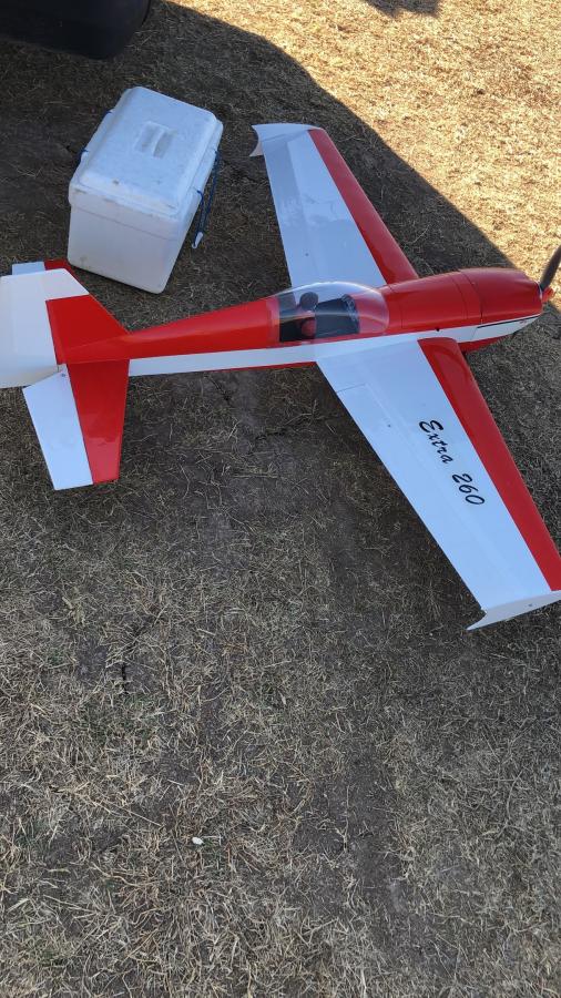

                          Hello from Spain!
                          I'm a beginner on EDF planes, but also a scratch builder and I've owned many big gas warbirds.
                          Now I'm converting all my fleet to electric, cause I have less "maintenance" time and I need to "plug and fly".
                          My first option was Freewing ME-262 but due to our flying field, low EDF units of the ME-262 may cause me problems.
                          So I'm wondering on getting the Venom.
                          The question is that I already own some battery packs on 6S, but they're 6000mah 900g graphene bricks.
                          Do you think the Venom can handle this? Will I be able to get correct CG?
                          I know there's a test with Admiral 6000mah packs, but they're only 844g.
                          Here you have a couple of my latest electric planes :)
                          My next one will be the Heinkel 162 with 90mm EDF.

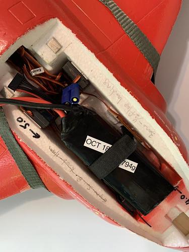

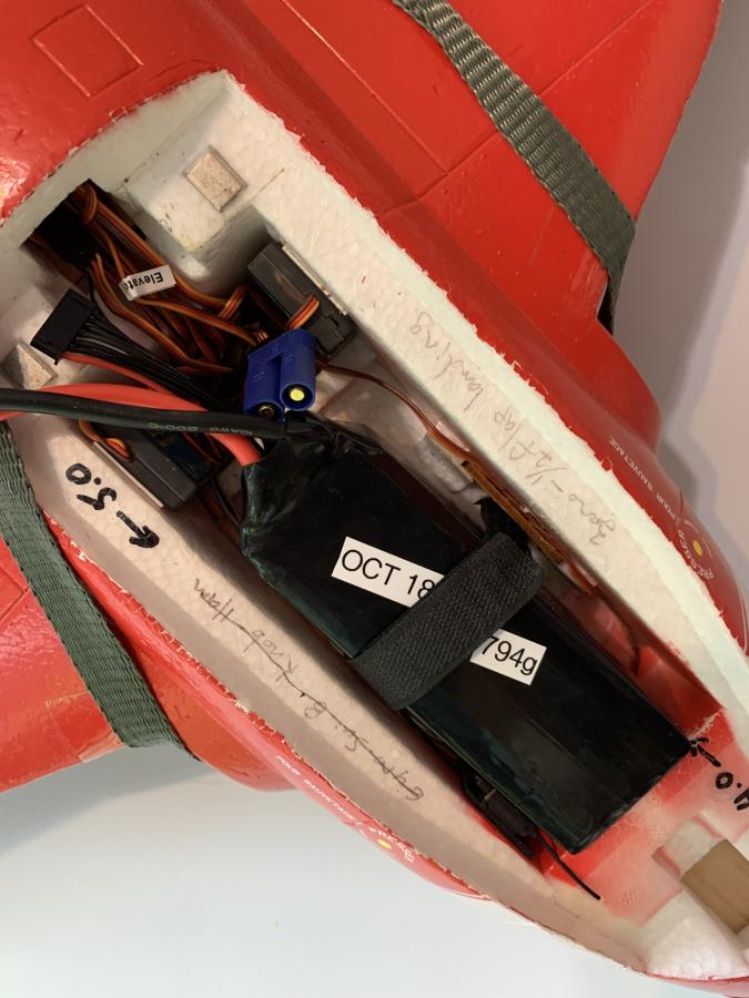

                            Here is a picture of my Venom with an 800g, 5000mah, 6s pack. As you can see, it has to go as far back as possible against that rear lip. A 900g pack is possible if you cut that lip off and move the battery even further back. Those two little boxes (RX and light module) can be relocated elsewhere and you can be creative about how to stuff the battery/ESC wiring along side the battery.

                              Thanks Xviper for your quick reply.
                              My battery packs measure 55x65x160mm
                              Will they fit?
                                • 8791
                                #375
                                The battery you see in my photo is 50mm X 50mm X 150mm. It's going to be tight. You could do it if you carve out some foam on each side. The 65mm side will have to go across the battery tray because if it were standing on edge, the canopy will not close. Even at 55mm in height, the canopy might have to get a shave. The battery will have to go much further rearward due to its length and the additional 100g of weight. But as you can see, after that lip, there is another 30mm or so of room. You can extend the battery tray and also relocate the battery strap. The light control box can get shoved deeper into that well (below where you see mine) and the RX can be relocated either to the rear where all the wires go in if you carve that space a bit bigger or put it to the nose of the plane with some extensions. Getting the battery cables to fit and have the canopy close will take some finesse.
                                This plane is very powerful and has a lot of lift, so other than battery placement for achieving the proper CG, the overall weight of the battery is nothing for the plane to carry.
