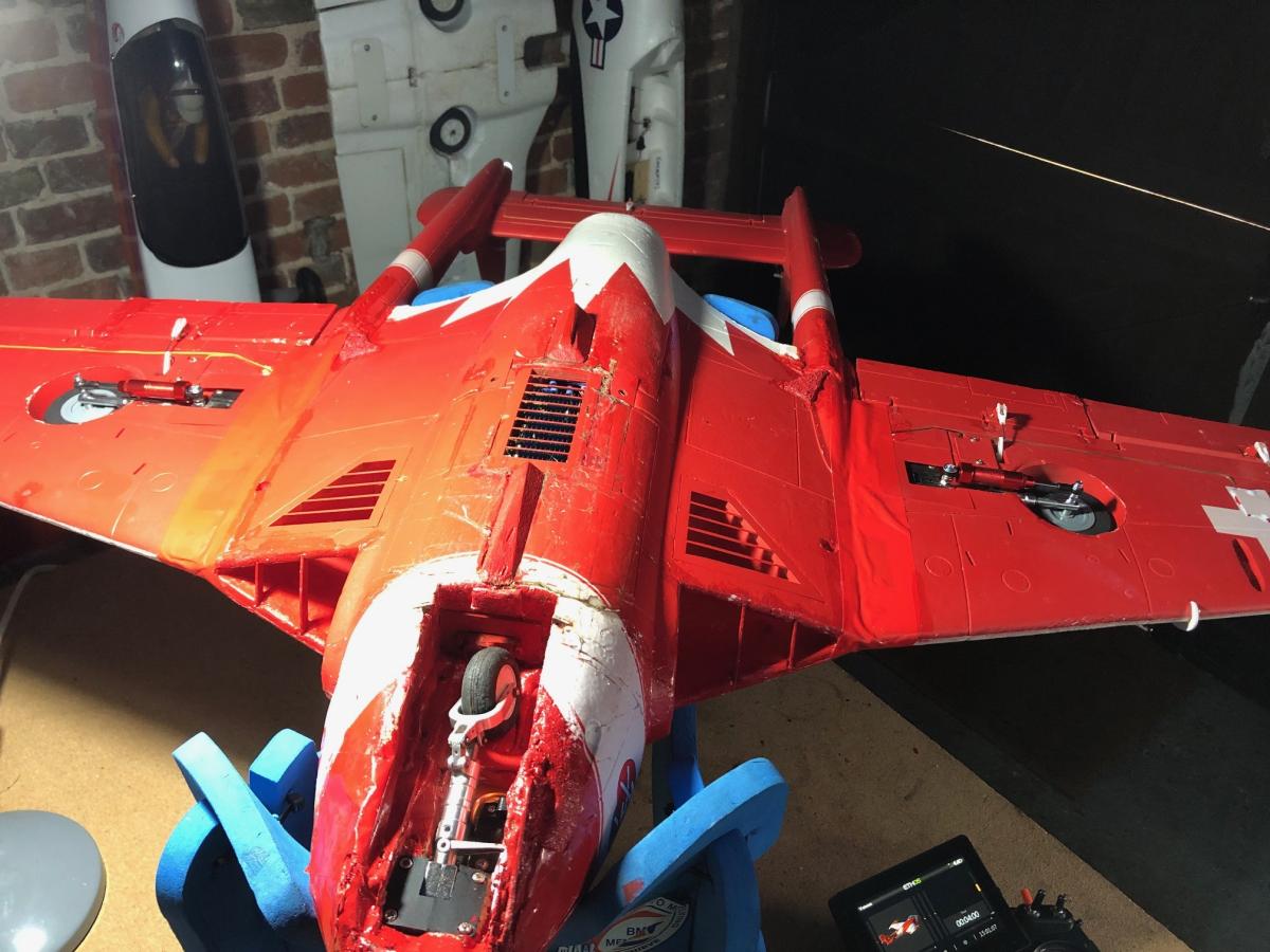

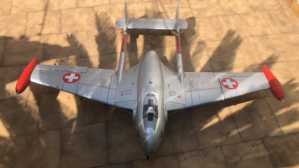

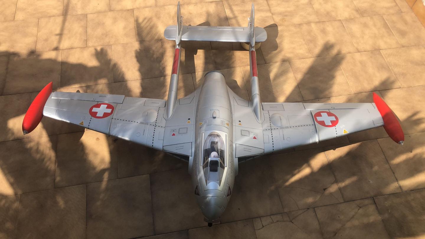

                    Finally I've only painted the fuel tanks on wing tips. Factory paint is such weak that I could not put any mask tape so I decided to go for the "easy" way.
                    Added two strip decals on tail booms to cover some paint chips that appeared when removing masking tape 😑😑 .
                    Hope it will gain in visibility.
                    Have you ever thought about vent holes for battery compartment?
                    I've also added a 3D printed exhaust nozzle to reinforce that zone, so that I can handle the plane from there. If someone else needs that, send me a PM.

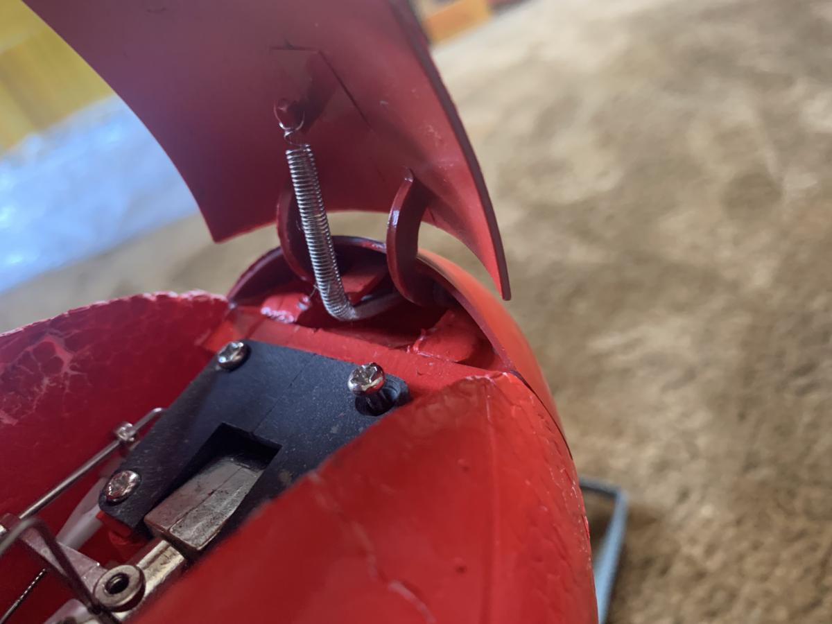

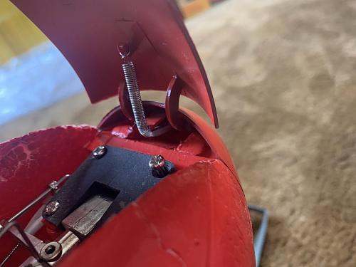

                      unfortunately on the last landing I’ve lost the spring that holds the door of the nose landing gear.
                      Can please someone send a picture of how the sping is installed?
                      Thanks

                          Thanks xviper
                          I'll try to find a spring that could fit in.

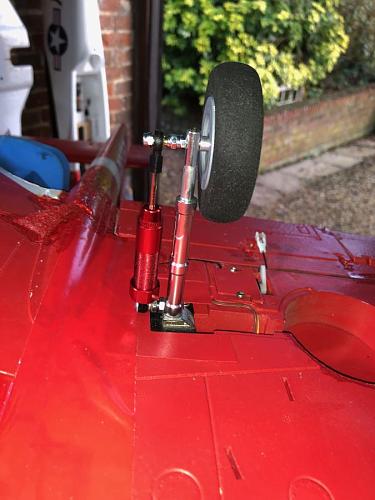

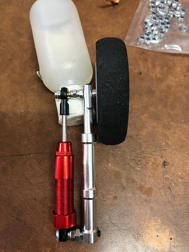

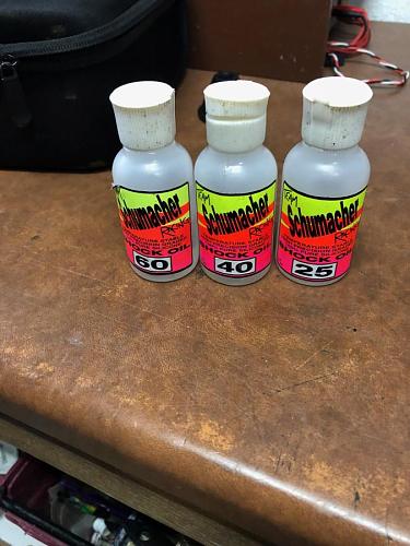

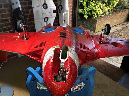

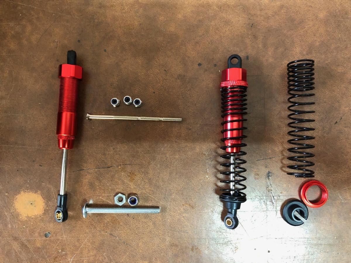

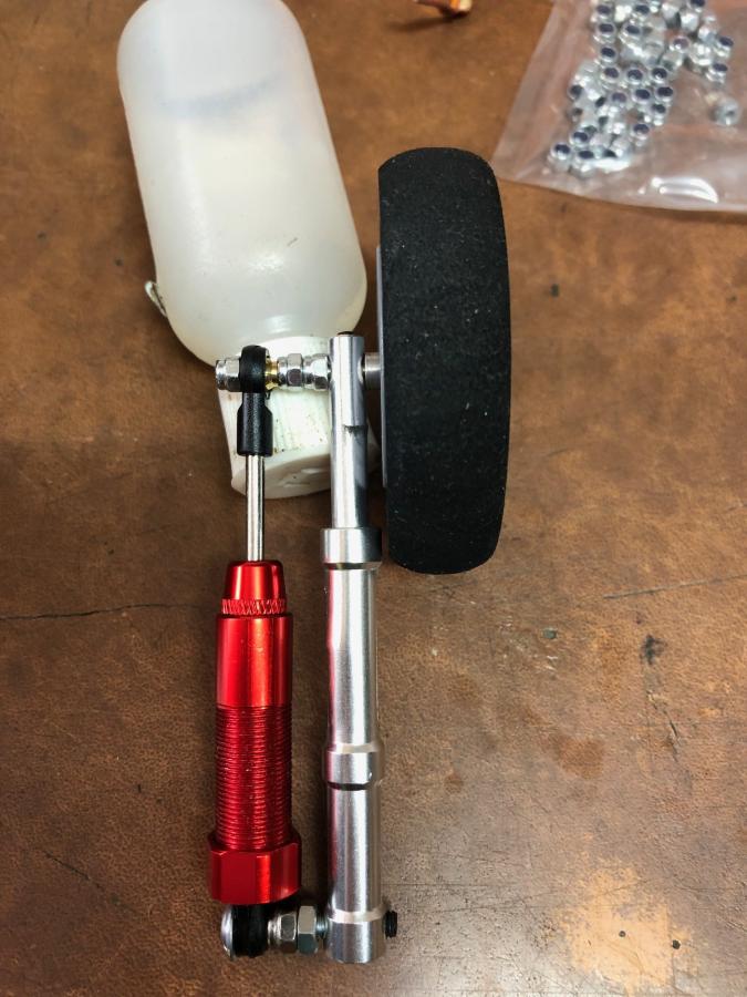

                                    I've never mastered the art of landing this 'plane consistently without a "damaging bounce" and I can't seem to find any trailing link struts to fit so I decided to add RC car dampers to the existing struts to see if that helps.
                                    I ordered some 100mm long shocks from Amazon and used some 3mm shouldered bolts to replace the existing axles and 4mm bolts to replace the gear cover retaining screws all spaced out with nuts as necessary and then cut to length. Testing the units there is no longer any "fierce rebound" when compressing and releasing the struts plus both compression and extension movements are damped so I hope it might also take a little energy out as the wheels first touch ( https://youtube.com/shorts/sAL1sUuqbwQ?feature=share ). I've filled the shocks with 60w oil as a starting point.
                                    I'll post back here to let you all know if these make a positive difference but it may be a while before the weather is good enough to go flying again.
                                      That's a very interesting/innovative mod. I have trailing links on mine and foam must be carved to make it work. I also had a lot of trouble greasing the landings on this plane, even after the trailing links went on. For me, it too practice and more practice and I finally got it 9 times out of 10. This was the same with my B2 but having the experience with the Venom (and other information), I left the plane alone and just kept practicing the landings and the same happened. Most, but not all, landings are good of late.
                                      • Mikdys
                                        • Jul 2019
                                        • 45
                                        #399
                                        Thanks. I also plan to stick to full flap/gear down landings (I had been trying belly landings but the flaps get caught in the grass) and decide at the point the mains touch to either go full throttle and fly around or full down elevator to keep the nose down. I've used the "full throttle" and go around before but never the "elevator down". The damage from a bad landing seems to come from the subsequent stall once the plane has gone up into the air a few feet and I hope, by keeping it low, damage won't be so bad if its a less than perfect landing.
                                        If I ever master this I shall buy a new airframe and keep it pristine
                                          • 8814
                                          #400
                                          I'm on my 3rd one of these and I'm still not at 100% greased. :triumph: However, I'm happy to say that with this one, hanger rash has been the only thing keeping mine from being "pristine".
