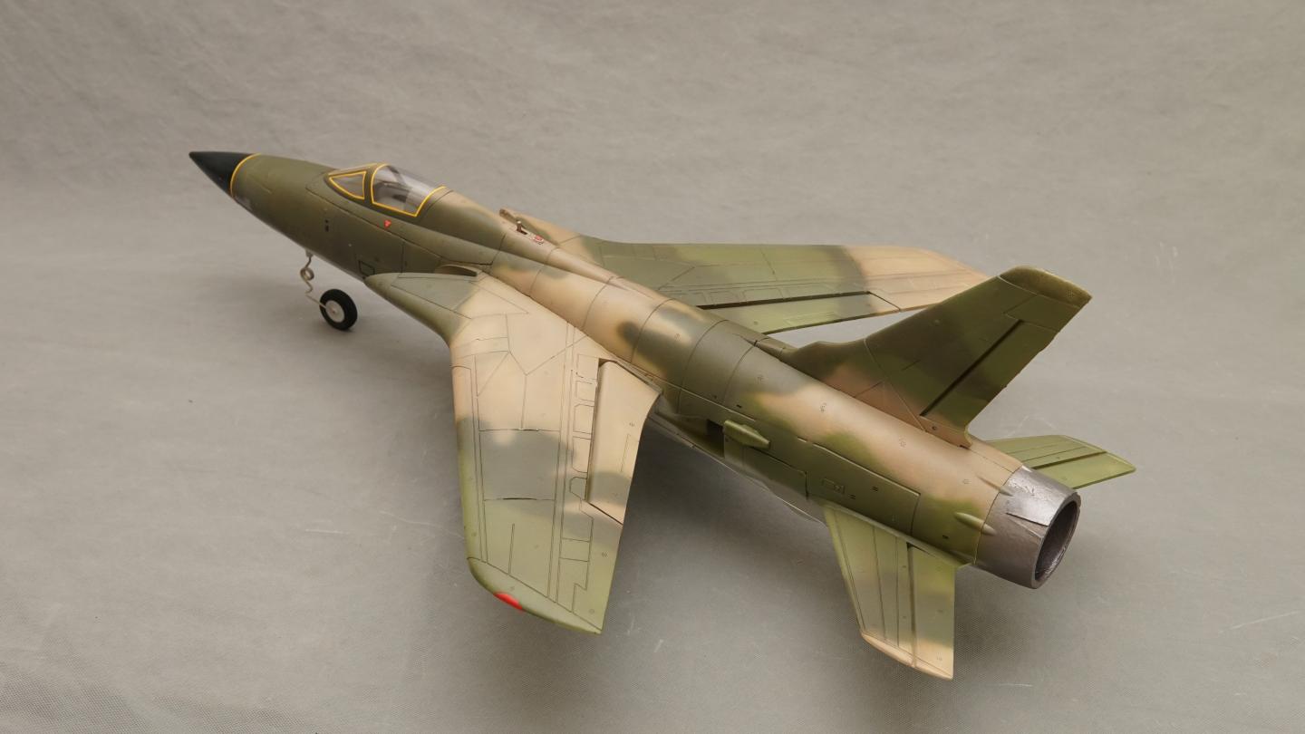

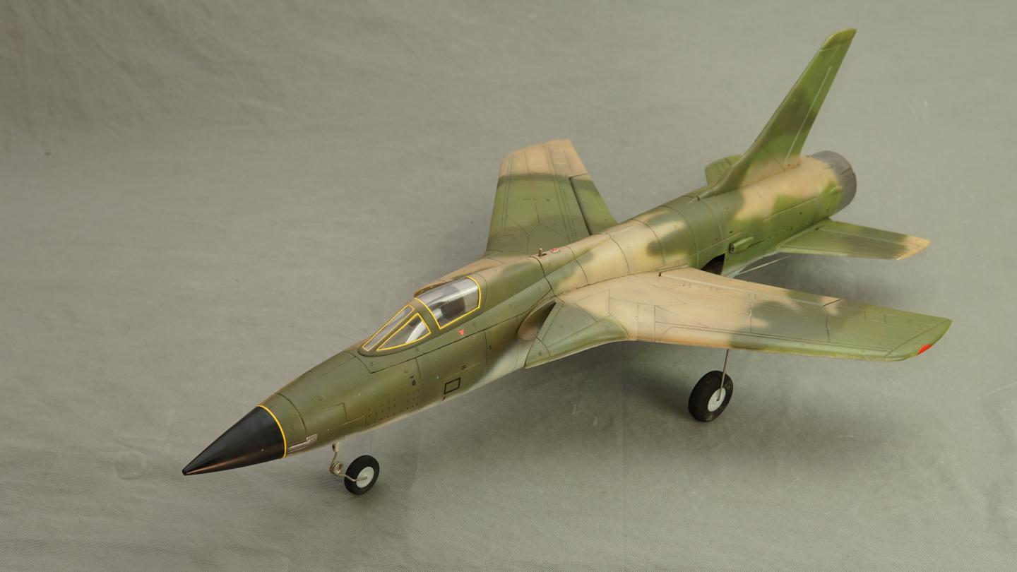

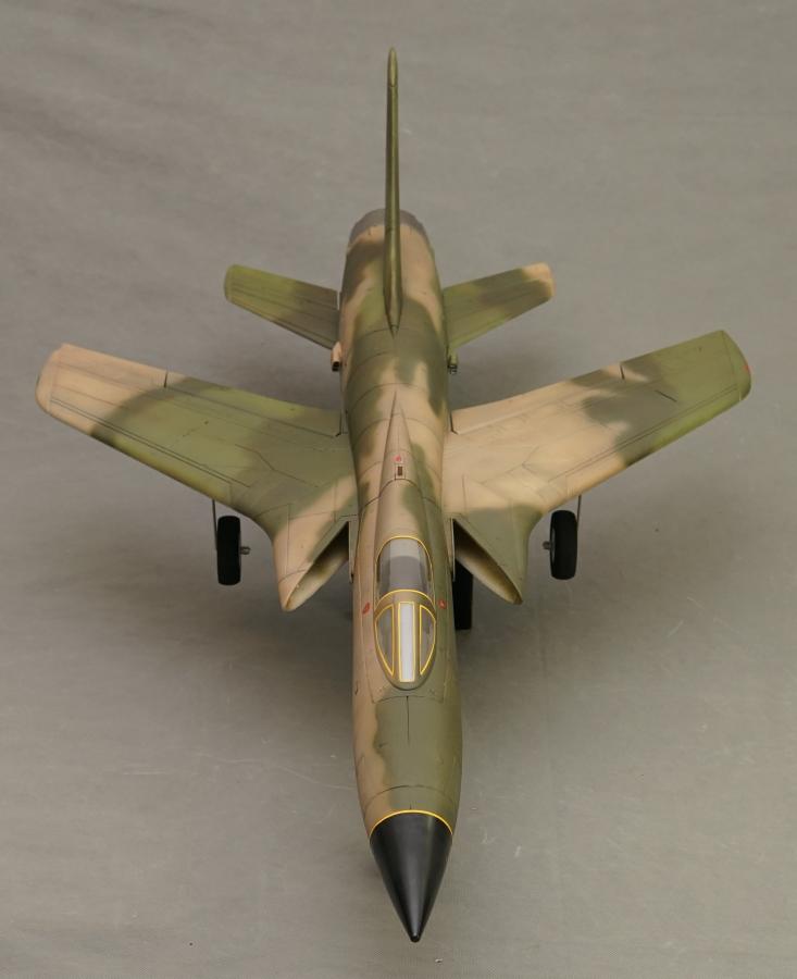

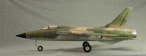

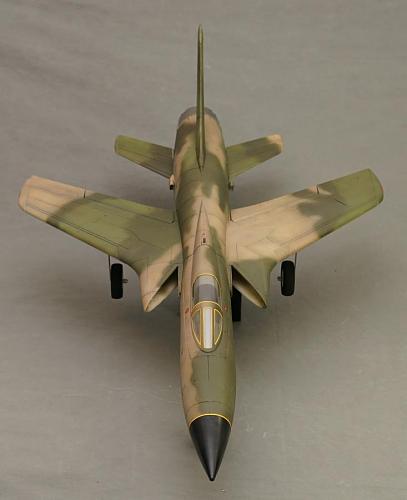

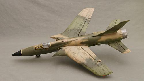

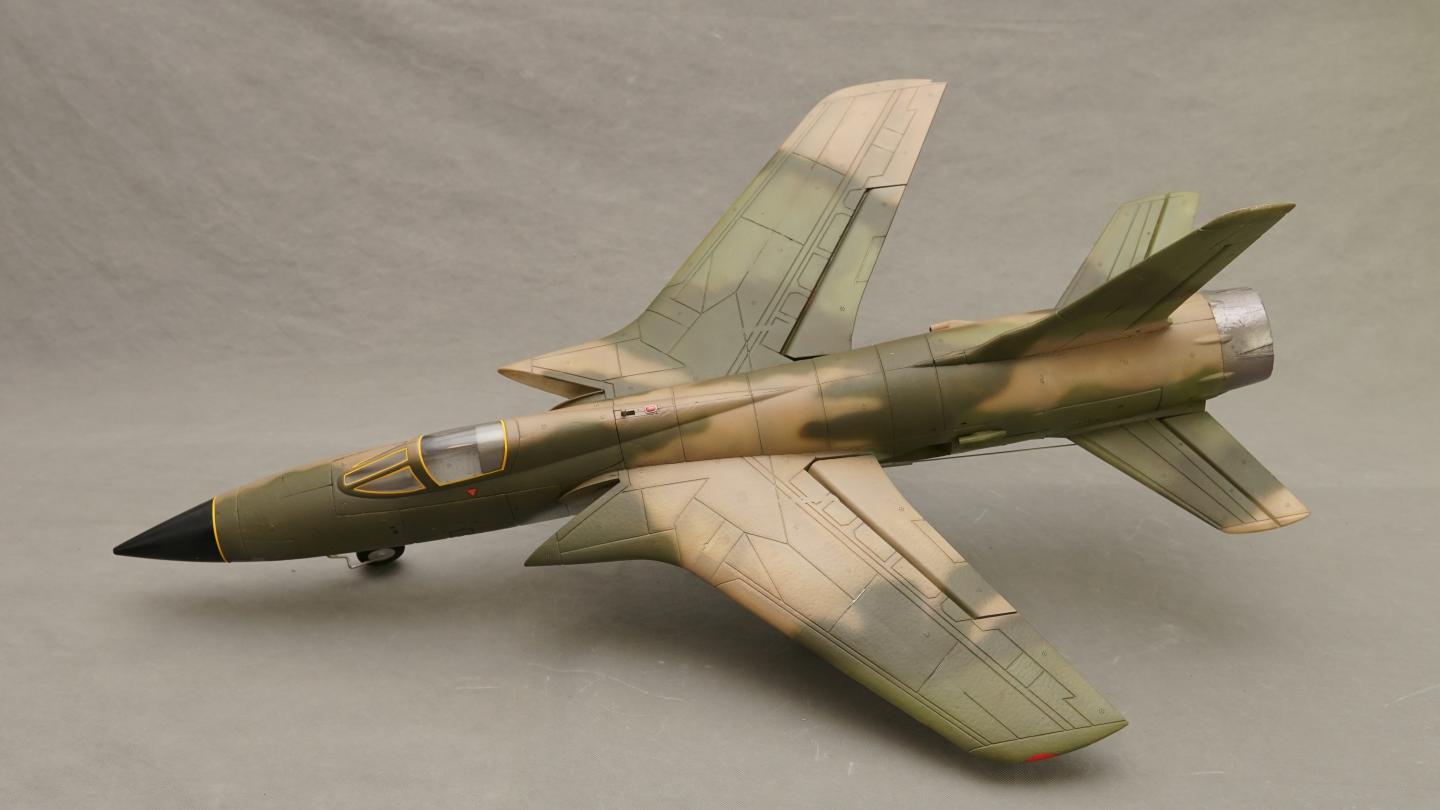

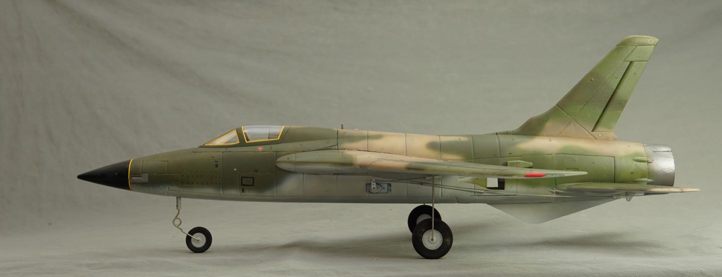

            We're still wondering which of these planes to use as a base for our painting tutorial. So far I've repainted all of our Toss and Boss planes, both the pocket warbirds and the pocket parkjets. I posted pictures of this Thunderchief months ago, but after some touchups I reshot it. I also have some other ideas planned for it. For now it's a great "Mantle Model", like those wood static desktop displays I used to collect as a kid, except this one actually flies.

            Three four primary external colors were built up over about ten different base colors (red, rust, oil brown, yellow). This imparts lots of tonal variation between transitions of camouflage, panels, and open areas. The idea was to simulate a sun-faded aircraft. I don't have Callie in Asia so I made do with hand drawn accents. I'm still undecided on a tail number. Perhaps I'll save that for the Tutorial video.

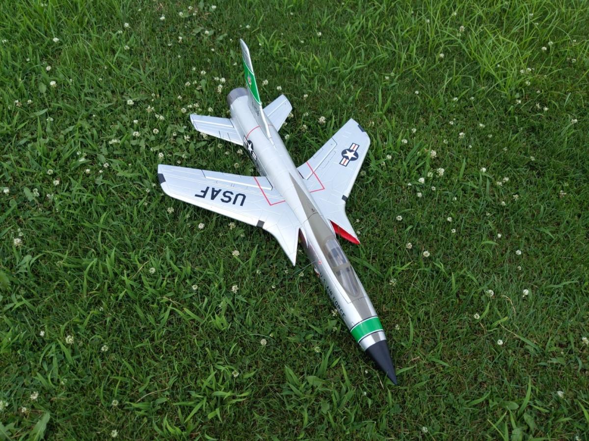

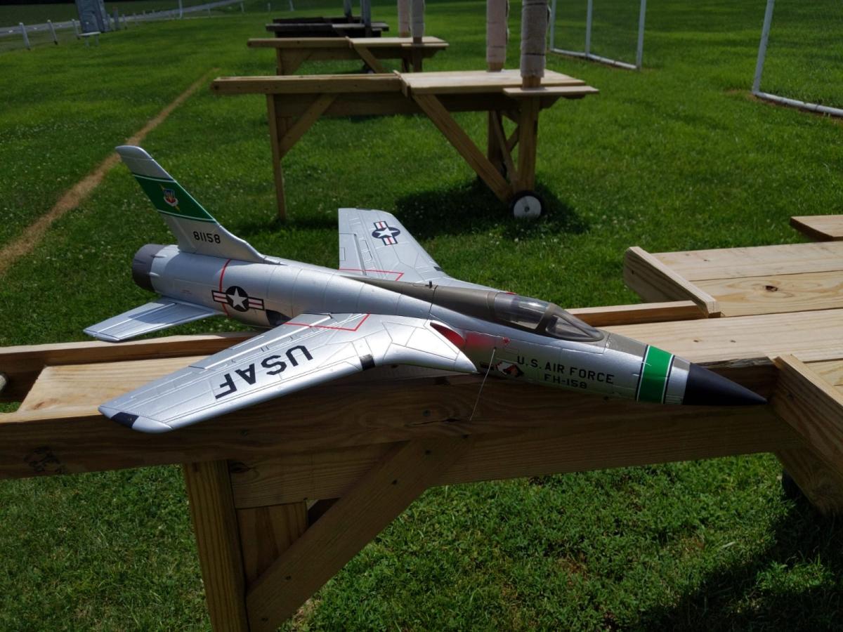

              Got me another 64mm line edf;
              -painted the intakes red, opened the main vent hes on the fuselage about 3mm, and about 5mm on the rear vents close to the ducted fan. Noticed a significant increase in watts, easy to hand launch w a 2200mah, 1600mah to a 1300mah. IMO the 2200mah is the way to go, flies more scale and no shakiness at low speed, 3:30 to almost 4min.
              A thin coating of Elmers glue 75/25 water to protect the decals and get rid off the cheesy shine.
              On a 1300mah sport flying, 2:30 minutes.
              The CG is like in the guide, 14-3/8, but a slight tail heavy, so slightly, once in the sky will track as other say, like an arrow/dart.
              Loops are so so, rolls are stupid snappy. It does blend w the sky, so a good eye and 100% complete attention. I may cut a little of the bottom skid plate, imo is too much fin under the fuselage.
              ​​​​​​:Cool:

                Alpha..... Now that's how a Thud should look !

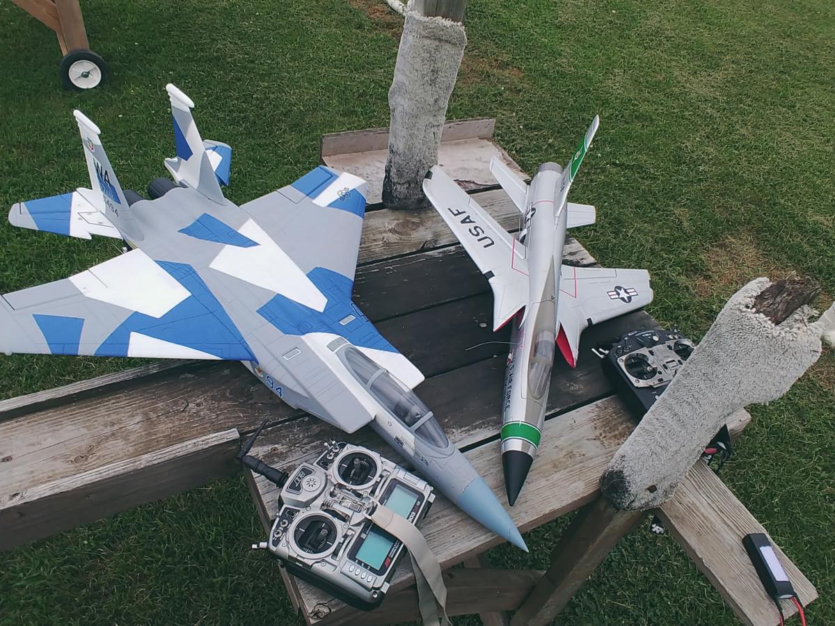

                    A shot side by side w a Eflite F15 4S veersion and SAFE select systemClick image for larger version  Name:	20190705_154629.jpg Views:	0 Size:	225.8 KB ID:	204650 ​​​

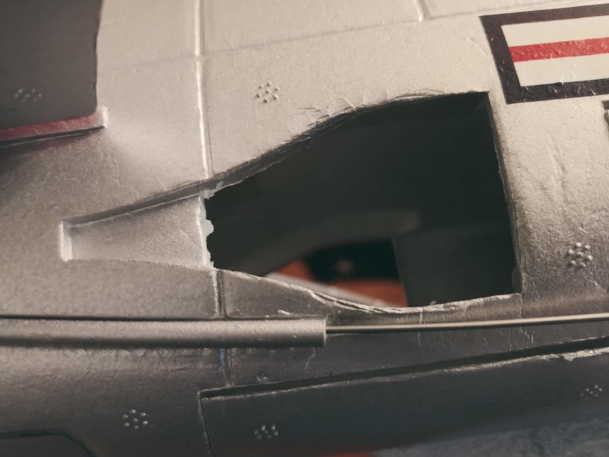

                      Am able to fly the Thunderchief,
                      w 1300, 1600, 1800 and a light 2200 20C, not the heavier 40C 2200.
                      Its tricky to set the aileron and elevator (ELEVON) setting right w dual rates, using a Futaba 10J w 6 channel Corona receiver, FHSS protocol. Have managed about 15 flights since I received it last Tuesday. I try to run four packs/flights per plane.
                      Its bone stock, 3S w the 30A brandless ESC. Opened the naca ducts (I think thats how its called) and added half of a spoon piece as a duct painted black. Flies the same, w a little more punch and sounds more realistic of a whoosh sound than the annoying vacuum cleaner noise.
                      Let me correct, that after a few flights 1800mah is about right, and w good flying envelope, keep the speed up, wings leveled and easy on the elevons when bringing it in, belly lands smoothly. I like how it shakes before dropping a wing, je je, does its wiggle dance as I call. For some reason, this little jet has personality and I like more than the F22 Raptor. Am frustrated that I still need to dial a little more the elevons for loops as so far they are just ugly, as soon as it goes vertical, and yank it to do the loop, the plane is all over tumbling in the sky, which besides elevon not set correctly, is a sign of lacking power.
                      I still like my little Thunderchief, its one of those to always bring along and enjoy it at half to full throttle darting across the field and its unique landing.
