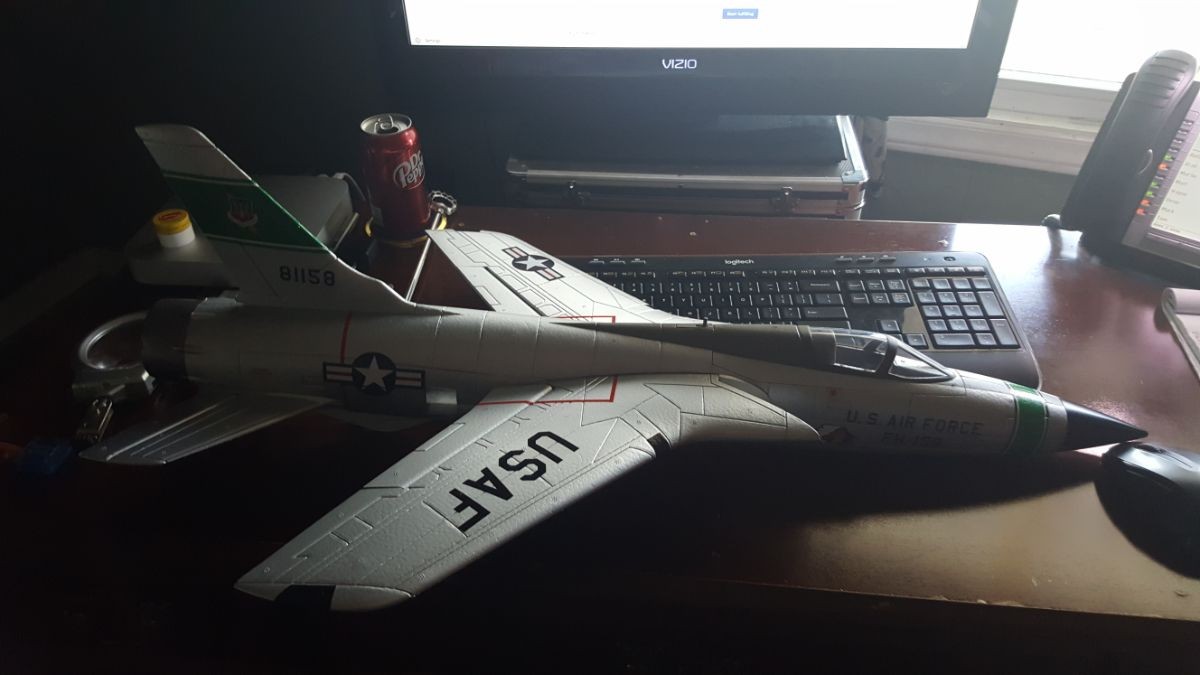

                                She has arrived!!

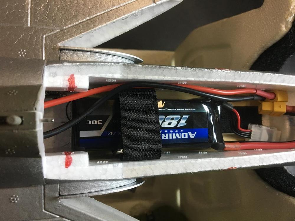

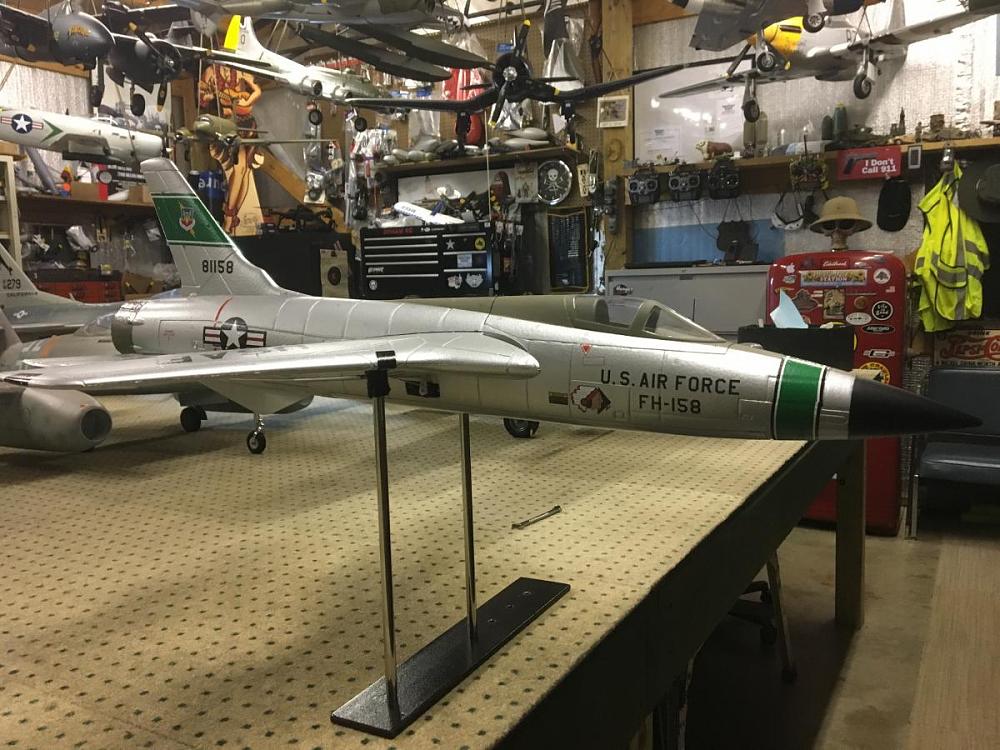

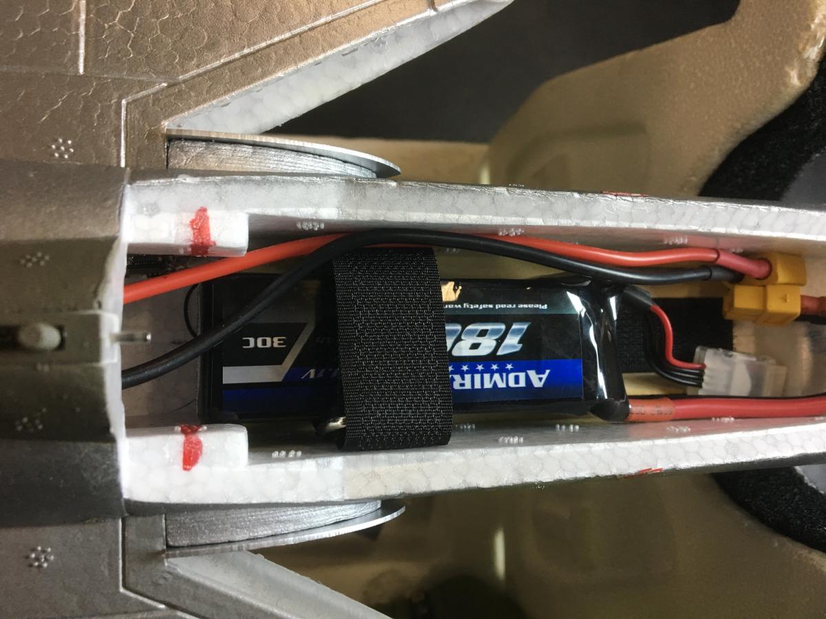

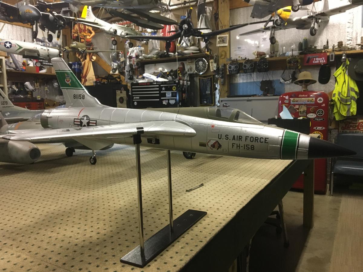

                                    This F-105 is even nicer than the F-8 as it has a full belly skid and a flexible plastic nose cone, it took longer to setup the radio than to build it, fit and finish were perfect. It balances per the manual (365mm from the exhaust nozzle) with an Admiral 3S 1800mAh battery 10mm from the rear of the canopy opening.
